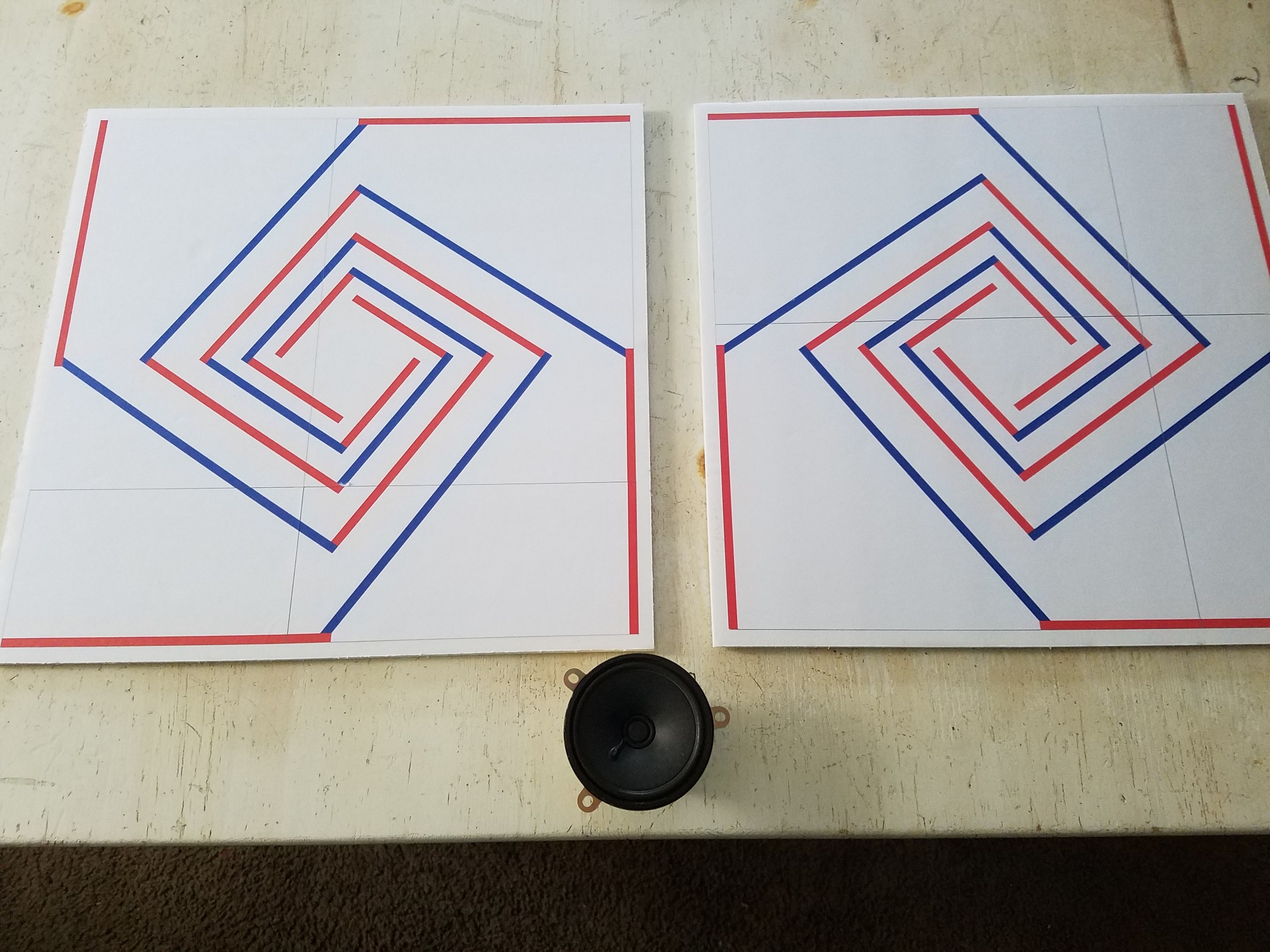

I was working on a set of the micro cornus, a la Planet10's pdf, for drivers I scavenged out of some old Creative brand PC speakers, but I was having some trouble getting the dimensions to work properly. My foam board is 5mm thick, which takes up a huge amount of the available space in the micro and narrows the channels. The throats narrowed to 6mm. I estimated the effective area of the drivers at about 31 cm^2. To make the throats big enough, I would have had to make the enclosure about 26cm deep!
Initially I thought about following roughly the same shape as the template but making the throats wider and keeping the lines a constant cross section instead of widening until further out closer to the final flare. That way, the lines could still be about the same length. I started, but realized the scoring and shaping and bending and measuring and re-thinking while flying blind without a template was going to take a lot longer than the time I have allotted for this project.
So, I designed a new template, simplifying the shape to use all straight lines and sharp corners. I also went with 4 throats instead of 2. This should be a lot faster to build. I have no idea how they will sound; I'm just flying by the seat of my pants. I haven't modeled it, as I wouldn't even know where to start, and I don't know the specs on these drivers anyway. I'm just crossing my fingers and hoping they sound better than the original enclosures. Here's a picture of where I am now, templates printed and glued to foam board and one of the drivers.
