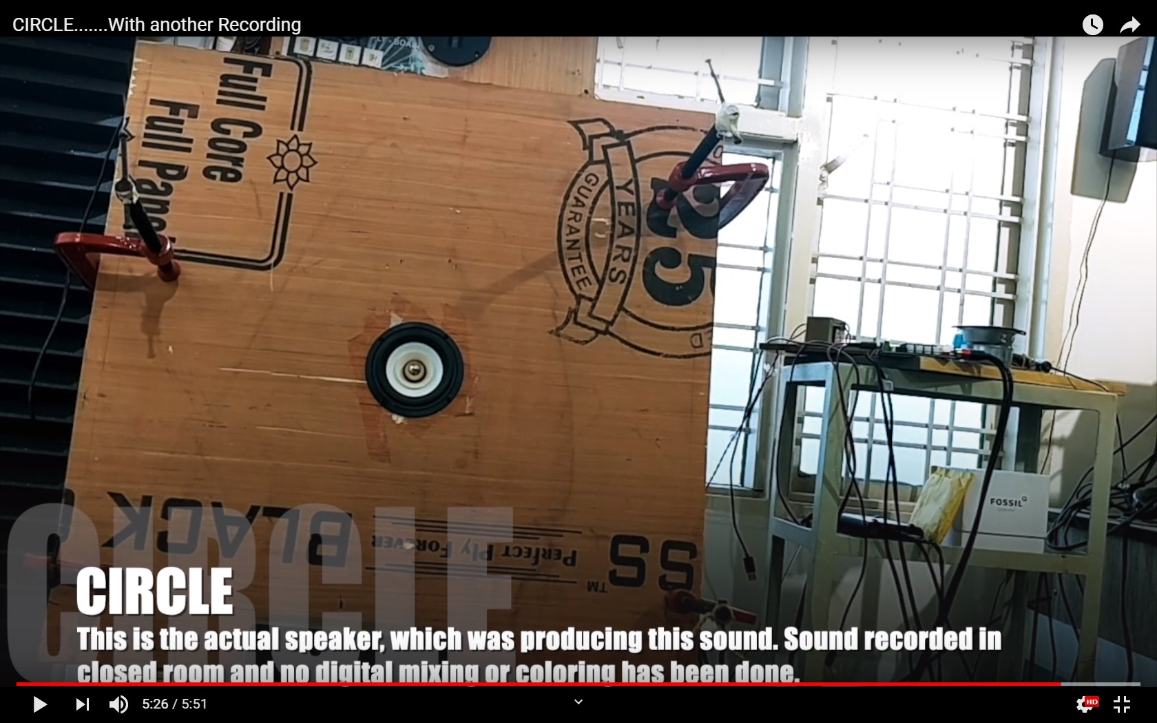

Friends,
I did an experiment.
I just mixed this full range Cornu board with high class Fountek rd 1.0 Ribbon Tweeter.
Now again i added Denon Sub-Woofer, for Lowest Frequencies to add depth.
To add, some more spices, i used MiniDSP 2X4 Board with Active DSP, to leverage full benefits of Parametric EQ and Leveler to match Speakers crossover (48DB/Oct separation), and you all will be surprised with that.
I uploaded video on you tube, link is YouTube
I recorded audio-video in 24-Bit audio format but editing and uploading into Youtube, just messed up with original quality. Although quality is somehow manageable.
I need carl & xrk971 review, as this thread is only because of their most of contribution.
YouTube
This costing a lot (around 400$ + more)
CIRCLE
I used full range audio labs 4" dual cone speaker as mid range.
Fountek rd 1.0 super tweeter has been used at 3500hz cutoff frequency with 48db/octave filter.
Denon sub woofer being used below 200 to 75 hz.
ACTIVE DSP IS BEING USED.
Crossover function is used through MINIDSP.
Input signal is fed through creative sound card.
Original Recording was made through 24bit recorder, but YouTube and I movie editor ruined it.
Parametric EQ was also implemented through MINIDSP.
80+80 watt rms class-d amplifier was used (TDA7498).

I listened again with my nice headphones (OB-1) and a SE Class A headphone amp and the sound is very good - excellent actually. Nice bass and surprising depth from a 4in driver and a Cornu. You did not mention the dimensions of the Cornu you used, or standard 28in x 5.5in deep?
I could barely make out the ribbon tweeter at the top as it is partially cropped. Anyhow, nice work. I may have to revisit the Cornu again and add maybe a small AMT or a B&G on top.
Thanks for sharing.

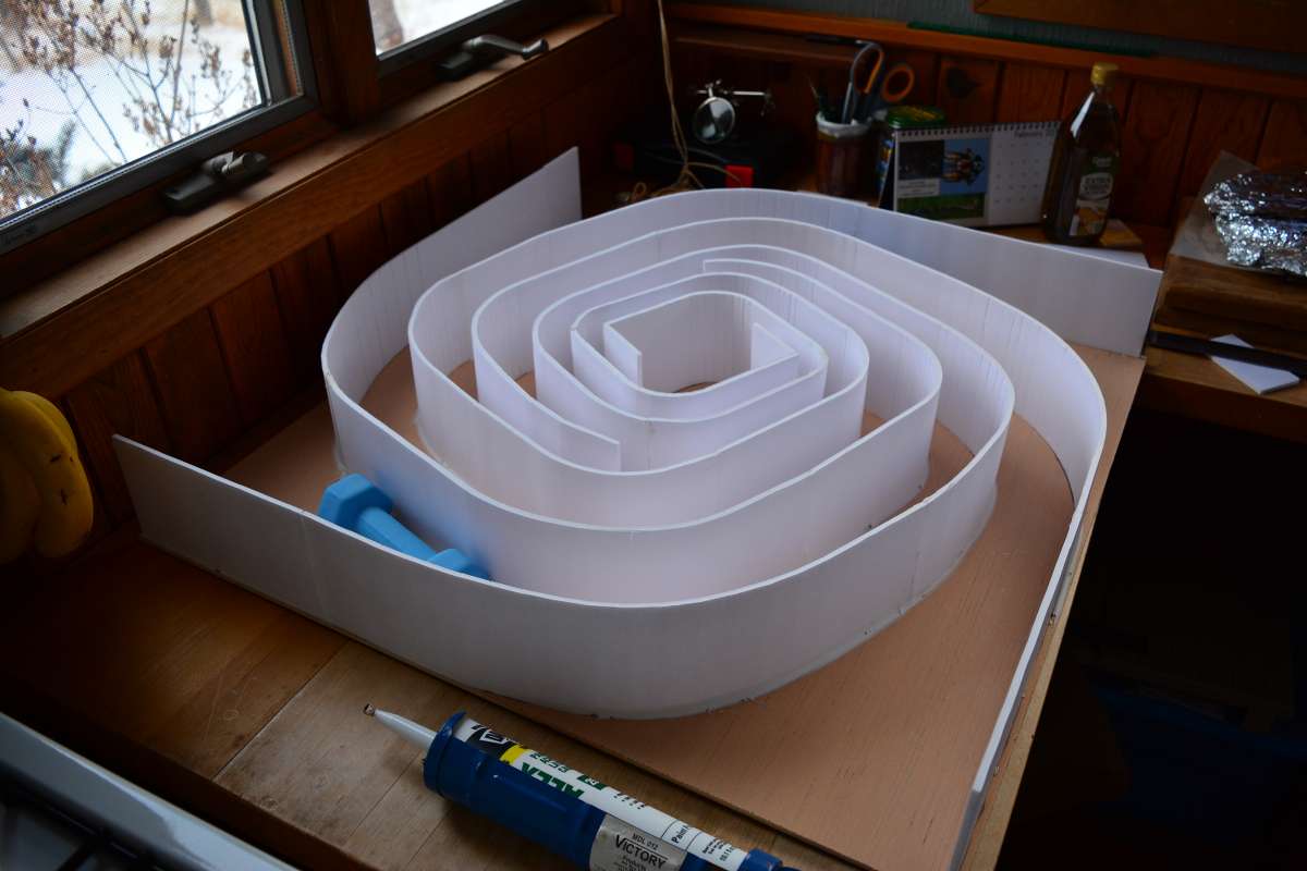

I took advantage of the single digit temps (or less) and whipped up a couple more of these foamcore speakers. These are 28” x 4” Cornu spiral horns with Dayton PC105-4 4” drivers. Cost about $60 altogether. Used Lowe's RevolutionPly 5mm poplar plywood for the front and backs. Overall they turned out OK. There is some confusion as to what I'm hearing in the midrange on some recordings, most likely drum or percussive string sounds. I'm a big fan of the various mini Karlsonators w/TC9FD's, and have delved into high end wooden projects in the past w/Focal and ScanSpeak drivers. So it'd be nice to have clearer detail, and I may order some Tang Band W42142's to plop in these boxes. Previously I built micro Cornus (14.5” sq) w/2” drivers for my TV and they yielded outstanding results. I knew ahead of time that these are not reference monitors but should result in some big wow factor. A surprise was working with the RevolutionPly instead of all foamcore. Even tho I picked a very good specimen 4x8 out of the stack at Lowes, the material exhibited waviness and buckling, especially when attaching the second piece (back). I was simply unprepeared for that and didn't have the necessary number of small heavy weights or dozens of large clamps necessary to combat this. The first speaker came out OK but the second was a mess and had lots of large air gaps after the glue dried. Hopefully they were all near the edges so I could fill in the gaps. All four horns seem to be transmitting OK tho one was a bit weaker than the others. That said, there is no lacking of bass in these things. It was a wonderful way to fill up a subzero week. Only sliced my finger once and then took time off to build an apple pie 🙂 Also threw a loaf of bread in there for some variety. Thanks to everyone who tried these and talked about their experiences especially Cal and X. I posted a YouTube with a variety of short music clips that I'm prone to listen to and one w/ vocals that we recorded here locally with people I regularly work with. It was recorded on a portable Tascam that has built in X-Y mics. Everything on the recorder is flat but it yielded a bassier sound than what was experienced in the listening room. There is very minor adjustment to the eq in my computer, maybe 3 bands and nothing changed more than 2dB. So these speakers turned out surprisingly flat.

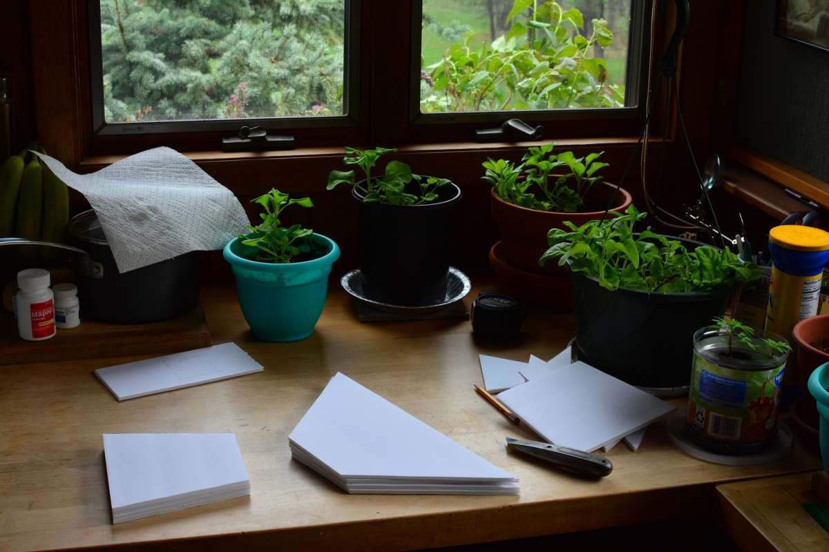

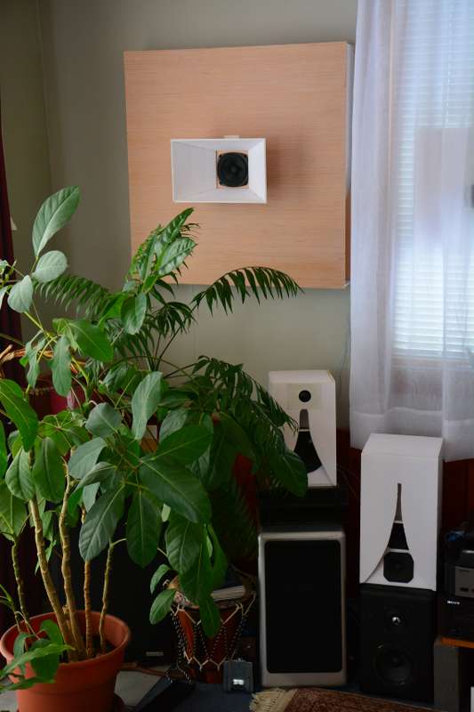

I've been grooving on a Cornu Plus setup for the last few months. The 'plus' is that I added a pair of XKiClops (XKi's w/ tweeters)speakers to fill out the midrange and highs. The Cornus really filled up the room with a nice horn sound, but wasn't very bright with the driver I chose (Dayton PC105). Last night I was eating dinner and my playlist ran out; the ensuing silence was interesting and I had an idea. Build a small horn for the 4" driver. The purists are going to hate this part, but I cut some trapezoids out of foamcore and glued this thing up w/o any idea about angles and sizes except what I pictured in my head. As soon as I held the horn up to the driver I could hear the sound "focus." So I taped the horns on temporarily and started listening. There is an abundance of mids now that matches better the rest of the sound. I listen to alot of jazz, acoustic and electric. The horns sound magnificent and so does acoustic piano. Everything is in ur face now. Drums slam and kick drum is much punchier. About the only minus is that staging is not enormous like it used to be. Spatially it's flatter effect.
