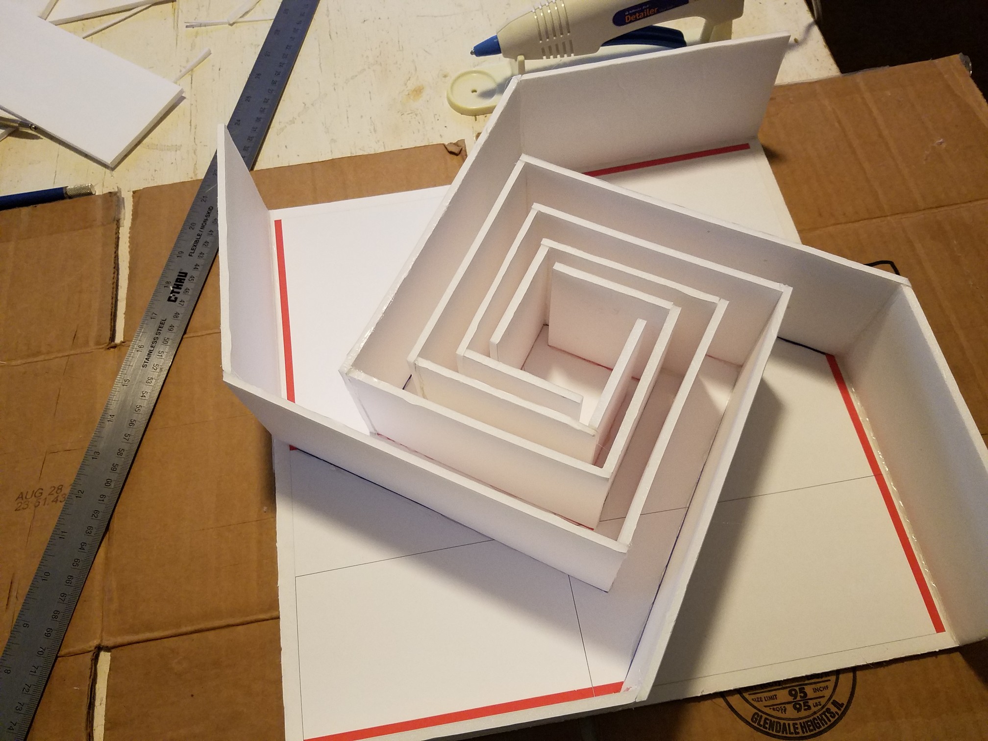

Simplified Micro Cornu
Cal, those pentagons are really cool. It looks like a lot of work to shape all those smooth curves. I bet they sound nice.
Craig, well every "W" in "WAF" is different. Mine prefers simple, sleek, ultra modern, straight lines, right angles... so squares are be better in my case.

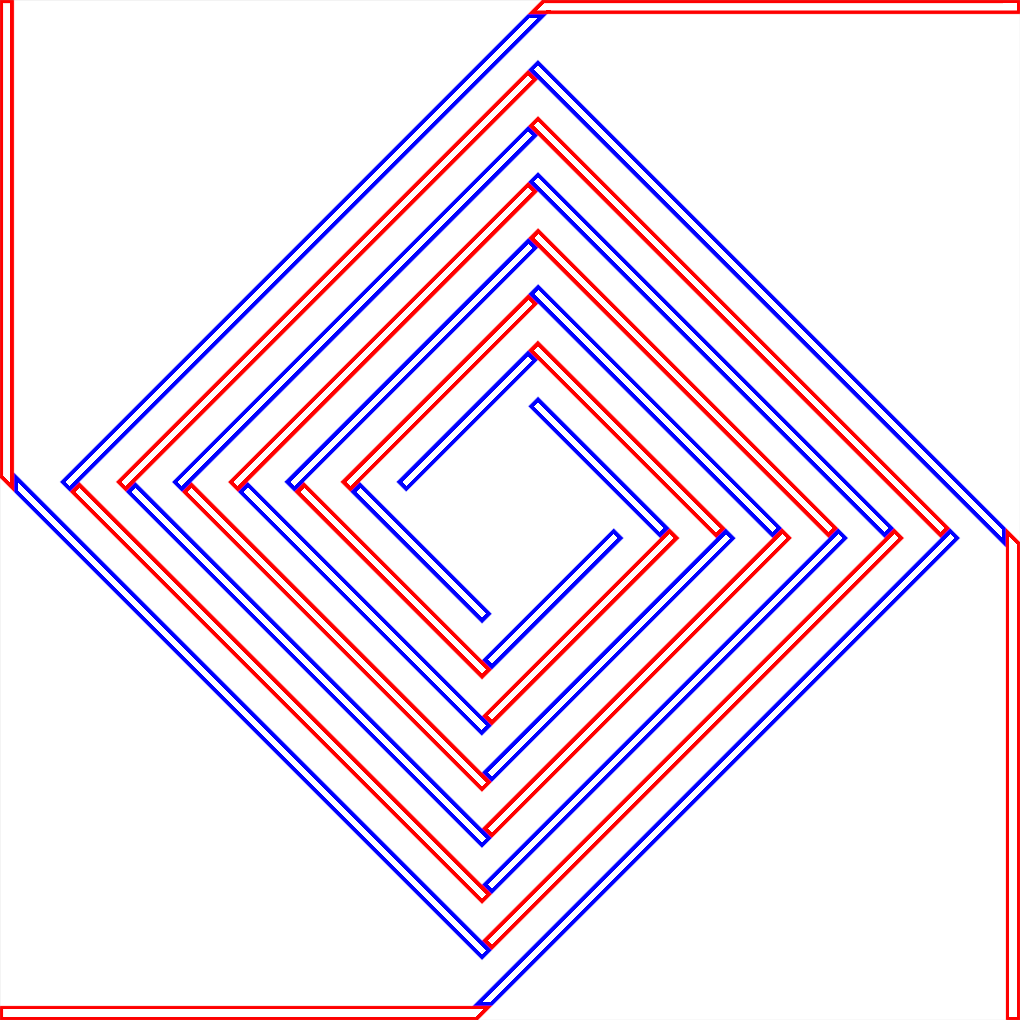

I drew up a new version of the simplified (straight line) micro cornu. It uses a constant cross section and doesn't flare until the final turn/exit of the horn, so it packs a lot more length into the same space. It's just a tiny smidge over 110cm per horn, so should have a 1/4 wavelength tuning of about 78Hz. Again, this is completely unsimulated/modeled, and it has never been built, so use at your own risk.
With constant cross-section it is now a TL not a horn, and so really not a cornu-clone.

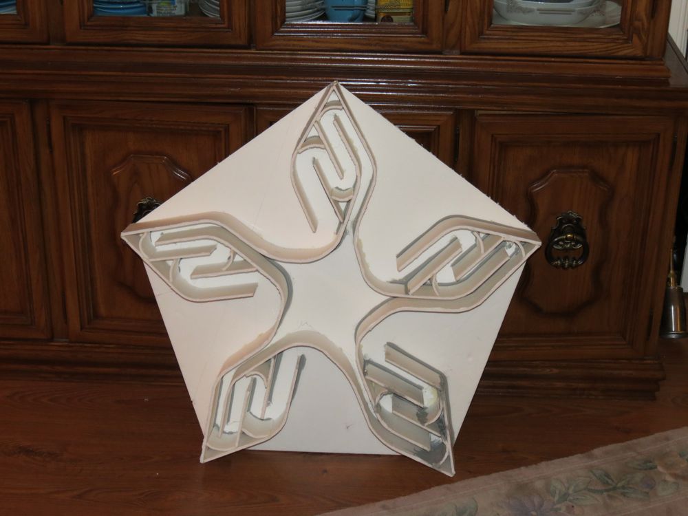

Cal, i suspect better response will be had in those pentagons if the little deflectors to smooth the corners were removed. You don’t want HF coming out the horn mouth. And in the labyrinth part is there a constant expansion… on 1st look it doesn’t look like a horn shape… how do they sound?

Yes, the Penthorn is a constant expansion.
I think you're right about the reflectors but it was together before that thought came to mind.

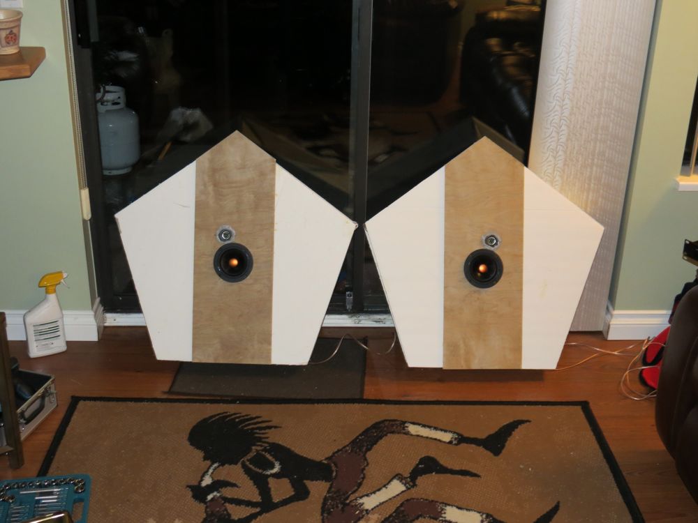

Those were made in 2013. They use the WR from CSS and a small tweet to top it off.
Not sure how you would do that.Cornus with a circular face and back rather than square?
The Penthorn is too short. Low end suffers.
That WR driver is a real workhorse. Probably the most robust driver of that size I've come across. It can get annoyingly loud. 🙂
