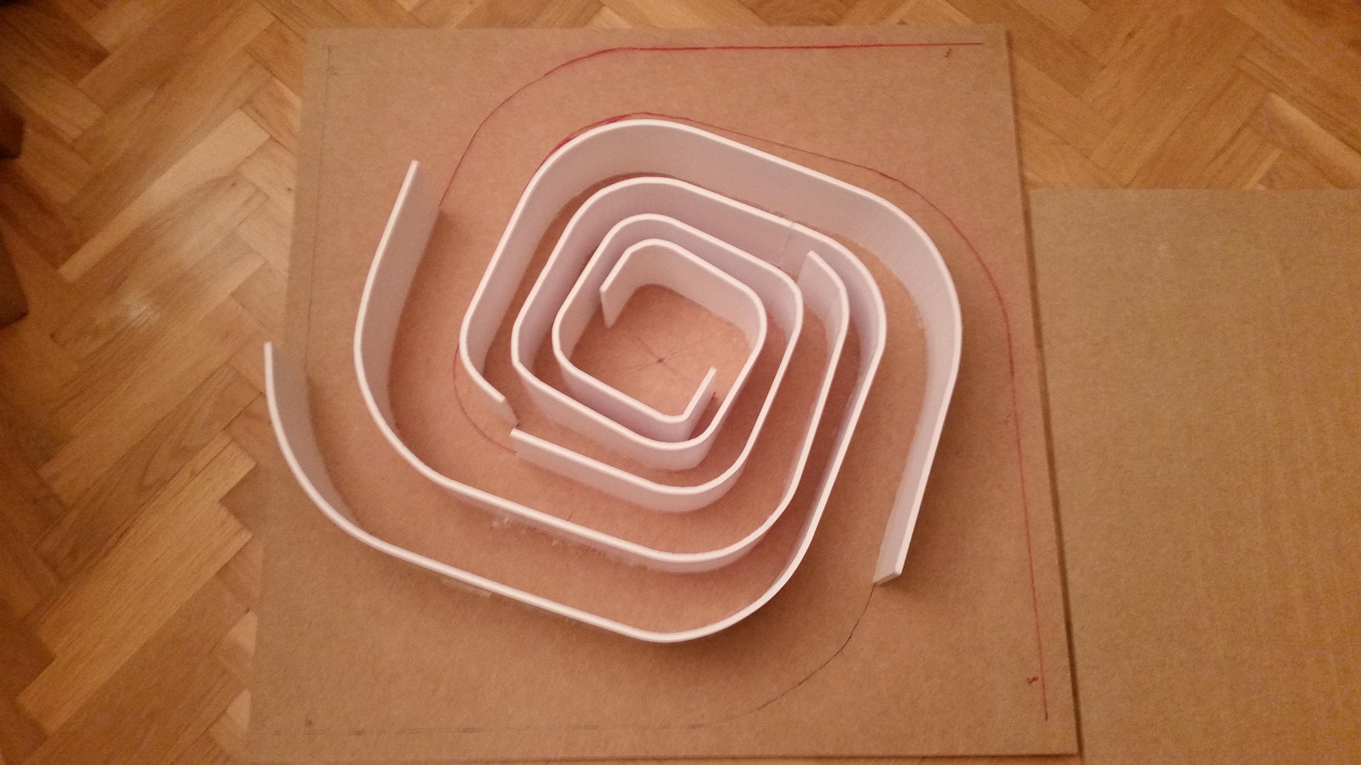

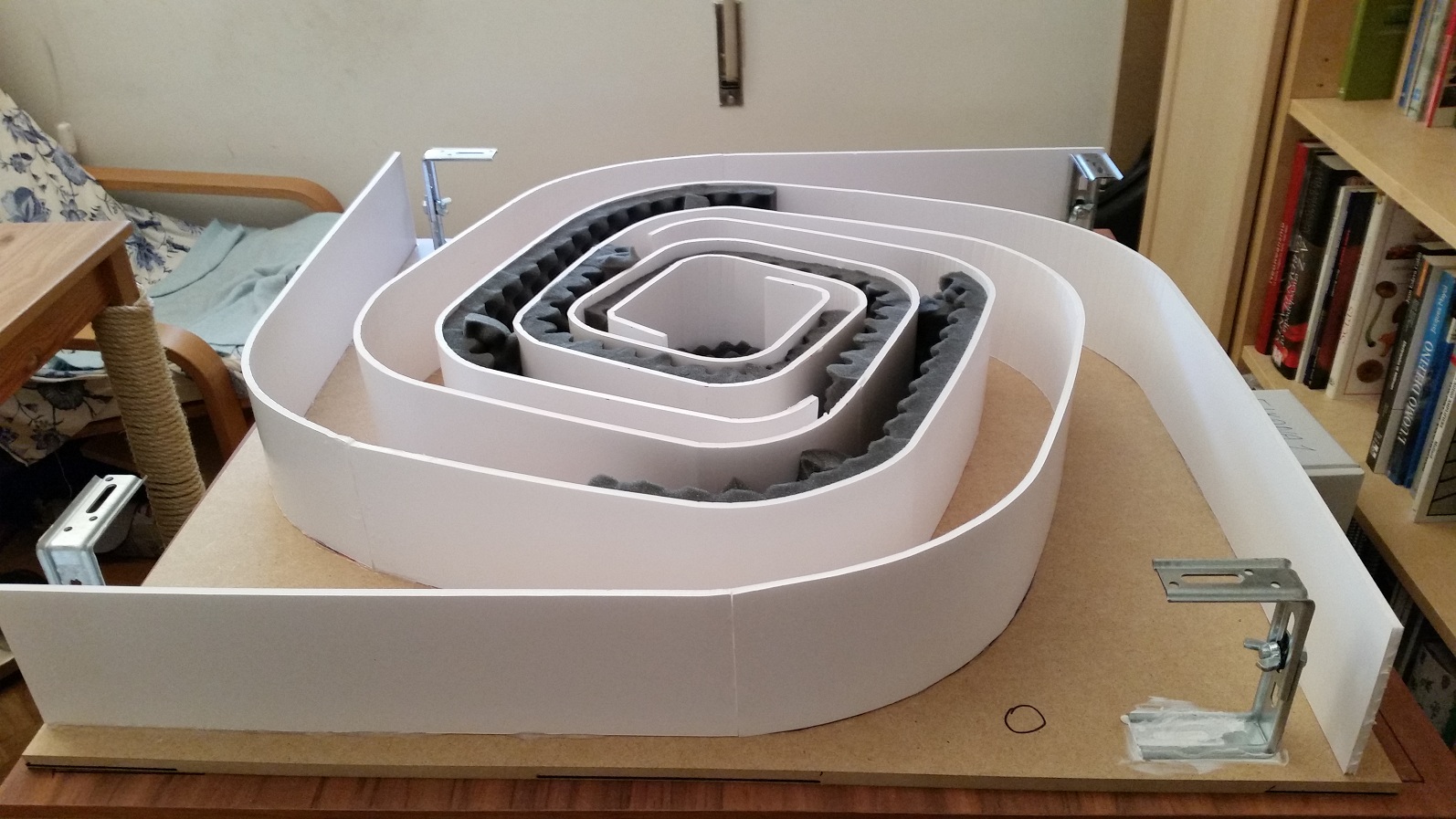

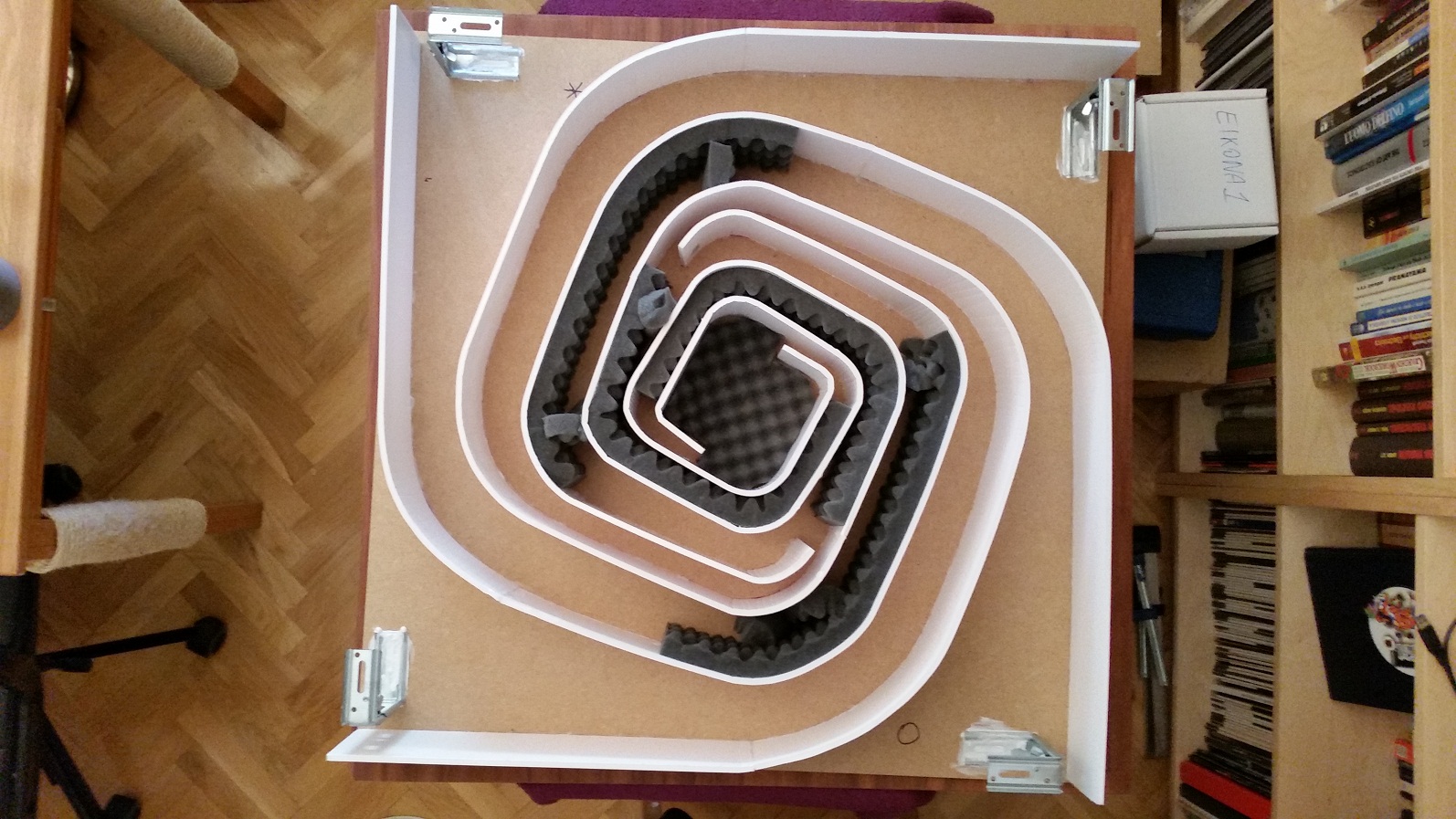

Finally I've achieved this long term objective : to build a pair of Cornu.
As you will see from photos I've been applying a kind of solution to make the front solid to the spirals and rear, with this method I’m sure that the wood won’t move and there will be no vibrations.
For the moment I’ve not sealed the spiral to the front so may be some “loss”, this is because I’d like to try different stuffing configurations.
I’m using a pair of Jordan’s Eikona and applying suggestions by XRK971 (thanks) : 75x75 cm , 10 cm thickness.
Wood is 1cm thick.
The preamp is a Pete Millett’s low mu preamp (Low-mu preamp)
The amp is a class-D amplifier (up to 100W)
Source : I use a Squeezebox classic from which can access to all my music collection.
Sound : For the moment the sound is good but not fantastic, I seem to have high missing and low are not that present, comparing with previous speakers.
I don’t know if :
- maybe Eikonas need some rollup (ie make them sound a good quantity of time) or
- maybe there’s too much stuff in the channels (please see the photos) or
- maybe I should seal the front with the spirals
I’m going to try to quit some stuff and check how the sound changes, after that will seal with silicone and make the speakers sound.
If you have any suggestions based on your experience they will be really welcome, as for some test music to check sound quality.
Thanks again for all the help and the presence of this space, best regards.
gmonno (madrid)

Gmonno,
Wow, beautiful work! And what a driver to use on it. How is it held together presently is not glued in the front? If not glued and sealed - you won't get much bass as little pinhole leaks can collapse the quarter wave air column. If you ever play a flute you know that a finger seal that is barely leaking will not achieve the low C note. Same thing here. So if you have not glued it yet don't worry about not any bass.
A few observations:
1. The open cell foam in the channels may be constricting the flow too much. Inwould remove the foam at the pinch point, leave the other foam in larger section and in chamber.
2. Add polyfill in the chamber and that lets you adjust after glueing.
3. Glue the front panel on and make sure you have a good mechanical fit to ensure the seal has no leaks.
Good luck!

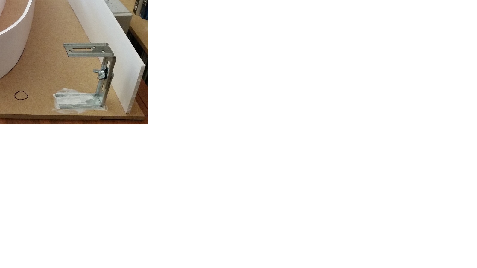

Many thanks XRK971.
The front is mantained in this way : if you look at the detail photo, I used a strong clue to link the rear and a "L" like aluminium shape, and used another "L" glued with front (not visible in this photo).
So I can join togheter the two "L"s --> now forming a "C" and screw them.
Will follow your auggestion about open cell foam and glueing rear and front.
