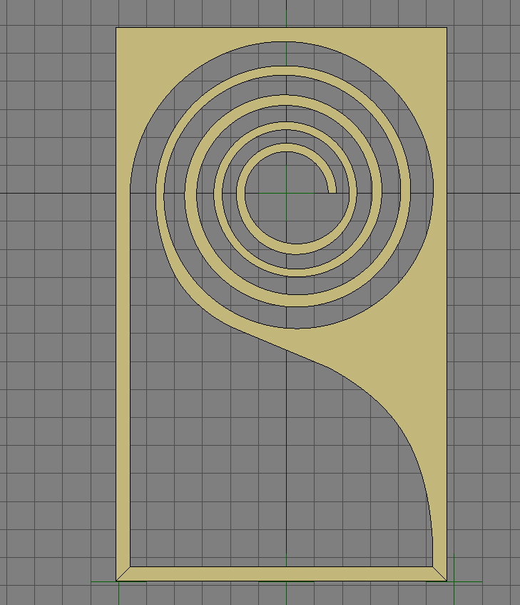

Spiral BLH boom box version 3
My latest design iteration -
Now based on a 3" driver. I am thinking the Tang band W3-1878. The overall dimension is 12" x 20". The horn is 90" long down the middle. The narrow end is 0.5" nearest the driver, and the spiral grows to about 2" before widening out to the biggest mouth I can fit in the overall box. Grid is 1".
Is this good enough to try to build, or should I make refinements first?
I have a pretty good technique down for making these now in my computer software, so new versions are not hard to make.
My hunch is that the horn does not expand enough in with as it spirals around. There is an exponential function in there, but scaled and manipulated to make it fit.
xrk971, what do you think?

The expansion is very slow and then opens up much like a trumpet. I am afraid it may have a "brass horn" like sound aka - mildly honking sound from resonance. You could model this in HR or Akabak pretty easily and get an idea.
Thanks xrk971
This is as I suspected - I went for horn length in a small space over other variables.
I could do one with fewer loops (shorter) but getting wider faster.
Any other comments?

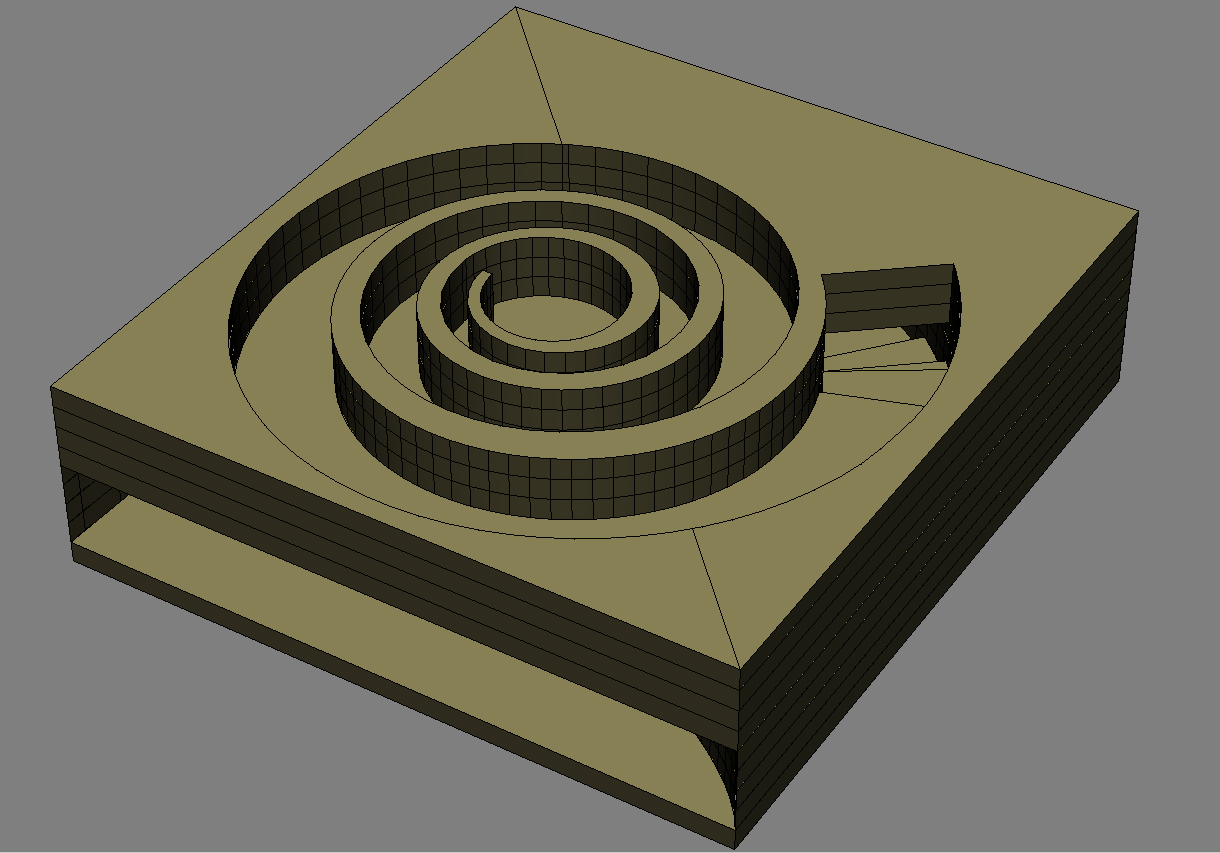

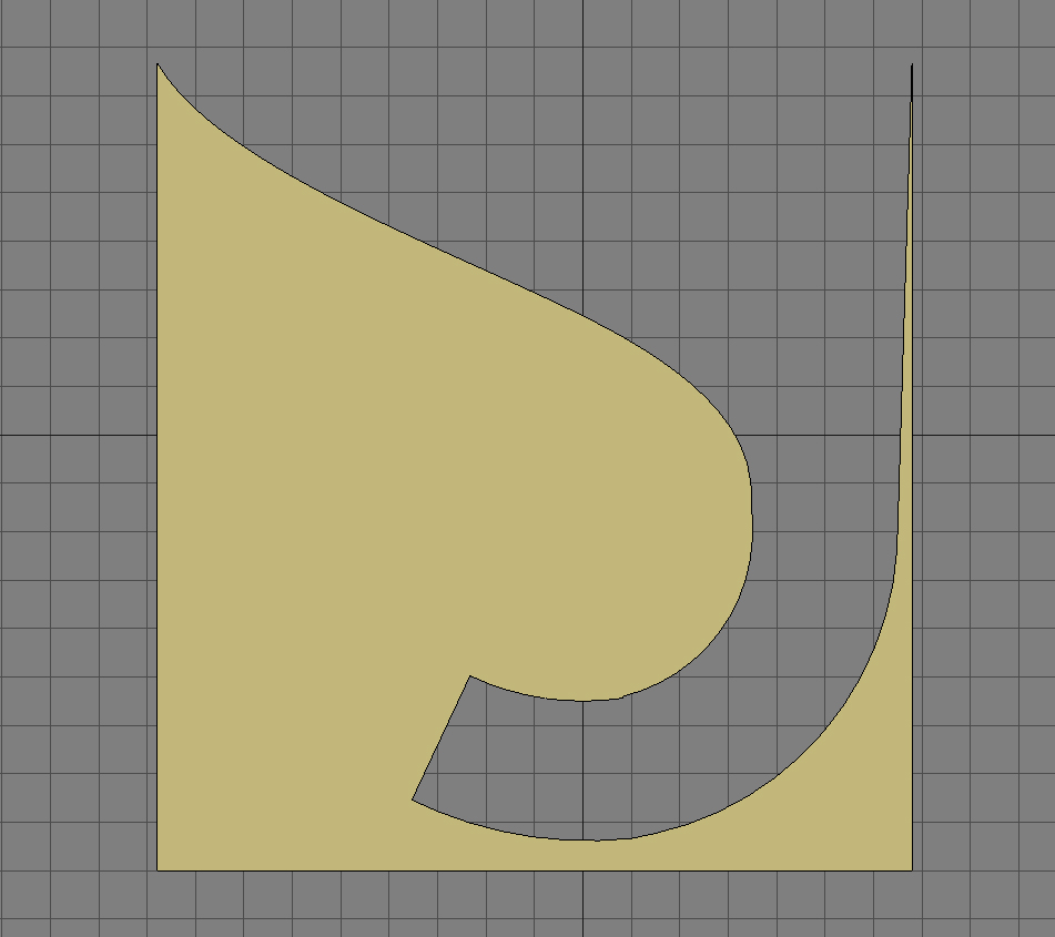

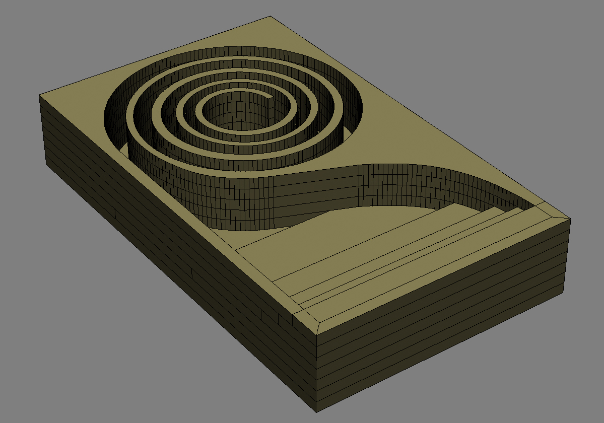

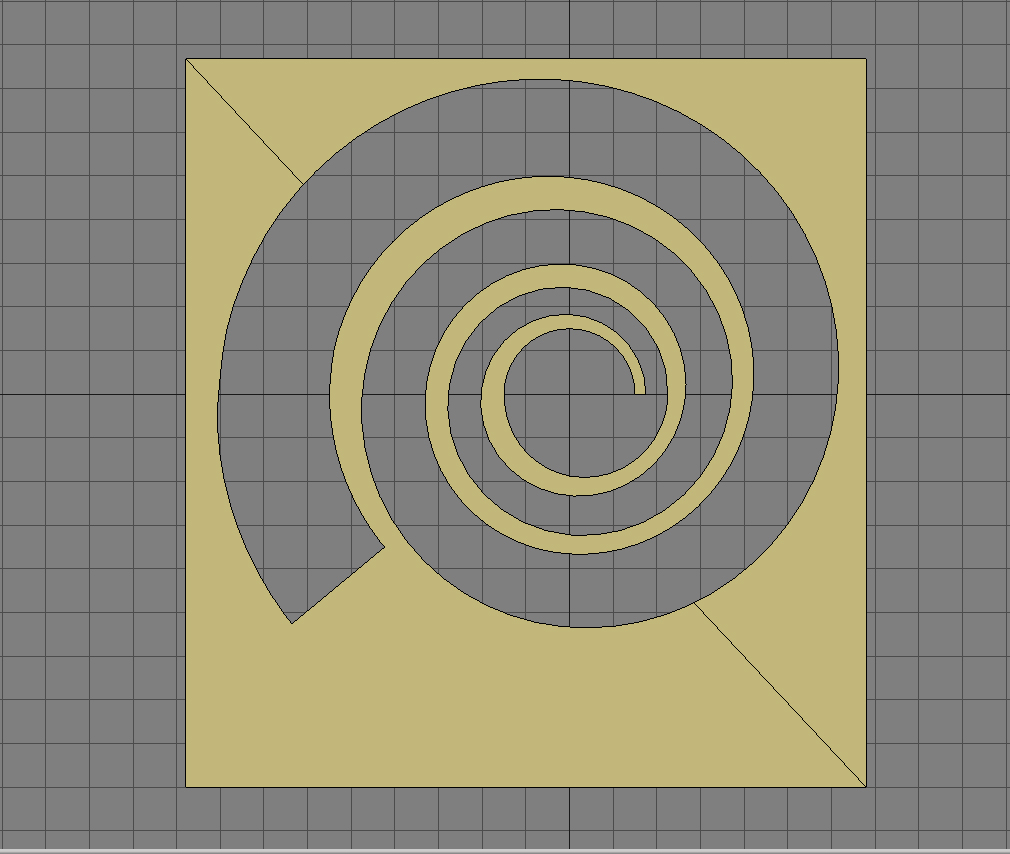

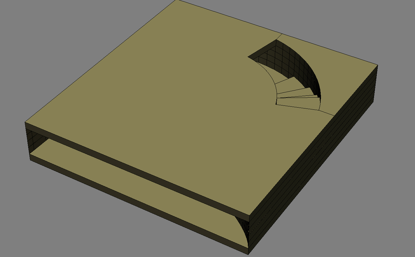

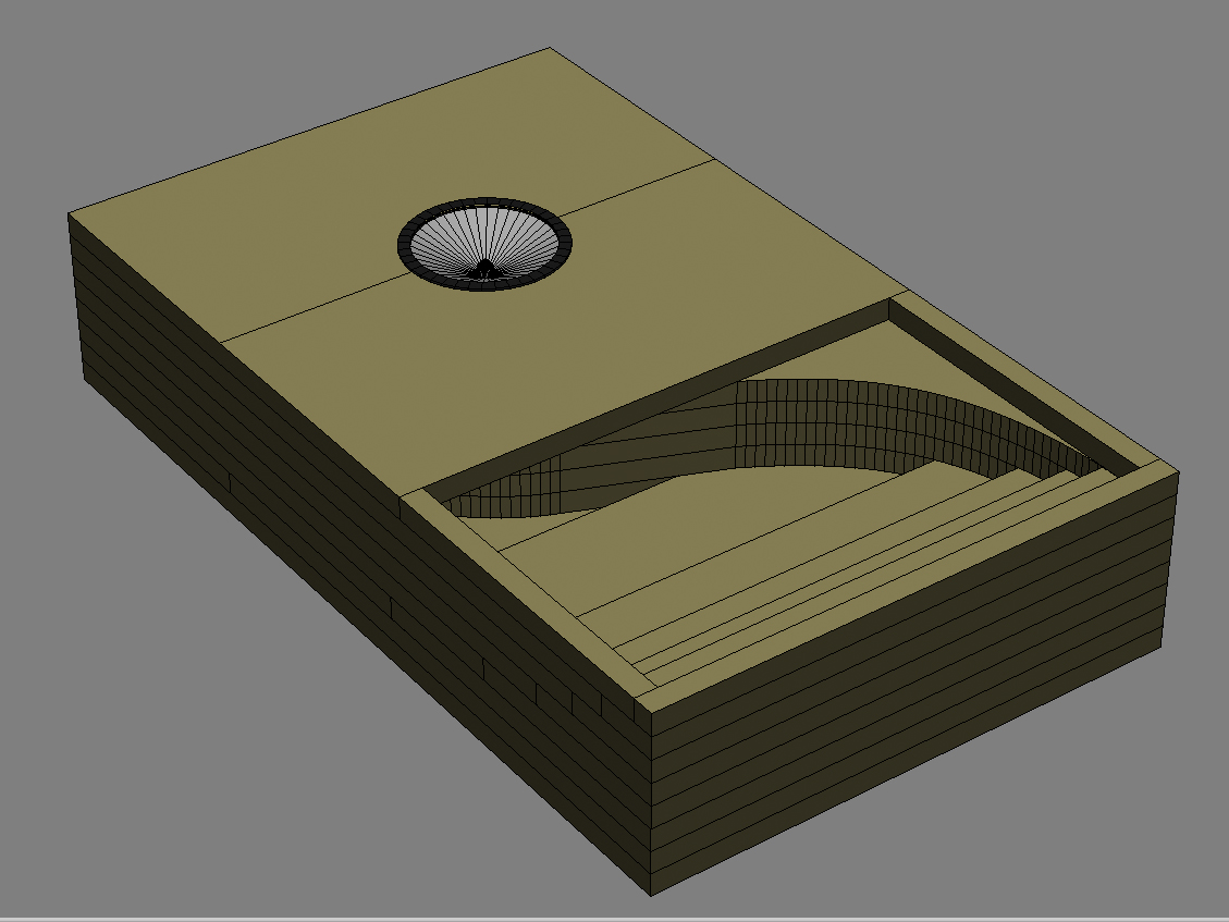

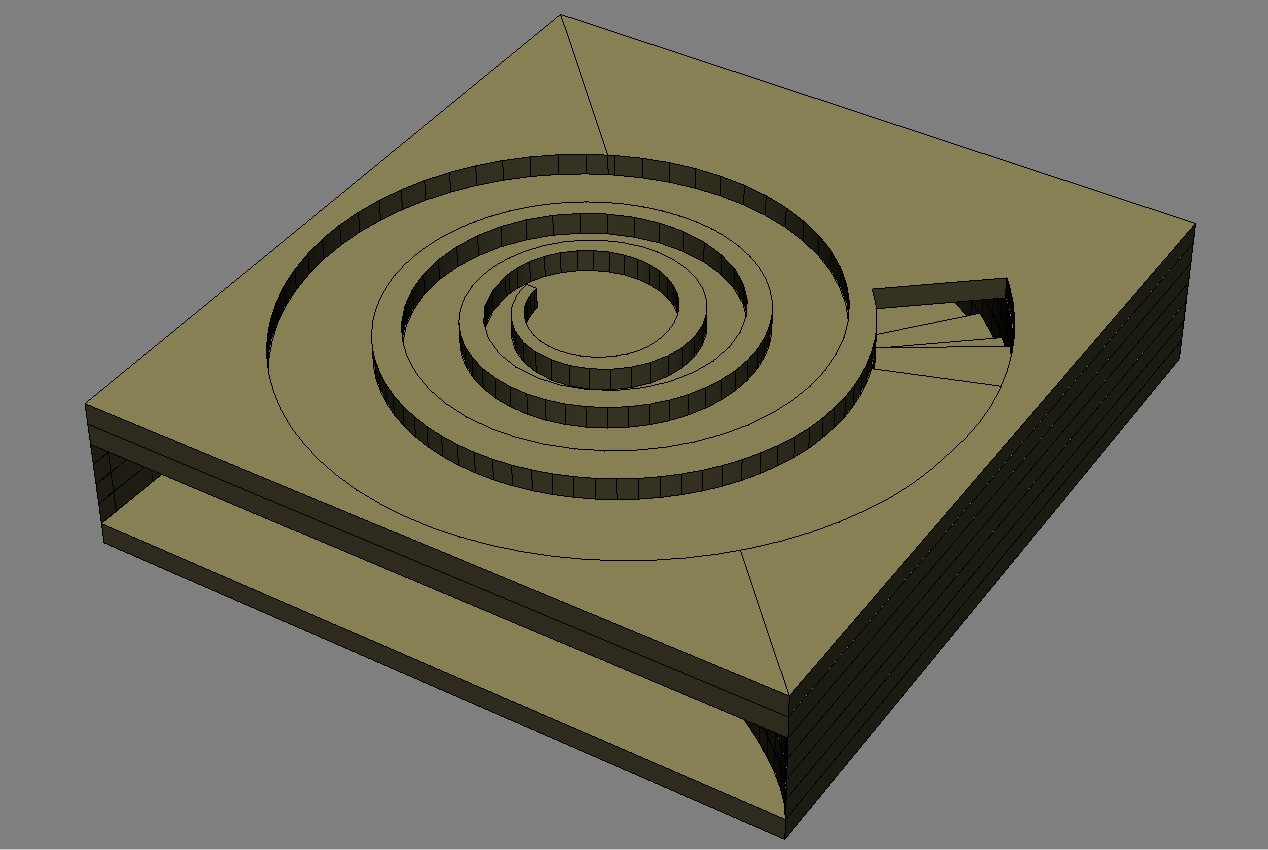

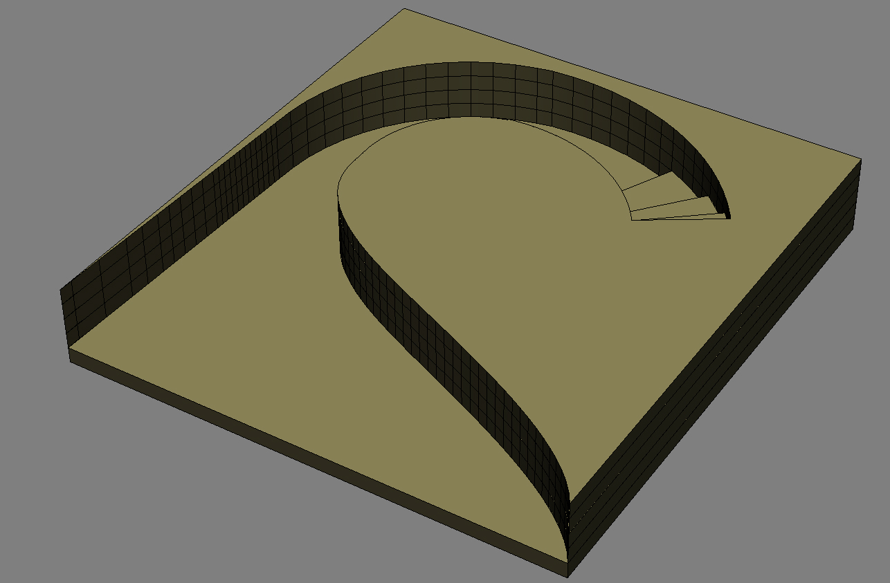

OK -
After fighting to keep the overall size low and weight down, I came up with a way to push the horn down through the layers and emerge from the side in lower layers so I still get a big mouth without a big baffle. This is about 15" square, and uses a 3" driver.
The horn goes from 0.5" in the middle to almost 15" at the mouth. The midline of this horn is about 90" long.
xrk971, is this better?
Other thoughts?
Colin
Other thoughts?
Colin

XRK -
There is enough room in all the layers of plywood for the cylindrical opening behind the driver to be deeper and higher volume.
In my current design this open space is ~3" in diameter, and the spiral section is 1.5" deep - 3 layers of 1/2" plywood.
All of the open areas of the the lower layers are outside of this area, so it would be possible to extend the depth of this cylindrical area behind the driver up to 6".
Is there an advantage to making this chamber directly behind the driver have higher volume? I can make this volume 2x bigger without changing the design, the horn dimensions would stay the same.
Make sense? Thoughts?
