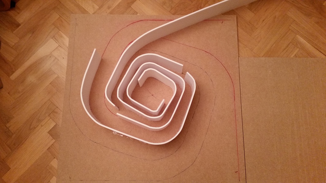

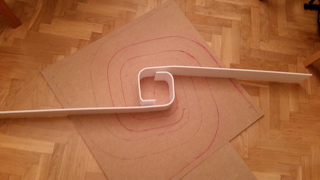

So I read the first 24 pages of this thread, but didn't find much on how to actually build these things. I suspect getting the first two (opposite) foam strips in goes okay, as there's plenty of space to work.
But how do you get the other strips glued in, with such a narrow working space?
Will a hot-melt glue gun nozzle get down into there, and then I just lift the strip slightly and put some glue underneath, or what?

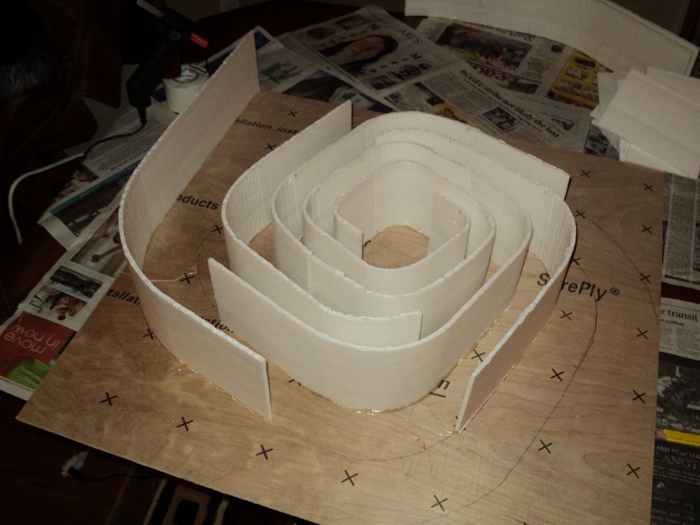

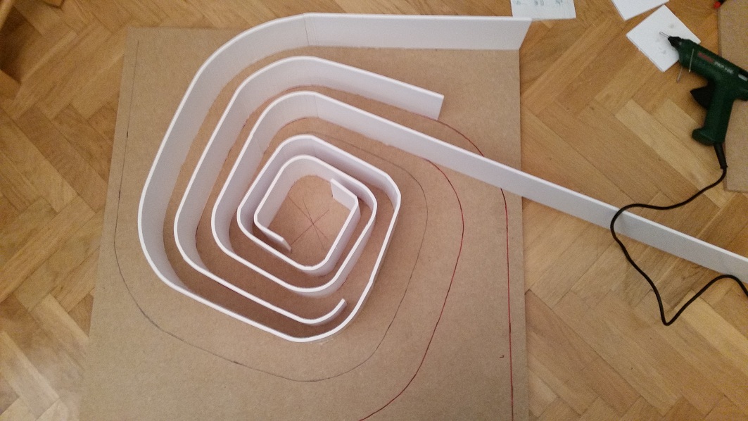

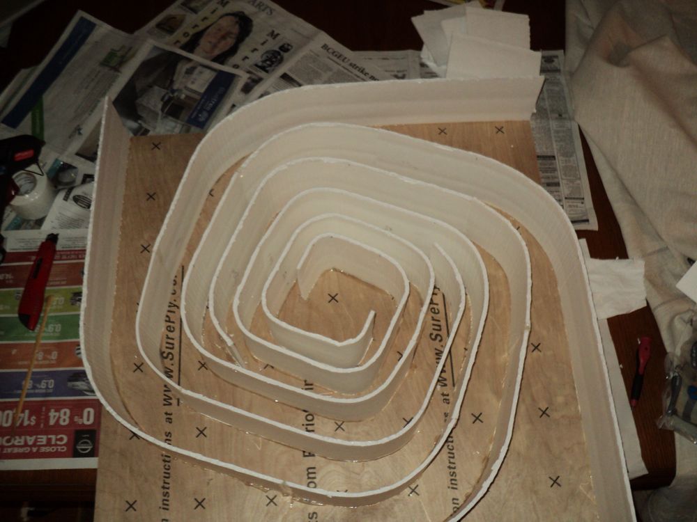

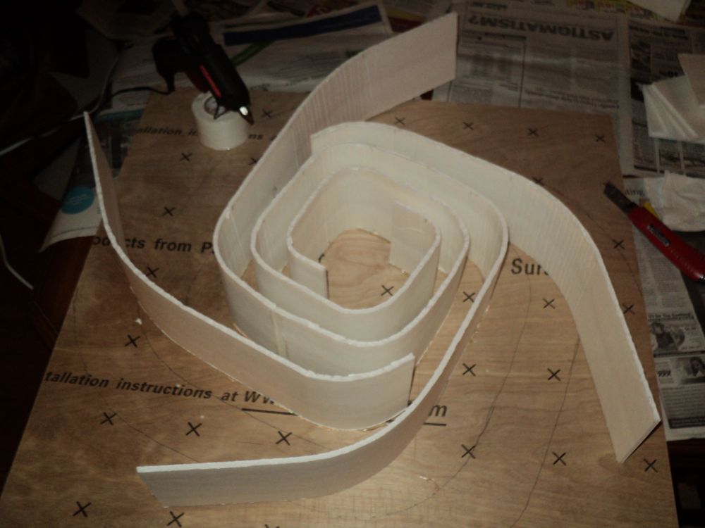

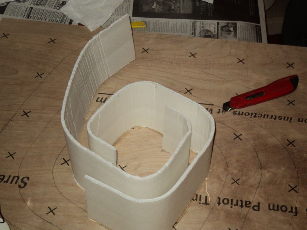

Work from inside spiraling out otherwise you can't get glue gun in the narrow channels. Little self contained BT speakers are really cheap now and would make a great cornu for use as MP3 player that is wireless. Just need occasional charging with 5v USB jack. Just need to take one apart - they have 2in drivers with pretty good bass and at least 3 watts.
The first narrow section from driver is only 2 channels. After that it is wider and easier to work with. But section by section is the way to do it.
Like this:
You'll notice in the 3rd pic that I started at the end of the horn and filled in the last part after. That's so there wasn't a little piece near the end of the horn. This is the 27"

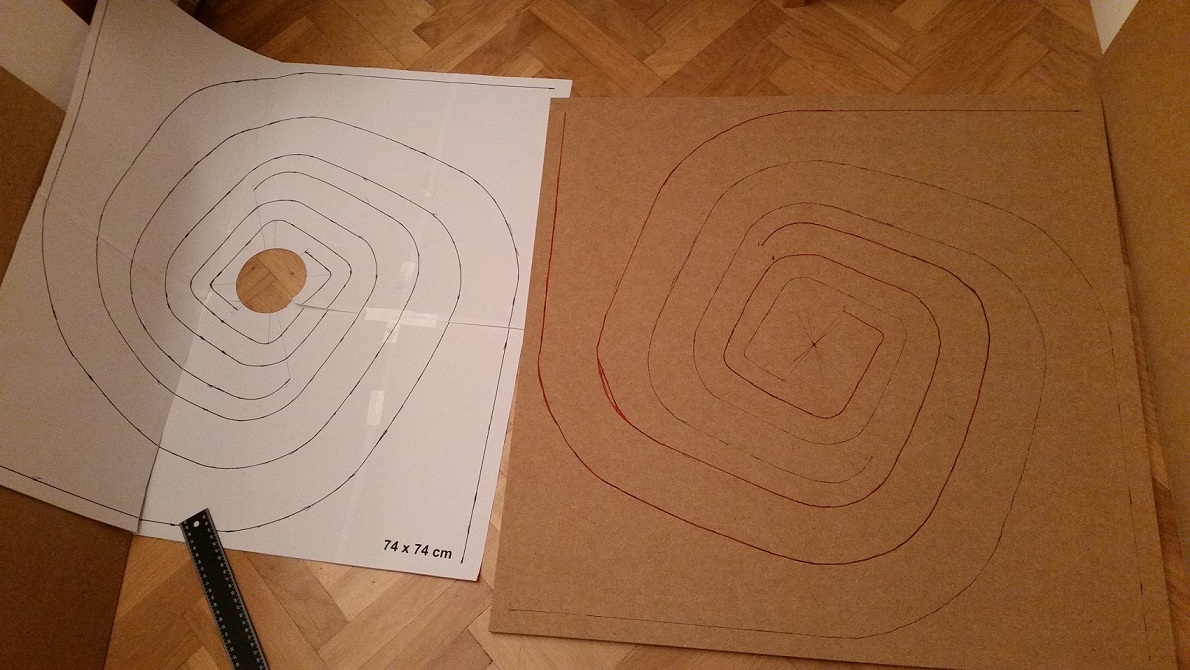

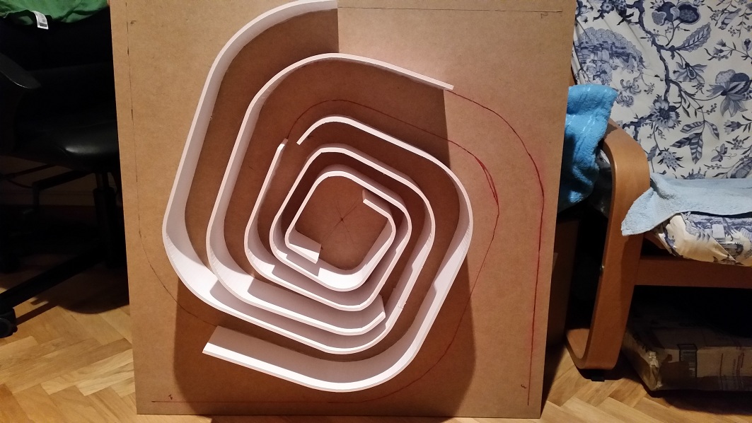

So up to now I've finished first Cornu and working around the second.
Here's some photos.
A couple of questions :
1) what do you use for "stuffing" and how do you distribute it inside? Are there any photos?
2) About fixing the front : I'd like to screwdrive instead of glueing so if I need adjustement it would be easy; what is your experience / warnings ???

Maybe useful put in the first post that foam name in Spain is "caton pluma" so if any other Spanish wants to try them will be easier.....
