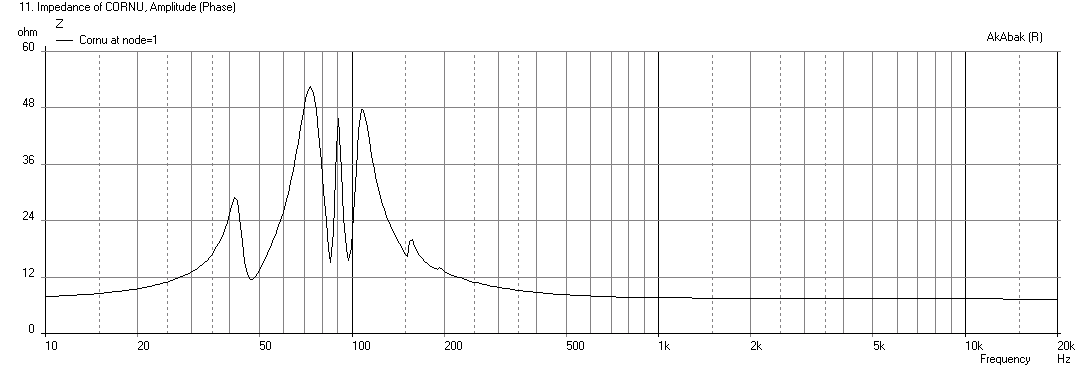

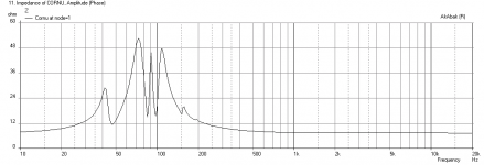

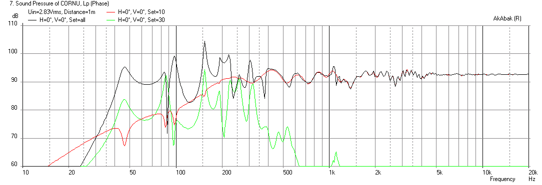

Here is a sim of the FE103E in a 40in x 4.5in Cornu, mounted at 1.2m centerline from the floor. Looks pretty good with deep 45Hz bass extension. You may need a tad BSC to tame the HF.
Here is the impedance:

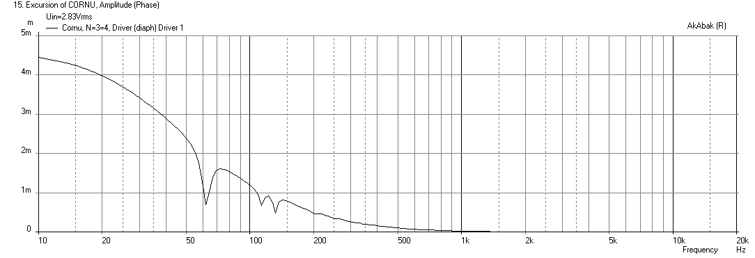

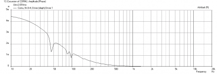

Here is the cone displacement - you may run into over-excursion here.

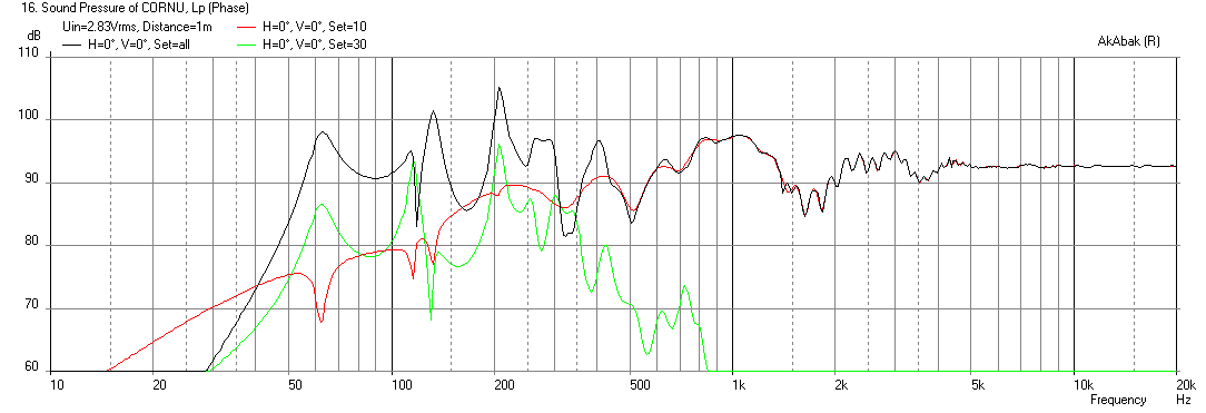

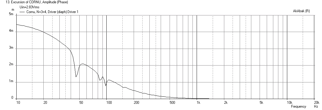

I think if you made a typical 75cm wide (29.5in) x 4.5in deep Cornu, the displacement goes to about 1.5mm at 70Hz and you get a higher level of bass amplitude with bass extension down to 55Hz:

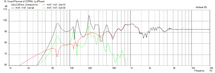

Here is freq response of a 29.5in Cornu:
My recommendation is that you make a smaller 29.5in for your first Cornu and look for a bigger driver for a 40in (like a 6.5in full range). It's a lot of materials and extra work to make a 40in vs a 29.5in.
You can go with the 40in but be careful with cone excursion and don't play it with music that has low freq content at high volumes. If you have an active EQ, you can limit the content by high passing at 50Hz or so.
That's great. Thankyou XKR971
I really like the smoother response in the 40 inch simulation, but can see the excursion problem as well. I suppose I could add in an active high pass stage to protect the driver.
