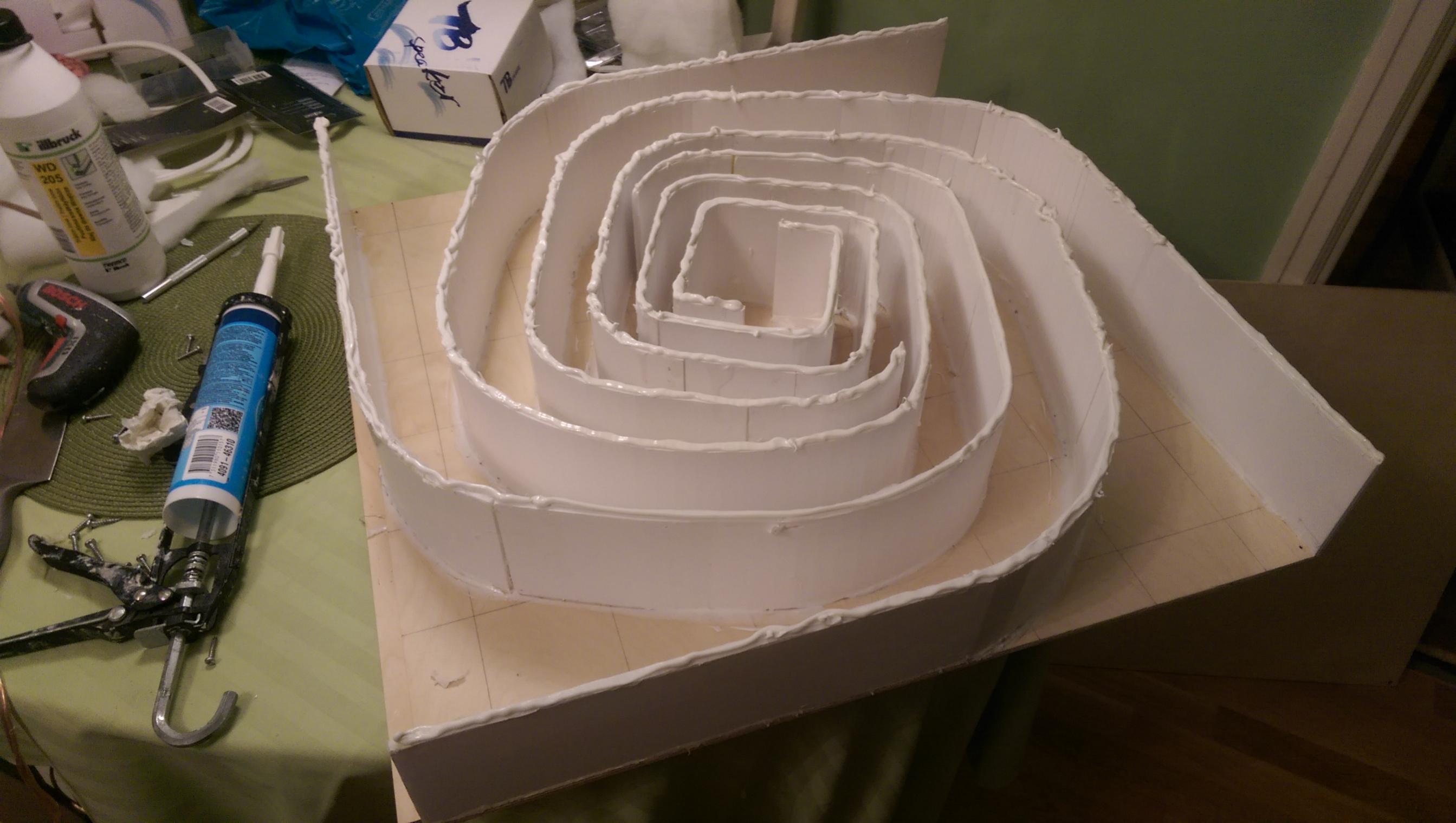

I laid the cornu on the floor and put some weight on the baffle over the night and it got a bit better, but nothing substantial. Eventually, I took a knife to it to try and separate the baffle. There was a lot of dried wood glue on it and looking at it now there's nothing obviously wrong (apart from the missing baffle, of course). The channels look of reasonable even width. I've reattached part of a channel that came loose when pulling the speaker apart and I've caulked along both sides of each channel on the back, to make very sure there aren't any leaks. I'll let that set and then caulk the hell out of the top of the foamcore before reattaching the baffle.

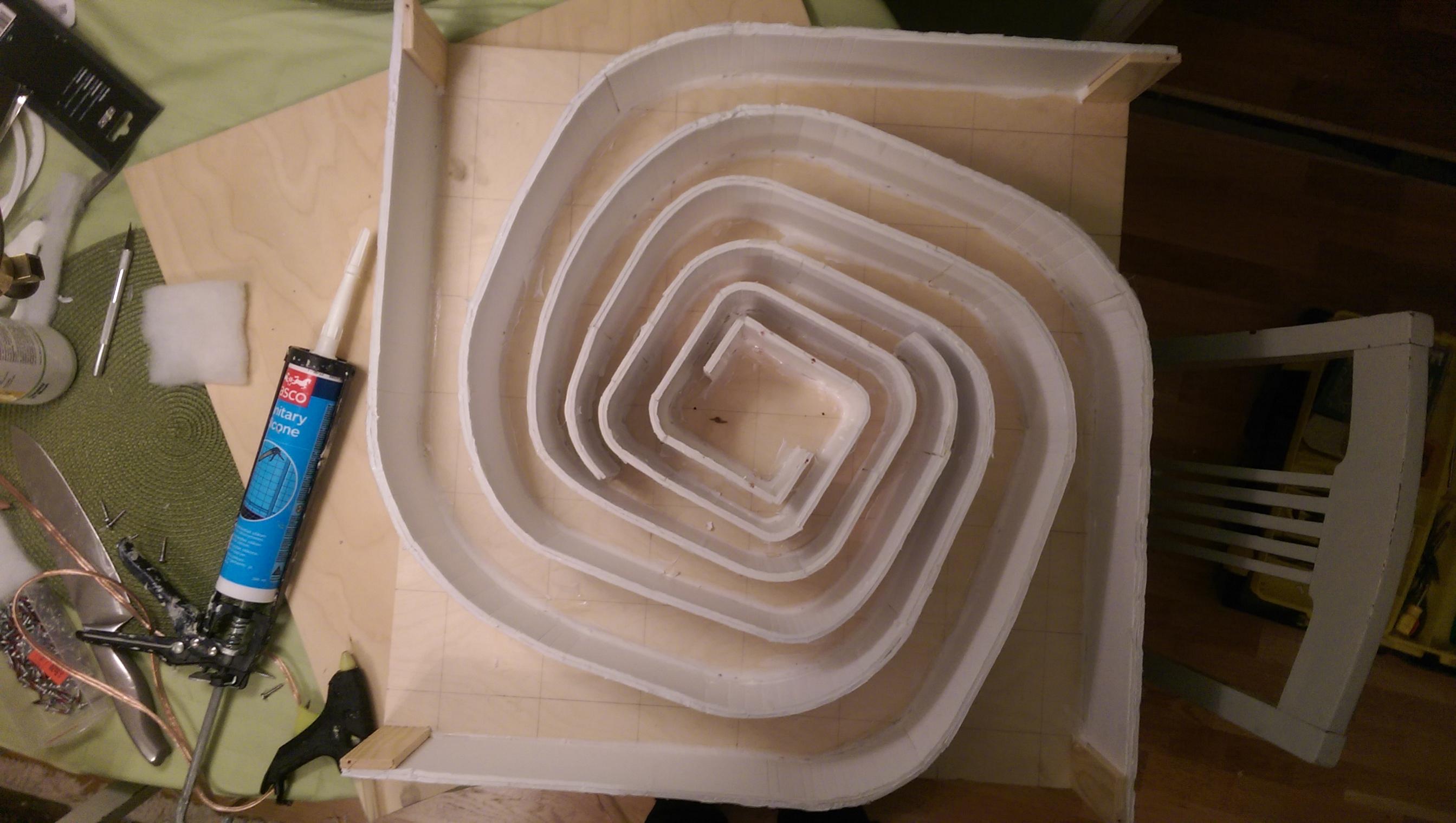

Cal: I'll get a picture up of how it looks at the moment. Maybe there's something obvious that I'm missing...
Here's a top-down photo of it. It's 24,5" x 24,5" x 4" for a TangBand W4-1320. Caulk for the bottom seems to have set, so I might seal it up again and let the baffle set over night.
It looks good. Are those double layer channel walls? How were you able to take the baffle off so cleanly after the glue dried?
Yep, I only got hold of 3mm foamcore, so I doubled up. I glued the first ones together using wood glue but the latter are with hot glue, since it was just soo much simpler.
I got the baffle off using a knife, force and luck, I guess. I've now removed the wooden supports, to make sure they're not too long and inadvertently keep the front and back apart. I want to make sure any weight I put on it helps to even out any differences in channel width by forcing the higher parts down to a common height.
ok X, I don't see what's up except maybe the top panel gluing leakage that we can't actually see. Maybe there's an over-stuffing of the driver chamber or something else you can think of?
Well, I sealed it up yesterday evening and let it set over night. This time with sanitary silicone and without wooden supports. The result is quite a lot better. The caulk won't have hardened completely until after a couple of days, apparently, but there's no movement in the structure of the speaker - back has about 18 hours and is also hot glued, front has about 12 hours and is held in place only by the silicone. Now, depending on song, I can get close to wall-shaking action from this one, which is nice. Nice enough that I'll make sure to finish the second one as well, at least.
