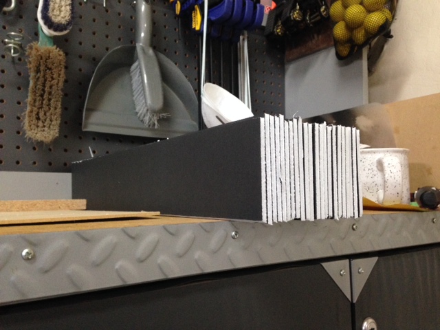

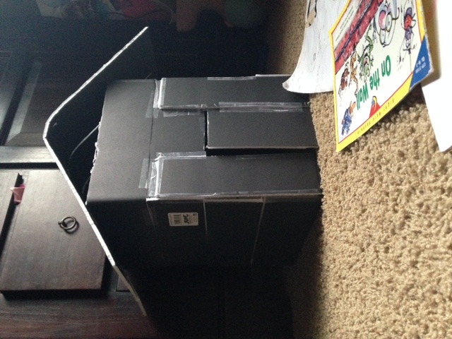

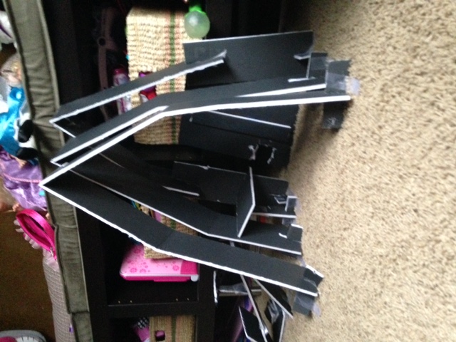

Just to document a little progress, and an excuse to post a pic or two:
1. Initial foam cuts, I was doing this with a scrap piece of particle board as my guide and am using a typical thick-bodied utility knife. So, I wasn't able to be as consistent with the angle of the blade and all of my cuts and I knew it. First pic sort of shows the variability of my results - quality control fail #1.
2. Another trip to HD and I picked up a monster aluminum adjustable t-square. It can rotate and lock at 90-degrees and it's big enough to accommodate anything I'll ever do (I do a lot of projects and have needed something bigger anyway over the years - why I waited this long is a mystery). Once I got that home and did some more cuts, much better results (and a lot faster to use as well). Still nowhere near mechanical consistency in nature (a planar would be nice to have to knock 1/8" off what I've got for true accuracy) but I'm satisfied and know I can make these work.
3. Still being without facing boards I'm happy with, I took a different tact and switched priorities. My youngest daughter and I built some Barbie houses with the inventory of pieces from my initial cuts....she's happy and we had a good time.
O yeah, the black foam board I've got - the black paper is really not an issue at all. I played with bending the bejezezus out of several pieces and that paper isn't coming up/off/anything. Should be fine for my needs, phew!

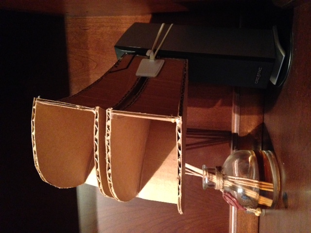

Spirals ASAP, can't wait to get the hot glue gun going (been years since I've used one). Last time I did a speaker project with hot glue, I built horns for my PC speakers and they're still in use (love 'em!).
