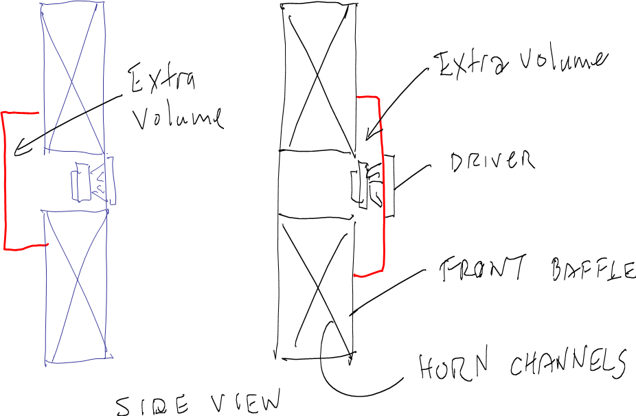

hi XRK can you provide a sketch of this ? ThanksWe have all been playing with the base design for some time now, with some of us willing to venture into uncharted territory. I have been thinking about how to improve the sound quality of the Cornu as it appears that a lot of mid-bass is leaking out. In a conventional BLH, the most effective way to acoustically low-pass filter this is to have a larger driver chamber with a throat. The current Cornu has a throat but a very small driver chamber volume. The ratio of the throat area to the chamber volume sets the low pass cutoff frequency. So what I think can be tried is to add a sub driver chamber either on top of the existing one in the front, or in the back next to the wall in order to expand the volume by 4x to 5x. My sims show that this will significantly reduce the mid-bass leakage and smooth out the peakiness of the main bass response. If anyone wants to try this I can post some sketches of a proposed modification to the current design. It is an easy 'after the fact' mod to your existing Cornu if you want to do some foam core surgery: cut a hole a little smaller than the existing driver chamber on the back panel, make a thin, say 1 in deep box that has 4 to 5 times the volume of the existing chamber, fill with stuffing and glue onto the back of the speaker.
Thanks xrk.. With extra volume at the rear panel this would mean a circle hole of similar size to the front panel driver hole needs to be made?
Do you think 5mm plywood would be sturdy enough for the front and rear panels?
Also what would be the estimated dimensions of this rear box to get 4 to 5 times of the throat volume?
I would do the extra on the front or the box won't load with the wall as intended.
Plywood can be as thin as 1/4". It is well supported by the foam core.

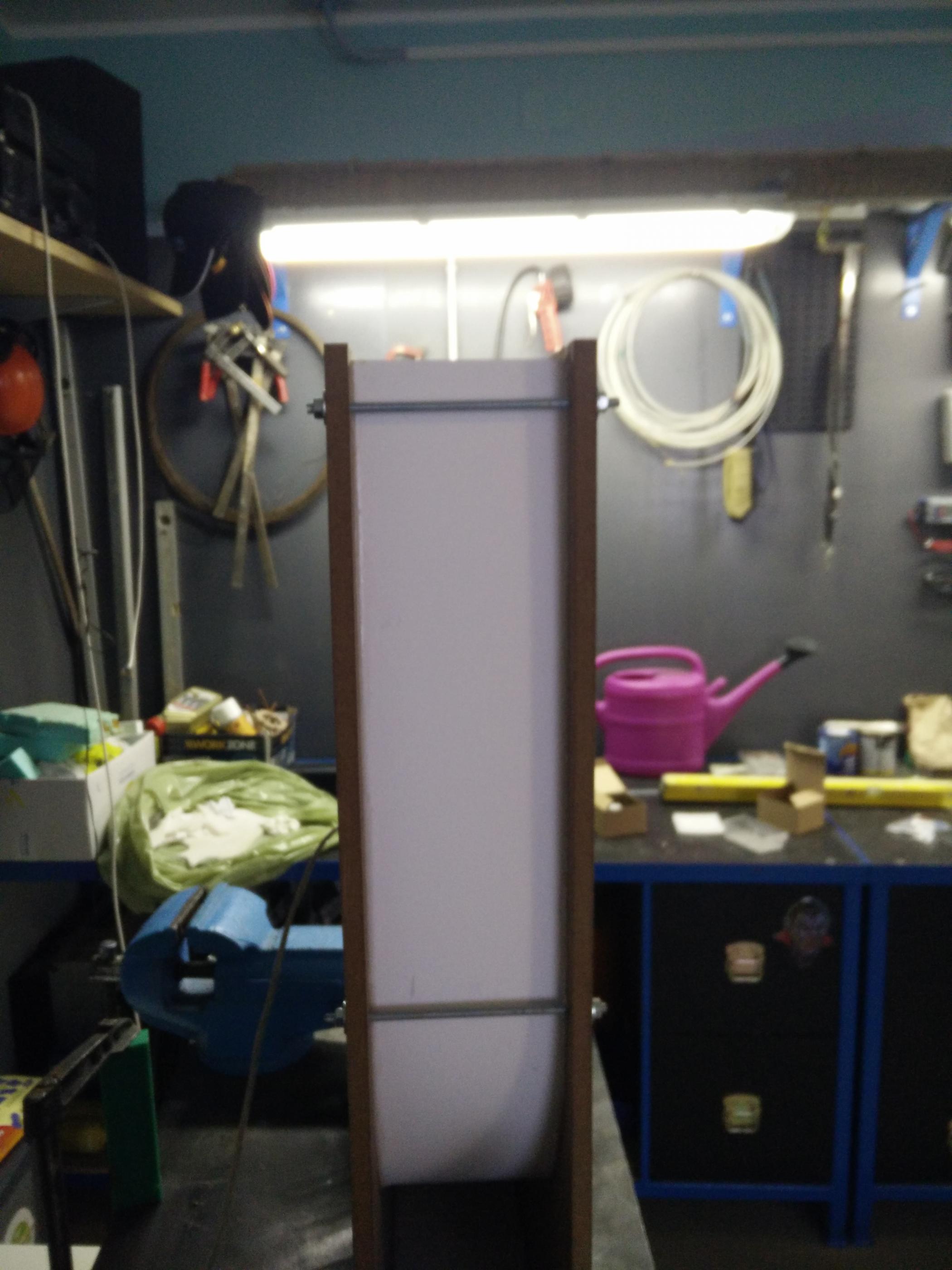

FYI - I am building a 24" cornu dipole / bipole, with drivers on both sides.
4" thick.
I have tried both flipped polarity series and normal parallel connection of both drivers. The drivers are Chinese from Ebay. I am told they are called Guide Sound 4" drivers.
The wave guides are 1/4" bendy mdf, some of which had to get a brief soak in water to bend enough.
I have not yet glued the front on, it is only clamped at the moment.
I hope things tighten up when I glue it all together.
I had to add 6"x"6" 3/4" ply baffles to move the drivers far enough apart to not touch in the middle.
I will report back when it is glued with how it sounds. So far it sounds pretty good, but not enough impact to the low frequencies.
BTW, this is my first experience with a full range driver speaker.

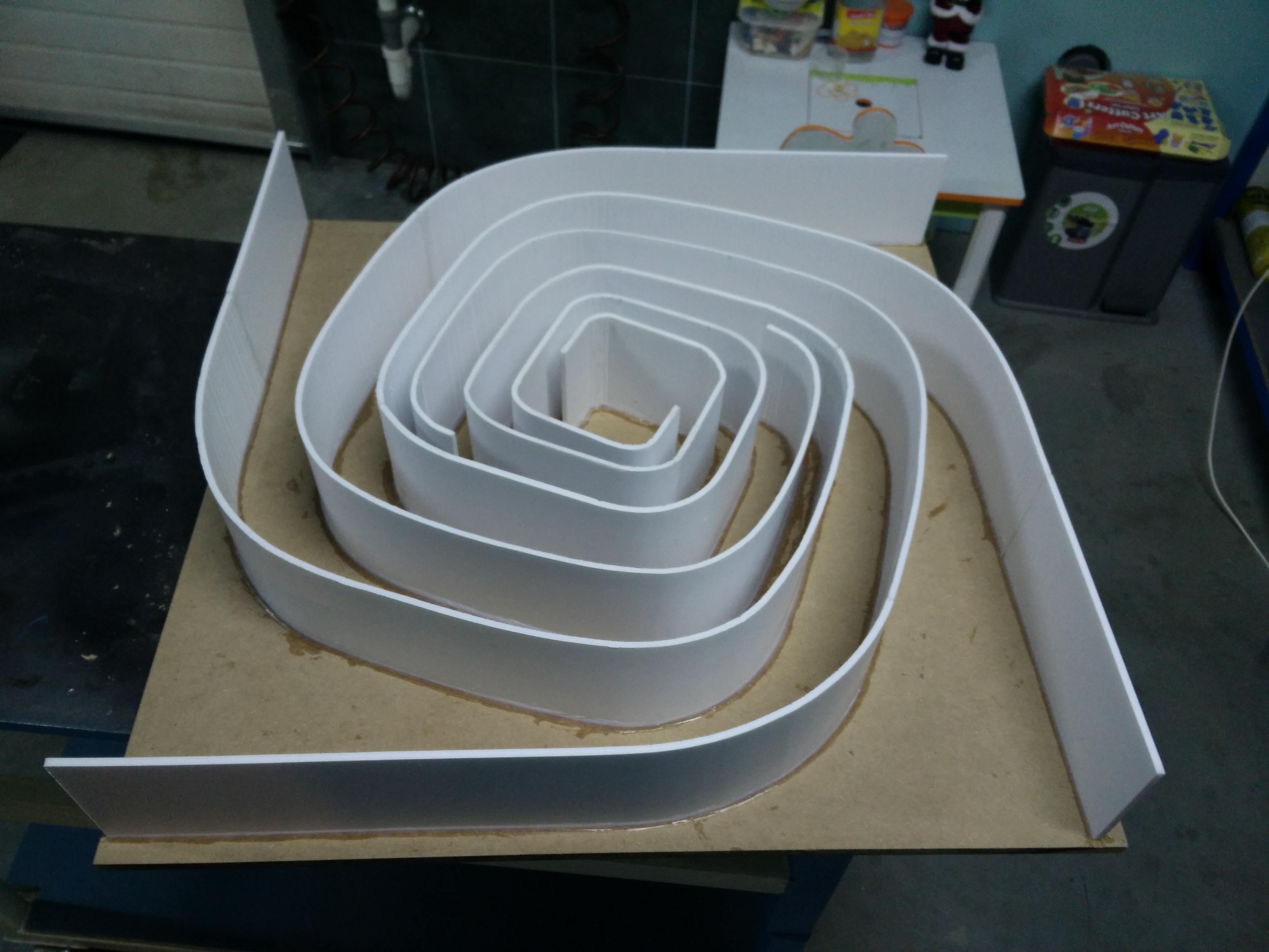

I went with the 3fe25. Here is the first spiral finished:
Too bad foamcore is so damn expensive in Sweden, the cheapest I could find was 5 usd for 50x75 cm (20x30 in).
/Anton
/Anton
Nice work Anton. The $5 a sheet is reasonable as that looks like the nicer thick stuff. In USA, thicker Elmer's brand is $5 to $6 a sheet. Only dollar store carries $1 per sheet but that stuff is very brittle and light.

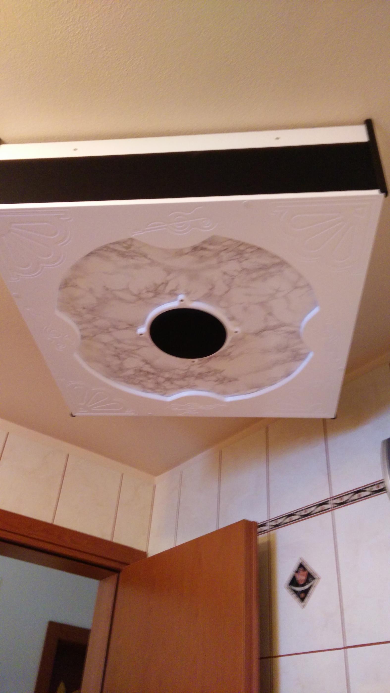

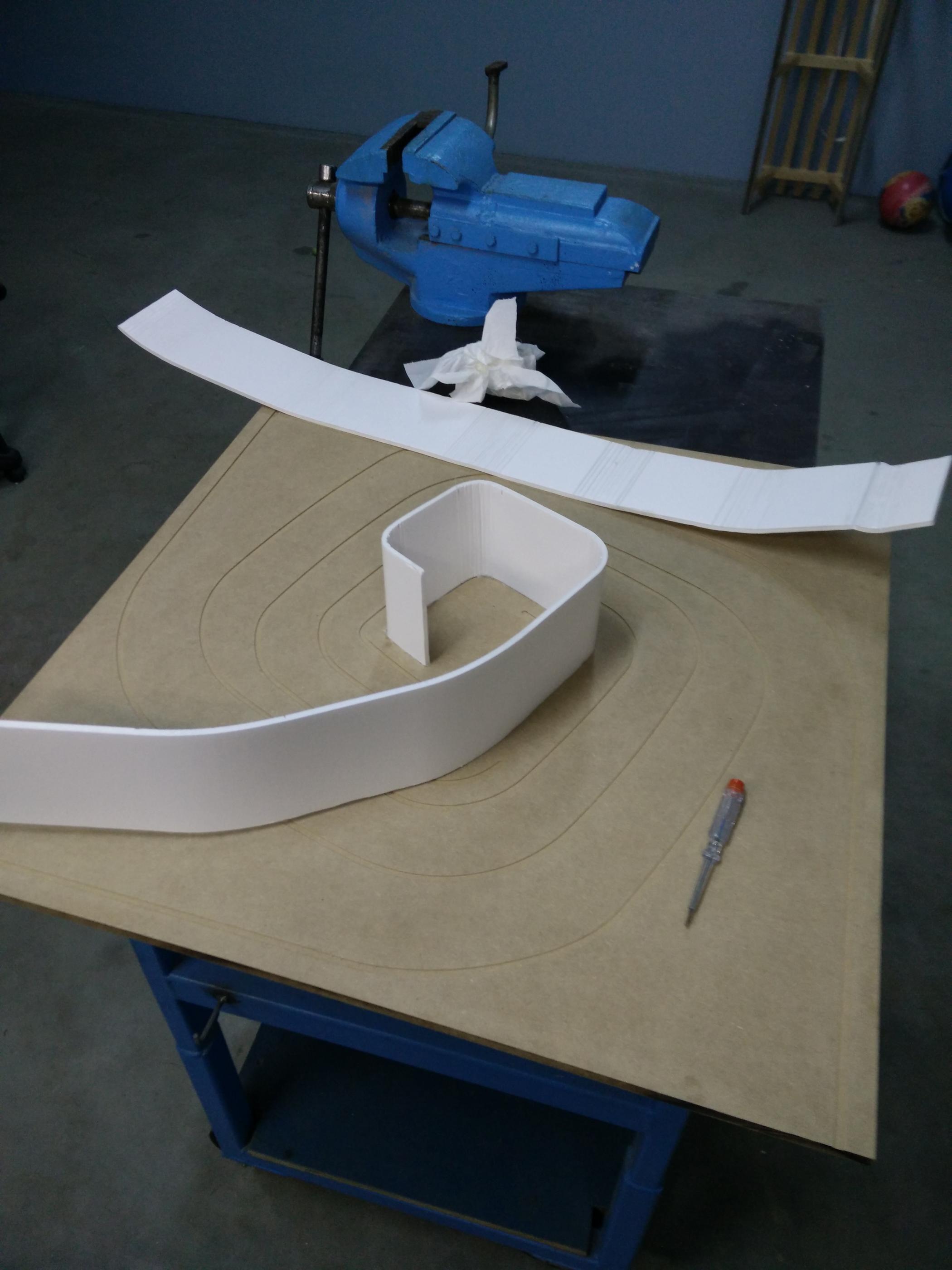

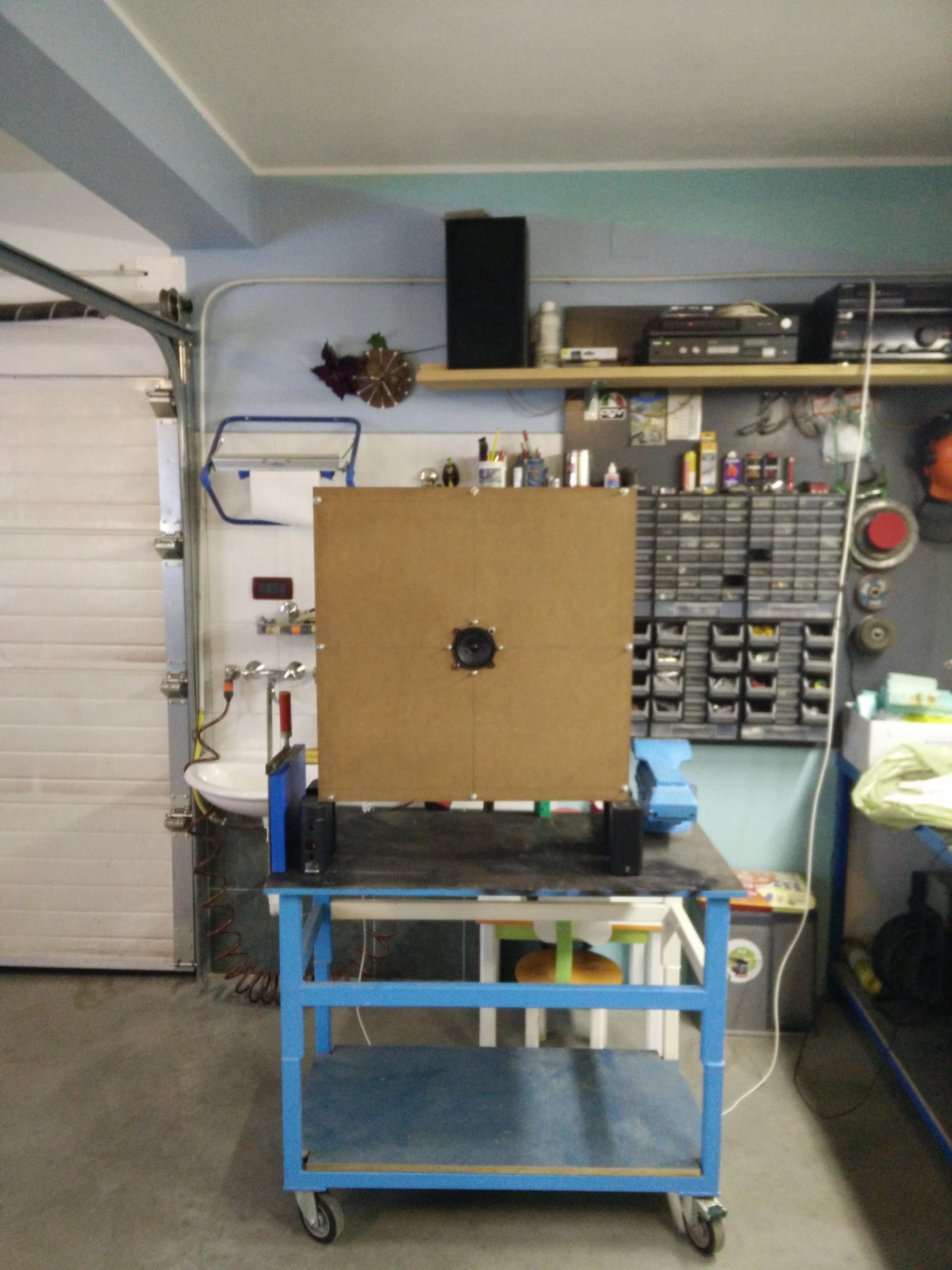

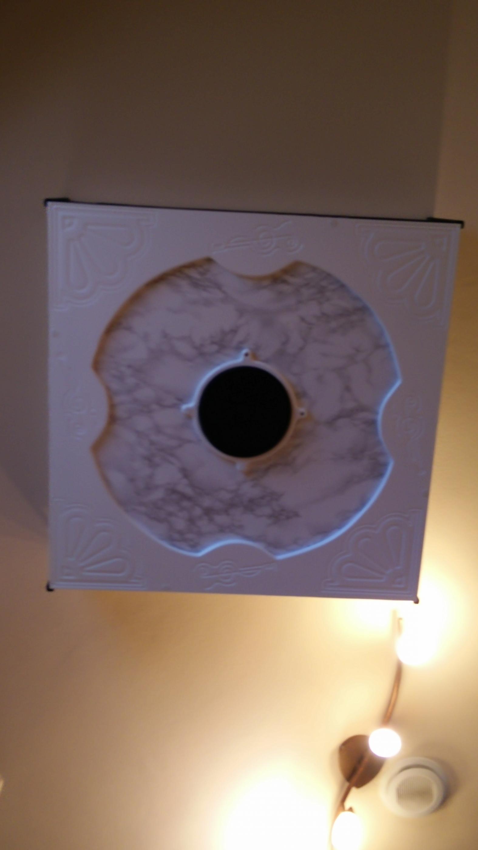

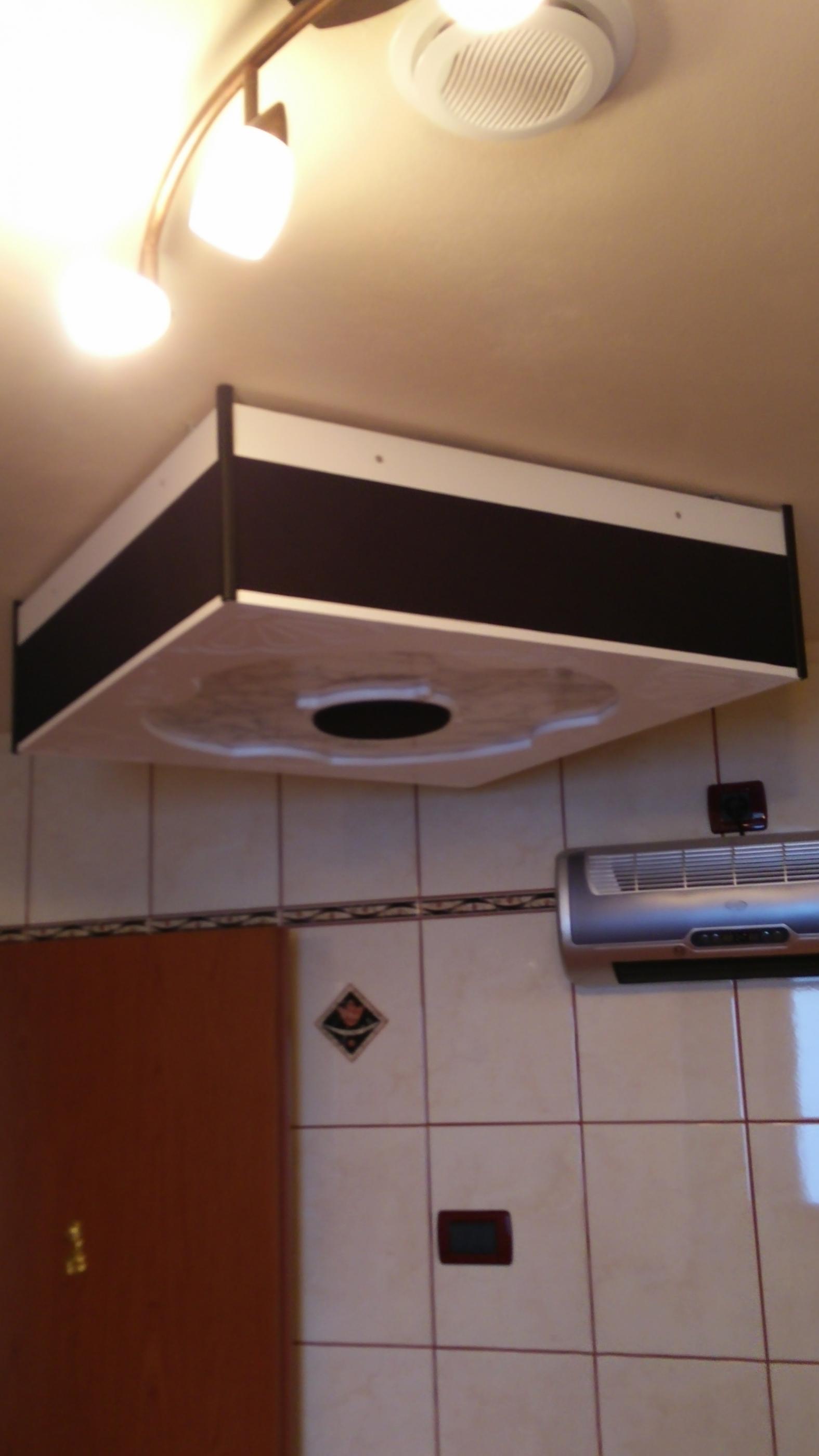

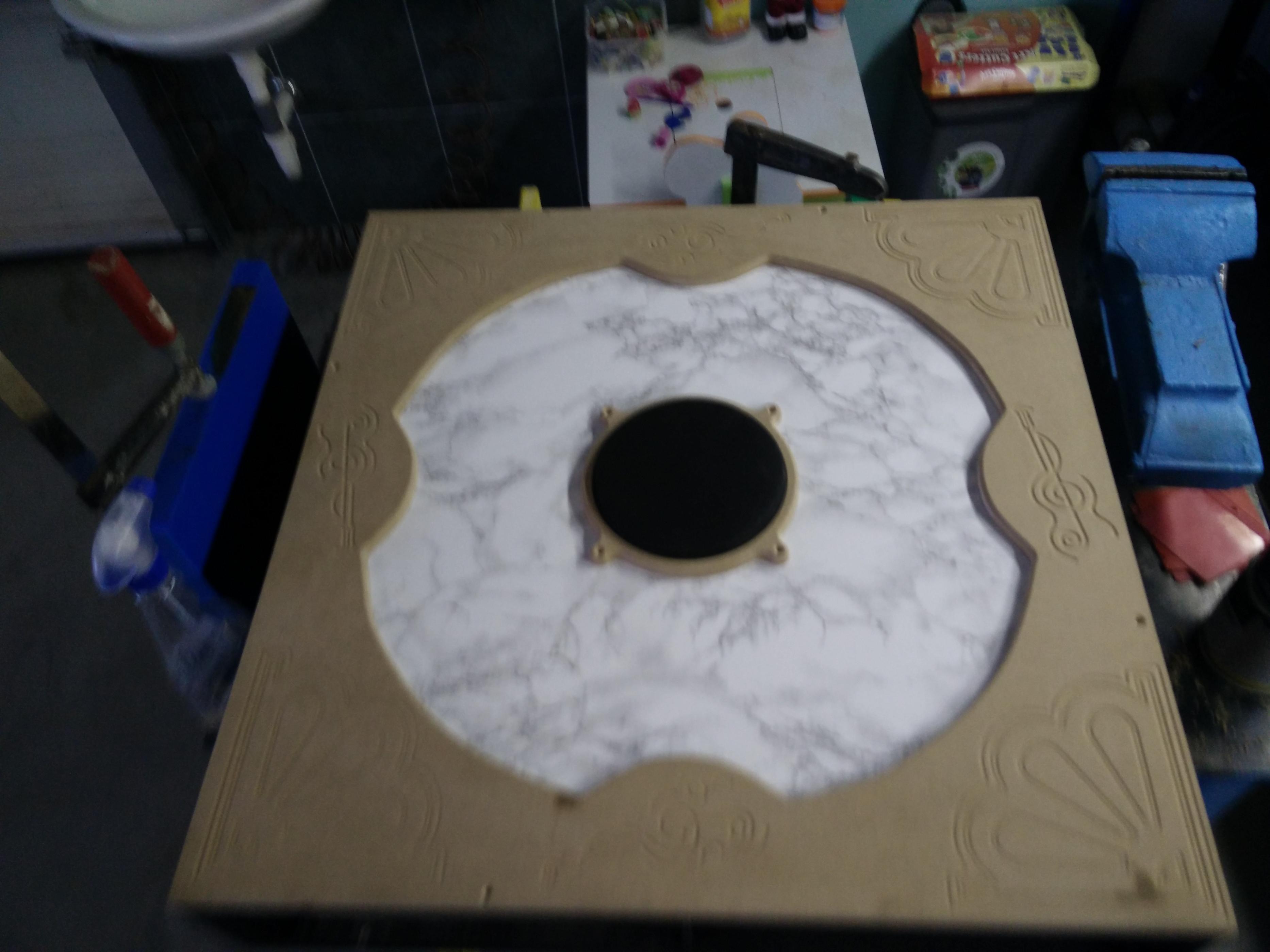

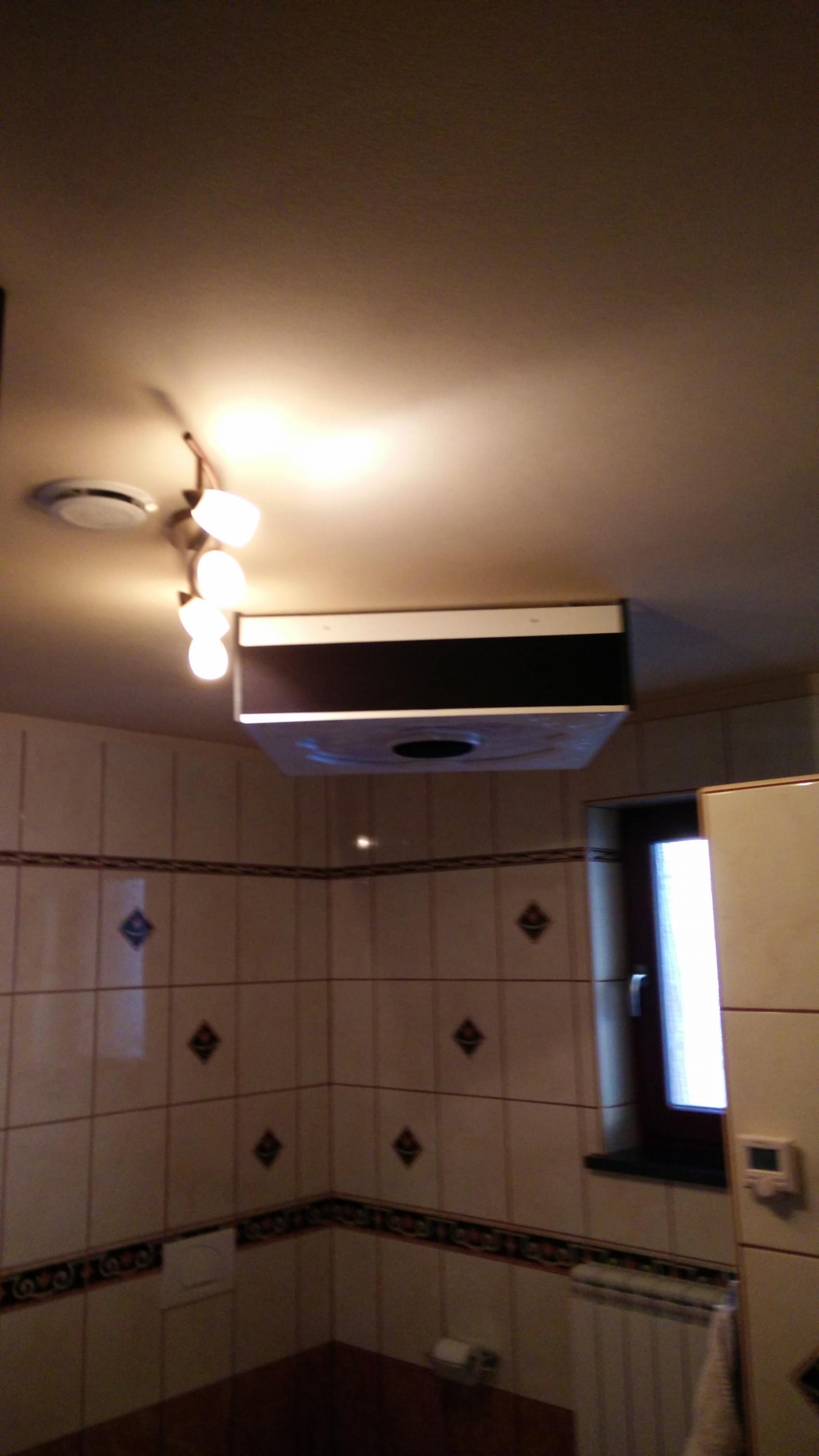

Hey guys
Well first of all let me apologize to all for late posting , especially all the the best dudes with all the great help you provided through this forum.
Well here the pictures of my cornus.
I must say i'm surprised with the quality of sound an the amount of bass coming from a 100mm driver.
They are placed in the bathroom on the ceiling and there was a noticeable drop in sound quality when they were placed in the place where they are now.
So placement and room are playing quite an important role in quality of the sound of these speakers.
If anyone has any questions about my build, do not hesitate to ask.
Greetings
Aleš

Very nice work! The first ceiling Cornu I have seen so far
Is that a 4FE35 or 4FE32? What are the dimensions (width and depth)? Did you do the decorative millwork for the front baffle cover?
Thanks for sharing.
Thanks for sharing.
Thanks for the compliments.
The drivers are the Faital Pro FP4FE32A.
the depth of the horns is 100mm (4"). The dimensions of the bafle are 740mmx740mm. The dimensions and the choice for drivers are made by following your advice a few month ago.
Thanks man.
Yes, I did the milling.
The speakers still need decorative stickers on some bolts, so the project is not closed yet ha,ha,ha.
