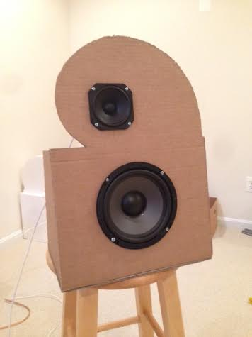

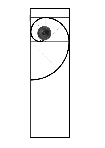

You can also make a Fibonacci spiral baffle but it will be a snail vs a flower. You might like the look of a flower more, but mathematically, the snail has probably less diffraction artifacts due to asymmetry.
That could be cool!
So, the center of the spiral is higher, and gradually gets thinner at the edges, put that on a baffle.
Would the driver be flush with the spiral, or recessed?
I'm not sure i can imagine what a spiral front baffle would look like, but I can't imagine liking the esthetics of it. I can understand the spiral for a rear loaded TL like the B&W Nautilus or your nautilos. But I'm happy with my previous versions of open baffles and cannoli-TL designs so far for the back side of small fullrange drivers.
I'm actually leaning either to try mattes flower baffle or a zero baffle like linkwitz lxmini for my next attempt.

XRK and Perceval are right insofar as that the Fibonacchi spiral is theoretically the better way to go. Please have a look at Rudolf´s work regarding dipole speakers:
Dipolplus - Alles über offene Schallwände
where you may download a compendium regarding dipole theory in english laguage. Some of that is also applicable to a front baffle design, I for myself name either dipole baffle effects and baffle diffraction effects geometrical resonances; bell modes of cones (for which your F 10 has these little curves on the backside, in order to suppress them) or whizzers (therefore the petal design of the Fertin´s whizzer, which had led me to the idea of the big flowers) fall in the same category.

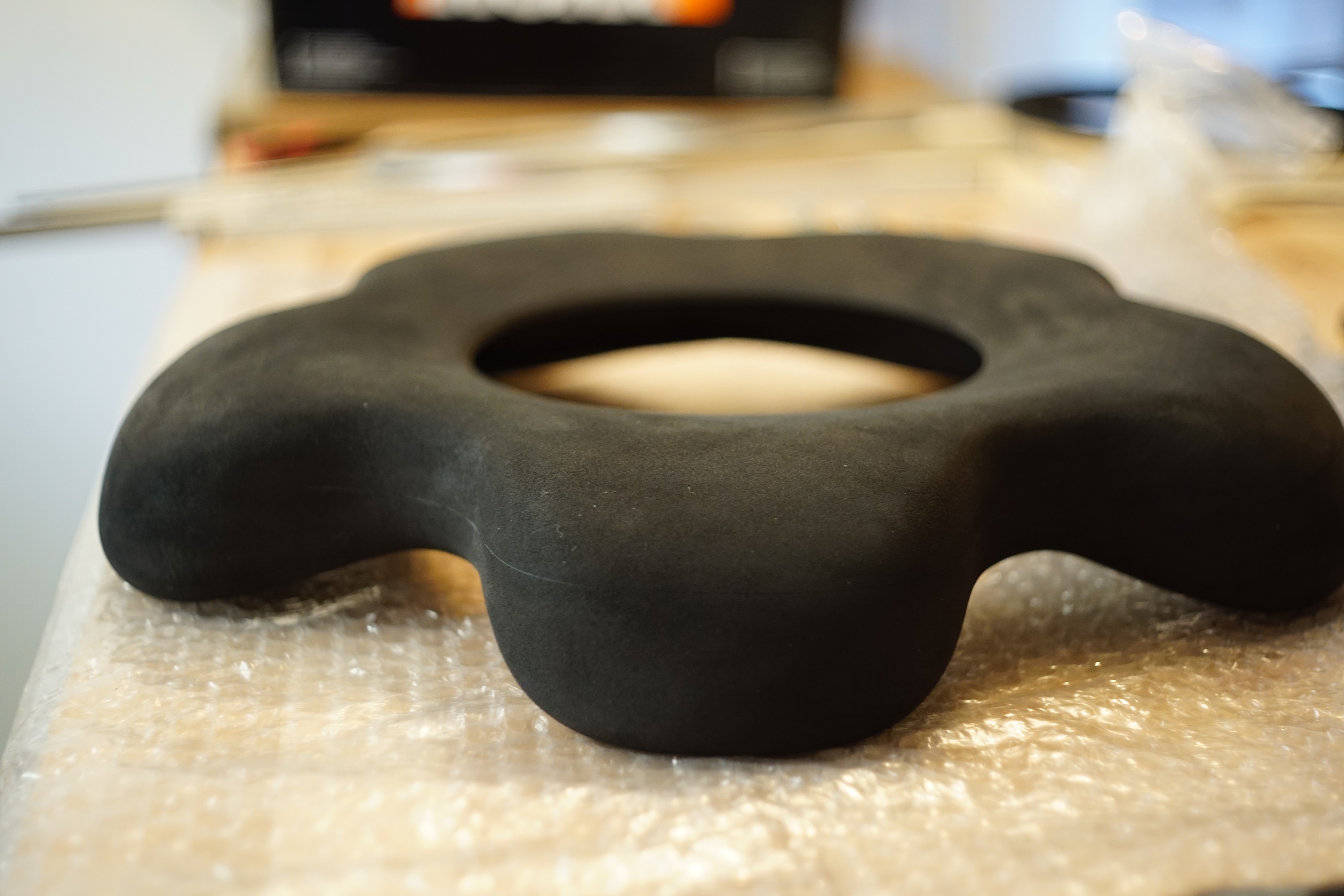

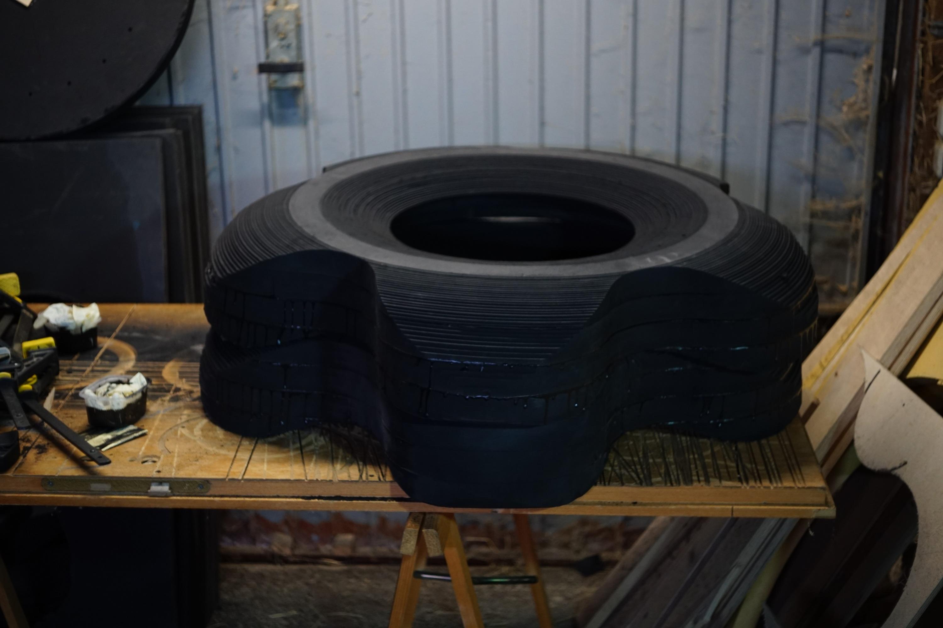

So, I was aware of the superiority of the spiral, but liked the flowers more, asthethically... but of course, if you curve the spiral perpendicular - smallest radii at shortest distance from speaker, largest radii at longest distance, this should be perfect.
However, I myself felt that making the flowers (literally hundreds of hours of routing circles in steps of 2 mm and sanding those down, and I´m not finished yet) brought me to the limits, attempting the spiral in the same way will not be easier... but of course, more simple solutions for making those baffles might exist.
A comparison might be interesting, but I won´t do the spiral, will be glad once the bass flowers of 932 mm diametre and 160 mm depth are finished...
I´m sorry, I don´t have my design sketches with me in the moment, but they´re just this, sketches by hand, sadly no elaborated 3D CAD files from my side... will share them in the (yet to start...) building thread in maybe 10 days or so from now.

However, I myself felt that making the flowers (literally hundreds of hours of routing circles in steps of 2 mm and sanding those down, and I´m not finished yet) brought me to the limits,...
Mattes
Wow... that is dedication.
Love that.
Keep it up, Mattes.
Hi Mattes,
Wow, definitely wow. That is dedication. Now I completely understand your comment about being sad if you had a cat destroy your flower like mine did.
Ok I think I understand the concept now. I'll have a go at copying this mathematically. I want to try a 3 petal version and see how it looks. I do all my EVA construction by hand with tracing patterns and then careful cutting with an exacto knife. I'll work on my design and post my progress in a few days.

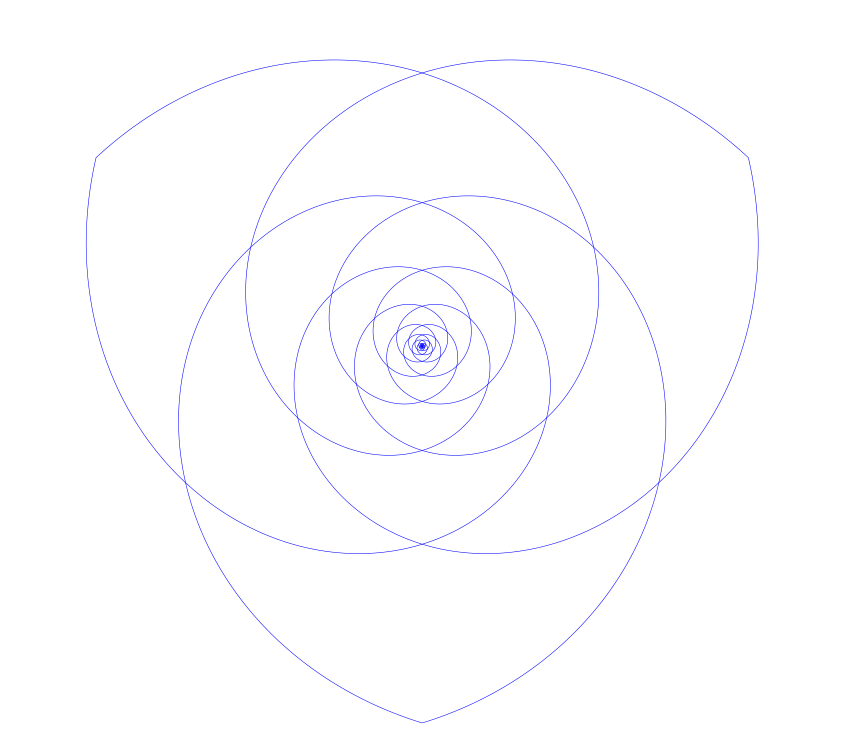

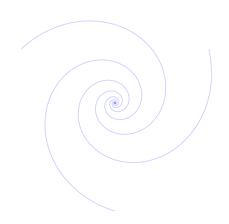

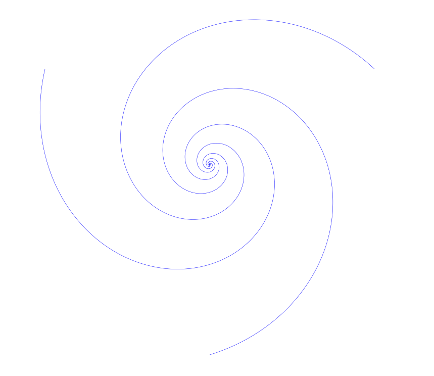

Ok here is a rough version of my understanding of mattes' Fibonacci flower (my version with 3 petals)
This rough version keeps repeating, but for the actual baffle I would only follow the paths once from the outside of the driver until they connect.
So with the flower version, there will be a few points (6 in my case) with the same radial distance from the driver.
I'll play with this a bit more, but I think this is the idea.
- take a golden ratio spiral (counter-clockwise spiral)
- then create radial symmetric copies. In my case to get 3 petals I rotate the spiral 120deg
- create mirrored version spiraling clockwise
- combine

Hi Jeshi,
of course I don´t mind, in contrary I´m happy if I could supply some inspiration!
Your 3-petal-version, if I imagine the outer lines forming the border of the baffle, looks good, too.
I don´t think that the number of petals or the exact shape is critical, as long as there´s enough variation in the distance from driver to edge, because in the end this is what counts, and a rectangular baffle could for sure have the same (positive) effect, given everything is well rounded. I think that the roundover of the surface and the edges is equally important.
With my flower design, at the larger distances, there´s a large general roundover and a smaller one (app. 15 mm radius) at the termination. At the smaller distances, the roundover is smaller, also around 15 mm.
I would have loved to enlarge this radius, but wanted to have similar ratios as the bigger bass flower has. The general ratio between the two flowers is nearly 2,6, and even if I ease up this ratio, the practical limit (at least for me and my skills) is a radius of 28,4 mm, with my biggest handheld router and my biggest routing tool. Therefore, the small flowers have 15 mm smallest radius.
The only reason for me to choose 5 petals over anything else were the 5 petals of the whizzer of the driver, I wanted to stay in this pattern.

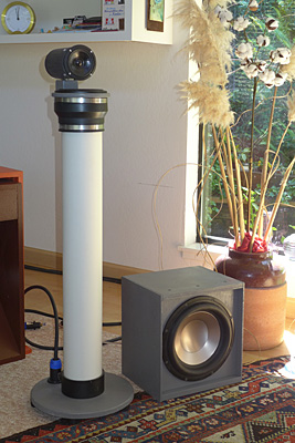

Dear all,
just forgot to say thanks for the nice words...
Please find attached another teaser, showing the bass flowers in raw form and again with a little bit more detail the roundover of the small flowers.
Yes, I know, this belongs to the yet to come building thread, and I will repeat myself there...
All the best
Mattes
All the best
Mattes

Hi Jeshi,
of course the Olson analysis is well known and still useful today, exactly. The only issue is that our drivers are bigger. Therefore I started with the angle of the cone, made a smooth curve to the largest part of the flower and voila: the shape of the petals was there. Then I added in the shortcuts for the lesser distances, trying to make them the least obstrusive. Then as well, I formed the backside and whilst trying to be least obstrusive as well, I also tried to maintain a certain thickness of the whole affair, in order not to have anything flabby...
The density of the foam is an important factor. After several trials, I opted for 125 kg/m³. The material must not be floppy (in the end, it´s an open baffle speaker, also in the bass region... and my AE Dipole 18 bass driver can move a little bit of air...) but should have at best a non-resonant behaviour as well.
A not unimportant property of this material was the very smooth and luxurious feel and look of the surface, once finely sanded. It´s like the flowers were made out of a solid block of suede... and maybe this smooth surface rejects some reflections of the baffle as well.
All the best
Mattes
