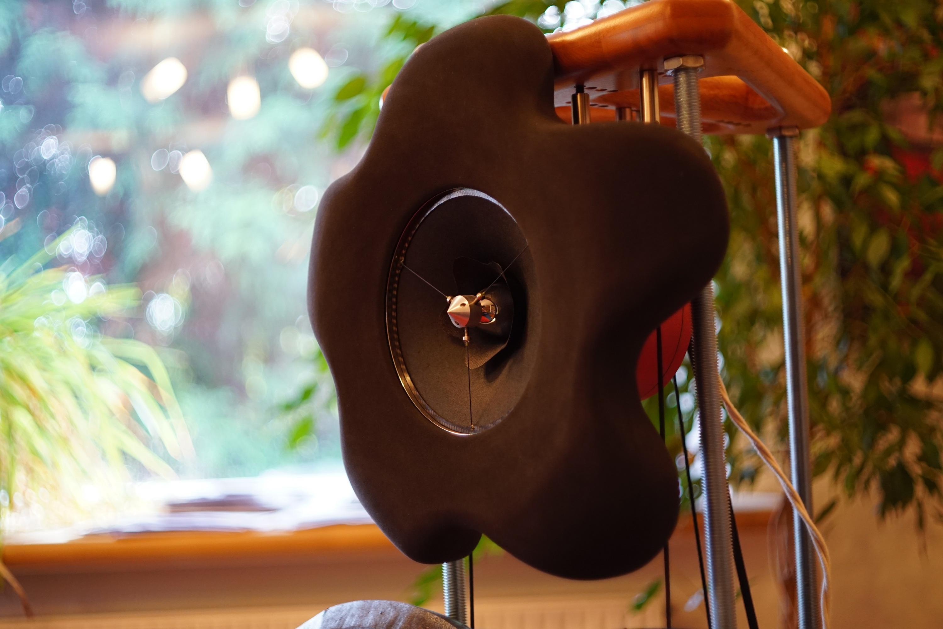

Hi Jeshi, hi all,
many thanks for a very interesting read, which, amongst many others (have been a reader-only for years...) has inspired me to try EVA foam for my OB speakers.
After several prototype builds, I´m currently building an open baffle speaker, fullrange/wideband with woofer assist, out of EVA 125kg/m³, baffles are 16 cm depth for the woofer and 7 cm for the fullrange.
The fullrange baffle is already finished, bass baffle and ceiling base (this will be a free-swinging speaker, suspended by Dyneema strings, following Michael´s theory) yet to come. Teaser photo is attached, and if there´s any interest, I could open a thread describing the built in more detail.
All the best
Mattes
That is funky and way out there!
I love it!
Please do open your thread.
I would love to know more about this... if you don't mind sharing.
That is a strange looking full range setup.
If you also have measurements to see what the petal looking baffle brings, and the reasoning behind the whole thing.
Looking forward to some reading... again, if you don't mind sharing.

XRK971, exactly that was one of the rationals for the design. It´s a form follows function design without gimmicks. The suspension you see is the front suspension of the driver. The HF whizzer cone is mounted to the coil former in a traditional way, but more details later. The petals you see at the whizzer have of course a very similar reason, breaking off the bell mode.
