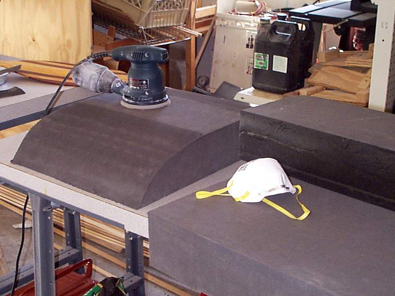

Beautiful work on the 18in flower baffle. I wonder if pink XPS home insulation foam can work here - rounded and sanded down. Painted of course. The 18in driver is quite impressive. Perhaps a double 18in flower?

XRK, I suspect that the XPS foam would work up to a point, but it is more rigid, resonant and reflective than EVA. EVA can be compressed and bounce back while XPS will permanently deform (push your finger into XPS and you get a hole). Although I don't have XPS to test, I suspect it is more sound reflective than EVA (sound will bounce off it) based on my memory of being in a construction with exposed XPS and the terrible acoustics of that space. The EVA foam is a good sound absorber (not best or perfect, but pretty good).
I think some of the benefits I hear (and I assume Mattes too) with the EVA baffles is that it acts to absorb reflected sounds, so even on the edges of a baffle the EVA is adding additional absorption. Also the EVA is vibration dampening so for something like a big 18" driver pumping out bass, an EVA baffle will not rattle and resonate, but I suspect that an XPS baffle of the same design would create a rattle and have a resonant frequency/buzz which would add color back into the sound. I suspect that Mattes previous experiments with wood baffles was showing a resonant rattle color. So yes it would be an interesting experiment but I don't think it would work well and given the effort needed to create an XPS baffle of this design, I don't think I would try it.

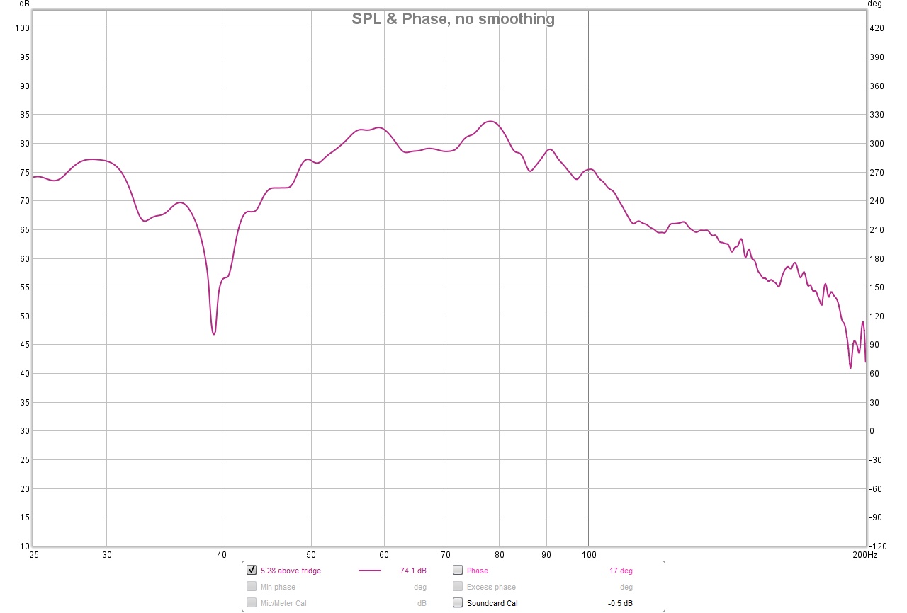

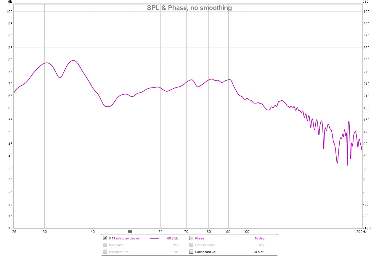

mainly a room node around 40-43hz that sucks energy and no matter what I do for treatments or positioning has worked to resolve it.
At 41.5Hz we're talking an 8.19 meter wavelength. Your acoustic treatments would have to be quite large and cover a decent surface area to begin affecting that. That's why nothing has worked. Even tuned treatment like a limp membrane or Fraunhofer metal panel absorber would have to be large. We're talking 15.24+ cm thick and 2.4meter by 1.2 meter, and preferably multiple of them. What you can though, is attack it from multiple angles, aka distributed subs. I haven't seen that approach on this forum as much but several subs distributed around the room can blast those modes away, but still end up with the same overall SPL levels. Distributing like that you can also get away with many smaller subs that add up to same Sd as a larger one. I can post more on this if people are interested.

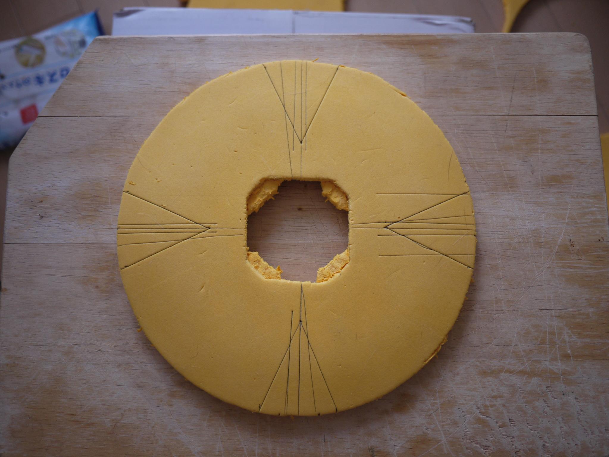

For what it is worth I use an exacto knife for most of my EVA cutting and shaping followed by lots of wet sanding. But a jewlers saw is a great tool to have around.
about my room. you have to realize that this is a small Japanese rented apartment where my living/kitchen/music room is about 8m x 4m and that holds my sofa, main stereo, kitchen, computer space, diy speakers, 88key piano keyboard, dj rig, harp, bicycle, cat tree, litter box, record & cd collection, book shelves, storage boxes, every wall has something covering it, and there is a little bit of free floor space to walk around and set up a yoga mat. All the treatments you suggest would probably take up 33% of the space in my living room and I honestly don't know if it would actually fit (maybe if I take the stereo out lol). I don't want to loose that much of my precious space to try to fix this room node.
So I am happy to just live with it and hopefully when I can afford to buy a house I can find a place with better room acoustics. I am happy to have good extension to 45hz and then a surprise 30hz boom every now and then. I can live with it.

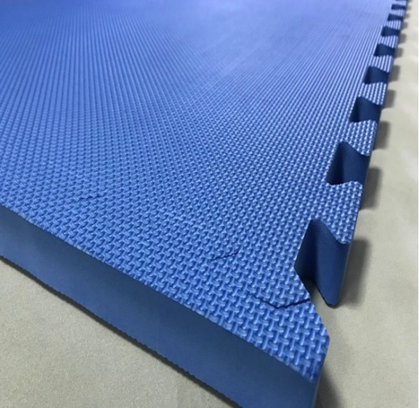

You can always start with the EVA mats you can find in almost any store. But something like these rubber top EVA mats might be really good. they don't have the ribs like all the cheap mats do.I am seeing the beauty of EVA really is the material of choice for OB. I will look around for larger thick sheets. I must try this! I have some rather higher Qts Eminence Beta 12cx that Freddi gave me. They might work for a smaller room?
Amazon.com : Velotas Rubber Topped Interlocking Foam Fitness Floor Mat, Multiple Colors Available : Sports & Outdoors
I forgot to mention that I have not bought these so I don't know the density (like Mattes mentioned). The cheap orange EVA floor mats I bought (you saw in my recent circle baffle pics) are very low density and don't work so good. That is why I am trying to use them up now with these prototype experiments.
Thanks for the tip, Jeshi. That's reasonably priced and I will give it a try for the full range tops. For the bass, will probably use my own compact bass horn of my own design.

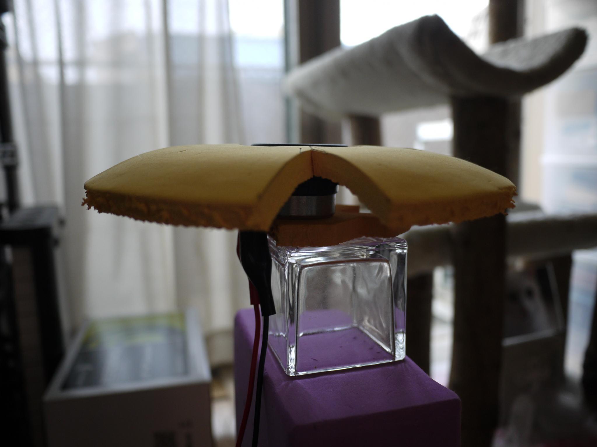

Hi Mattes and everyone,
I forgot to say thank you for your last response, it was 2am when I wrote my last posts. The peerless 10" 830668 was very high on my list for a long time until I discovered the gainphile speaker build and the RSS265HF. I also considered the SBacoustics 10", the SEAS L26RO4Y that linkwitz uses in his LX521 speaker and a few others. I did some models for OB on these and in the end the RSS265HF looked the best for me. I was also expecting to need to do DSP EQ correction like linkwitz and my previous OB experiments with the SB Satori MW16P-4. In fact my current diy speakers are left-side a closed box and right side OB with a 2way Satori MW16p-4 and dayton RS28f tweeter which I love.

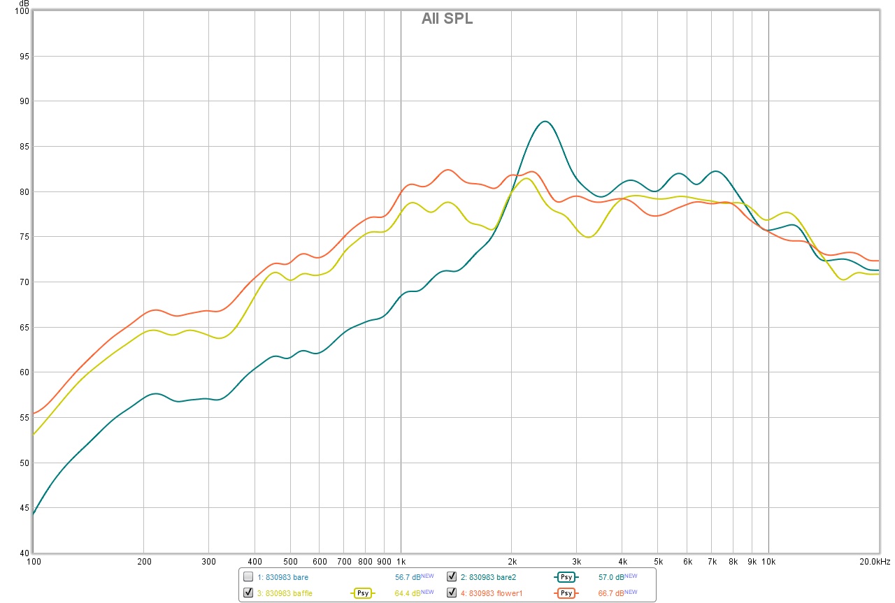

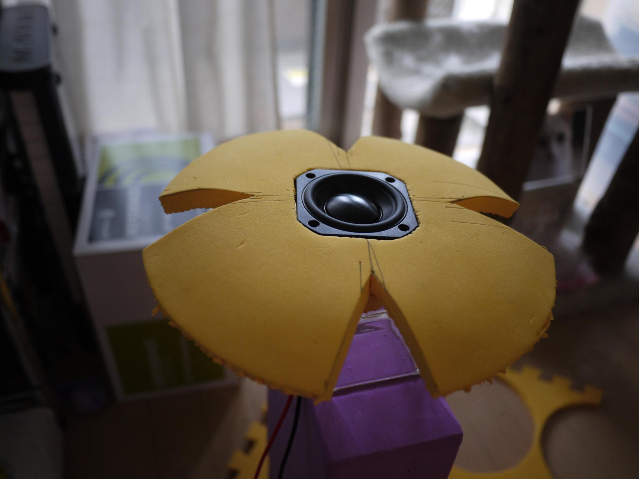

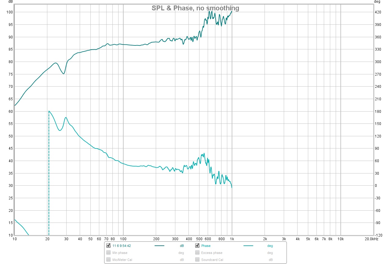

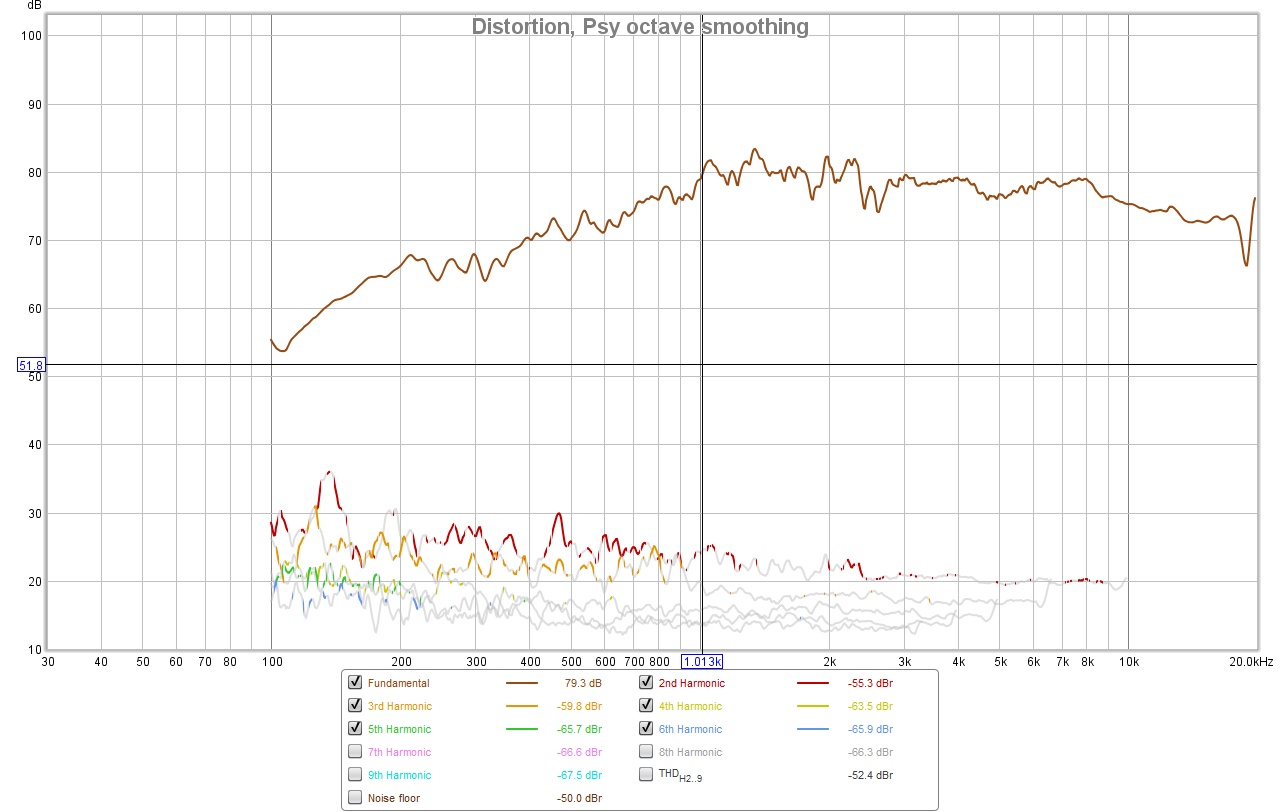

So you have really inspired me and I can't seem to stop experimenting. This morning before heading for work I decided to do a quick flower with my 20cm disc. Just worked with the small 2" peerless 830983 driver. It's a simple biohazard-like 4 petal flower by cutting out wedges and then using the bendable nature of EVA to roll over the petals.
pics and graphs. yes this works great! Rolled over flower petals gives a smoother response. Even with the same diameter the roll over petals even gives a bit more extension. This is very promising. And with small 2-4" drivers maybe all we need is to bend an EVA sheet since they don't vibrate so much. The yellow trace is the round 20cm disk and orange is this biohazard flower.
But of course I will continue my experiments. I think my next experiment will be with using ribs under the petals to hold them at a steeper angle, or try thermo-forming so they can hold a more extreme shape. I might also work on shaping the petals with more rounding like yours. This little 830983 is not a bad little driver.

Hi Jeshi,
thanks for posting the biohazard measurements! To be honest, I thought a lot about the impact this materials might have, and I fear that there´s nothing environmental-friendly in EVA... apart from the paint which is not needed. I thought about using cork for some time, but in the end abandoned the idea.
I will make a few simulations later today with the RSS265, TSP looking quite good for OB. Just be warned that with 120 gr. MMS (more than the Dipole 18 with 3 times the surface...) the driver will, once in action, move anything in it´s vicinity. I see you´ll be using DSP, and of course that´ll give you a lot more headroom than a passive approach.
I´m sure you´re aware of the AE Dipole 10
Acoustic Elegance Dipole10 woofer for Open Baffle Applications
which is purpose designed for OB, but is expensive, and will be more expensive once at your door outside the USA.
However, your Peerless 2 inch looks good, and I like the biohazard shape as well. I think in the end it doesn´t make a difference wether you have 3, 4 or more petals, the path difference and the roundover are the decisive factors in the design. The non-reflective and non-resonant properties of the EVA baffle come on top.

Mattes, this is the EVA mat I saw over here. They are not the flimsy kind, but not as hard as I remember the EVA mats we had in elementary school for PE activities. And I think they may have some black ones too!

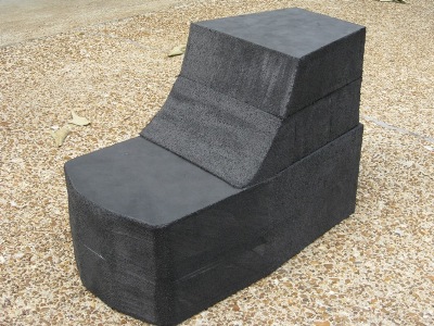

Got me thinking... how about mini cell foam?
We used to get blocks of it to pad and shape canoe/kayak seats.
They say it is 2 lbs per cubic foot density.
Perceval,
Those kayak seat foam blocks look like EVA. Good find - that is some really thick material.
