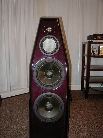

Here's Kharma GR CE-1.0 that uses two 11" Etons:

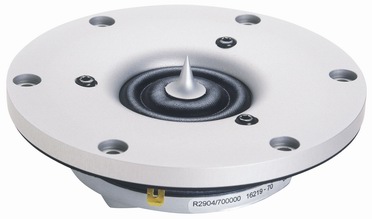

Any opinions for Ring-Radiator by Scan-speak?
Scan Speak ringradiator is the best tweeter I ever heard, but I must say I heard only dome tweeters.

I have not listened to the Esotar, but I've heard the budget Morel tweeters (MDT 29 & 32). The local DiY-shop has only a limited choice of demo speakers available. I also have heard a old expolinear ribbon, but I was not impressed.
The ring radiator is in my opninion a little bit directional. But the vertical and horizontal dispersion is still good enough. On the plots of ScanSpeak you can see that the off-axis response is not as good as the new ScanSpeak 7100 or some other fine dome tweeters.
