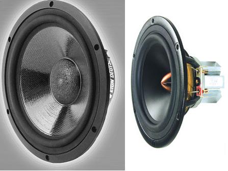

Is it possible to crossover the Seas Excel M15CH001 with the Eton 11/581 at 250Hz? I would choose the Excel W21 EX 001 but I am scared of its Mms 25 g - (not fast and detailed midrange ?).
This could be 2x Excel M15CH001 with 2x Eton 11/581 per cabinet.

I use the m15ch001, and only i can say is that this midunit is one of the best midunits i ever heard. (very neutral, very fast, very dynamic, high dynamic power handling)
The only thing I would think twice about is the crossover frequency of 250 Hz. The Xmax of the M15 is VERY low (about 1mm linear each side), and at a few hundred Hz you'll reach that very soon 🙁

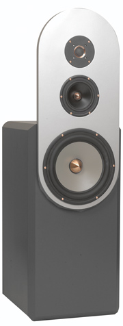

I think it matches really well: Ascendo M 32,000$ (look at the photo)
But it uses the 8" with the 11" Eton.

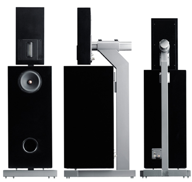

Well Exmotion has a Seas 26cm woofer, Eton has better sensitivity. (And two of them...) What do you think?
It also uses the Millenium tweeter which is not the best out there... Raven, Aurum Cantus, Eton ER4, well I will see
Thank you everybody for this helpful info. 😀
Here's the Exmotion:
