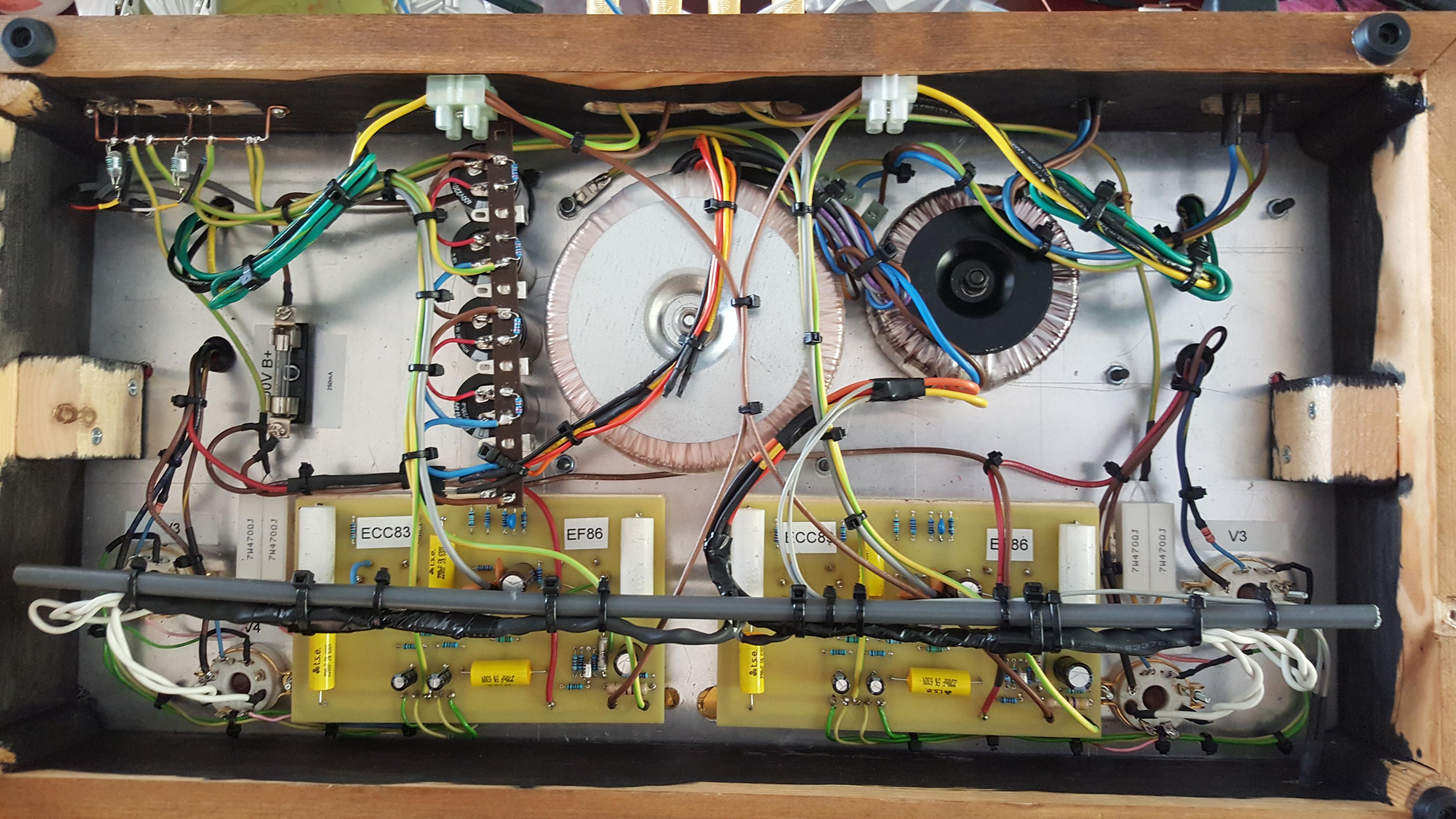

I've just connected R27 (10M), R26 (1K0) & C16 (220pF).
The load resistors are no longer cooking.
I do see a lot of 50Hz ripple on both outputs.
The only difference between my application and the original is that I'm not using CT heater transformer.

I think I've found the problem but I don't know what to do about it ?
If I short circuit the inputs at the input sockets, the amplifier is silent on both channels.
I've just tried it with my existing system and it is absolutely awful with very low volume and horrendous distortion along with massive 50Hz hum.

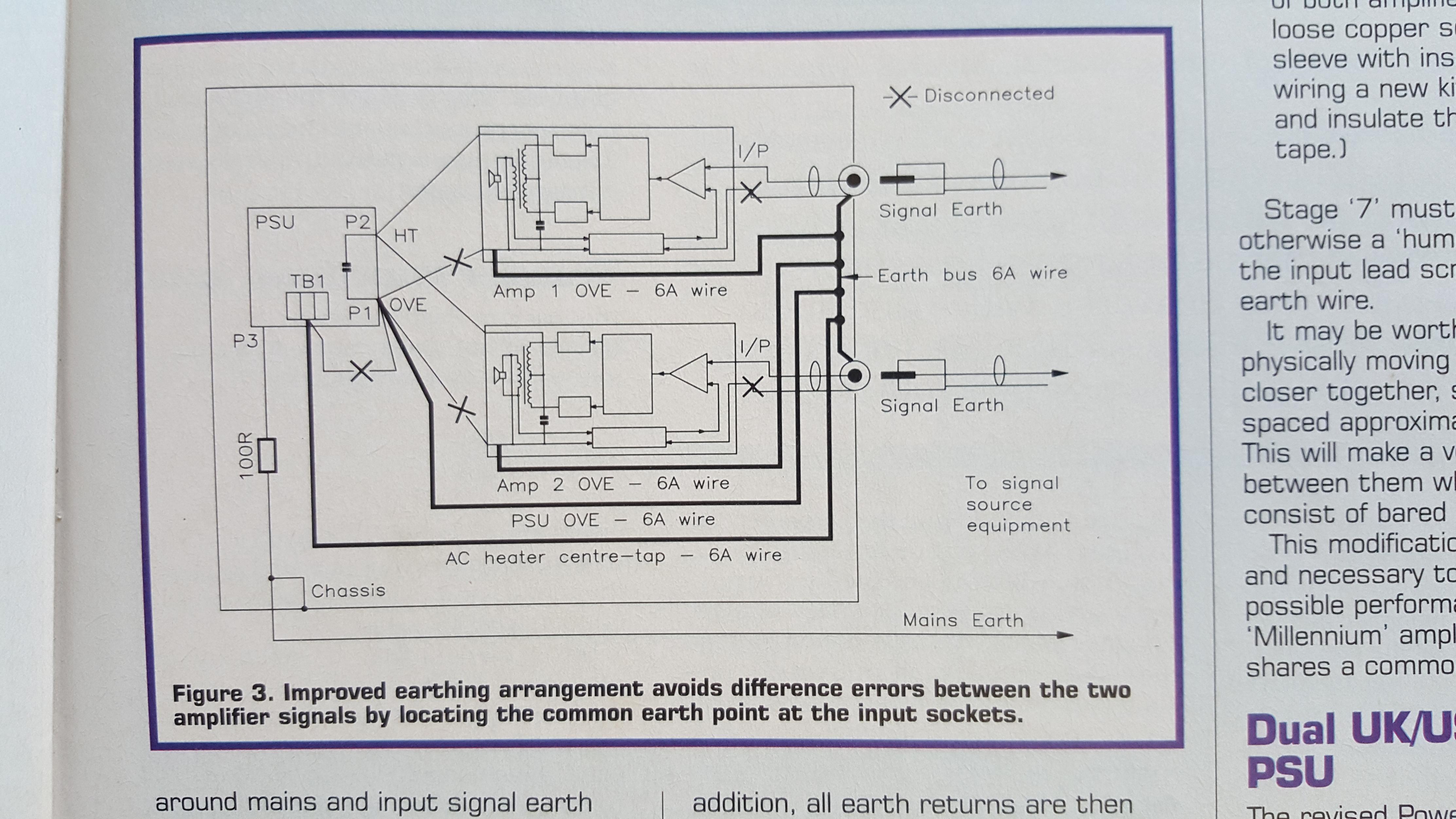

The mains hum suggests a ground loop.

I did try altering the ground wiring for the input screened wires, changing the screen connection to 0V from one end to the other but that made no difference. The screen is only connected at one end.

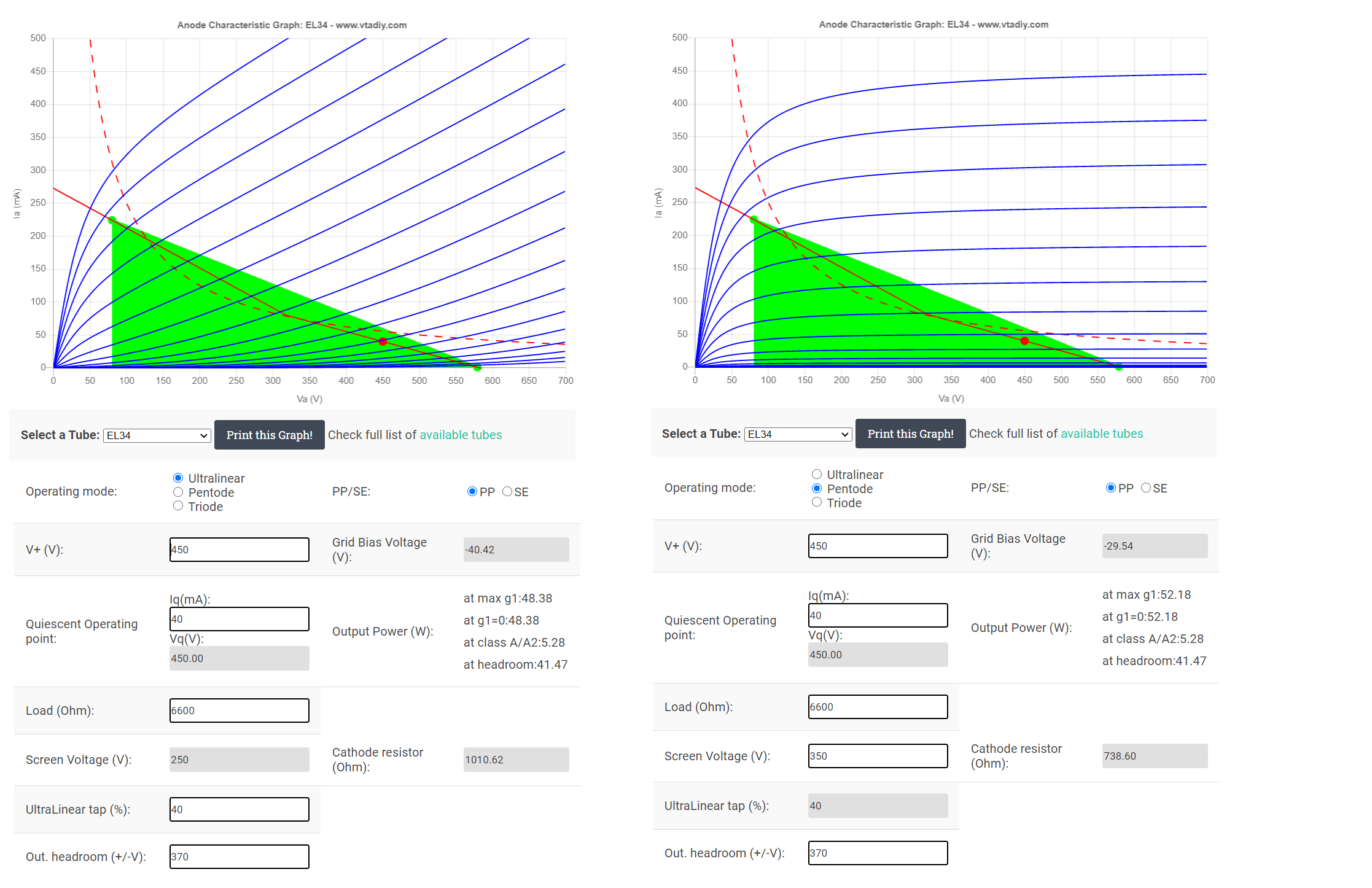

For ultralineal would need to drop at least to 450 max for fixed bias but for pentode mode is a good number since your design uses self bias the power tubes Vak will roughly fall under that numbers for a EL34 you can measure the G2 currrent just before clippling if is less than 10mA then I wouldnt worry even a reissue tube will last for long in there.
For a EL34 using 6k6 primary the loadline would look like the following......... the tube is a bit over the 25W limit but since is in the B loadline it would only dissipate that much with a 50% duty cicle so it wont hurt much.
Just dont bias much more than 35-40ma in the class A part of the load it will burden the tube a bit more with 495V you see under no load. 😀

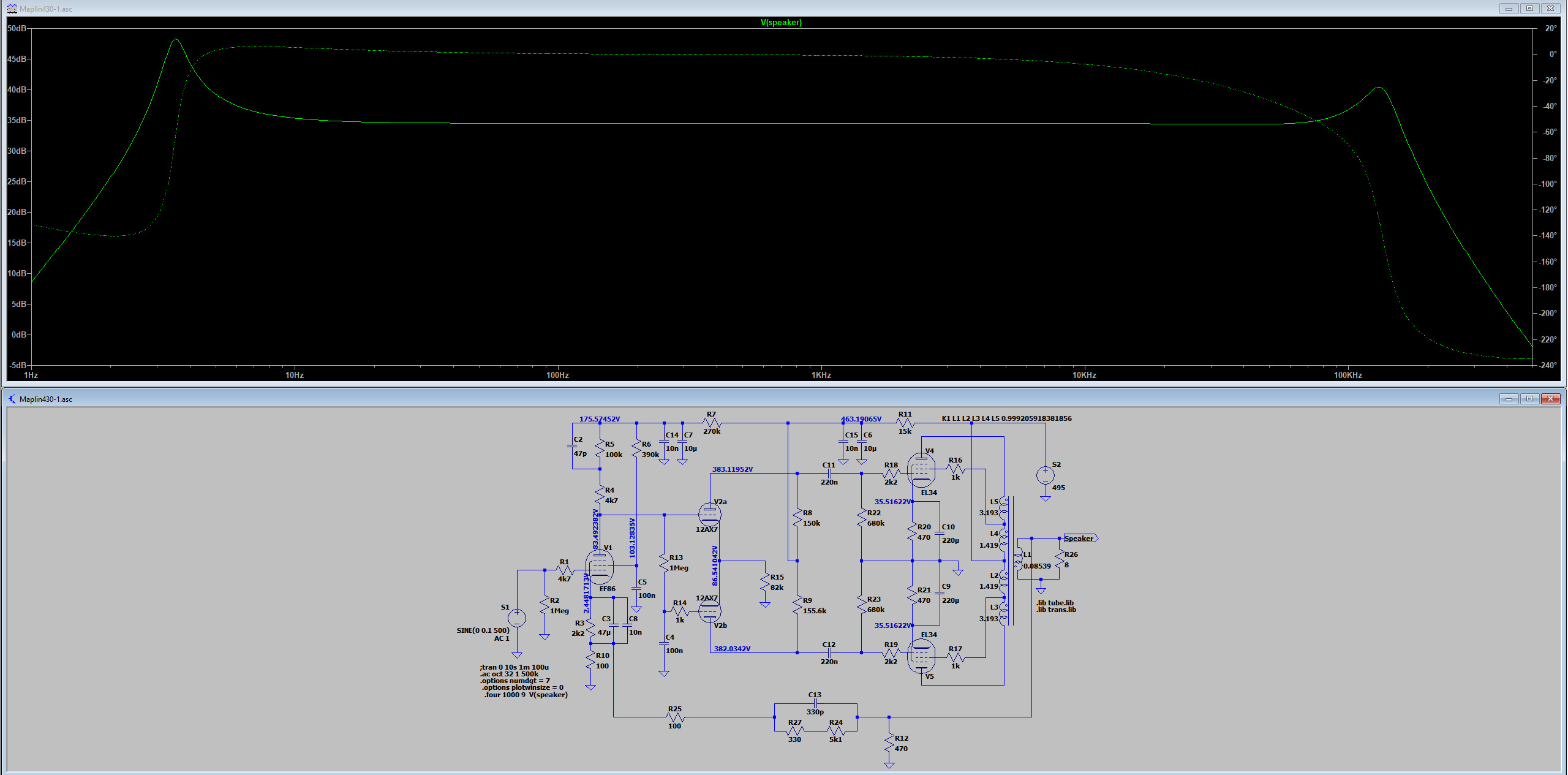

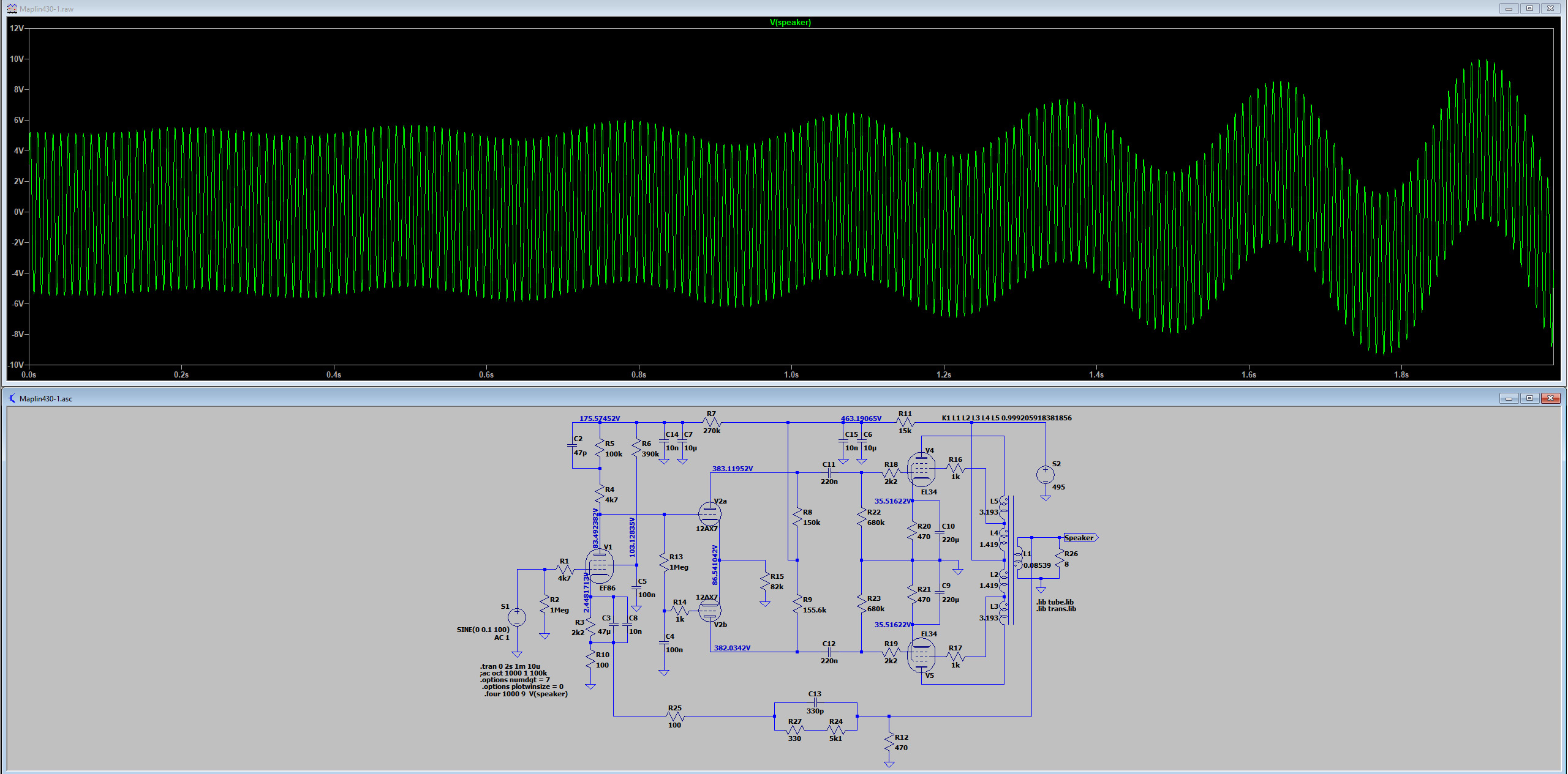

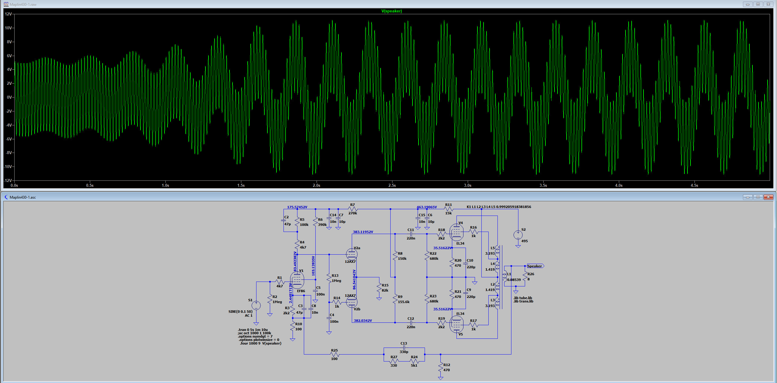

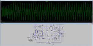

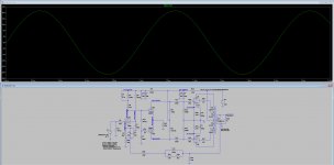

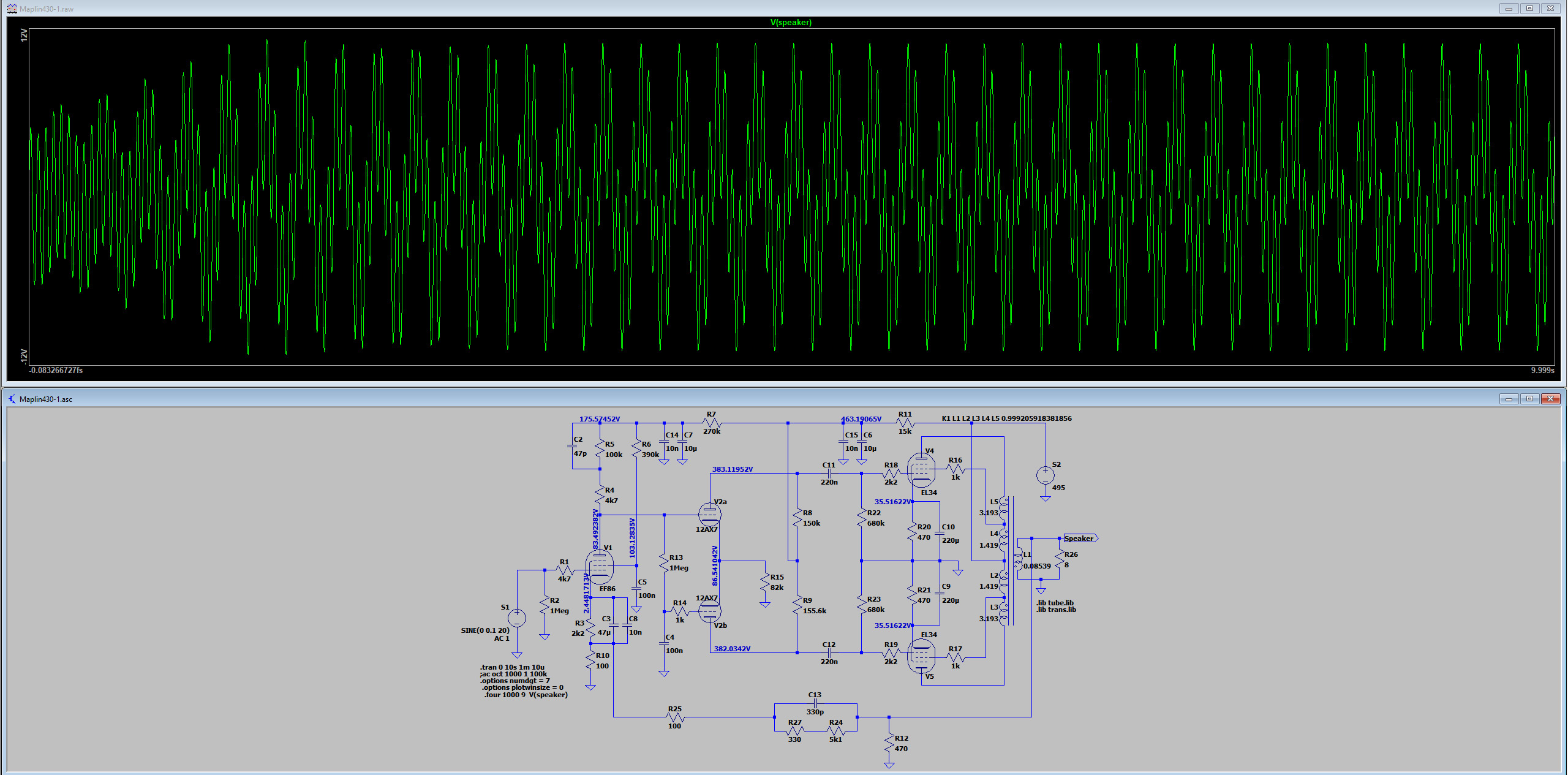

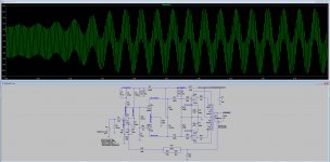

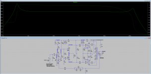

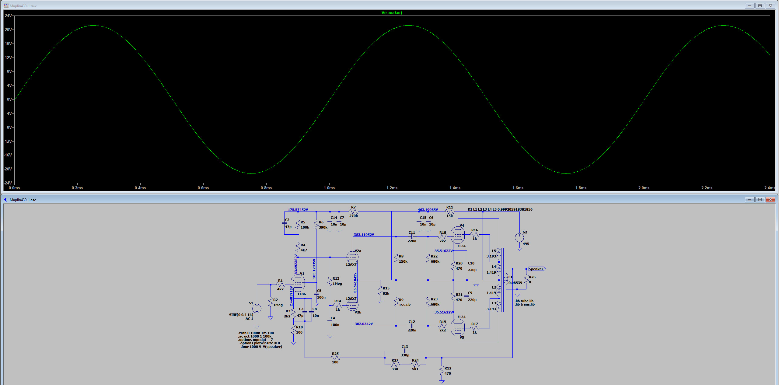

I've plugged the schematic into LTspice and tested it. (ignore the 1K resistor on the grid of V2, I forgot to remove it as my model had it. I've retested with it removed and the results don't change) It looks to be unstable, particularly in the LF. Disconnecting the feedback loop appears to solve the issue but the amount of open loop gain is extremely high. (65dB of gain. just 1mV input gave 14W out) Obviously, the simulation isn't going to be 100% accurate as the output transformer isn't going to match your hammond 1650H but it will give a rough idea.
I'm looking at some component value tweaks that help stabilise the simulation. Dropping the value of C12/C13 from 220uF to 25uF appears to have a fairly substantial effect on it's own. Increasing C9 to 220nF appears to also help. Removing C4 & C5 on the cathode of EF86 in combination with the above appears to virtually remove the LF peak. (down to just under a 1dB rise)
Pictures in order:
1. AC analysis of the circuit
2. 20Hz input at 0.1V
3. 50Hz input at 0.1V
4. 100Hz input at 0.1V
5. 1KHz input at 0.4V
