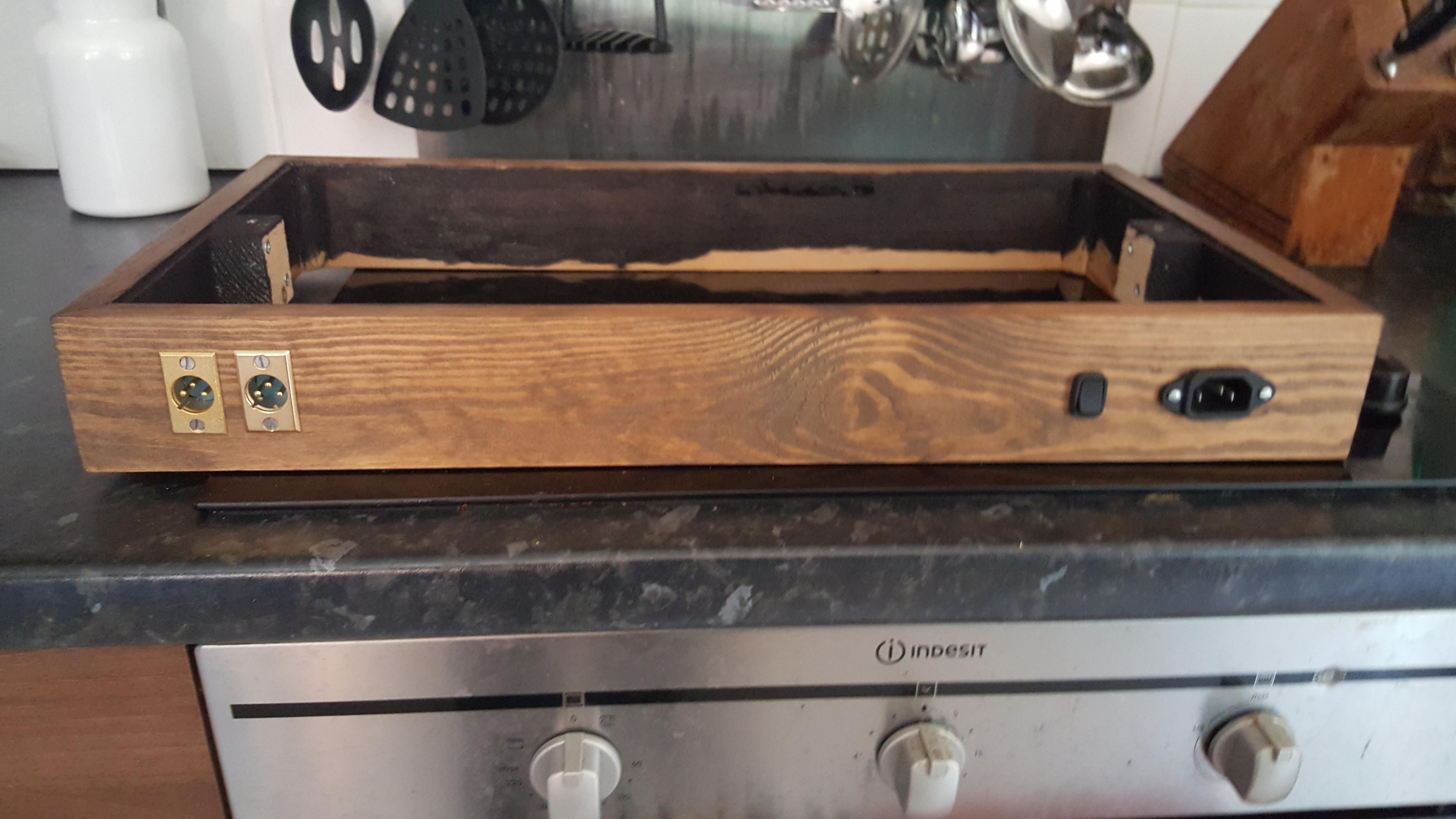

The wooden chassis is coming along.
I'm waiting for some components for the electronics so I'm finishing the wooden chassis.
I've installed the I/P sockets. I'm using XLR as all my Pass amplifiers use balanced connectors. I'm still undecided as to whether or not to use a balanced to unbalanced convertor or just use one side of the balanced input.
I'm waiting on a nice piece of brass to mount the O/P sockets.

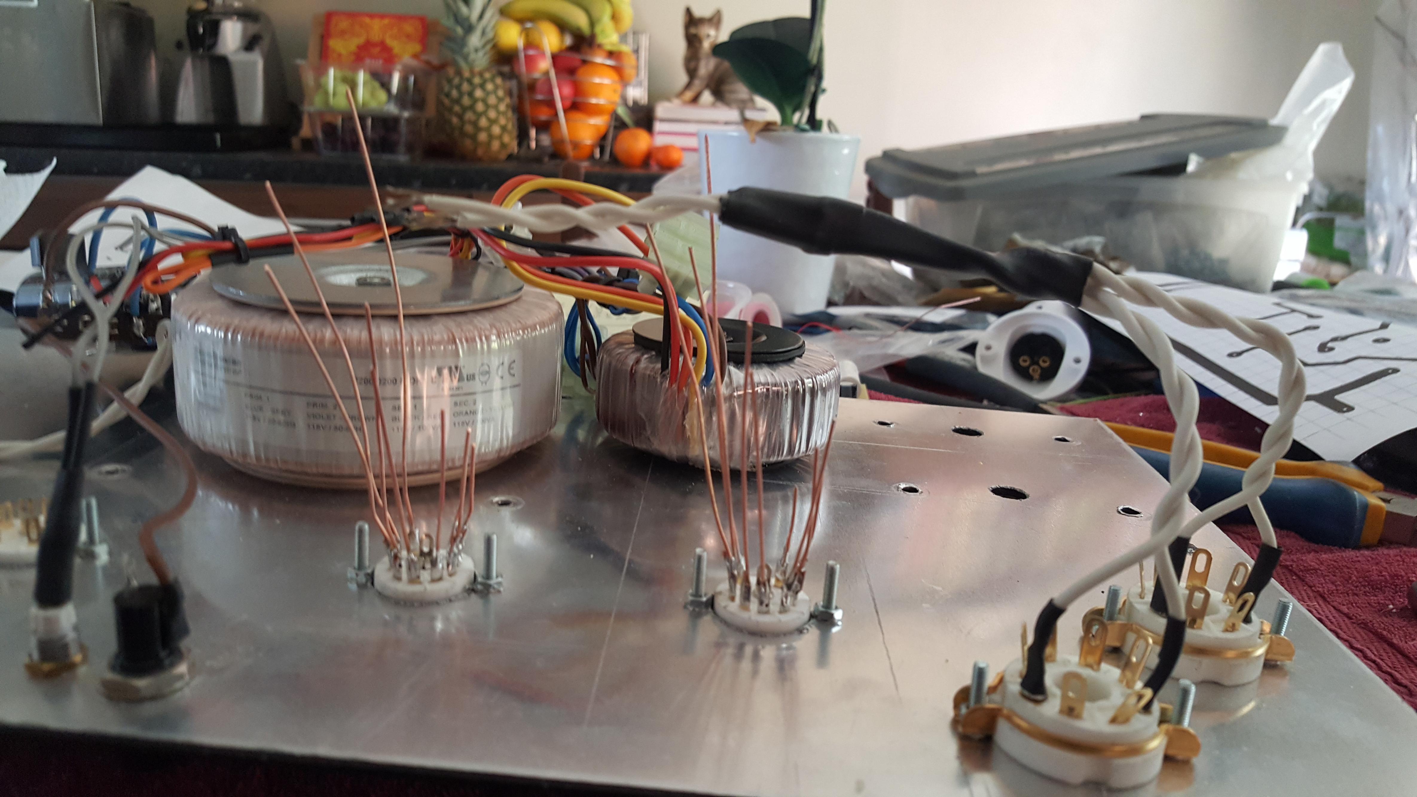

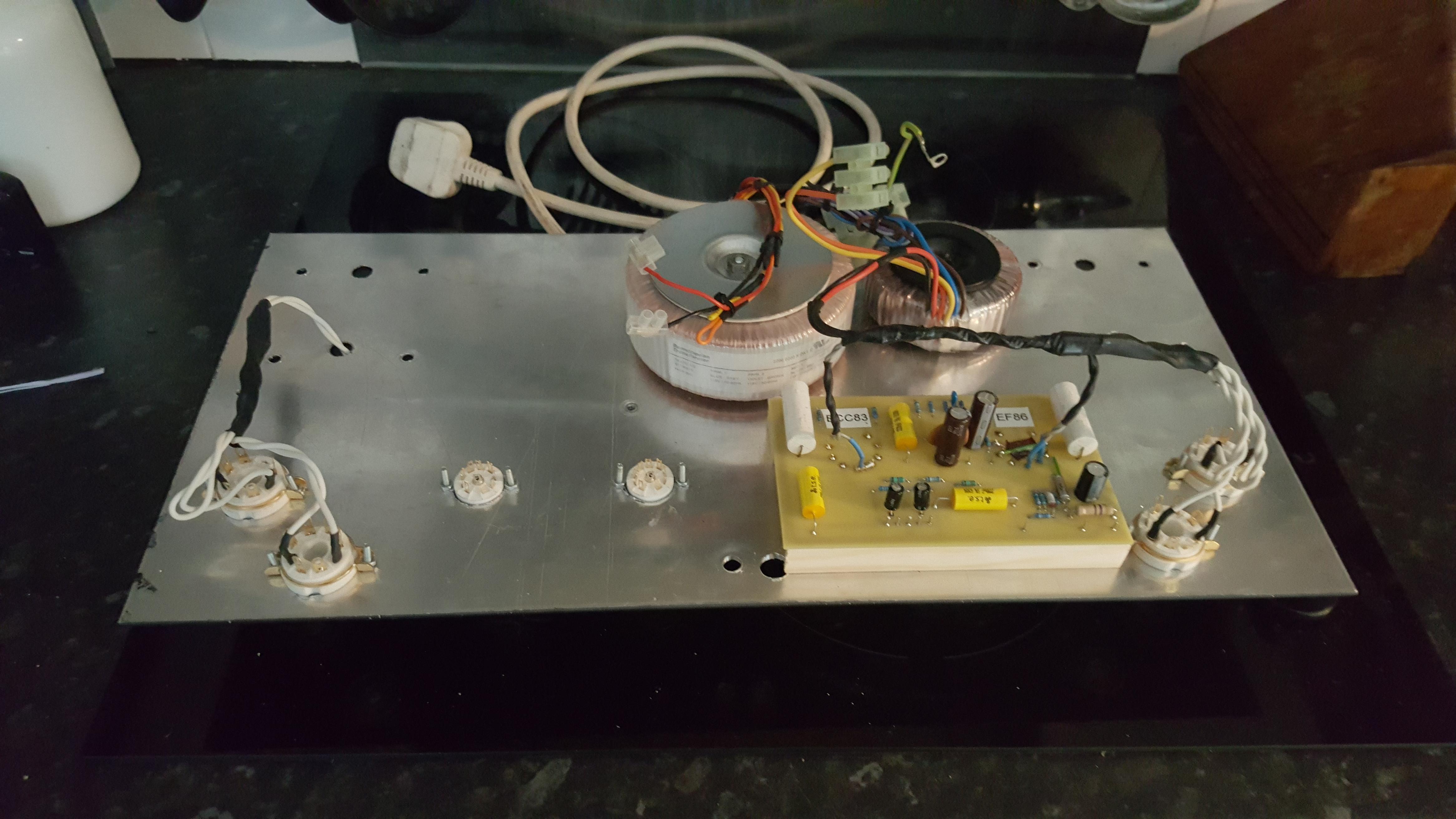

I'm using chassis mount tube sockets. Due to the interface between them and the PCB, the sockets will be 16mm away from the PCB. Does anyone have any advice on this ?
I'm aware that components such as grid stop resistors should be as close to the valve bases as possible.
On the EL34s the GS resistors are on the valve bases.
On the pre-amp tubes all the components are on the PCB.

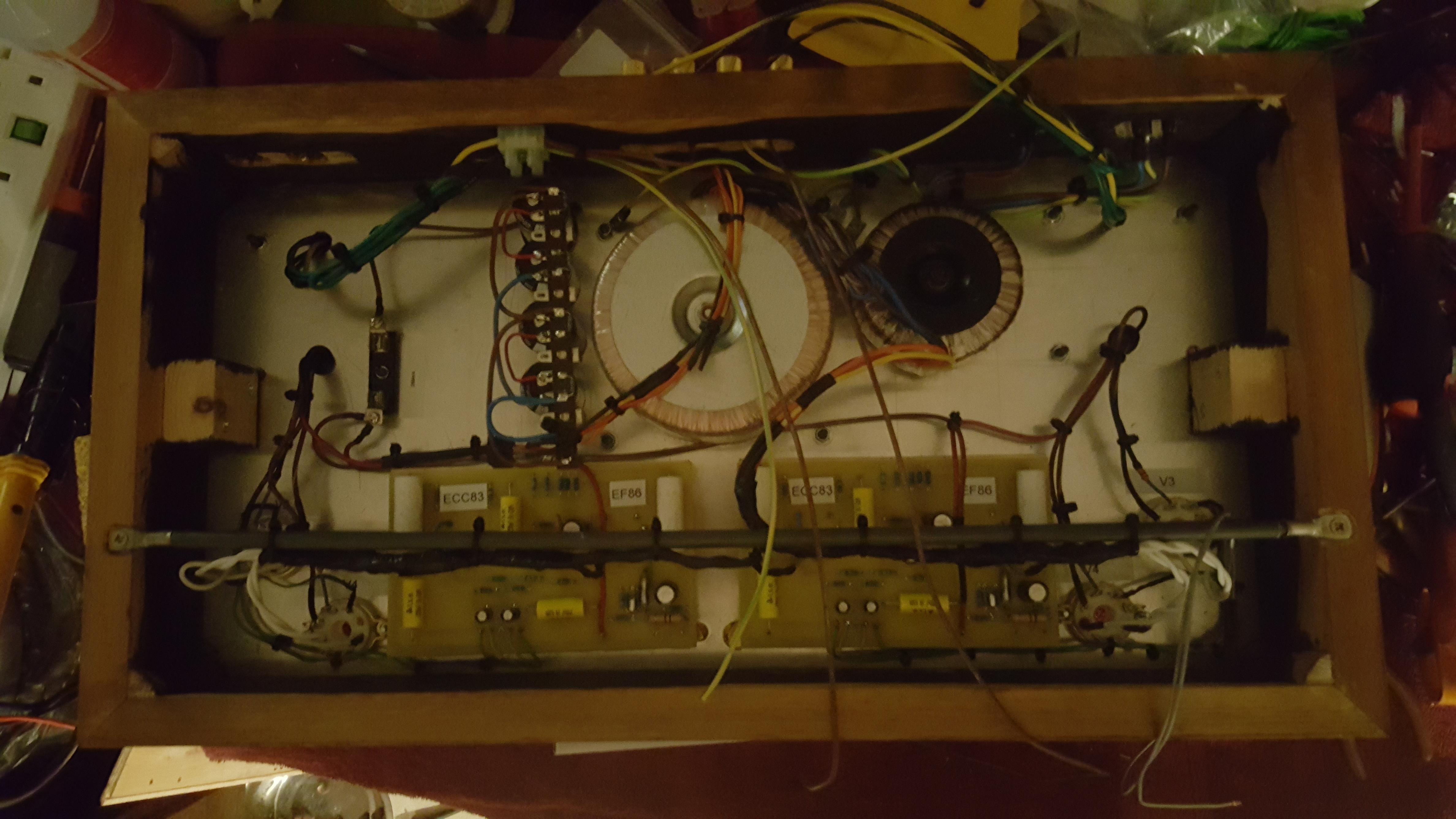

I've never built a valve amplifier before so I'm learning how labour intensive it is and how awkward the build becomes as the weight increases.

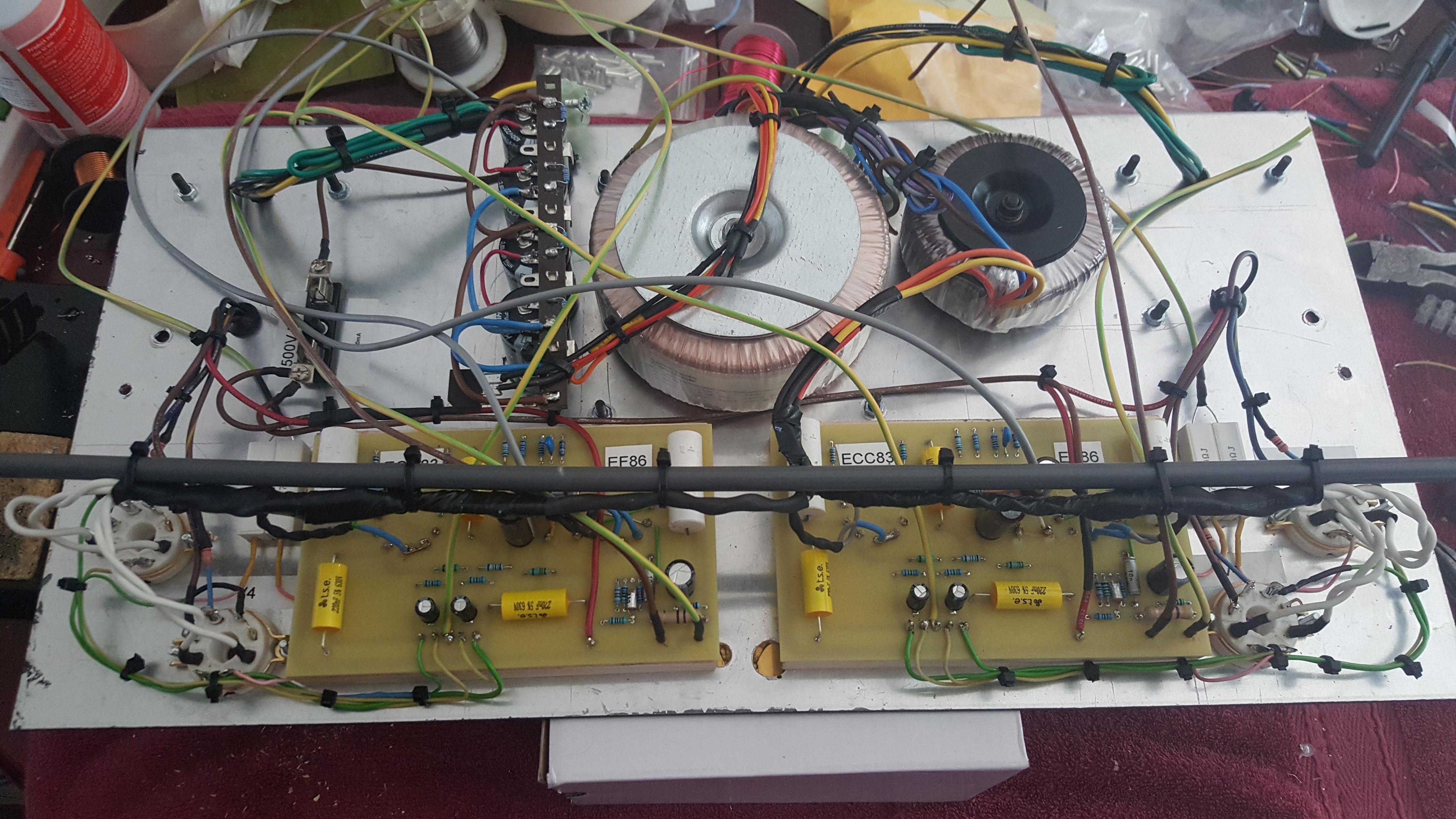

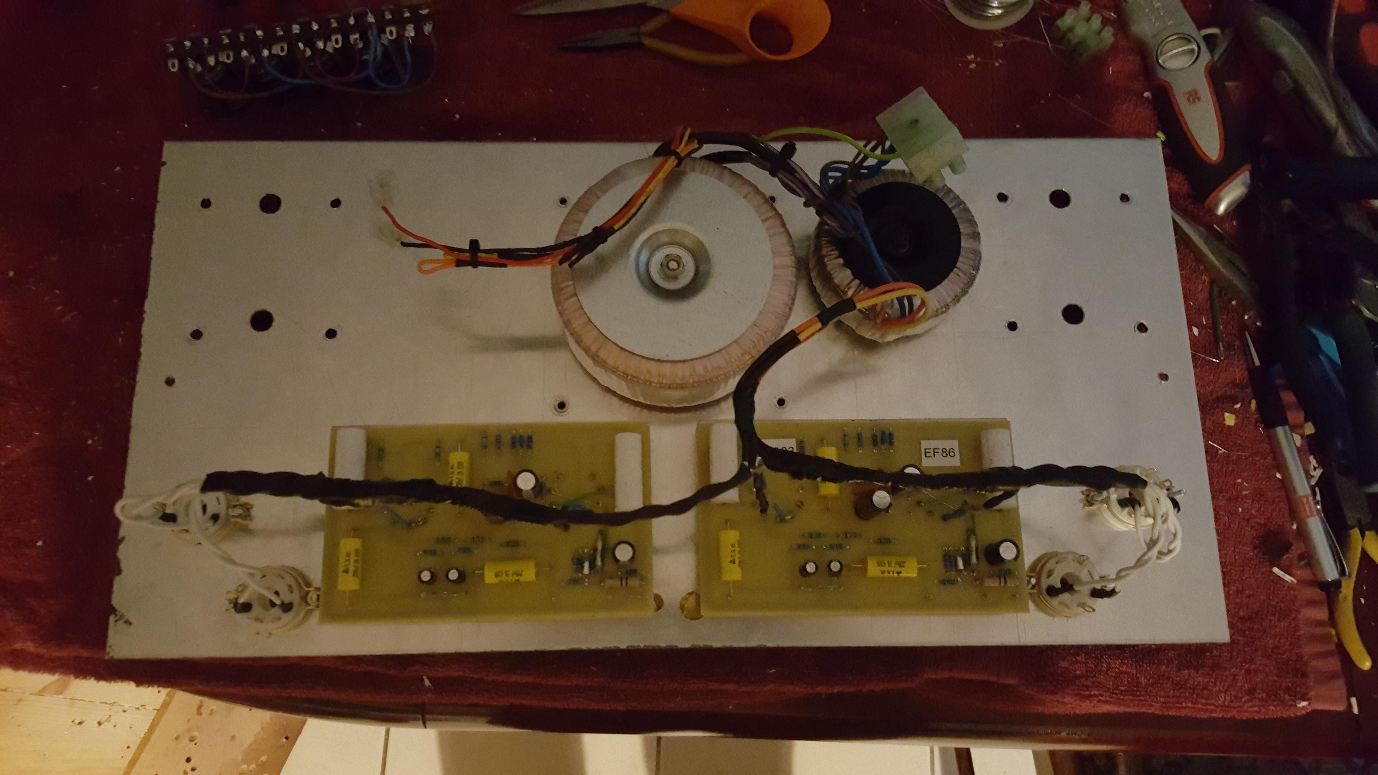

Today I have made some progress. The two PCBs are mounted in the chassis and the pre-power tube bases have been connected.
The heaters are all connected and I have heater power to all the tubes.
The 500V caps arrived and luckily they are slightly smaller than the 450V ones and actually fit on the PCB.
The wood under the PCBs is my version of PCB standoffs.
One last photo of todays efforts.
Tomorrow will be fun as I get to finish the project.
There's a lot of heater current flowing, some 8A, I hope my heater wiring will not produce any hum.
The heater transformer is dual 6V / 5A with each secondary feeding the heaters of the L and R channels separately.

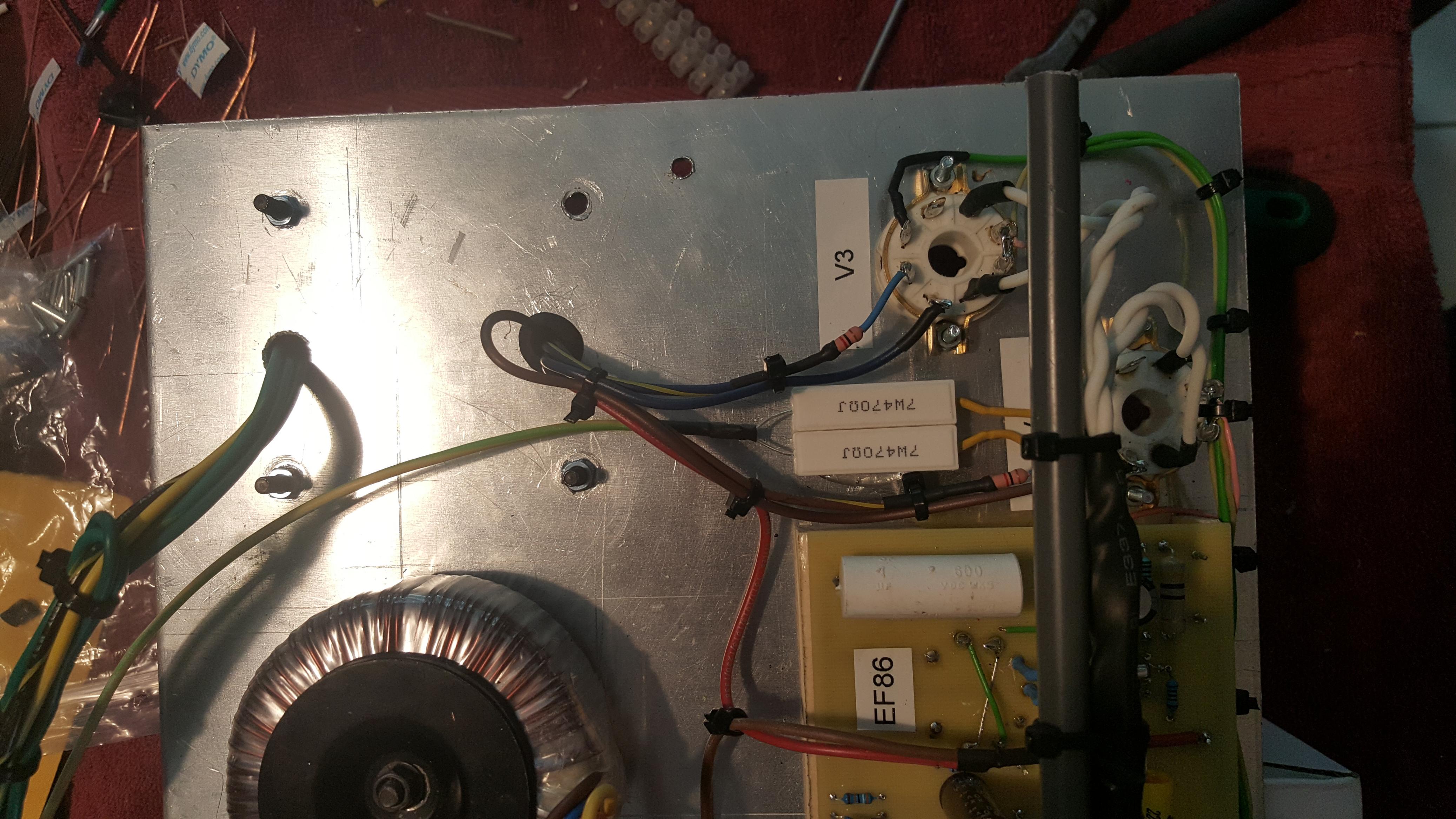

They will get very hot after a period of running, so just watch out for any stray wires that run close by.I had to remove the chassis from the woodwork, but, thankfully that was easy enough to do.

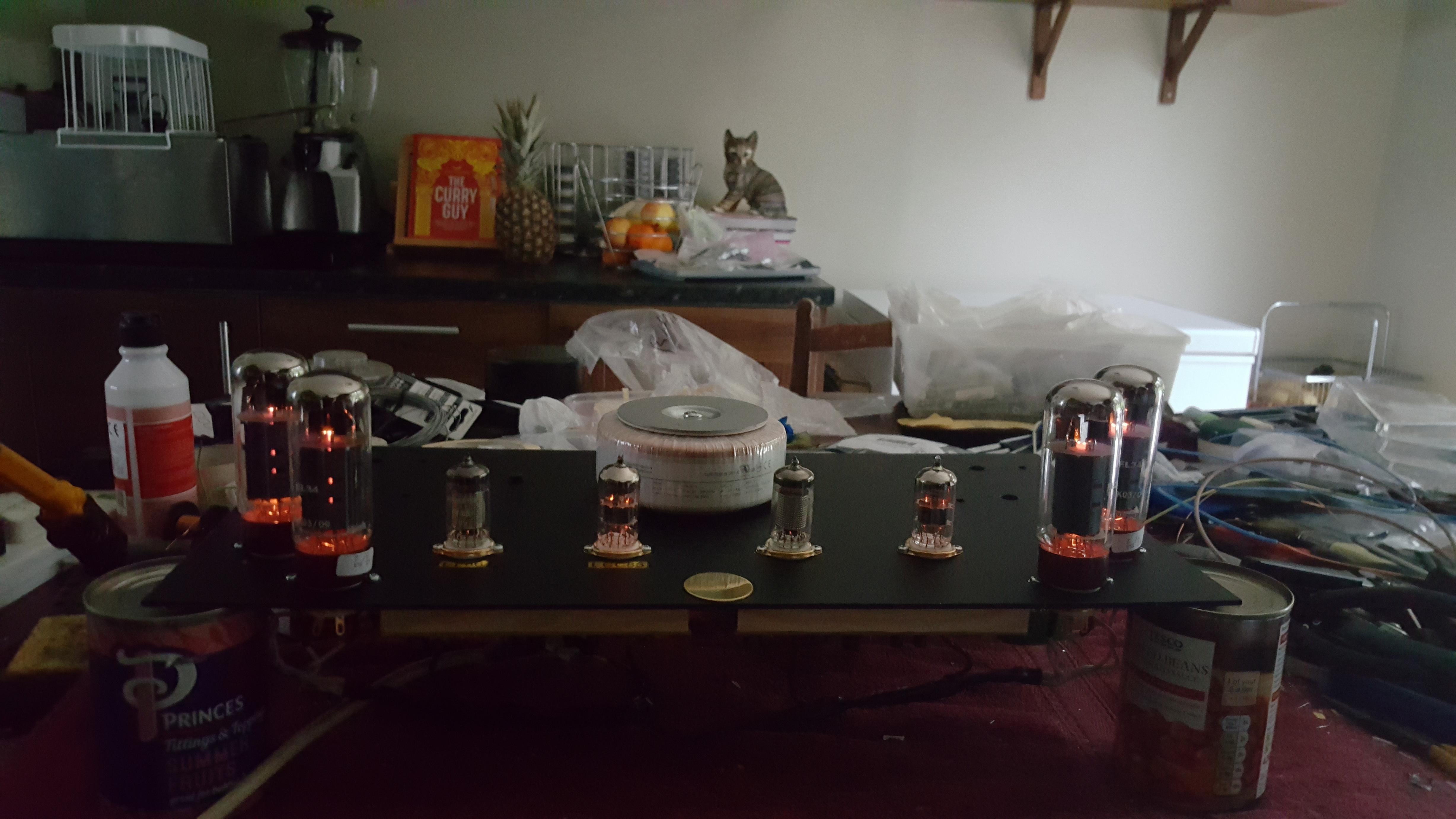

Unfortunately it doesn't work
I've just finished the construction and have started testing it.
1. All heaters illuminate - Test passed.
2. B+ measures at 550VDC with no valves - Test passed.
3. B+ measures at 495VDC with all valves - Test passed.
12R 10W resistors are fitted as test loads.
LH amplifier seems OK.
RH amplifier is cooking the test load.
I've checked the phasing of the feedback, it is identical in both channels.
I've tried swapping the phase of the output transformer but that makes no difference.

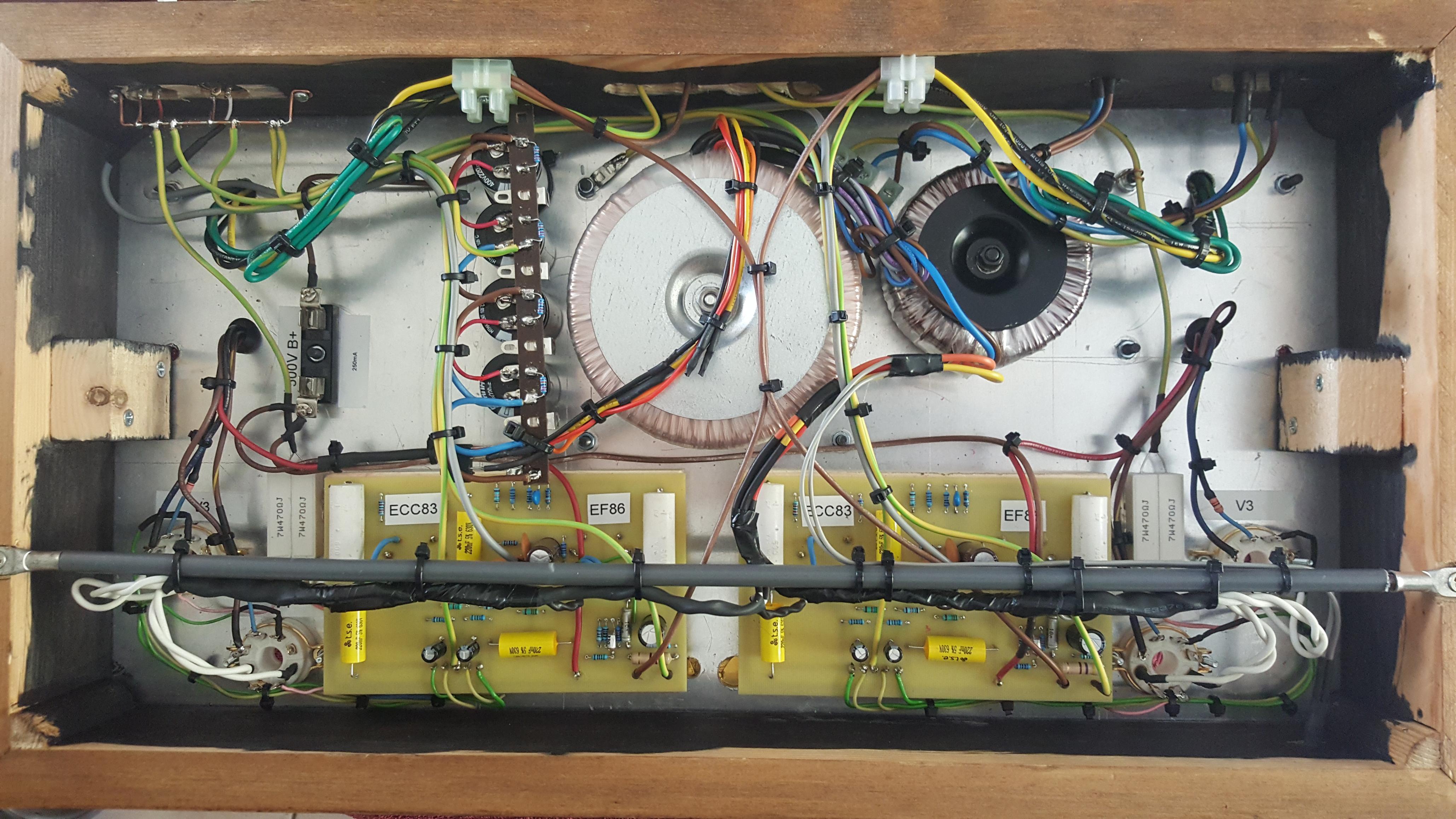

Please see my earlier post. They are clear of any wires and are bonded t5o the aluminium chassis. At 7W rating they should be OK.
I haven't fitted the optional components R26, C16 nor RV1 and R27 so the input is open circuit into P1.
ie The grid of V1 is open circuit except for R1.
I can't see this being the problem as one of the channels is working OK.
