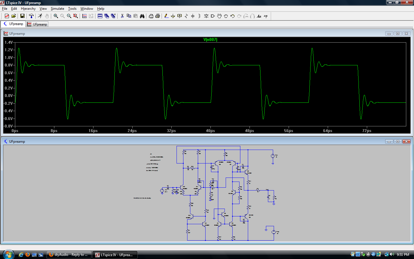

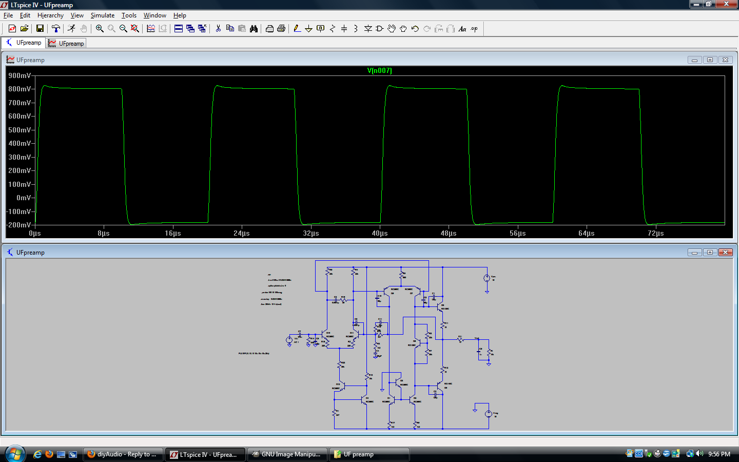

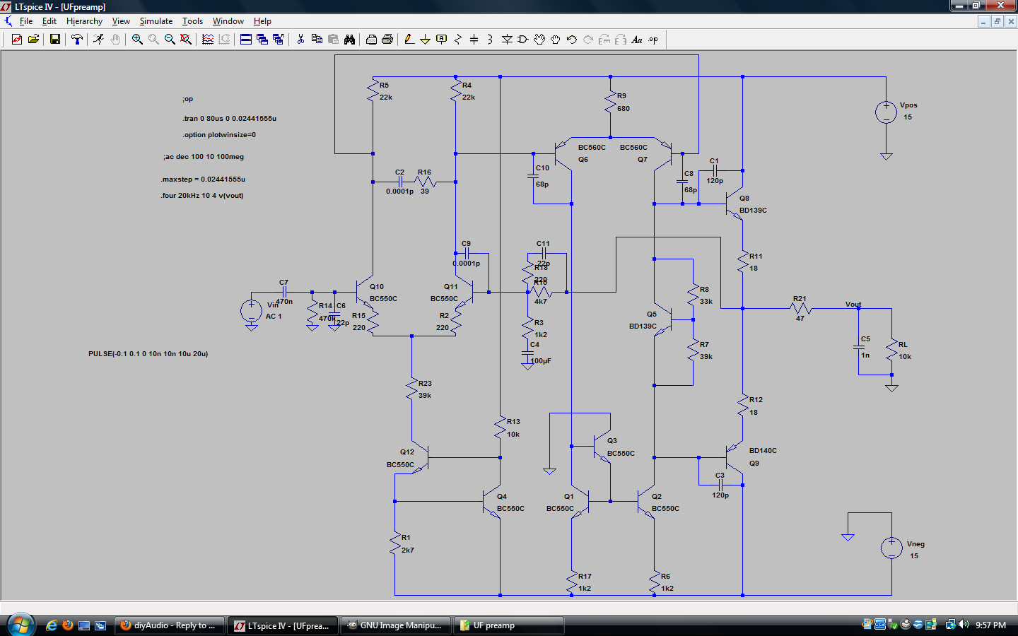

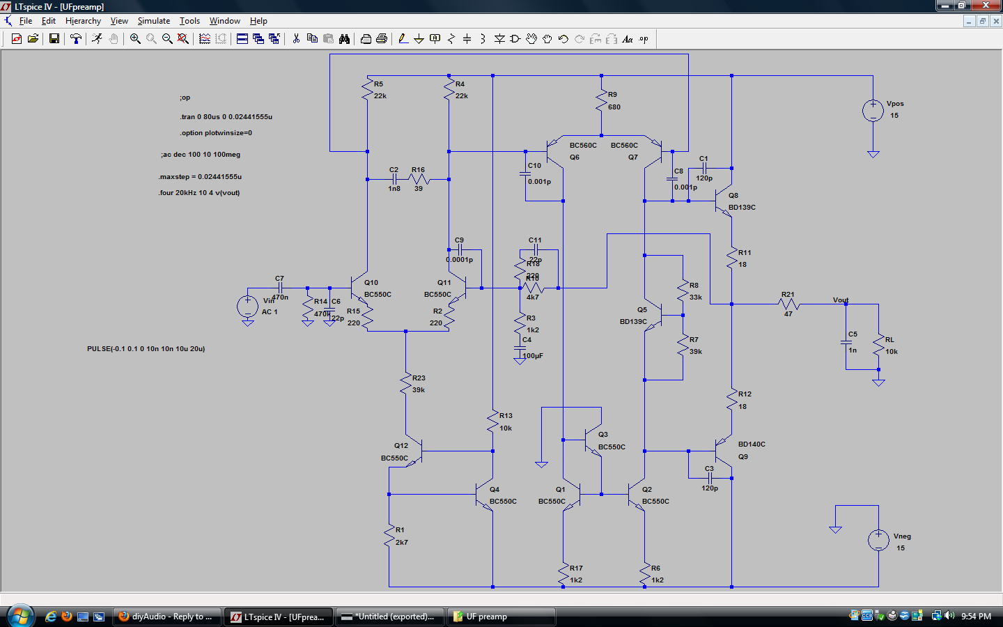

The reason I'm writing is I still have the line stage of your UF 6000 preamp. I never really thought it was as good as the power amp, and not long ago I decided to see if I could work out why. I believe it is perhaps not as stable as it should be as it shows quite pronounced ringing on square waves. I found this both in simulation and measuring the actual preamp with a 'scope. I also discovered a track missing in one channel of the original PCB, which probably didn't help...
Anyway, I played around in spice with different forms of compensation and found the the best looking result by ditching the input compensation (1n8 + R) and instead slugging the next differential stage with a 68pF cap across C-B of each transistor of the diff pair. This seemed to tidy things up nicely in the real circuit, with no visible signs of overshoot or ringing on square waves.
Unfortunately this was very much trial and error on my part, I don't have the necessary skills and knowledge to really know if this method of compensation is optimum, but it does seem to sound quite a lot better now. I'd be stoked if you could have a quick look at my mods and see if you think this is really a good idea. I don't have the means to measure distortion, but it certianly looks very low in simulation. I've attached the simulation screen grabs and can of course send the files if you're interested. The waveforms look identical on the 'scope. Please don't feel in any way obliged though, you've probably got much better things to be doing.
Do you think it's still a topolgy worth playing with? Douglas Self and others seemed to have dismissed the differential VAS as flawed in their publications. I'm curious to know whether the FET preamp you mentioned is based around that sort of discrete opamp toplogy?
