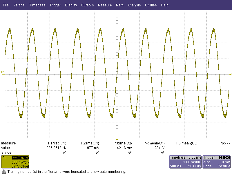

Getting back to the 5000, I had a bit of a look at it today. It's being a very naughty amp - I removed the Zobel resistor (which had completely fried, leaving a burnt patch on the board beneath), powered it up with my dummy load connected and got a really beautiful oscillation out of it on the positive half cycle, of maybe 1V, superimposed on the 1KHz test tone I was putting through it.
But by the time I got the cro set up to take a happy snap, it'd gone 🙁 Poking and prodding completely failed to bring it back. Anyway, I've attached a pic showing the output distortion, which is pretty impressive.
I didn't make terribly much headway with it at lunch today - as I spent most of the time checking out the mods to Tilbrook's original design. The zeners to balance the dissipation in the two sides of the VAS are a very good idea.
Anyway, I've ruled out blown output transistors - they're all sharing current happily. I suspect things will look a little better once the electrolytic cap in the feedback path is replaced - it's bypassed with a poly cap, and I suspect the poly cap is providing all the capacitance.

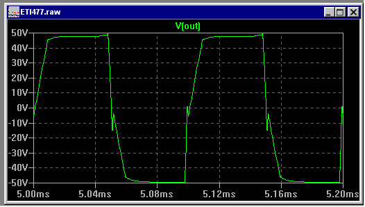

Just for fun, I've knocked together a simulation of the ETI477 in LTspice. I was able to find models for the BC550, BF469, and BF470 (included in the .zip). I substituted the 2SK1058 and 2SJ162 for the 2SK134 and 2SJ49, as I understand these are the same die in different cases.
The simulation agrees with the measured results reasonably well. 100W, 8 Ohm THD is 0.0042% at 1KHz, and 0.041% at 10KHz.
Interestingly, substituting KSA1391 and KSA3503 VAS transistors reduces THD to 0.00038% at 1KHz and 0.023% at 10KHz.
Oops. Sorry about that. Yes, Jaycee is right with the part numbers. I'm rather taken with these transistors for VAS use. They're lovely and fast, and readily available to boot (from Digikey).
It doesn't behave very well as all when clipping. Here's the result of a 4V 10KHz sinewave input.
Yes.. I have tried simulating more conventional amplifier designs (single transistor VAS) and they (or the models at least) seem to have a terrible time recovering from clipping. In a single transistor VAS scenario, they have a tendency to stick to the rail for a while.
This could be a simulator thing though. I'm using LTSPICE as well. I guess the only way to know for sure is to "suck it and see"!
