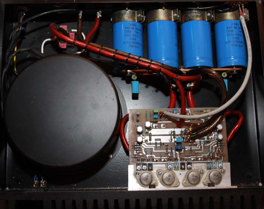

I found this thread through googling AEM6000 - reason being that I have 4 6000 monos, which were built by someone else, and are generally very good ( albeit very, very over engineered ) for what I want, which is running fully active speakers ( mids and tweets ) I use Perreaux's finest for the bass.
Anyway, one amp has developed a 1.8 volt DC offset. This I discovered as I found one of the tweet diaphragms totally popped out from the faceplate ( Focal Audiom TD5's ) By some stroke of good luck, the tweet was absolutely fine once it was reseated.
Anyway, I have schematics for this amp, and friends who are capable of deciphering said schematics, but they are asking for the correct procedure to alter the DC offset bias ( RV1 I believe, the 20K in the feedback look? ) Apparently some of them have had bad experiences re biasing some amps, and have had the magic smoke come out.
Is anyone able to post the instructions for this, or, alternately email me the full instructions to set it up correctly.
Many thanks, I hope someone who is able to help is still reading this forum!
Attached is an image of the amp. Caps are 4 * 10000micro caps, 1.2Kva transformer potted, and some grossly oversize internal wiring!

Yes, RV1 is indeed used to set the output DC level.
Simply leave the input and output open circuit, power the amp up and leave it to come up to temperature, and measure the output with a voltmeter while adjusting RV1 to zero it.
It's possible that the DC bias is a symptom of something else being stuffed, or it may simply be a dry trimpot. In any case give it a go and see if it comes good.

Thanks for the reply, The amp is performing fine on a scope, so I think that its just an adjustment. It has not been used much since new, to be honest. When I said over engineered, I was referring to my amps - not the design in general. 16mm internal wiring, 1200VA transformer...........
I will take to it with my scope and a screw driver tomorrow.

Well, thanks to you for your advice, my amp now has a DC offset of about 10mV. Nothing thats going to damage a tweeter!. I have left it running with the scope recording just to make sure nothing changes, will do so for the next 24 hours or so. I really dont want to have to fork out nearly NZ$800 for a new tweeter!.
