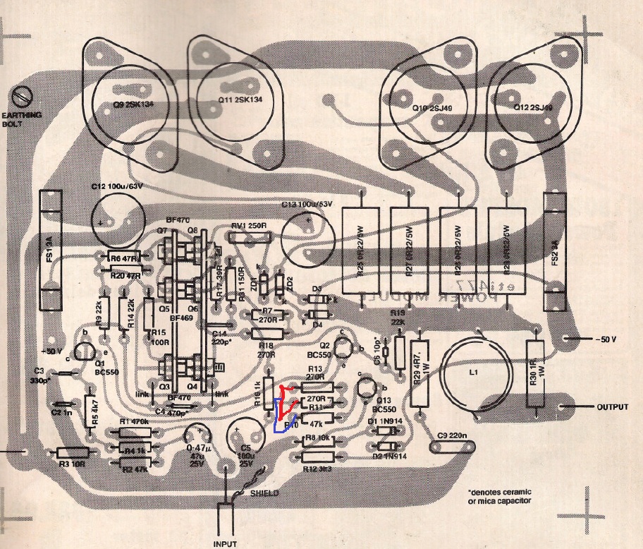

I can see that the "0" volt point is not exactly "starred" at the pwr supply caps. Left and right "0" volt connections are separated by about an inch.
Maybe that is it ?

I think Ian may have hit upon something with reference to earthing and 0 volt connections.
It all looks good except for the 0 volt connections at the pwr supply caps. Each channels is about an inch apart. not sure if this will affect things.

Good that you've found something so easy to fix. It may not be the culprit but won't cost you much time finding out, and fixing it should improve the perfomance. Another area to look at is ripple on the power rails. If the filter caps in the amp have dried out and reduced in value there could be a lot more ripple on the rails. Being AC it shouldn't cause the offset issue but still worth checking with a scope.
Great point made by googlyone - just changing R2 to say 18k (from 47k) will mostly equalise the offsets due to bias on each side of the diff amp and will probably reduce the output offset considerably. The resulting reduced input impedance should not bother any solid state preamp driving it.

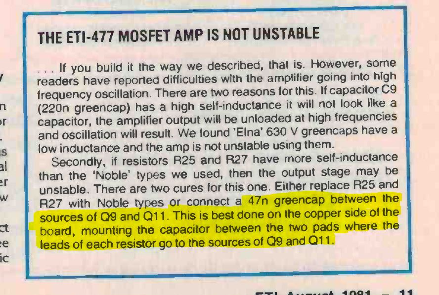

I have also heard that the 470p gate/source caps should actually be connected gate /drain. (see attached) and removing the 47n cap between Q9 & Q11 sources.
I realise that this article relates to the "updated" series 5000 (eti477) but the output mosfets are the same and in the same configuration etc, and I feel that makes this info relevant.
Actually I'm really vague as to my reasoning. It was such a long time ago!
I just dug out the original .asc files for the 100W version, and it (shuffles feet and coughs) shows 220Ω resistors in series with both gates.
So then I dug my original 100W one out of the bottom of the blanket box, where it's been languishing unloved ever since I built an active crossover for my ariels... It's got 470Ω and 680Ω...
Newer boards (see Suzy's Blog: Measuring a MOSFET Power Amplifier.) use 100Ω. But the driver stage on those is a little different to the AEM6000. In any case I'm not consistent.
I do recall some initial issues with getting the original one to not oscillate when I went from the simulation to the actual thing. I think increasing the gate resistance helped, but from memory most of the improvement just came from bumping up the closed loop gain a little.
It's something I clearly dispensed with later, in the quest for better slew rate.
I don't really have a strong opinion regarding capacitors to source or drain. My recipe has tended to be 220p gate-source on the n-fet, and 18p in series with 22Ω for the p-fet. It's never caused me any grief, so I've just stuck with it.

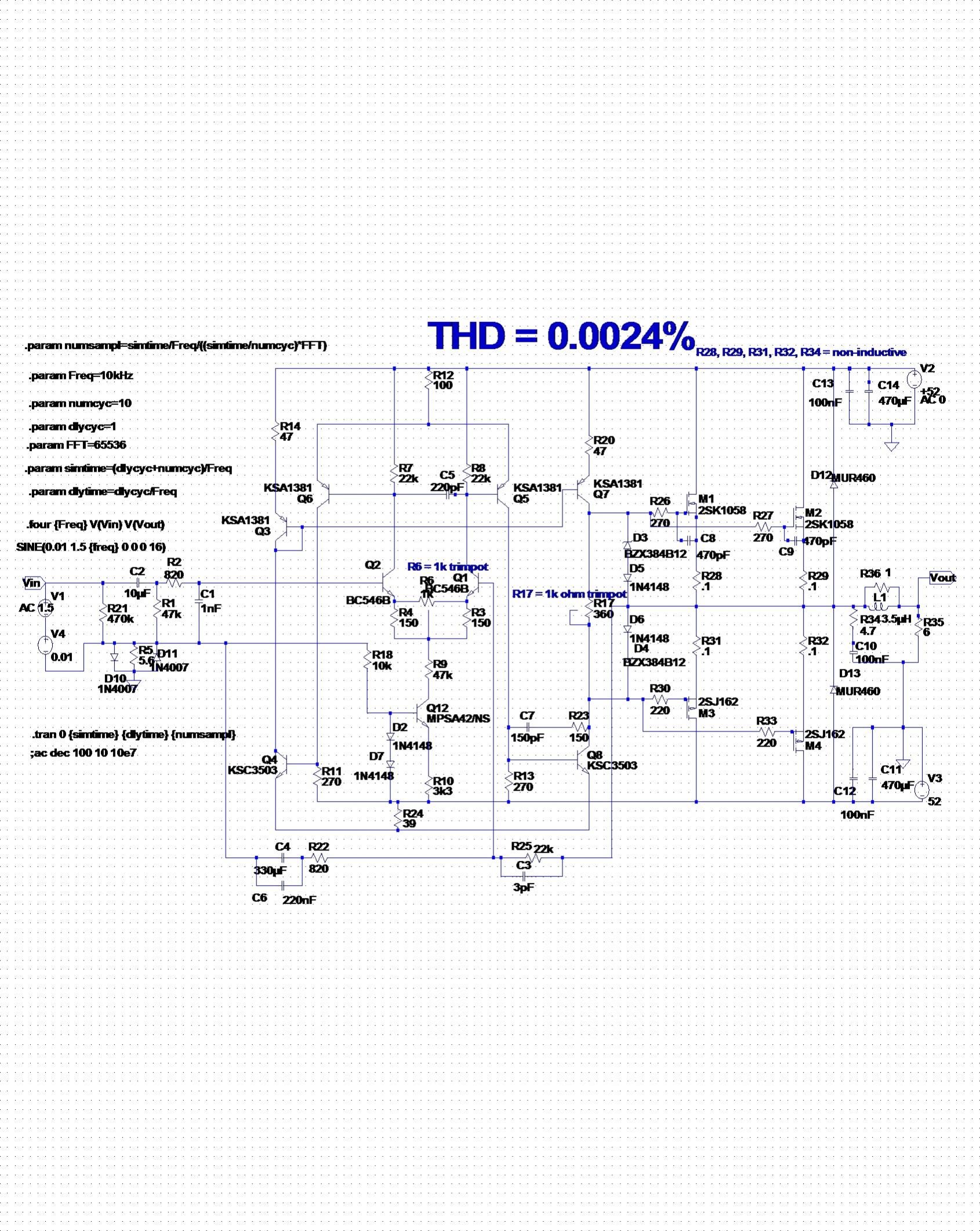

You need to download LT Spice and a number of libraries from various sites. It takes time to learn so I'll do it for you tomorrow or on Monday.

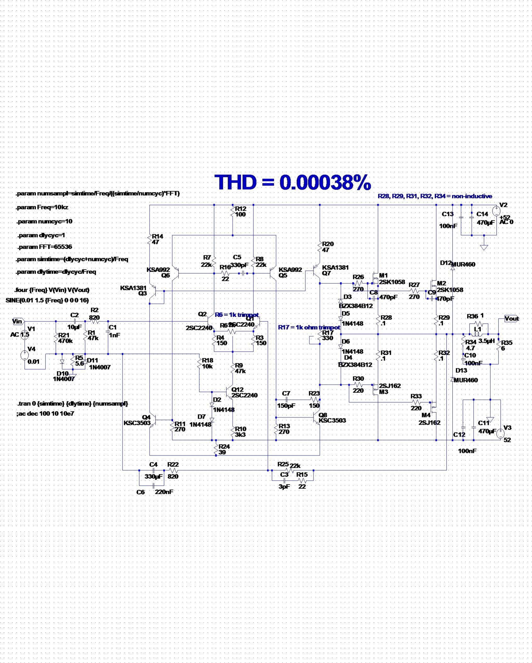

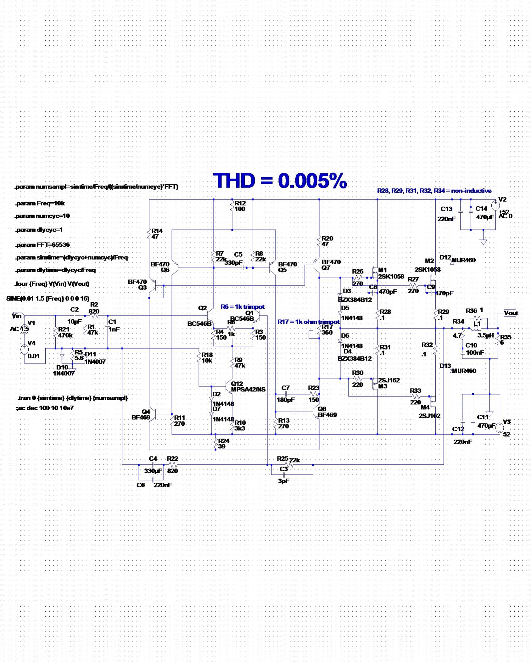

OK, you got 3 versions with THD at 10kHz shown. What really matters most in all of these versions is that source resistors (5W ones) and the Zoebel resistor have the lowest possible inductance. That's why I reduced source resistor values to 0.1 Ohm and that's fine with laterals. I use such values in my ETI477 and resistors are so called non-inductive mpc74.
In Zoebel I use Caddock (mpc74 or KOA bpr58 are good enough) and 100-220nF cap here should also be low inductance polypropylene.
All picofarad caps are and should be silver mica, not ceramics. 220nF and other nF caps are polypropylene as well as the input cap. 10uF is a good compromise here if you want good low frequency response. 330uF cap in nfb is Nichicon Muse BP. Simulation shows that the cap across 22k nfb resistor MUST be 3pF.
To minimize offset add 1k trimpot as shown in pcb image. You should be able to bring offset down to below 1mV.
In mine eti477 I got rid of the 2nd input HF filter and reduced 1k resistor at the input HF and nfb to 820 ohm to improve stability as I reduced LTP emitter values to 150 ohm to somewhat reduce distortion.
As you see from the attached images THD depends quite a lot on transistors used.
Increasing gate resistors to values shown reduces chances for oscillations and having these higher for N compensates for differences in capacitance of N and P laterals.
cheers,
PS use 1k multiturn trimpots in LTP and to set bias.
