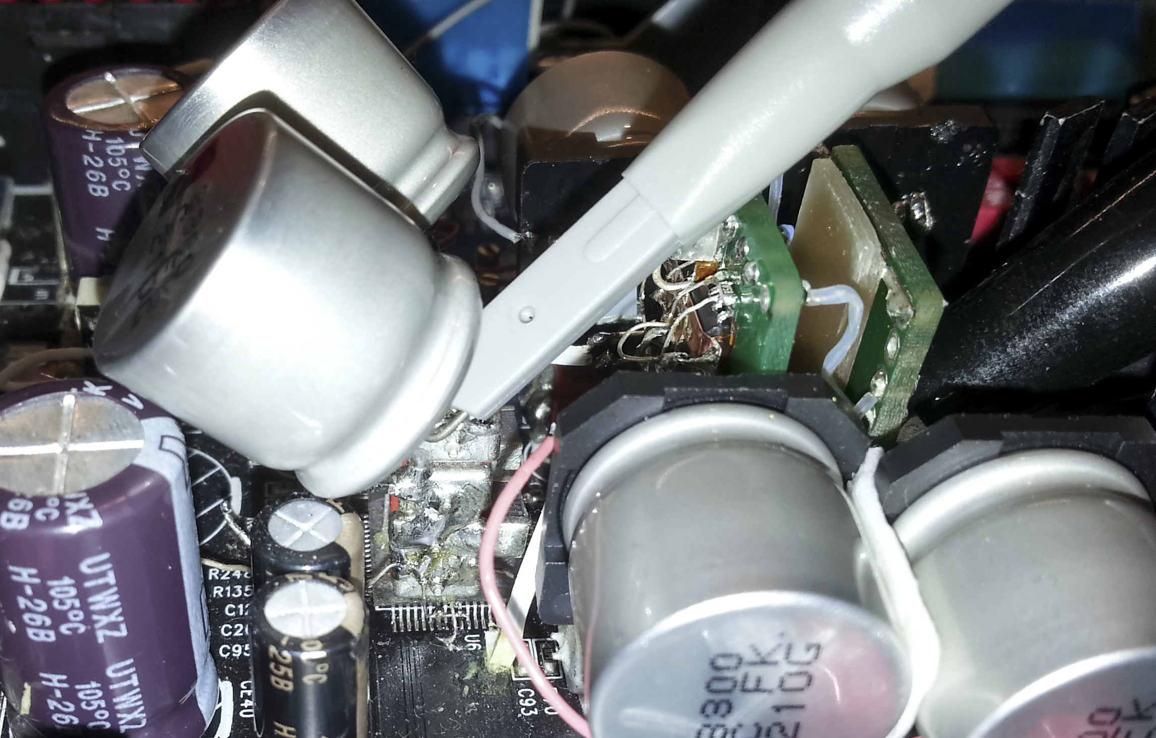

PS. Some more details about the last picture. One may have impression of a quite long connecting wires. The picture is enough enlarged. In real the length of connections is between 2 and 3 mm. There is much better connections than the PCB traces. The wires are silver and bigger section than the traces. The routing of the wires it may be even improved. It is to be seen in the picture a ground plane under the caps (over the chip)...

My main concern would be the increase in inductance with the wires.

I really do not know what you refer to about that clock at the end of a 6" single core wire...
It may be a misunderstanding here. Have you seen something like this in the pictures I have published? Or I have claimed that a such configuration is something reasonable?
I just sustained the opposite about long clock traces. As you may see in one of my pictures, I have soldered the oscillator output directly to the chip pin...

I have used this time quite common, but low ESR aluminium caps soldered directly to the chip pins. Low noise voltage regulator for AVCC, at 3,8V. The DAC is running by a 108Mhz clock. This clock frequency is lower than I have used before. The reason is that this frequency is divided further for another functions, but not because the 125Mhz which I have used earlier it were not a well working frequency. I`m actually excited to try again 125Mhz in this quite large decoupling setup...

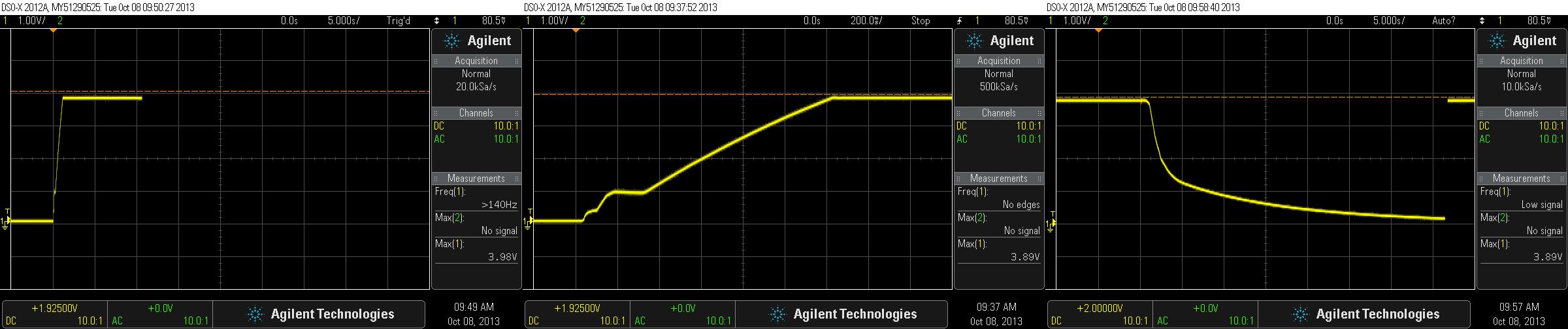

May I ask you the following points?
1. How many times you have ever turned the power of the system on/off ever?
2. Have you observed a voltage change profile at an AVCC pin of the DAC chip by an oscilloscope at timings of power on/off?
3. What measures have you taken in order to discharge the cap after power off and to mitigate a possible high rush current at power on?
4. What kind of regulator do you use and how is the capacitance value of decoupling capacitors placed at the input side of the regulator?

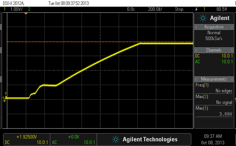

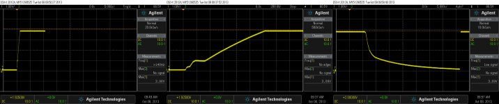

I just turned on/off many times my system to make some pictures of the AVCC. You may see the snapshots her... There is another picture with the measured environment (it may not looks very nice, but is an experimenting area...) So, the nr. 2 question is answered...
The question nr. 3 is partial answered too. The high rush current at power on is fixed by the regulator current protection.
The regulator is LT1763, and the filtering caps before this regulator are of teens of mF.
Of course if is about using even larger capacities on this AVCC, one may take some special steps to take care of possible issues you may thinking about when asking the questions above.
Else you are welcome with another questions too... Or maybe give it a try to this idea...

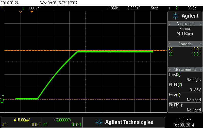

There is pictured here the start up sequence with this cap, and beside for comparative reasons, the previous start up snapshot of an approx 5000µ decoupling cap.
An interesting observation with this huge AVCC capacity: In power off sequence, the very stable regulator tension it rise up with approx 10mV, before the cap discharge process starts and goes low very slowly. The decoupling cap is connected directly to the AVCC pins of the DAC chip.
This slightly rising of the regulated tension when the chip it loose the another power rails, I explained as the AVCC line of ES9018 it is completely decoupled from the power source, or do not show any load for the regulator. It is like a relay contact which is switched off into the chip, and it cut completely off the AVCC load from the power source. Then, after a second or two it start the cap discharging curve.
I have also noticed, looking at these start up sequences pictured here, that in case of a 5000µF at the AVCC regulator output (with the chip connected), the regulator`s current protection it is working (stair in the ramp up). This protection seems to have a different behaviour in case of this 0,4F cap on regulator output. So far I do not have any interpretation for this behaviour... Anybody with a explanation is welcome.
