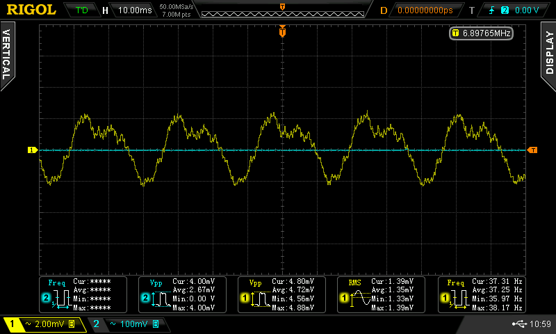

I have measured current draw on DVDD with the DAC idle, it receives I2S (BCK,WCK) but DATA is only zeros.
The scope shot is DVDD current measured as voltage through a 3R3 resistor. There is filtering to remove the HF, as I was only interested in current draw at low frequencies.
As you can see the DAC is doing something periodic. The period varies between about 15-60 Hz depending on I2S sample rate. As soon as signal is played, the current becomes signal dependent (and very ugly).
I have searched for a pulse train like you found. At some point I thought I had found it, but it was interference from mains.
I used a 1x probe with long ground wire and clip. This kind of setup is prone to picking up all sorts of crap, so it must be re-checked :
- I probe a signal, then I probe the GND close to that point, and GND at many points on the board. If I see the same signal when probing GND, it means it is picked up by the ground clip loop antenna (this was the case with the pulse train).
- I also solder a 50 ohm coax to the measurement point : this gives much cleaner measurements but it is not the most practical.
- Also, setting the scope trigger to Mains Line will tell you if it is interference from mains. If it does not move on the screen, this means it is synchronized to the mains, so it doesn't come from ES9018.
The analog output shows no trace of spikes repeating at around 50Hz.
Well, if I use the long ground clip, it does. Proper probing (coax soldered to output), and spikes disappear.
I connected the scope to the ES9018 output without filter (the modulator levels are clearly visible) and set it to window trigger, with the thresholds a bit outside of the top and bottom of the normal modulator output. If there are noise spikes (besides the normal HF noise generated by the modulator) then it will trigger. I set it to record before starting to write this post, and it still hasn't triggered on anything. I can get it to trigger if I switch on my soldering station (it has a huge transformer inside) but that would be expected...
So... I think your noise spikes don't come from 9018...
