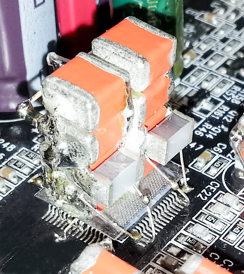

Improved design for the idea in first picture of this thread...
2x4000µF tantal decoupling on L/R AVCC (3,8V) of ESS9018. No different local regulators, but one low noise for both analogue rails of the chip.

funny, the aim seems to be to be close to the chip and the point of SMD parts is to have low inductance, but the leads to connect the chip are longer than what is possible just using leaded caps next to the dac ...
The effect of 4000uF pr. channel on the AVCC are most possibly much more important than the tiny inductance caused by the 4 - 5 millimeters of wire - the original decoupling close to the chip are still in action..
I expect this "modification" improves the fidelity greatly as the AVCC also are the DAC reference and now the -3dB point of decoupling are moved several decades down in frequency...
expect all you want, give it a decent reg and the 4000uf is completely meaningless, but it sure looks 'pretty'...
You completely missed the point, the point was that here we have SMD caps that are designed this way to be compact and low inductance, because they have no leads ... but the way they are used here means the leads added to them are longer and more inductive than if a 4000uf leaded cap were placed optimally with trimmed leads. (if indeed a 4000uf cap here could be called optimal under any circumstance, but lets pretend it can be...)
there is no point using SMD caps if you are going to add leads to them. those tantalums wont be terribly cheap either and you are paying for attributes that are wasted in this format.
there are better ways to get the noise down, a simple passive composite filter with much less capacitance would do better.

It is true that the clue with the SMD ceramic caps in my first picture/try placed so near to the chip as possible, it were to lower too ESI as much as possible. Of course it is not possible to connect those caps without having some wires in between to the chip pins. The problem with the ceramic caps is that their capacity is temperature dependent. The capacity get lower when the temperature rise. The DAC chip it not run completely cold. So...
Using tantalum big capacities, one get rid of the temperature problems, when placing those right on the chip (shortest connection possibility, when the PCB is already designed for another decoupling solutions). One advantage more using those caps is that one can have bigger capacity for the used place, than it may have using ceramics.
One such tantalum cap have an ESR of 0,08 ohm. So totally is there 0,002 ohm ESR per total 4000µF capacity. Those caps are specially designed for the lowest possible ESI. The wires introduce an ESI value, but for all the system that is extremely low (when is almost nothing for the caps it self).

PS. Please note that the AVCC pins of the chip are lifted up (unsoldered from their tabs) and connect directly to the caps and further to the power. The GND of the system it still be intact, connected to the board. The caps are independent for L/R connections to the chip.
I may recognize that the connexions pins - caps it could be even shorter, and the wires should be routed other/better ways. I have done not very well there, but I will remember next time...😉
Coris, erm... just what do you think your cap is? its not a filter? you do realize i'm talking about a filter on the AVCC regulator yes? you think there are not lumped R, L, C elements in there already and you have just put a cap there? you think adding small parallel caps to the larger caps after lifting the pin means the smaller cap will actually do something? you think that mΩ impedance means something here when its some cm away? wow... youre just making your rhetoric up as you go along...
and I cannot help you either Ray, if after twice explaining the same thing very simply you still dont understand... you somehow think that just throwing the largest cap you can at the problem is useful when you can make a better filter... if your regs need caps like this to make low enough noise, then you have issues. you think there is only differential effects here? you think installing a contraption on top of the dac, stacking caps upwards makes the path short?
you didnt see he had done this? meaning the local decoupling has been taken out of play and the stack of low impedance caps connect to AVCC through a wire and are grounded through a wire, the current path is very long and now where is the IV stage return connecting? given unbroken direct low Z connection from the IV stage is recommended and the AVCC pins are lifted... I wonder how well the regulators like feeding a 4000uf inrush...
