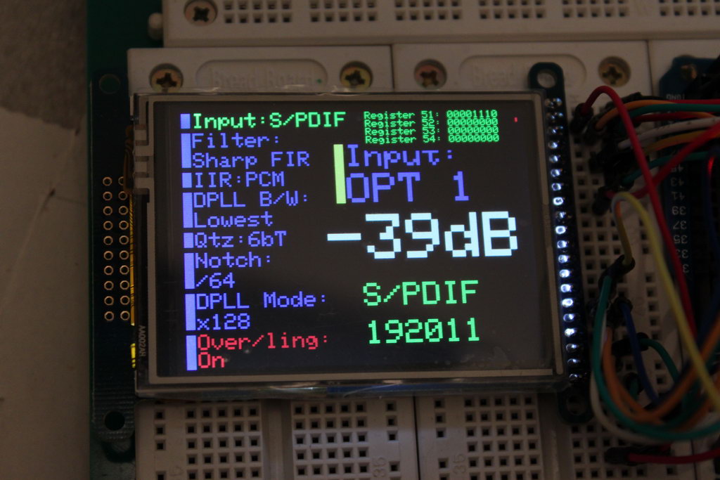

Hi guys,
Has anyone had any luck making sense of the Registers #48-71?
They are supposed to provide a lot of information on the status of the s/pdif channel like clock accuracy, sample frequency, word length, etc.
I am not having trouble reading them, but I'm getting a bunch of 0s on most of them that don't really seem to match up to the data I should be getting according to the datasheet.
I am using a modified version of the Hifiduino code on a Mega with a 2.8" TFT screen.
(btw, great job glt, I am really greatful for the code)
Here you go:
attachment.php
Obviously it is still in development (and on a breadboard 😛).
The only useful information that I have managed to get from registers 48-71 is the sampling rate (see Register 51 above).
I was hoping to get some more info but the rest of the registers appear to be all zeroes.
I assume you ordered the ITDB02-3.2WD, right? It's a very attractive display. Does iTead have any sort of an ETA on the library?
Regarding the registers, I am guessing that since they exist and are read only, it would make sense for them to actually contain data. For instance, the word length.
I have not gotten to the filters yet.. I have put on pause the development of the controller since I'm busy building the actual DAC (B III).
