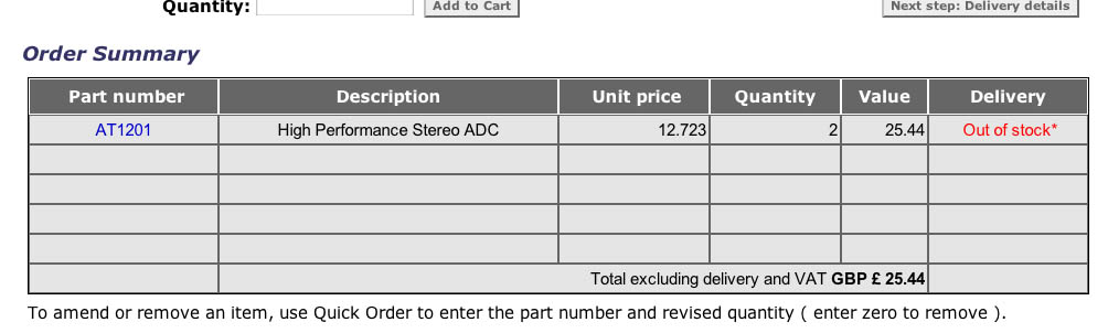

yes, but the company has been disolved, so to buy these chips will not be easy. its possible that profusion has stock, but they also said they had stock of the semelab lateral mosfets all the way through the period where they had none. I suppose I can email and ask if they are real
yep, as I thought, I just loaded some in my cart and its out of stock, so they are not available anywhere, you may have the last ones. looks like i'll go with the ESS, I wanted to try something else, but I suppose the ESS ADC is best for ESS DAC interface, but no DSD 🙁
so in answer to your question, no i'm not glad someone else is taking the risk for R&D. i'm mad at the corporate company that bought them up and stopped their products from getting to market for diy, not you... its my fault for hesitating, at the time i thought it was possible i could get some elsewhere, but that has since proven impossible. I hate thesde companies like profusionplc and farnell/element14 that list products they dont actually have and dont show you till youve decided you want to buy them
