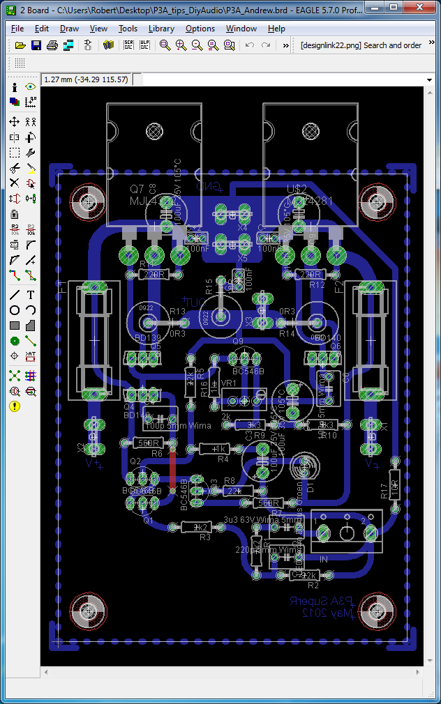

Pff, new day, new chances. Shorted the input, measured AC and now I get a 0.0 mVac sometimes going to 0.1mVac. DC offset around 4 mVdc. Maybe it's time to put the amp aside for a couple of days and rethink the layout and measurement methods.
The current layout is attached below.

I'm sorry to butt in here guys. I'm also trying to make a layout, can you comment on these, which one is better? thanks
You can download and try the first one here

If I understand the comments made earlier correctly, it is advised to split the powergnd and signalgnd.
But if I recall correctly, you had already made a channel right? If so, why not try to measure some sort of performance?

I prefer the layout of Jlester 87
I didn't split the power gnd and signal gnd because it requires major changes to my current layout so I have to make compromises to the design.
Also, I can't measure the performance because I don't have proper equipment(s) to do so, and I don't have an oscilloscope here to check for oscillations, that's why I'm posting my layout here so that anyone can try and check the layout's performance. (I'll remove it soon, for respect to rod elliot)
Your layout is also good, I won't be surprised if it performs better than mine...

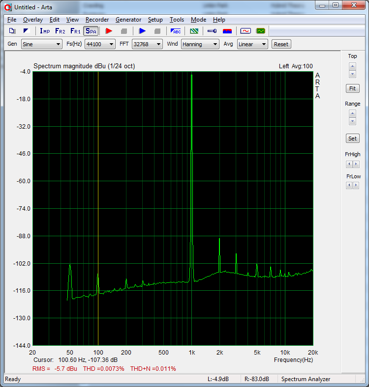

Take one torroid, 2 caps, 4 diodes and you get a better measurement than with a 400 dollar power supply.... I cheated a bit by using an iPhones battery operated signal generator, but when I used the iPhone with the labsupply I got 50-500 Hz noise, with the simple torroid that's less.
THD+N is around 0.012% at 1.6 Watt (3.9 Vac over 9.4 Ohm)
Update;
And adding 2*10 mF caps damped the 100 Hz peak by over 5 dB and 50 Hz by 4 dB. We are making progress. 4 days the output looked like http://www.diyaudio.com/forums/solid-state/212342-esp-p3a-layout-4.html#post3040762
Update;
