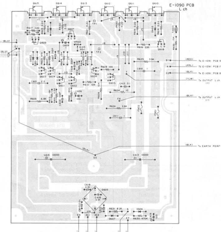

Look at commercial PCB design, it's revealing.

One example from a simple Rotel amplifier. It might not be optimal in every sense but at least the Rotel PCB designer avoided spacing the rails. The good old NAD 3020 is another classic example worth a review.

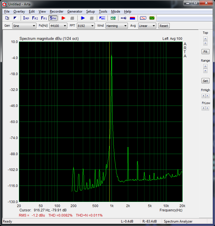

I redid a bit of the layout after reading your comments and this morning made another pcb. It performed similar, lots of 200-800 noise. I want to lose that noise. Since I have fairly efficient loudspeakers and would like to use more than 30% of my volume control, I tried to lower the gain. That resulted in a larger volume control action (obviously) and seemed to drop some of the noise. THS+N is now 0.02% And the low frequency noise has peaks to -90dBu.
Can you also post a black on white traces only PCB layout?
I can't find the Power Ground, nor the Signal Ground, with all that noise (devices and notes & labels) superimposed.
The FFT shows a lot of mains hum and buzz. There is still something wrong.
Have you measured the noise on the amplifier output with the input shorted to signal ground? What is it?

The measurement is a 1kHz sinewave, going from my pc, through my pre-amp, to the P3A, to a load (around 10 Ohm), and scaled down to not overload the soundcards linein. Without the amplifier in the measurement-loop the noise is lower and the only low frequency peak is at 200 Hz.
By adding the amplifier 200-800Hz noise is added.

something is imposing all that noise on the FFT results.Ow and the PSU is DEAD silent. I measured the voltages and I cannot find any noise. It's a Voltcraft labsupply.
Measure the amplifier alone.
I do not have a proper spectrum analyzer. Therefore I MUST use the pc+preamp.

What is the mVac and mVdc using the 199.9mV scales of a narrowband DMM. It does not need to be an rms measurement. An average reading DMM is good enough to give us and you a good clue. A reading of 0.0mVac means that the narrowband noise is <=0.0499mVac
If that includes all the hum and buzz and all the 40Hz to 1kHz noise and a proportion of the 1kHz to 20kHz noise then that is good enough for first assessment.

I don't have a narrow band DMM. It goes up beyond 20kHz according to the specs so the results might be a bit pessimistic. Shorted, well the end of the 20cm coaxial cable is shorted, gives me 0.3 mVac. Dc is a disappointing 30 mVdc. It was lower in my previous design, but it's a "Work In Progress" right?
Ps. I posted a very low noise picture earlier when the input is shorted, that one is not correctly measured. Noise is around -100 dBu
