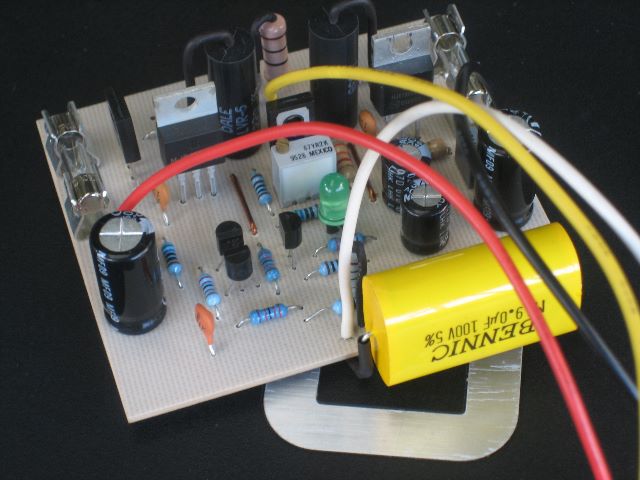

You just summed up about 50% of the questions on the Solid-state/PCB-ing department. Fortunately I ended up with a nice result which does not only work well but seems to measure nicely on THD+N. The comment that really boosted performance was that of adding a 10R resistor between powergnd and signalgnd. That impact could be measured in the low frequency regions.

The amp is a 90% copy of Elliots P3A and the pcb layout and schematic adjustments have been made by me in order to make the pcb fit vertically in the 80mm high enclosure.

This is my current layout. Maybe with some minor changes but the basics are there. http://www.diyaudio.com/forums/solid-state/212342-esp-p3a-layout-10.html#post3043548
Instead of the BD139/BD140 I have used MJE15030/31, for the output I have used NJL21193/94 and the other transistors are BC546B. Input caps are just cheap 0.30 $ /piece items so the most luxurious item are the output transistors.
In practice DC offset is around 4 mV. The layout is not 100% to my likings, but so far it works nicely.

I'm surprised you're quite right very simple...thinner traces so similar to the original P3A board perhaps Rod was right in saying...."Note that the layout of any power amplifier is quite critical, and great pains were taken to minimize problem areas - if you make your own PCB, it is unlikely that you will be able to match the published specifications."
It's up and running for about a day or 2 so it needs some work and testing but so far it's performing quite well. I still need a proper dummy load and attenuation so I can record the output on my pc. The story isn't over yet but so far I am pleased, especially about the clean look.
