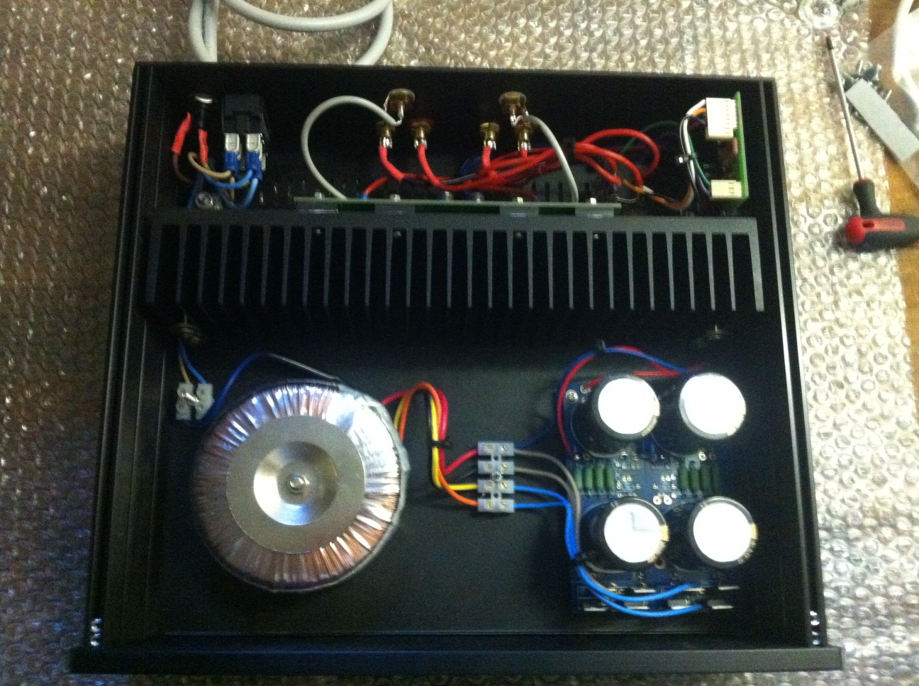

Well I finished the wiring over the weekend, testing everything as I went. I'm pleased to report that everything worked 100% first time.
Quiescent current is set to 75mA, in accordance with Rod's instructions. The heatsink is barely warm to the touch when the amp has been idling for a couple hours. I'd say its only a couple degrees over ambient - if that.
Here's a few grainy photos I took before putting the lid on. I'll take some better ones soon and update this thread.

Great that it all works without drama, Ranchu. Enjoy!
With all that sinking, you won't have heating or stress problems but take care to trim the excess of output leads, power leads etc. Route power well away from input/output leads and twist the DC Power leads for each amplifier tightly together back to the power supply to limit spurious noise or possible instability. Obviously, for very short runs, there's not much point trying.
'Just standard design procedure, really. Don't forget to give us a listening check!

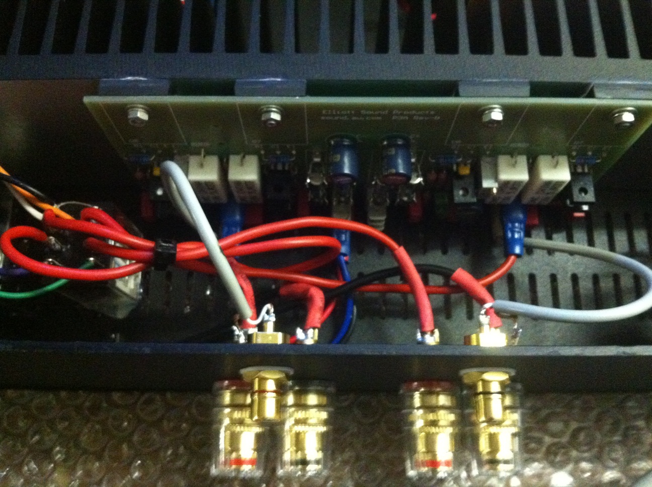

I've tried to separate the high voltage, DC power, low level signal and speaker wiring as best I can. A few points:
- I have +35VDC, -35VDC and ground lines running from the amp module to the PS board.
- I have a separate speaker ground wire from the terminal back to the cap bank "ground plane" also.
- There's a 25VAC wire taken off one of the transformer secondaries that runs alongside the DC wiring into the loudspeaker protection circuit on the top right of the board.
Which wires would you suggest pairing/twisting?
There's actually not a lot of space between the amplifier board and the back of the case! Nonetheless I am going to try and shorten/reroute the wiring to improve separation.

Ian, I've only had the chance to listen for an hour or so. I'm no audiophile and find it difficult to express in words the difference between audio components. Suffice to say, from my test I am impressed with this amp. Compared with my Marantz AV receiver, I would say stereo imaging is improved; instrument placement is distinct. Lower frequencies (e.g. bass guitars, kick drums) are pronounced and crystal clear.
I tested it using high quality FLAC material output from a DAC directly to the P3A's inputs and the software volume control set about 25%. Connecting a CD player directly to the amp inputs resulted in far too high a volume (I need an attenuator or preamp before I can test this source).
Perhaps the most interesting observation is that the outputs are dead silent even with the volume set near maximum. At the same settings there was always a slight hum from the speakers, which I assumed was the source. Even with my ears up to the speaker cone I can't detect even the faintest hiss.
I suspect the amp as built lacks the power to drive these loudspeakers to very high volumes. With the software volume control set to levels somewhat higher than normal listening levels the quality deteriorates, particularly on material with a lot of bass. The outputs don't clip like some amplifiers I've heard when overdriven; rather the sound slightly muddies.
All in all the sound quality is excellent and exceeds my expectations.

As posted, the DC power rails (that's +/- 35V rails from the power suply to the amplier.....Which wires would you suggest pairing/twisting?......
The rest, I think you will understand well enough, realizing that low current, smooth 50Hz AC loads are much less of a problem. It's about the power being switched and how quickly, all the way back to the mains socket. Big offenders also being the rectifier, smoothing caps and their leads which you have already taken care of.
By way of explanation; In a class AB amp, the +/- rails alternately supply positive and negative halves of the output waveform, so they switch on and off sharply at the crossover (0V) potential and this action causes a pulse to flow alternately from each rail, even with nice, smooth sinewave tones. The pulse generates significant electromagnatic radiation (EMR) from the leads which is picked up by the amp and any other nearby sensitive circuitry.
Twisting the leads together effectively reduces the EM field strength which is a reduction in unwanted distortion. This is not restricted to just power leads - it's critical to PCB design layout that output stage and feedback is arranged for minimal interference by the placement of traces and ground routing but this is for the P3a PCB design thread guys to worry about, because it can easily make the difference between high-end and so-so sound quality.
I'm sure Rod Elliott has covered this in his articles and just in the last week or so, Bob Cordell discussed the lead twisting matter in one the threads he frequents -probably the book thread. Maybe one of the Randy Slone, Douglas Self or Bob Cordell books would be a good read and help you make your own mind on this stuff, even if you don't find technical stuff easy going.
