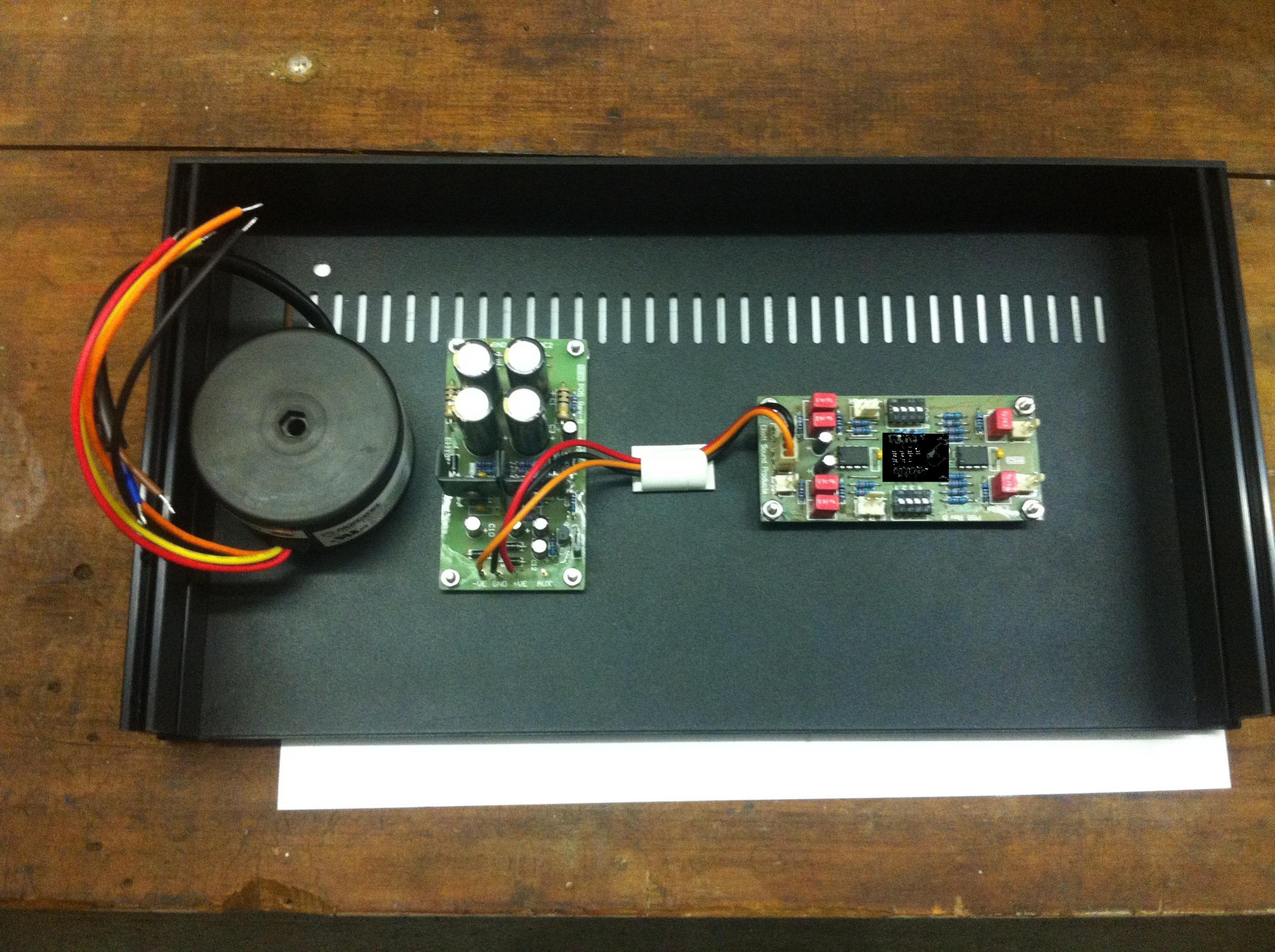

I twisted every flow/return AC line and also the +/- DC power lines as suggested by Ian and Andrew. I also shortened and tidied up the other cables as practically possible. No noticable differences found but then none expected.
After some critical listening I did encounter something amiss with the treble, present only on some female vocalist tracks. Its difficult to describe: a "harshness" or distortion perhaps. After some research and investigation I realised that while all the ground lines were taken back to the filter bank capacitor bank, I had not connected the ground plane to chassis/earth ground! I have since remedied that and the distortion seems to have disappeared. Is it plausable that this could have been caused by improper earthing?

Finished P3A-- sound impressions
I have been listerning to this amp for about 1 week.
I use easily available parts Elna silmic 10 Uf input cap, panasonic FC 220Uf on board power supply caps , BC 546, 556, BD 139, 140 and 2sa5200 and 2sc1943. The transistors are matched.
I biased it at 75 ma.
My speakers are easy load 91db/w open baffle with powered subwoofer--V2 from GR Research. The source is Monica step ladder dac from diy paradise with Luckit usb to i2s converter.
My previous amp is a breadboard DOZ, dc coupled ---Shaan version.
I am pleasantly surprised at the sound . Overall impression is clean, clear, dynamic , tremendous control of the speakers.
The high frequency is a joy to listen. Bells has very nice ring and beautiful decay . Plucked string instrument such as the Chinese pipa has a nice bite with nice resonance from the box.
Mid is slightly lean but this is counterbalance with the MooseFet pre from Classic valve design . With this pre, mid range detail is amazing. opening of lips from close mic recordings are easy to hear . Singer is slightly in front of the musicians and well separated . Sarah Brightman's voice is seductive !
The bass is very tuneful and deep bass is well controlled. With big drums, the stick hitting the skin of the drums is well resolved. This is followed by the echoes in the recording room.
The set plays rock, classical and vocal equally well.
This amp changed my perception about class Ab amp. My previous amps are F5, alephJ, JLH69, and numerous Class T amp from 41 Hz..
