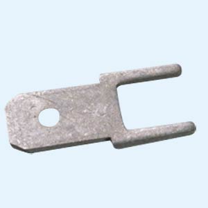

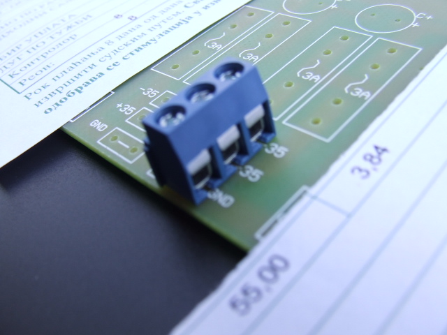

These can fit on stereo board, back to back, using outer three holes. But, I would never use them because PSU cables will be bended too much and stressed at the entry. Also, faston connectors shall be soldered on two points, that's better electrical and mechanical connection.
😕 Ivan, can you please check the bottom of the board, if not already cut in two?These can fit on stereo board, back to back...
(I can't check my spare until later today) The traces are, I think, common on the bottom, so if Rancho does not intend to separate the channels, only one 3-pos terminal blk and one set of wires is required, correct? I thought this was rather clever of RodE, frankly, but perhaps I remember wrong.
And if you cut the board like I did, then you can allow as much space for wire bend as you need.
Pete,
You are absolutely right! Only one 3-pos terminal is enough for stereo board, meaning that there is enough space for cables without stressing them too much and also meaning that terminal can be oriented any way it is convenient for the builder.
Checked my board and the traces are joined across both sides of the board....
Very happy now as I can go to Jaycar later today and get a 3-pos terminal. Only drama now is the speaker out terminals - I don't think 2-pos screw terminals will fit in those positions. I may just solder them using PCB pins in the packet Rod sent me (although they are a loose fit in the holes...)

Not much besides a tab connector will fit there, you are too close to those large resistors. You can get a crimp style male connector from a hardware store, and use it with a short piece of the same wire you plan on connecting to the back of your chassis. So, you would still have a quick-disconnect. and later you can replace it with the right connector.
You would think so, but what we find in this country is thousands of sellers, retail and internet, selling just crimp terminals for automotive wiring and general use - nothing thru-hole to fit PCBs.This should be easy to find almost in any electronic parts store....
Fixed 0.25" spade terminals will usually be the bolt-on type. Only PCB manufacturing suppliers and one or two electronic kit suppliers offer solder types and these are rare indeed these days. Interestingly, hi-fi loudspeakers may may use impressive heavy cable but drivers and crossovers use only the tiny, 3.2 mm width fastons.

I am really surprised. Serbia is a poor country and the town I live in is only 50 thousand inhabitants and yet there is electronic components store at 5 minutes walk from my home crammed with everything diy-er needs. There is even this same pcb faston in 90 degrees angled version! And there is also both 1 mm and 1,3 mm pcb pins both male and female.

Specs on the screw terminal is 13.5ADC. Under these conditions already it will be rated at P = 13.5^2 x 8 = 1458 watt. For AC signals it would probably be fine for more than twice that.
Yes, agreed, but I think the OP was talking about a 1-mm square pin (!).I think you are fine using those screw terminals. Maybe you should consider how thin the PCB track is compared to speaker cable and how thin the speaker coil's wire is compared to speaker cable.
The screw terminal does not fit on the footprint of the output connector. It only fits on the footprint of the power connectors... this is why not being able to post board pics is a PITA!
