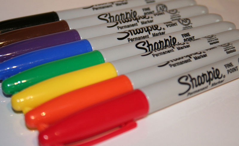

There is a local supplier here in Fort Worth that I can get a gallon for $60. Not too painful. I could certainly send some out to those interested in experimenting with the understanding that they would share their results. I don't think the Post office would have any issues with mailing floor polish.
Assuming the chemical makeup of Techspray 1720 floor polish is very similar to the Prostat DFP-410 then to make a suitable high resistance coating:
1) Take 350mL of 1720 and add contents of one permanent marker. Sharpie markers should work? pick your color?
2) After mixing, dilute somewhere between 1:5 and 1:10 with distilled water to get the resistance you are looking for.
3) Application by rubbing on with cloth. Circular motion like waxing a car? or long extending strokes like painting?
Sound about right?
I like the idea of being able to mix up a lower resistance solution to use on the edges and around the perimeter of the panel. Then switch to the higher resistance solution for the active area of the diaphragm that will actually be moving and under the influence of the stator's electrostatic field.

Capaciti, the marker pen was added for better hardening, and as I remember it, one of the many markers I used was very big and had zebra stripes on the label. I do not remember the brand.
To much ink destroyed the conductivity.
Bolserst, do a test first without diluting and marker pen.
After that You can experiment with different marker pens.
I always used a ordinary foam roller when applying the coating, rolling very slowly to avoid small irritating bubbles. I recently have discovered is that its good to warm up the coating to fingerwarm before applying.

Jonas,
Can you describe what you mean by hardening? Did the DFP 410 remain slightly soft or tacky without the marker pen additive? or did it just help it cure more quickly?
Also, do you happen to know what chemical it was in the marker that was beneficial for hardening?

The coating cured more quickly and stuck to the film in a better way. Sorry, I do not know the chemical that was beneficial for
hardening.
The coating could be used without adding marker pen ink, but subjectivly, I thought it worked better with the ink. You know, its very hard to experiment with these things, as the test periods may last up to a year!

I did a little research on the Sharpie website to find out what chemicals their different markers use:
1) Standard and industrial fine point: Dyes, n-propanol, n-butanol, diacetone alcohol
described as quick drying, permanent on most sufaces
2) Industrial Magnum and Kingsize: xylene, dyes (these are the super stinky nearly instant drying types)
descriped as water resistant, quick drying, marks on wet and oily surfaces
3) Industrial professional: Nitroparaffin solvent, naphtha solvent, resins, dyes
described as quick drying, permanent on most surfaces including wet, oily, abrasive, and nonporous surfaces
4) Industrial Meanstreak: Ethylene glycol monobutyl ether, pigments, resins, gelling agents
described as waterproof formula, resists fading, adheres to virtually any surface
Other than the xylene, the data sheets indicate that the chemicals are considered non-toxic.
3) & 4) look the most promising to me for improving adherance to PET film.
Anybody with a little chemical background or experience with coatings have any comments?
