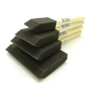

Techspray 1720 Polish (preliminary results)
As Jonas recommended, a few tests with the unmodified 1720 polish are being done.
With no dilution, surface resistance is ~ 4E5 ohms/sq.
With 8/1 dilution, surface resistance is ~1E8 ohms/sq.
I have another test panel curing now with 10/1 dilution.
What I am after is a very uniform 1E9 coating.
The solution is quite easy to apply. It has kind of a soapy feel to it and wets the mylar nicely and uniformly. You do need to go slowly when spreading or bubbles develop that dry in to areas of locally lower resistance. I tried spreading with a cloth, cotton balls, foam roller, standard brush, and foam brush. So far, the foam brush seems to be the easiest to use, avoid bubbles, and produce a uniform coating.
Few said:
Thank you for the report. Do you have any sense of how much mass the coating adds to the diaphragm? Licron, for example, seems to build up quite a bit. How does your solution compare?
Few
The undiluted definitely has some measureable buildup...similar to the Licron spray. The diluted mixture had no measureable buildup. Obviously there is some mass added, but I don't have access to a scale that could measure it.
