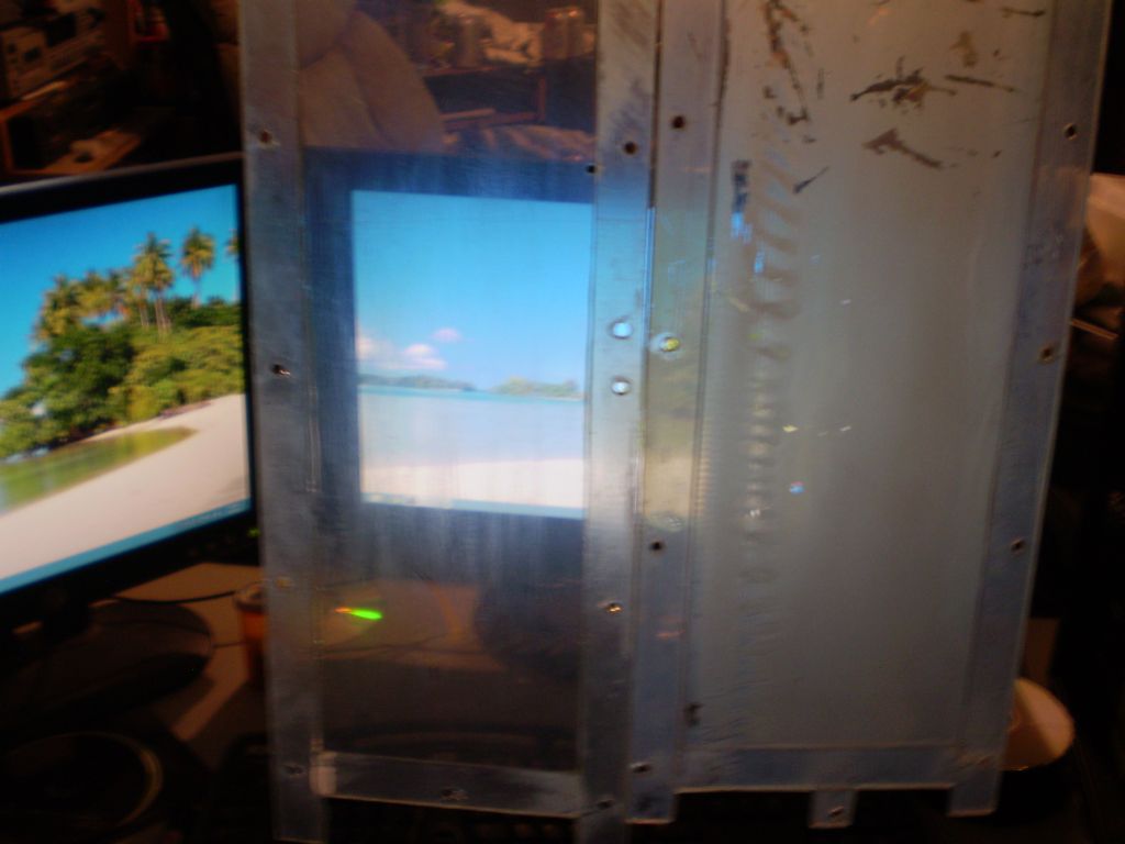

How transparent is it, Is it more clearer than the Licron Crystal that I use?

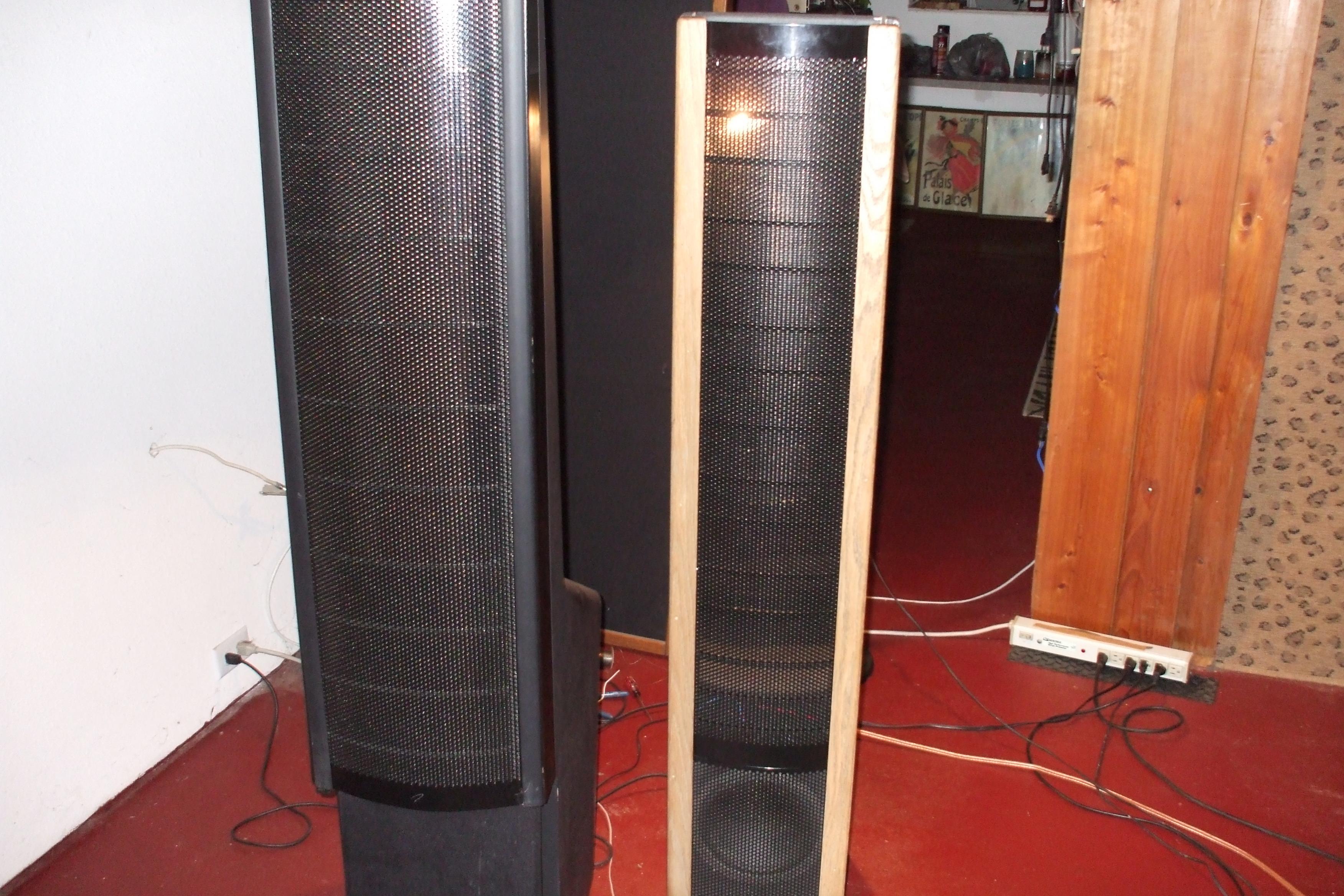

Yes on the Martinlogan you can tell it on the panels...thay look new..Here what i have found...
is any coating that looks like what you have posted work fine but push the mid out..thats ok...it works..an you can get vary high SPL..An some well like the sound.. Even me....but after time i hear that the top is rolled down..
this is how i hear...not sure we all hear the same..but the bass tranzits start at the Vary top on these ESL panels.... thay must have as mucht topend as i can get..here in fl..the air gets wet eze...thay sound dull..that why if you cant open the panels up an clen it or re-coate for get ESLs...
now with the Acoustats panels have a larger gap from the mylar an the panel.. for get the wool type pads on the back...
but with mods to the 121 interfaces.. there good to go with AC on. .as we all now the dryer the air is the better Any ESL works...thanks for the pix

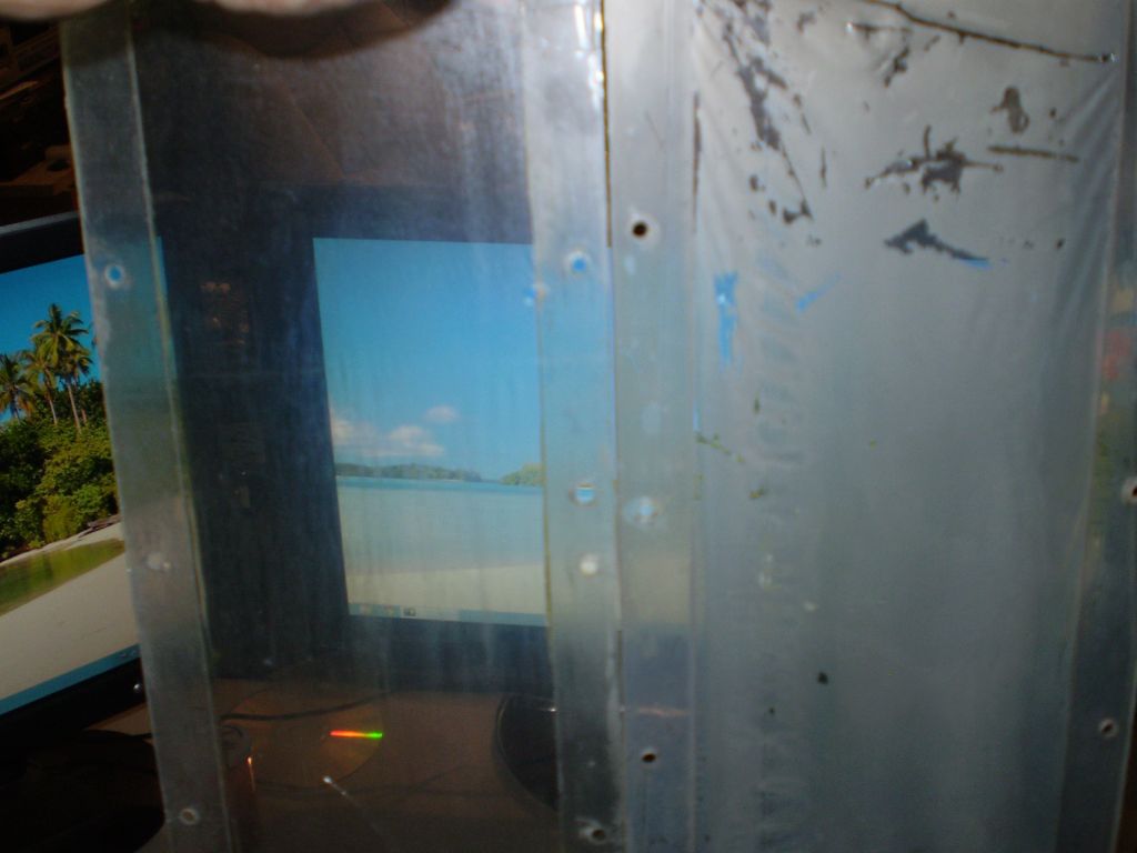

I used tishu..it not hard to work with...i clen the mylar with water...spray the tishu with the t. f21... spray it in a 1-2" line.. One time...an just pull from one sider to the other... not from top to bottem... i go over it twice ...lite coates.. so lite you dont see....Put it togather an play....If you put it on hever i think you get more mids...
I had said befor.... i think it fill the vary small poars in the mylar...look if glass has small pores... mylars dose..
Look ...i think most coatings do this....
But this work good for me.....
Last night i had FM on...thay were playing LPs...gofi...i could here all the surfus noise... like i was plaing Lp,s...Nuts i no....$3. you can do 100 big panels ... i am going to get a nother bottel ...the my chang somte thing in this stuff......
Like Moray James said to me long ago there a lot of wax type coatings out there that well work... it has not been tryed...good luck i hope it works for you..

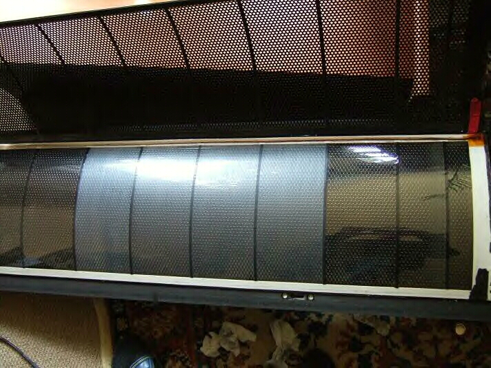

Youll dig this ,... i know your panels are all open...got be the best sound you can get.....
so how do we get a ML or any panel thats output of like 90db at one watt.. to give wider sweet spot ...big 3D stage...an out off about 95db at one watt....
I have working on the ML panels from 95....
ML found tha 9" wide by 40 1/2" tall panel would have some of the best sound if setup right .....
but if thay went with that panel some would never need a biger panel....so the way thay got the panel to put out less was buy adding cross staders....all there panels are setup this way...as are a lot of other panels diyed an so on.....so we know the way the panels are put to gather is the Mylar is glued to the [back] only... so all the cross staders are on the back ....thats were the glue is...an althe way around...like in the pixs....
so how i did to get more output out of the panels...was just take off staders after the metel was formed so there way less cross staders on the front part of the panel....this lets the ear hear much more output of the mylar...an the sound is much sweeter..an matchs the base driver just like it was a ESL also....
Now some well say... an on paper it may... the front staders have more to do with panels sound.. than just the output..... well all i can say... is if you get any panel of ML part...give it shot....
I think people like Jazzman an others has had the sound from day one... has to be even better ...with there panels setup like the Acoustats with NO..cross staders....on the mylar...
In the pix... of the front part of the panel you can see theres one cross stader in the middel...
the spekar i have working now an sound the best yet... have 3ea are the top an 3ea at the bottem only...
This coaeting has give me the best out put yet......have fun... keep diying ESLs

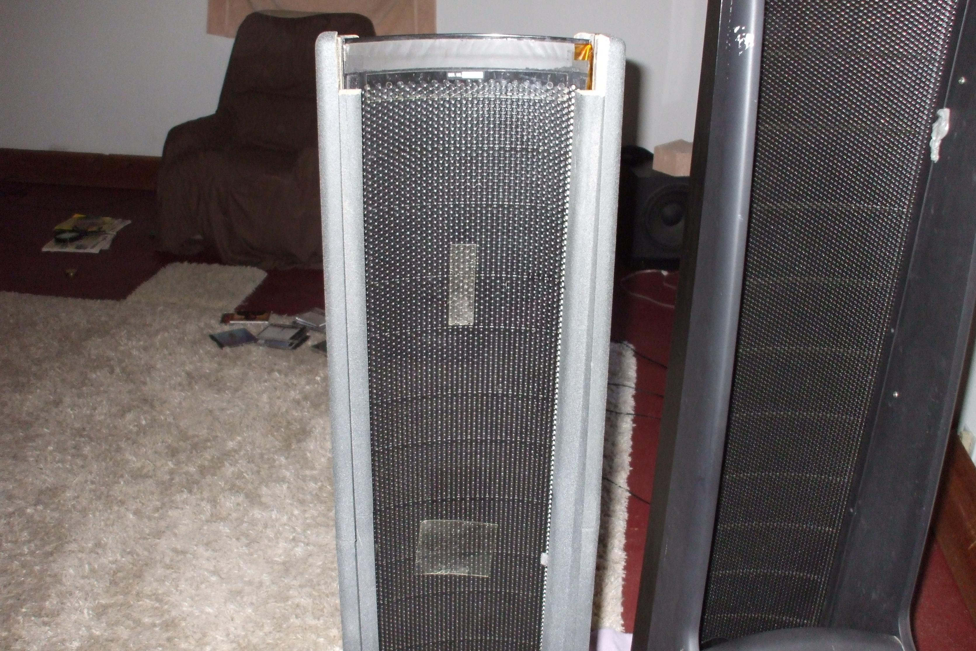

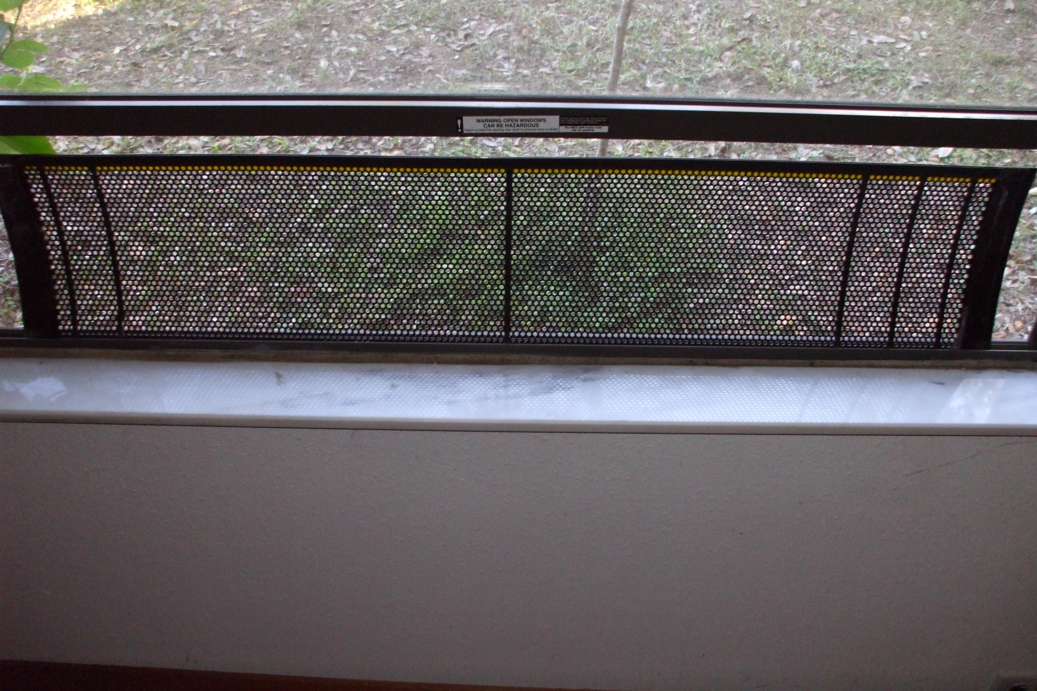

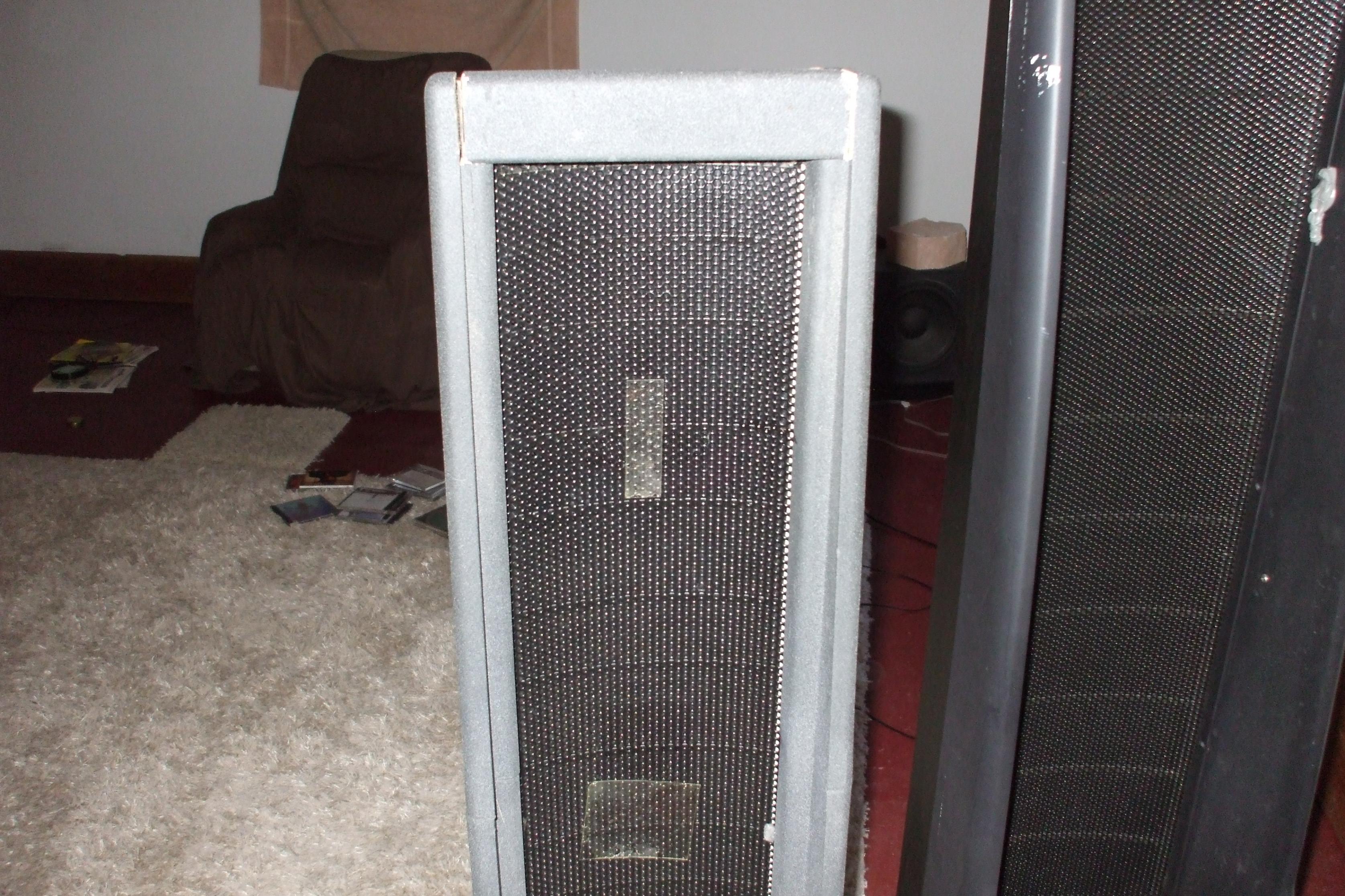

Here are the Aerius i...
I have had these from the 90s...cool thing.... this pic is when the panels put back to gather after this mod.... it looks like all the staders are there..cant tell there out.......by looking
.An i posted about this mod on the back bar of the speakers at the top..
one more way to cut output....
But on the biger Logans like the Ascent i... it get to much...well if there is ...too much...of any thing...... the stage GETS REAL BIG.....but it just 6 small swres...an you take it in an out......
On the Aerius i this remove of the top bar.. works like a charm...an you can add it back if you
like...
these have never souned better....befor these mods there no way i could live with the sound of the Aeraus...Vary Dark sound....like jim powers of ML told me in the 90s when i cap tell him after he sent me free new panels....thay sound no better than the 1 years old one.... look at the panels we did all we could to turn it off.......have fun
