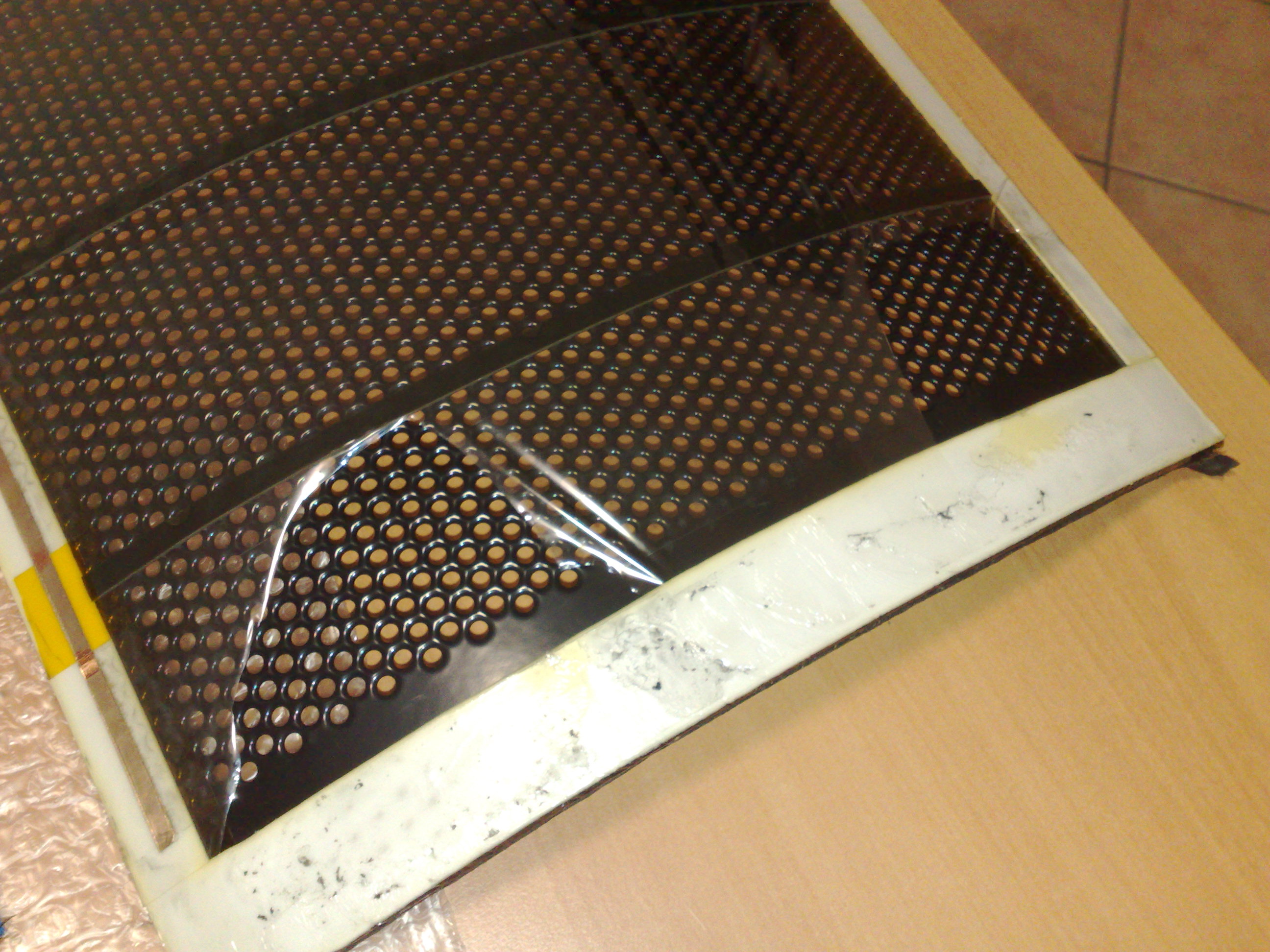

I destroyed the mylar taking apart the ML Sequel II panels
Hello Friends, ... yes, I know, it was August when I said you to be going to do that... but I then waited for the Lycron Christal arrived in October.
Well, today I finally decided to start the job taking apart the Martin Logan Sequel II panels.
Unfortunately, even if I tried to do the best possible being very gently, opening the stators the mylar broken (to both panels).
Herein are the pictures of one panel, but the other is the same.
Any suggestion about? Can I try to keep it in place with some adjustments or have I to replace it?
In the case of enforced replacement, what shall have I to use? I knew there was some 3um Mylar (probably the thinnest on the market), is it the best?
And how to get instruction on the mylar replacement?
Many thanks in advance!
Regards, Andrea

Thay well still work...i have a old pr sl3 panels... look the same.. thay been working for years... you can just leve them as thay are...are cut what left out of the tar mylar.....clen an put the coaeting on..... an new bias feeds an youll get more out than when thay were new... just put tape on the sides of the panels to hold them togather.. so you can get them back apart ...the wood real will hold the togather... or re-do the panes.....i would pass...
Look how clen the mylar is you must have clen it....you my not even need to re-coat....just run new bias feeds...get alumn type duck tape an cut strips....it works gerate.....good luck

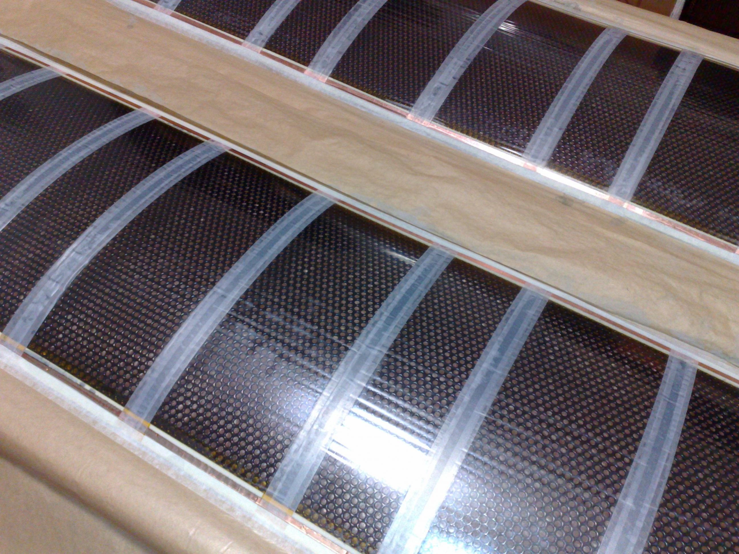

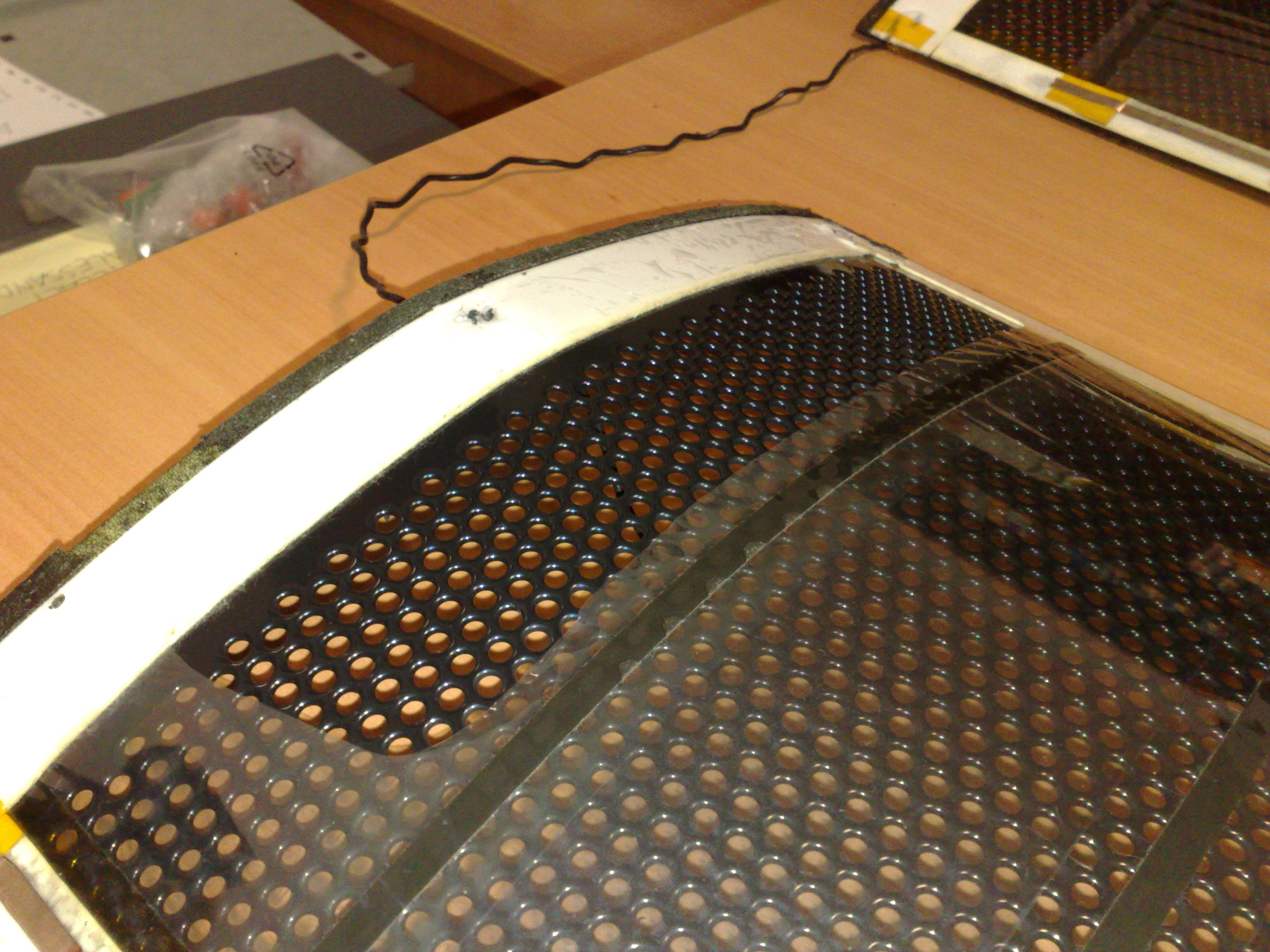

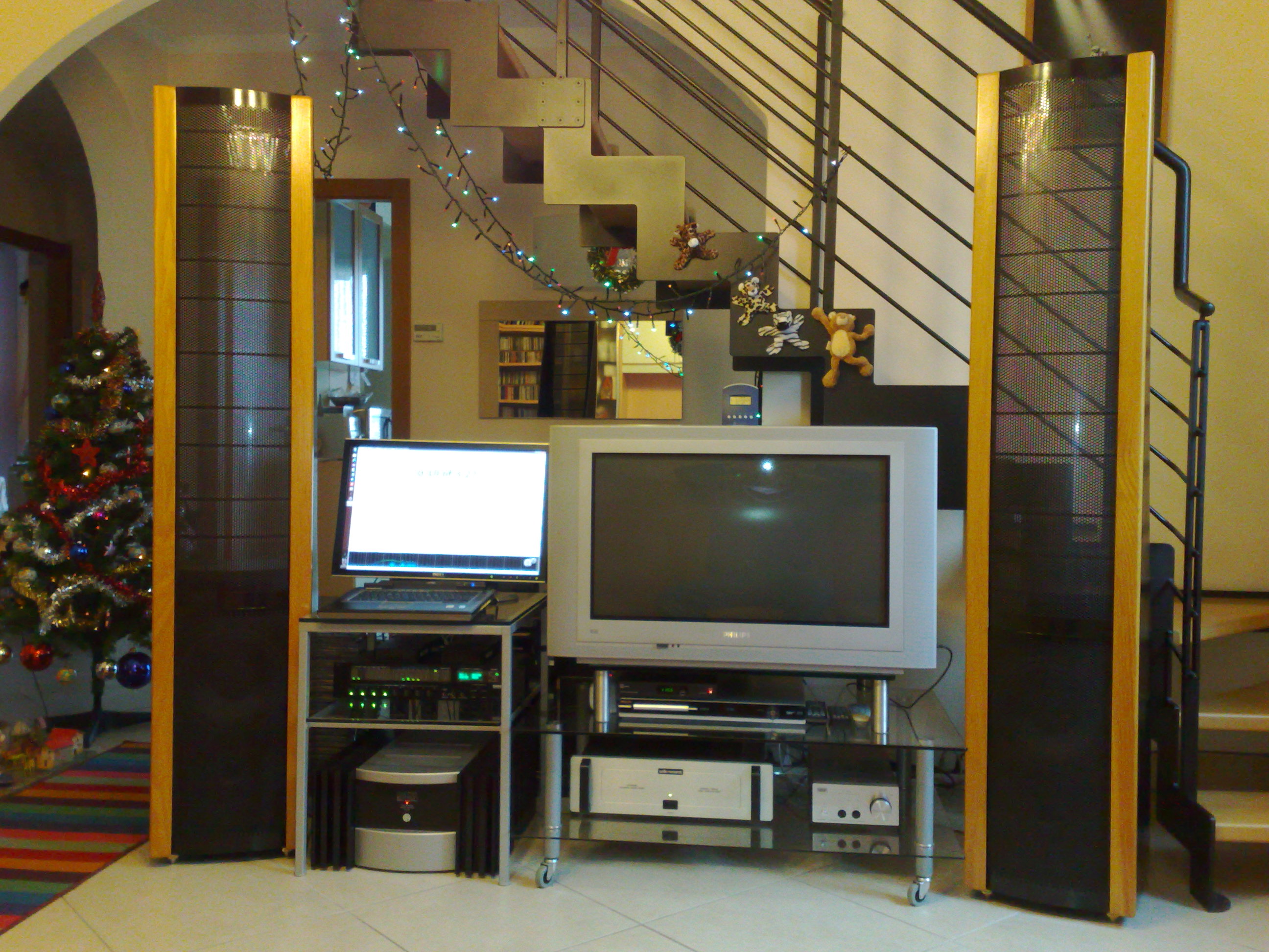

Successful story! The ML Sequel II destroyed mylar-panels back again to play!
Dear Tyu,
many, many thanks for your kind and outstanding support!
Thanks to your tips my "almost destroyed" Sequel II panels are now back to play and even better than before!
Herein a picture of the work-in-progress last-step:
And here is the Sequel II reassembled and playing:
I will wait a couple of day for the Licron Chrystal final curing and for the mechanical adjustment, then I will measure the "new" response/performance and I will post.
Again, many thanks to you and to all the others who helped me in the past.
Kind regards,
Andrea

Hi AndreaT,
I see some wrinkles in the diaphragm in photos. Have you Stretched and removed them, to the last one? Wrinkles give buzzing noises and harsh character to the sound.
By the way, licron crystal is also water soluble, as it seems, even the version that comes in a spray can. Tried isopropanol as well but that just spoiled it completely.
