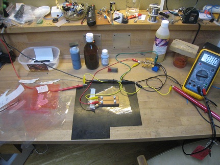

I have just got a sample of Staticide 6300 and a similar product from a local supplier.
I have some questions for you guys who use this coating:
1. How do you apply it to the diaphragm? (spray, brush, sponge...)
2. Do you dilute it ? (if so, with what)
3. What surface resistance did you get?
In my initial tests I got different resistance readings (5x10^6 and 400x10^6) when coating undiluted with a sponge.
/R

I put just a few tiny drops of 6300 on the diaphragm surface and wipe the surface with a damp sponge. I never try to measure its resistance though.
Since it's water base, you can dilute it with water if you want to.

I actually damp the spong with water. I guess I did dilute the solution a bit when wiping with this damp sponge.

I've applied it with the polyurethane foam wedge shaped brush.
Further steps are not that simple.
First of all you need to decide what resistance you need
Second - make samples as many of fellow DIYers have done: paint a strip across mylar strip (decreased and activated - the latter was described as well). After an hour or so (you may use hot air to speedup the process, remember?) using simple stencil made of paper, paint two stripes by graphite 33 over the coated area. Now you've got "Zebra": two highly conductive strips reliably connected to the coating. Let's say 10 cm(4") wide stripe of Mylar, 5 cm wide painted 6300 stripe across, two graphite stripes 1 cm wide and 1 cm wide coated stripe (graphite free) in between. Using DVM as ampere! meter! (usually DVM has fixed input resistance 1Meg Ohm (read specs)) apply around 1kV (using as many precautions as one possibly can) and calculate the resistance using Ohm's law. Readings for Ohm per square can be easily be derived as R(U/I)*Width(10cm)/Length(1cm)
Do not try to use high voltage - edges of graphite stripes are really sharp, so corona discharge develops pretty easily (ozone smell and hissing if you are really reckless) thus screwing your measurements.
That's it - make few test stripes as described with the different dilution factor.
Choose the solution you consider to be the appropriate one.
Undiluted 6300 yields too thick of a coating...
One of the ways to check thickness is to cut coated film preferably at 45 deg angle and use microscope. Knowing the film thickness you can easily estimate the one of the coating.

When my coating samples had dried for two days, the results were a lot better! 🙂
My test setup is:
- PSU 1200V DC
- 10MOhm voltmeter
- Multimeter with 10kV high voltage probe
- DIY surface probe (17x80mm copper rods spaced 5mm for 1:16)
When I measure the Staticide coated Mylar I get ~1 GOhm square - perfect for my needs!

Sounds great. Have you done adhesion test?
With the probe you are using it's near impossible to have reliable contact along the edge. So the painted electrode is better.
Use force drying - it's allowed by TDS: chinsettawong mentioned that naturally dried coating is kinda tacky. I have not observed that though.
The nice thing about 6300 is the very fast resistance recovery after moisture exposure: try to breathe on the coating and measure the resistance change over time...
I tried 2 varieties of soluble polyamide - none had good adhesion whatsoever.
Try moisture test on Elvamide...😀

alexberg:
I put a 1mm rubber sheet under the PET-film and a 1kg weight on top of my tests probe => I get quite consequent readings (+/- 5-10%)

Now I've got som licron crystal I've also done some tests, for me it works best to dilute the stuff 1:5 with methanol and then I apply two layers of coating with a paintbrush.
For measuring the surface resistance it's difficult to make a good contact. The easiest way I found is to just drop some water on the layer of coating. (of course this only works well if your coating is not very sensitive to water)
