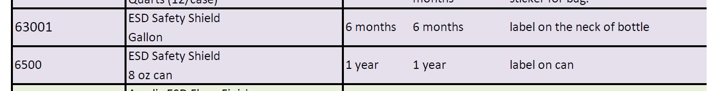

Hello alexberg,
How long have you had your quart of 6300? Have you noticed any changes in its conductive properties?
I have had mine for 1 1/2 years now, and it no longer conducts.
I noticed the datasheet for the 6300 specifies a shelf life of only 3 months.
I contacted the company to get some clarification. Here is what I was told.
The particular type of acrylic polymers used in the 6300 coating are susceptible to bacteria once they are exposed to air in their liquid state. The product will “spoil” much the same way milk will spoil from bacteria exposure after a short period of time even if it’s kept cold. As the product "spoils" the resistivity increases until the the coating no longer conducts. However, once the liquid (while still “fresh”) is applied and dries to a film, it no longer is susceptible to bacteria.
The 3 month shelf life starts when the container is first opened.
Once opened, a 3-6month shelf life is typical depending on how much exposure to air it receives.
Unopened, it should last up to 1 year.
Mine is about 2 years old and no good as well...
In regard to shelf life it's the same you've posted, see attach.
Alex
BTW 2 years on the previous post was about the coating on membrane.
Alex

Why would one expect that self-polymerizing one component varnish gonna be good forever? It's not saline...Hi
So the most stable and longest shelf life is still Licron?
Andrew
Seems that any hermetically sealed product is the proper one...
Water based product can be shipped by air - that was 1st decisive factor for me. Water based product dries much slower and I would never change such a convenience for a shelf life.
There are better materials as well - you would not like the price
On the other hand, also it's a stretch, would you use expired food?
