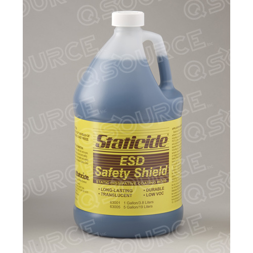

Try to google something like static control products and/or dissipative coating - you well may discover quite a few coatings. Some of them are transparent. Pressurized spray can is not the best packaging either.
Alex
Here it goes (😉 So nobody would sell it by once for a price of a quart:hohoho:)
A year from now, I've provided some hints (like the one quoted above) on readily available coating but chinsettawong was the only one who's listened. And, subsequently used it as well... with success. The coating is called... well, picture is better than words. Looks, smells and behaves almost the same as Aussie staff. In contrast to Li...on, it's water based... easier to be shipped. Exhibits semiconductor-like behavior: the higher the temperature the lower the resistance... Can be naturally dried or baked
Merry X-mas
P.S. it's cheaper than Li...n

There is this version that comes in Quarts at 12 per case for the same cost of 1 gal. of the Crystal formula but I have not tried it yet,
http://www.ellsworth.com/display/productdetail.html?productid=4454&Tab=Products
if this is the same stuff it cost more than licron 1756, also it may have a lower resistance factor as the licron can be as high as 10^9 ohms and the Staticide is rated at a highest 10^7 ohms,But I am sure that it would work fine as well,
http://www.all-spec.com/products/63001.html
http://www.all-spec.com/downloads/acl_staticide/63001_041609s.pdf
