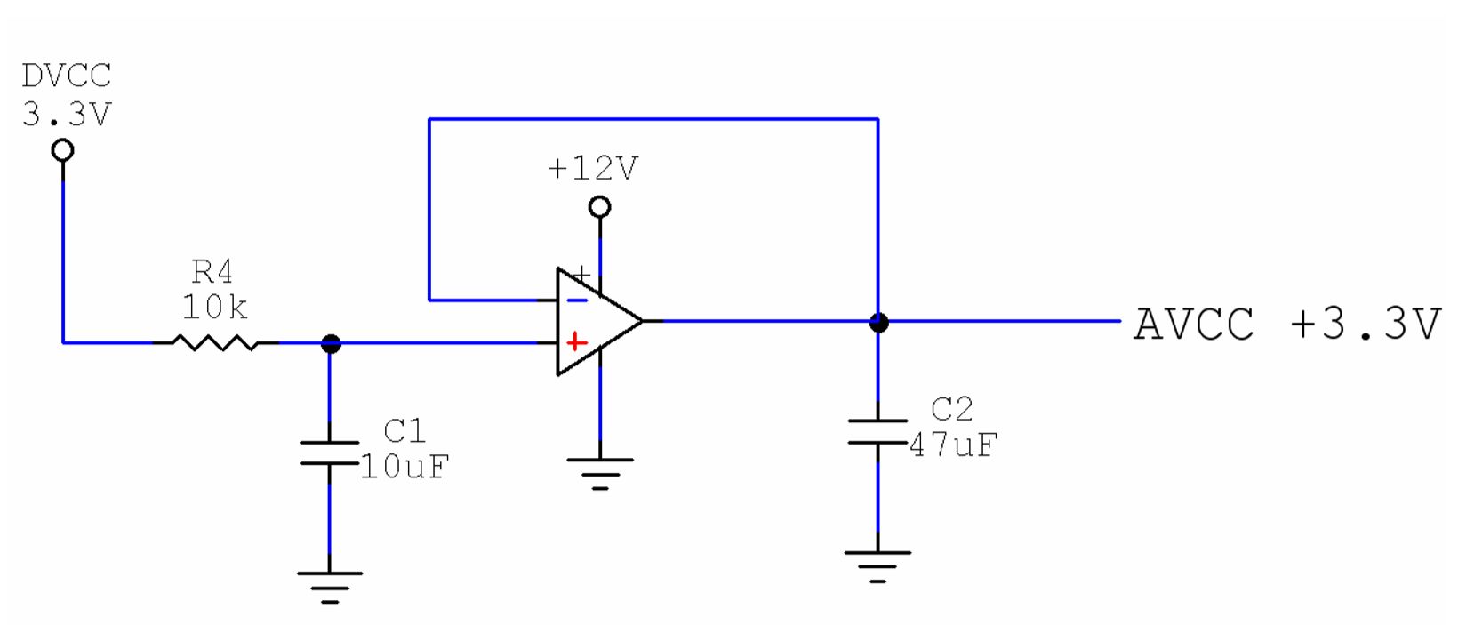

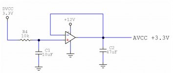

Sorry for any confusion guys. I would think that using Lt3045 as the reference voltage for an opamp AVCC power supply should be okay if the LT3045 output is filtered as ESS recommends. They use a 10k and 10uf low pass filter in front of the AVCC opamp as shown in the schematic below.
If using the LT3045 to provide Vcc for the opamp, then you might need to use a voltage divider to get the 3.3v, then filter that to use as the opamp input.
Also, I would agree that using LT3045 as a regulator for opamp +15v should be fine. It should also be fine for the other power supplies, just not AVCC.
I was just worried because some people may get the idea LT3045 can be used as a quick and easy way to power AVCC.

Mark, have a good read of the LT3045's DS; I haven't done a careful analysis, but you're in the same ballpark of regulation and noise as having a final Sallen-Key 49720, if not better. It's a stupendous part. Edit: spot noise is 2.2 nV/rtHz at 10KHz, so doing better than a 49720. And provides a cleaner layout.
Similarly, the primary motivation to bypassing (and no need for huge capacitance) a battery supply in this application is bandwidth, not noise. There were a couple (I'm having to reach into the depths of my brain) papers from NIST on their autocorrelated measurements and a rather extreme preamp to measure battery noise of larger cells. They're very quiet. Gerhard has posted some of his efforts as well.
Question is, what if I hang 47uf directly on the output of the 49720 as ESS recommends? With LT3045 they say it doesn't help in the data sheet. Same thing true with 49720?
Also, how do you get -122dB noise out of the DAC if AVCC has no PSRR and the AVCC supply has noise right around there or worse? Not clear to me I know the answer to all those things without measuring something.

At 2 nV/rtHz and it's super high PSRR, the lt3042/45 are doing battle with a properly designed 797-level super-regulator. Don't think a low-pass buffer is in that ballpark, but haven't done the hard analysis. At best, we're talking about 4-5 nV between the En and In of the 49720.

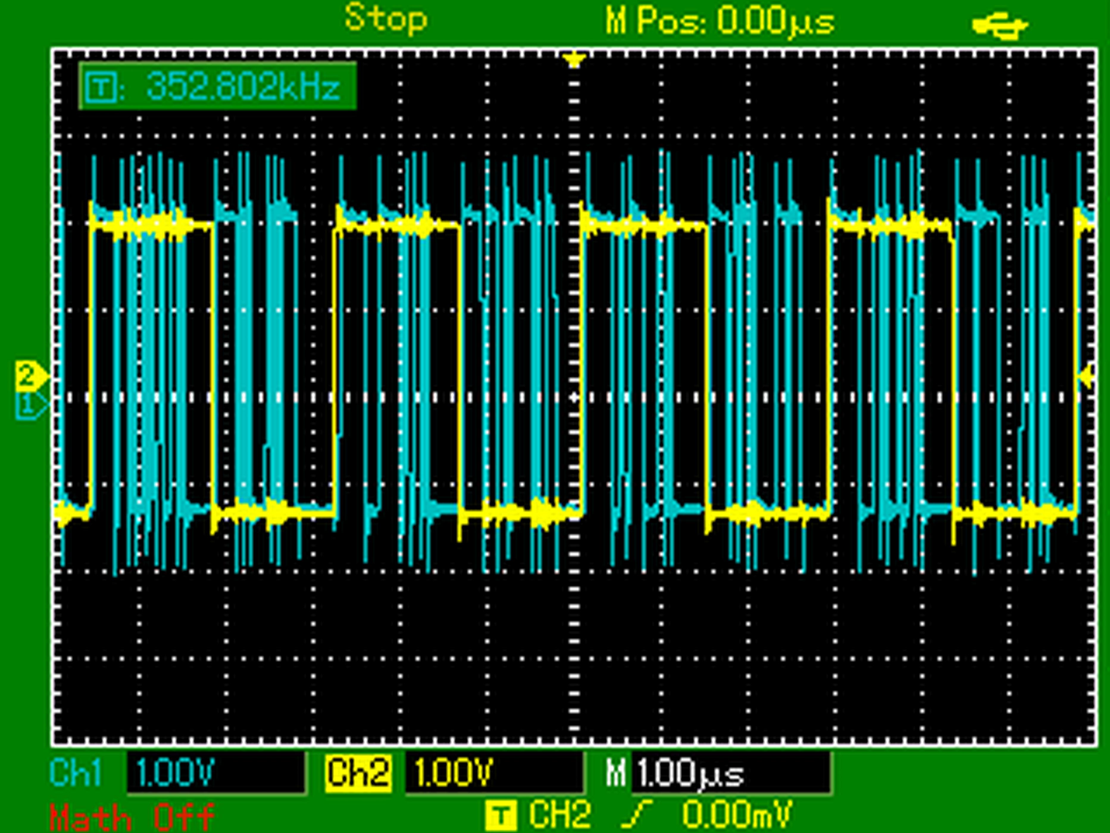

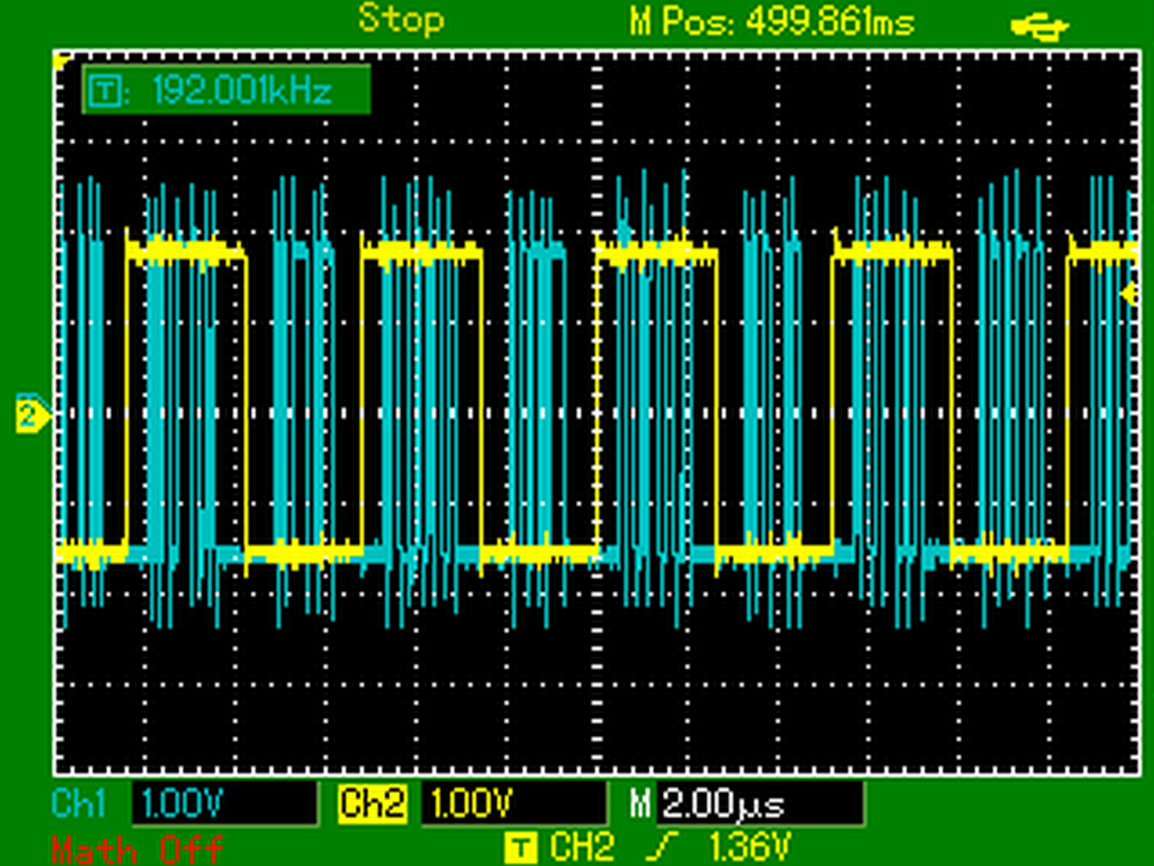

Apart from the 44.1/16 all other formats are working okay with ver 1.04 ES9038Q2M board. Play some 352.8/24 files feeling slightly better than the Pi DAC driver. Check the waveform, got the results as follow:
attachment.php
http://www.diyaudio.com/forums/attachment.php?attachmentid=679962&stc=1&d=1526036890
This clearly shows the Pi DAC driver not play the 385.2K but 192K on Volumio. If the problem playing 44.1/16 is solved the ES9028 driver is good.
