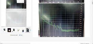

In addition, if even if no switcher in front of an LT3045 module, depending of the value of Cset they might be not suitable for directly powering AVCC. In the ebay ads for the modules some show the picture I will post below of the output noise spectrum. Probably fine for powering opamp rails since they have good PSRR at LF. AVCC on the other hand has no PSRR at all. And adding larger output filter caps to LT3045 doesn't help much according to the data sheet because it reduces regulation bandwidth.
Therefore, if you can replace Cset with 22uf it would be better for powering AVCC. Probably even better, use the LT3045 to power an opamp and use well filtered reference voltage and the opamp to power AVCC.

It's only such a slight improvement in the presence of LT3045 (instead AMS)? Did you do the measurements using the unmodded board using 1-2 LDO, and did you powered the controller from the same AMS? I wonder if this level still remained after full modding?!
If those are the distortion levels being discussed, then he's still using the as-supplied buffer, rather than building up an i/v circuit. The voltage out mode severely hampers the overall performance of the dac, and I'd expect the improvement in ldo to be mostly a lower noise floor, which gets lost in a single quoted thd+n number.
