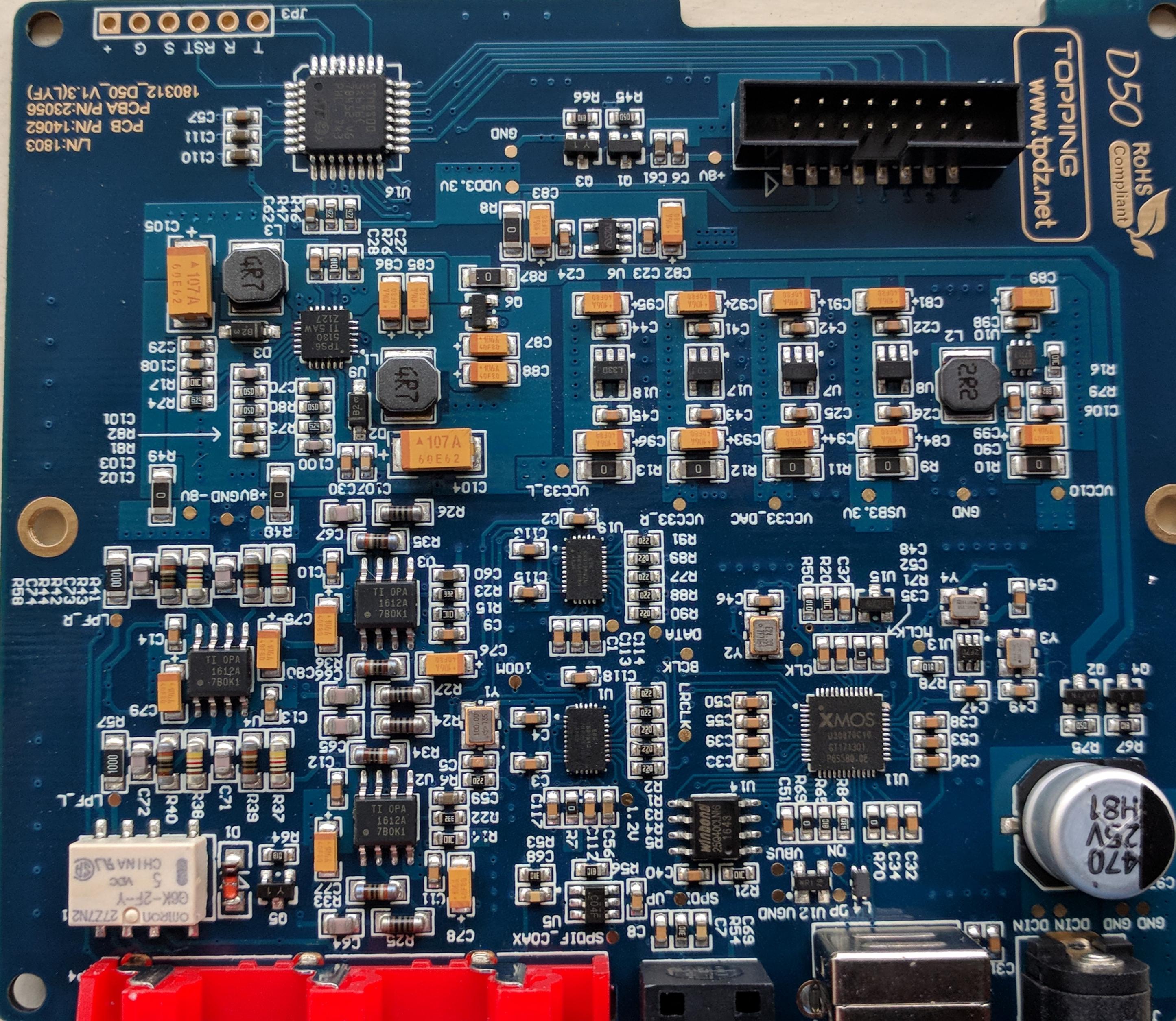

Just copied the Topping pic to Irfanview and magnified it some more there.
With a little more magnification traces combining in and out of phase outputs together at each DAC can be seen. The 100MHz clock can be seen between the DAC outputs and the IV stage inputs (maybe an odd place to put it). Switching power supplies are off to the right. Voltage regulator chips silk-screen marked as being for AVCC left and right channels. Part numbers can be read on some of the chips. However, the bottom area in the pic is a little out of focus so can't see as much there.

And here is the Hifime Es9038PRO
This one has an LT1054. Wonder if it is to produce a negative rail voltage for the opamp? Sometimes used for that purpose in guitar effects pedals, but the power I have seen didn't look very clean with a scope, and I was unable to make it much better.
Big 'Golden' type clock in there too. Not low phase noise, IIRC.
Looks like a single OPA2134 used as a stereo output stage. Not many components around it either. Could possibly be the ESS recommended low-cost output circuit option, can't tell from the picture.
Yes, I believe the LT1054 is for the dual rail. The OPA2134s feed into an OPA1622 (tiny black square behind the headphone jack). The clock, yeah, I don't know.. However, right next to it is I think a schmitt trigger inverter ('U20') (?). Curious what that does.
But after lots of comparing, the Hifime sounds much better than the Topping. In fact, the Hifime doesn't sound quite like a typical ESS, reminds me more of an AKM; bolder, more 'musical', mid-centric. Not sure why. THD compensation? Gain compensation? Filter?
Could have something to do with the particular clock jitter. Some people seem to like some kinds of it. That might be a long shot though.
Could be less switching hash from the power supplies affecting the audio. I see some inductors in the corner, but can't see if there are any switching regulators anywhere. That could be a big one.

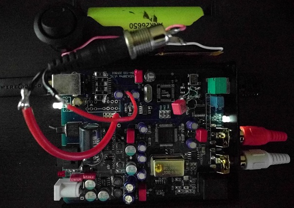

Just a general FYI: 3.2v Lifepo4 batteries are an excellent option as a low noise power supply. And they have become much more affordable the last few years since A123 no longer controls the patent. I have one powering the Hifime usb receiver and clocks. Needless to say it's quite a jump in sound quality. Less clutter as well since there's no AC/transformer/rectification to worry about. May do AVCC next.

Actually, I have been wondering about a similar thing a few days ago. Since AVCC requirements are not for a defined voltage but a very steady one, it does not matter when the voltage slowly drops off. As the battery voltage drops the offset drops with it so everything is good. I could be wrong.

There should be some Lifepo4 measurements around here -they were very popular for a bit. I see there's one here. I don't know about the Jung Didden, but the Lifepo4 sound much better than other low noise regulators and battery options (alkaline, SLA) that I've tried in the past.
This has been my experience too. LifePO4 batteries beat the default LME49720 based reg, as well as several popular shunt regs, when powering the analog supply of my ES9018. The improvement in transparency was very obvious. But charging solutions can complicate things -they add complexity as well as potentially another noise source.
If using more then 3.2v then yes things start to get more complicated, requiring wiring in series, float charging etc.
Haven't tried LiPO4 batteries myself, but will give them a try. At the very least they may be good for telling you if you have power quality problems with a line powered supply. For that they may be highly useful.
However, probably good not to forget that batteries have internal source resistance themselves, and the voltage will modulate with load variation. In that regard they could be good for making fake bass pumping that is not actually in a recording. One would have to do some careful checking to know for a fact why one thing seems to sound better than another.

The output Z of the LifePO4 batteries is very low, sub 10mOhm, so equivalent to a good regulator. The improvement I heard was one of a cleaner sound rather than fake bass.
