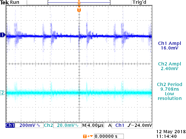

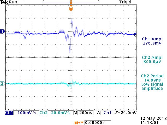

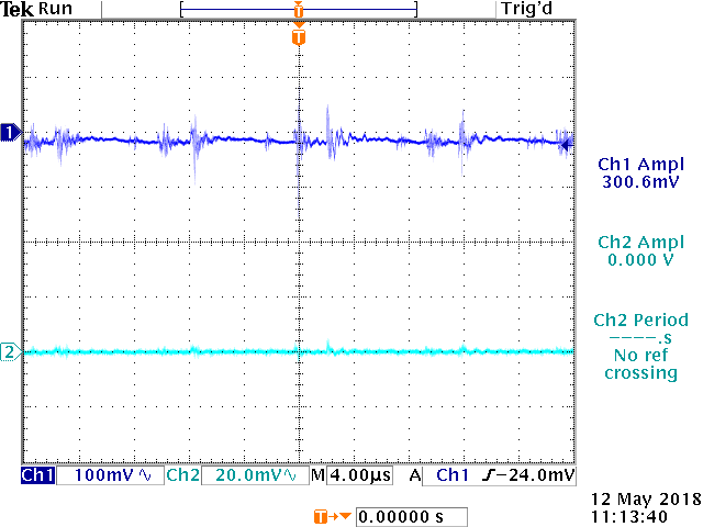

The feedthrough of switching transients exists, but not sufficient to be audible. These screenshots using an old and noisy wall wart will illustrate. First "Peak", Second "Average", Third "Ringing". Note the period.

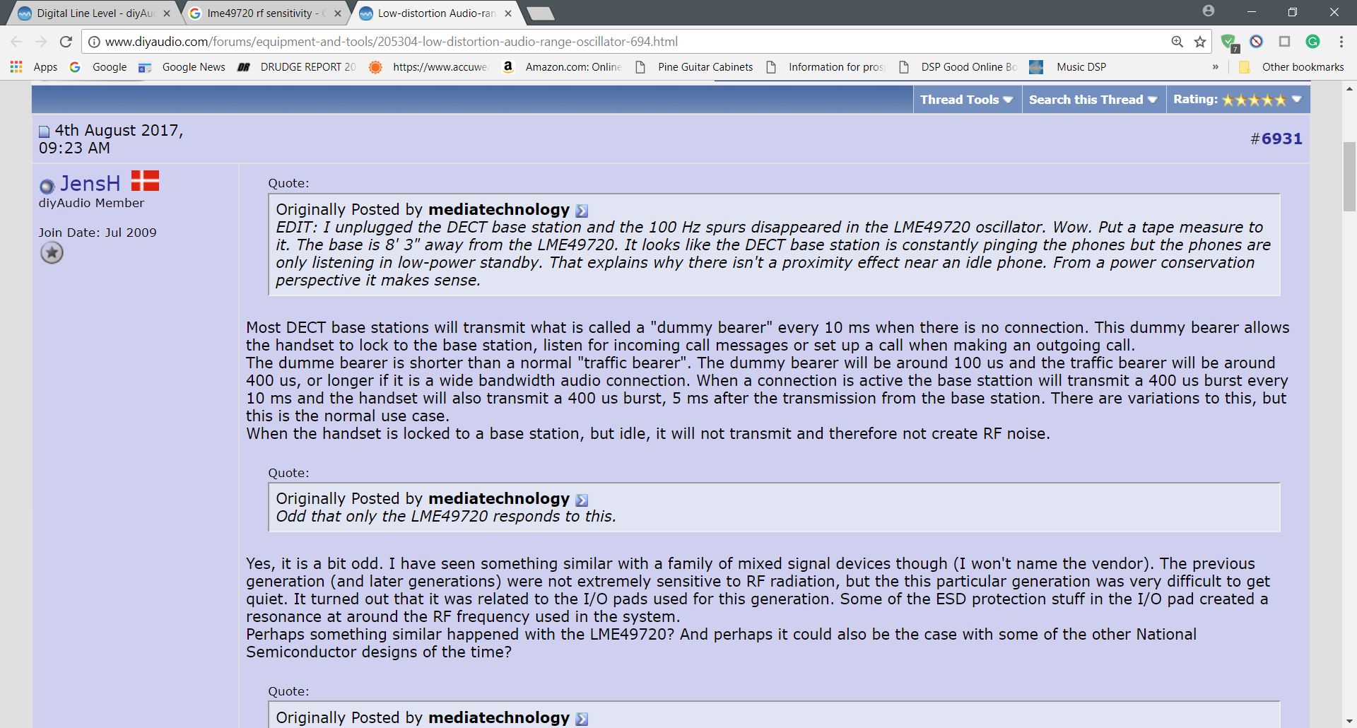

Jack, nope. You are barking up the wrong tree. The DAC has LME49720's in it for one thing. They have known RF sensitivity. See attachment below. Also, in the case based on some experimentation over at Richard Marsh's house using his test equipment the DAC chip itself has something funny going on that looks rather similar, although more work needs to be done.
What I have been using is a portable shortwave radio with adjustable RF sensitivity and an external antenna jack. Using an external antenna I can trace RF hash radiating up the wires from the switcher in the wall wart through the SS and up to the DAC. That's no good for my purposes because it is audible though some unknown mechanism that presumably involves rectification. Don't now if any bias level shifting as a result.
To be clear, I didn't start by looking for RF, I started by hearing some kind of distortion and trying various substitution experiments pointing at a power problem associated with switching sources before hitting on using the radio as an RF detector. What it detects correlates quite well with distortion I can hear, although the distortion may be at a very low level. Perhaps inaudible to some fraction of the population, haven't tried to measure that. Signals causing the problem could be down in the high nanovolt region, that I don't know.
Anyway, some of these devices with high sensitivities can produce very low level audible artifacts. My point has always been that how would one know if one had a very sensitive device to tiny amounts of RF? So far, a number of people have pointed at SS as a gold standard power source that can always be relied upon no matter what. I haven't found that to be the case.

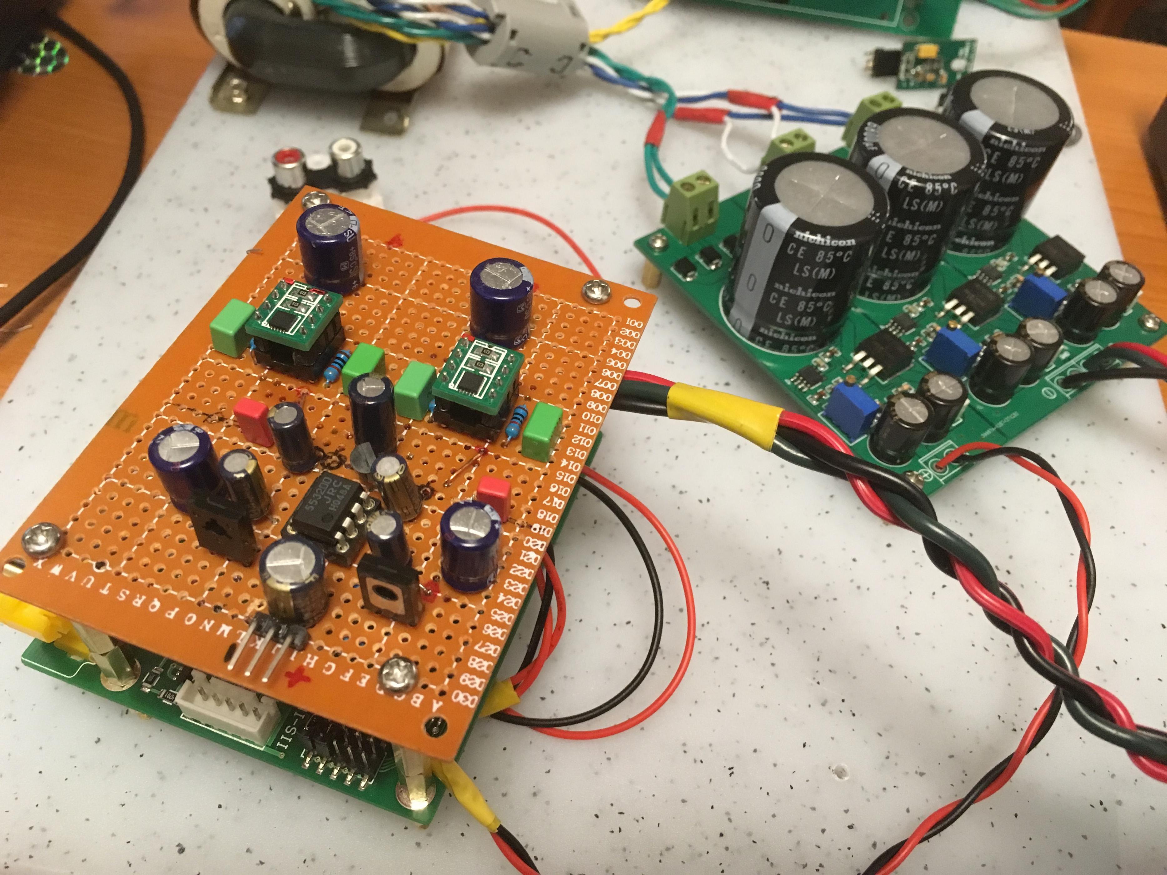

i soldered a prototype board with 2 series regulators for AVCC which run from a separate 5V preregulator. also I/V stage according vicnic design fitted on the same board. despite of horrible wiring and lack of proper decoupling it measures now -93dB.

Also, I didn't mention before but I tried a couple of off-the-shelf +-15v switching supplies and got essentially the same effect as with SS and wall warts. Between switchers and various wall warts, the effect is only a matter of degree, there is no difference in basic character, at least in terms of audibility.
Tried putting one of the switchers in a metal box with RF feed-throughs to bring the power out, but the tightly sealed box didn't attenuate radiated EMI/RFI enough to do much good. In addition, capacitance between the box and one of the switching supplies caused its noise emissions to increase considerably. Found that holding my finger near a spot on the top of the power supply had the same effect. Very strange. Abandoned all switchers for the time being.
Also, as an aside what we saw with the DAC over at Richard's house curiously consisted of spurs spaced at right around 100Hz intervals. Unfortunately, I didn't think to ask at the time if there was a DECT phone system in use.

thanks Mark! the thing measures pretty close to Pre Box S2 now. nevertheless, they sound is rather different, what also reflects in the spectrum.
what was somehow surprising that discrete regs are doing better than LT3045. unlikely noise wise, but maybe they can handle better such a tricky load as Sabre32 chip. i wonder whether someone has measured what is going on with LT3045 regulated AVCC when playing something like 384/32 or high rate DSD?

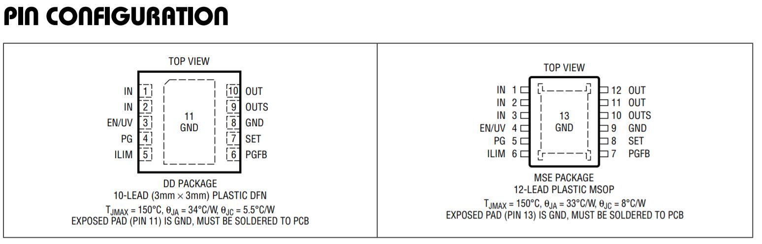

22uf is the maximum recommended value for Cset. Below are a couple of pics from the LT3045 data sheet. They show the pin labeled "Set" has a capacitor and resistor. The cap is Cset. Presumably the Cset for your module is the 22uf tantalum, but maybe you could check to confirm if that is correct?
