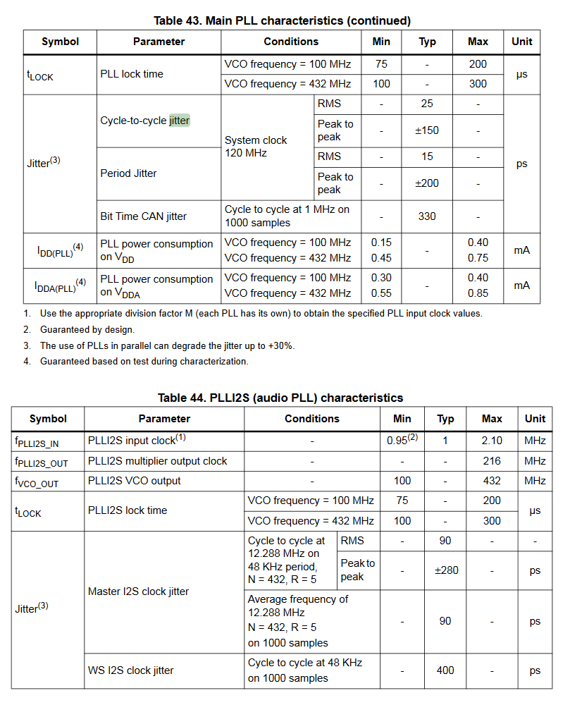

Stm32f446 datasheet give following values as jitter:
I'm surprised PLLI2S have more jitter than Main PLL, anyway even +/-280ps jitter is a high value ? I mean this is measurable in terms of THD ? (I think jitter affect mainly THD, maybe I'm wrong). It's something I can measure (I own a QA403), THD versus ASRC or not, different clock frequency etc... one time I build this pcba. Note: I will add footprint for a 100Mhz low jitter oscillator in my design as a option, in such way can measure correctly affect of jitter.

Some SPDIF receivers have lower jitter. Not saying it's audible but with dedicated audio clocks you could have much lower jitter.

About jitter, it will be interesting to measure THD with a high jitter (high here is above 100ps, below 1ns as I understand) and a low jitter clock, sourcing the dac.

You can get NZ2520SDA with better performance for 10x less.
https://www.digikey.fi/en/products/filter/oscillators/172?s=N4IgTCBcDaIHYC8wFYwAYDOATAhiAugL5A
But both NZ2520SDA and CVHD-957 are pointless if you use them as a source to PLL.

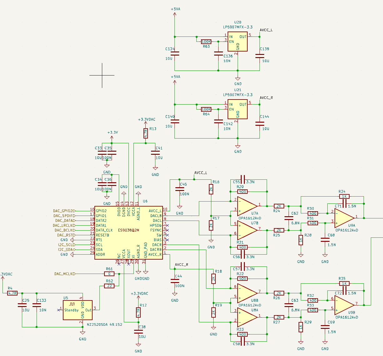

Hi, almost finish layout of my es9038 board 🙂 This board is purposed to fit my amp, so there are specific connectors for analog/power and other thing relative to my amps. Will order soon@jlcpcb to start manufacturing 🙂
This board embed a STM32F446 as a USB streamer (using UAC2 open project https://github.com/slerpxcq/openuac2_fw) and main general controler. There is also a Bluetooth module (chinese one Muyu or Feasycom).
I add a clean jitter clock option to see if I can measure/hear the difference compared to initial plan using STM32 pll.

Still not right. AVCC at the dac chip is supposed to 3.3v. Not half of that. AVCC/2 is only for the I/V opamp noninverting input.

I guess you speak about resistors R15&R14, looks on value it's only to add a small decoupling between both AVCC_x pin. AVCC/2 for opamp are made with other resistors R16/R17.

Looking at it again, you're only using RC filtering on the noisy +3.3v dac, and it making a small part of a voltage divider with R18, and R19.
The dac will play audio that way, but unlikely it going to meet specs for what chip is capable of. The sound will be distorted with noise, etc. Using a bunch of different value caps in parallel is usually considered a bad idea nowadays too. It can make the impedance vary wildly with frequency because each cap as parasitic inductance and self resonance. One cap's capacitance can resonate with another cap's inductance to create problems.
Better to dedicate a low noise, nice sounding 3.3v regulator for each AVCC pin. If you don't want to do then you probably picked the wrong dac chip. You want a easy chip, not a demanding one.

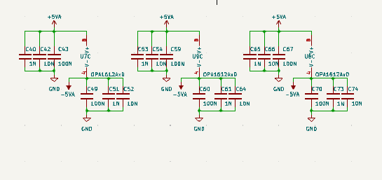

Hi, you sugest something like this ?
Now three low noise LDO, one vor VCCA portion of the IC, and one for each L/R analog circuitry.
I remove small 100nF caps of analog part, except for digital side, I often use bunch of differents caps in digital design to make a power distribution network with small impedance in frequency of interest, but that's more relative to high speed design than low noise analog.
I'm here to learn then will follow your experience, and thanks for that 🙂
I also use bunch of caps for opamps:
Better way to only keep one of 100nF for each opamp power pin (and eventually biger value than 100nF) ?

Better. One thing you could do is strongly filter one AVCC voltage regulator output, then buffer that with a unity gain non-inverting OPA1612 powered from clean +15v and GND in order to produce two buffered AVCC output voltages for the dac AVCC inputs. There are other things you can do too, maybe someone else will suggest something.
