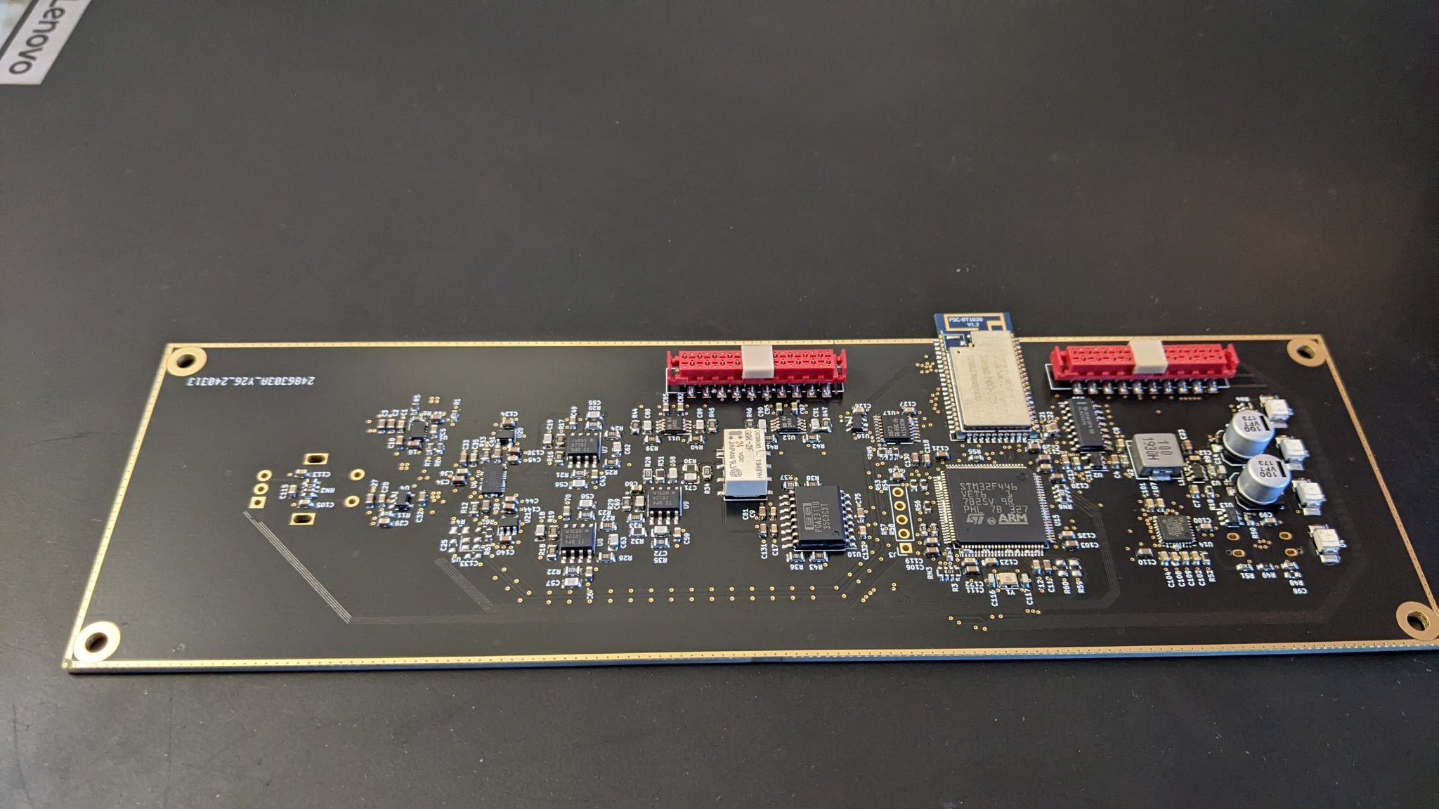

OpenUAC2 project implementation on custom HW with ES9038 is on the way 🙂
The STM32 USB->I2S work, I2S signals looks good but es9038 didn't generate any signal.

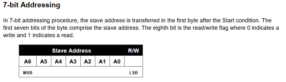

I can read and write through I2C on es9038, I was surprised as the i2c address of es9038 is not 0x90/0x92 like mentioned on datasheet but 0x48 ? There is also another strange thing as the res1 register default value is not b11001100 but b10001100 ?
Clock on es9038 is good, voltage rails on es9038 looks good, I certainly miss something on es9038 init. If someone know how to simply output a analog signal with I2S data ?

These devices use 7-bit addressing (see attachment). For some reason ESS gives the address in 8-bit format in the datasheet (i.e. 0x48 << 1)I was surprised as the i2c address of es9038 is not 0x90/0x92 like mentioned on datasheet but 0x48
Can you list what values you use to initialize the registers?
Oups a newbie misunderstanding!😆

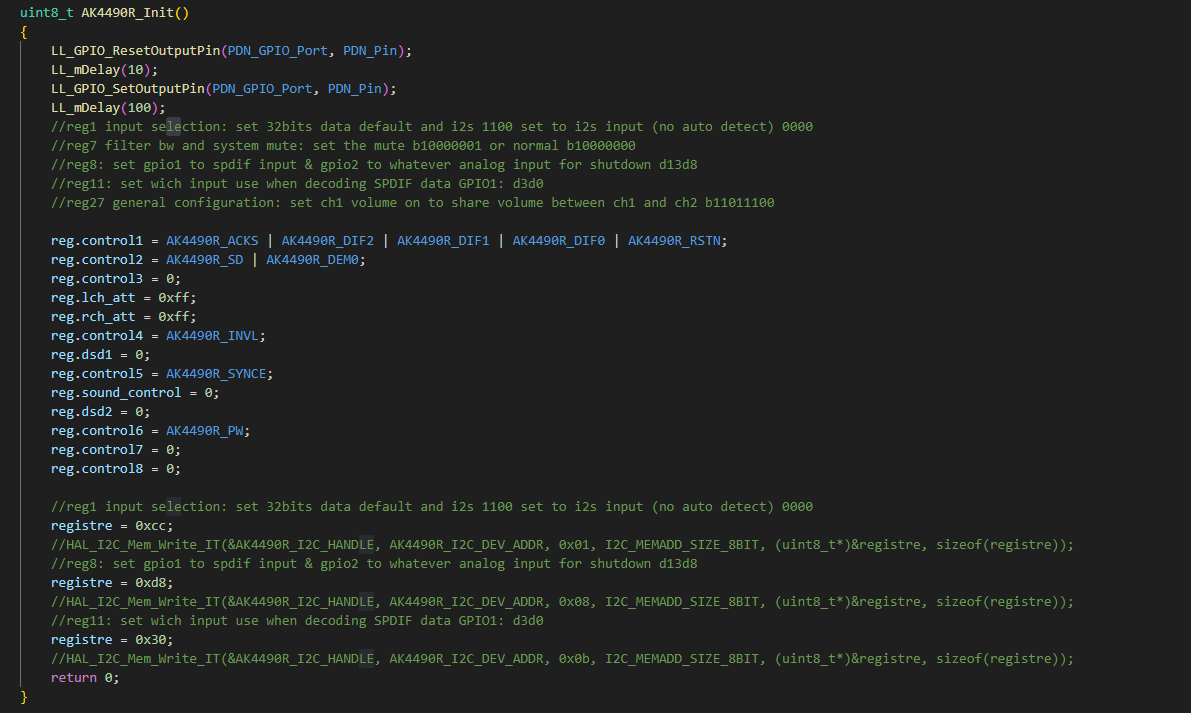

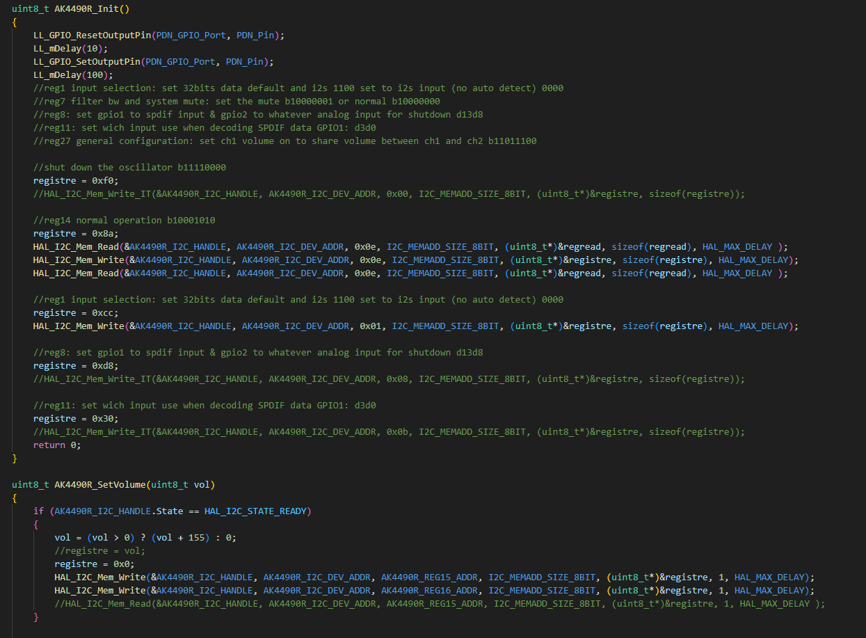

I tried several combinaisons of registers, last try I only made a reset cycle toggling reset pin these way: L wait 10ms H.

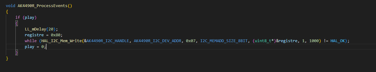

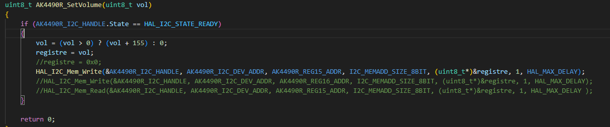

I think it's maybe my volume control in fault :
I have binary stream on I2S bus, I see I2S_WS frequency change accordingly with Fs (ie 48ks i2s_ws=48khz, 96ks 96khz)
I comment all other functions

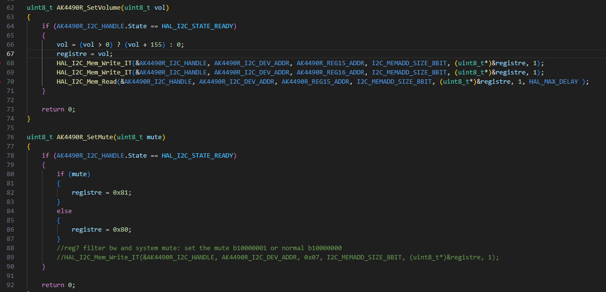

That does not look right. You seem to use volume value as register id. And you really should get rid of "AK4490" stuff in code as well as namings.I think it's maybe my volume control in fault

You totally right I have to get rid of all reference to ak4490r and rewrite these portion of code, I'm only doing a quick check to be sure dac is working.

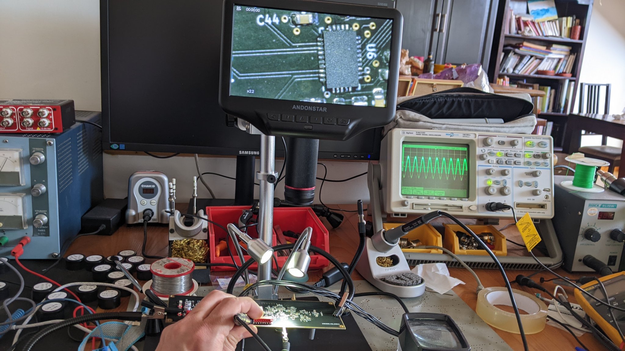

Hello 🙂
Finally, it works 🙂 it just work few second ago, so I have to properly understand how and why but... great!!!!

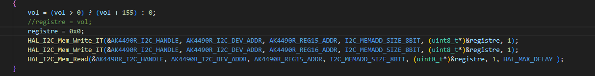

I had one issue, I used the i2c write meme function with IT this doens't works for me, I replace it with no IT it works 🙂 bit7 set of reg14.
I modify these things:
and my init sequence:
I see on scope the wave is not stable, there is some issue to fix, but hw seems to be good and that was my goal for this week 🙂
Here the sinus of victory 🙂

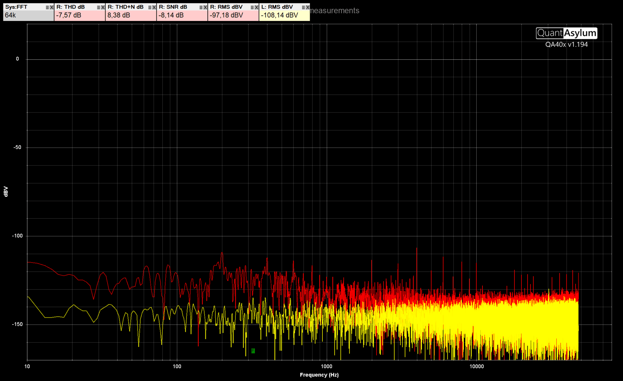

First noise floor on a 98.304 stm32 clk try (same results with 24 or 49m):
I add left chan as reference 50R bnc terminators.

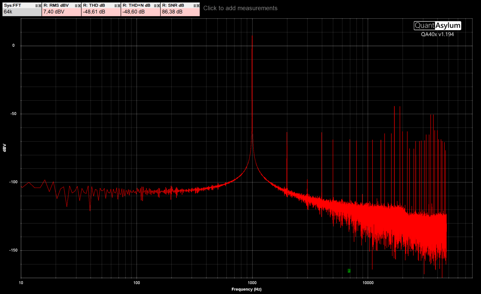

And THD with 49.152m and 384ks Fs:
I put this screen to show that 384Fs with 49M clock is not a good idea.

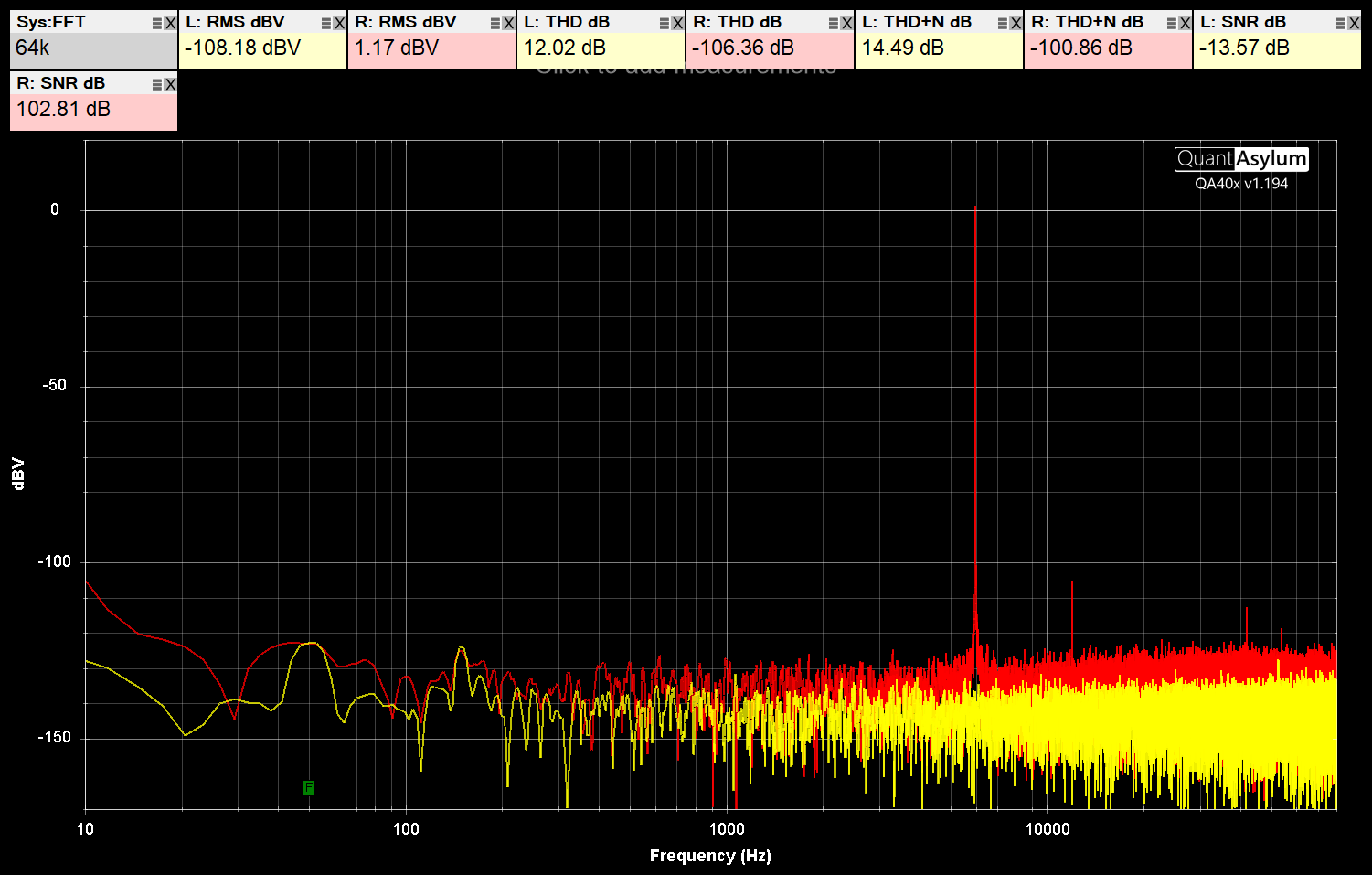

Let's give a try with a 98.304Mhz clock:
Far better!
Other Fs/MCLK combinations show similar results than the one just above.

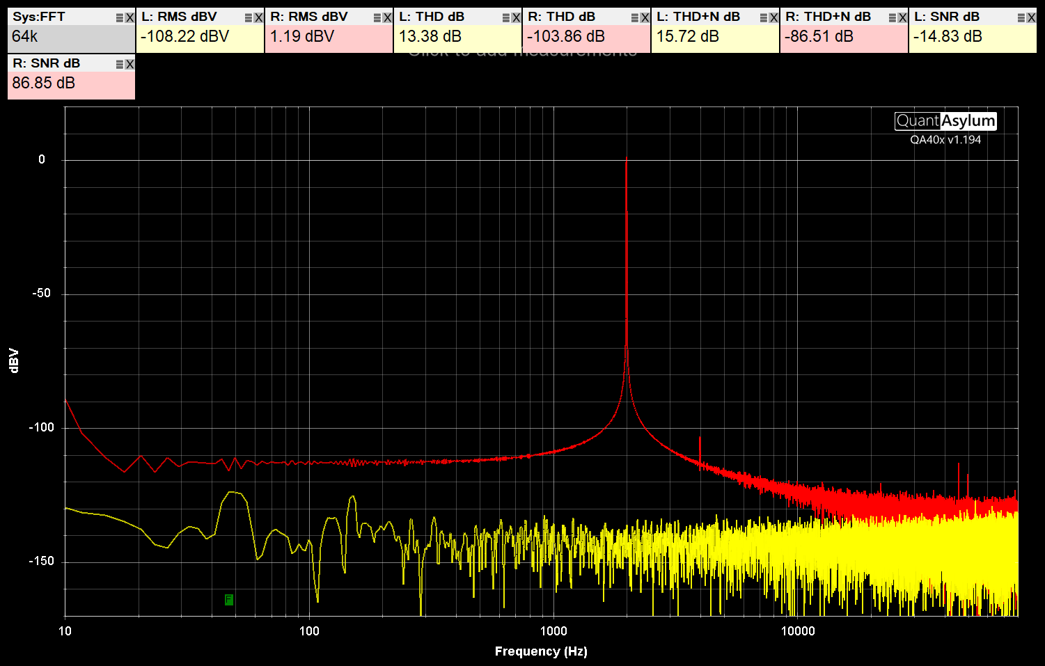

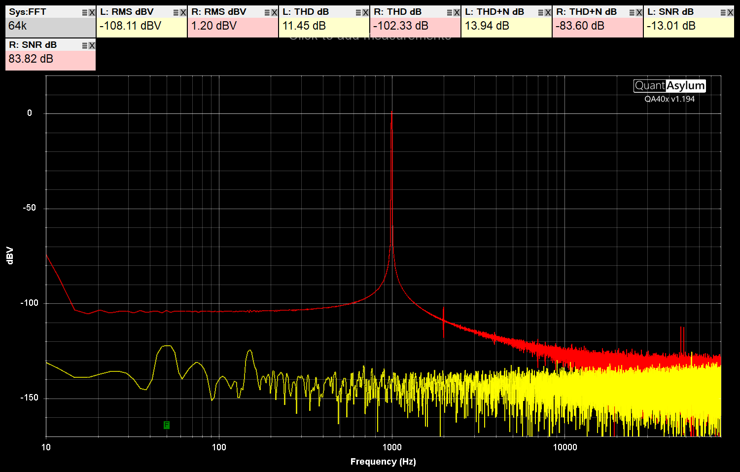

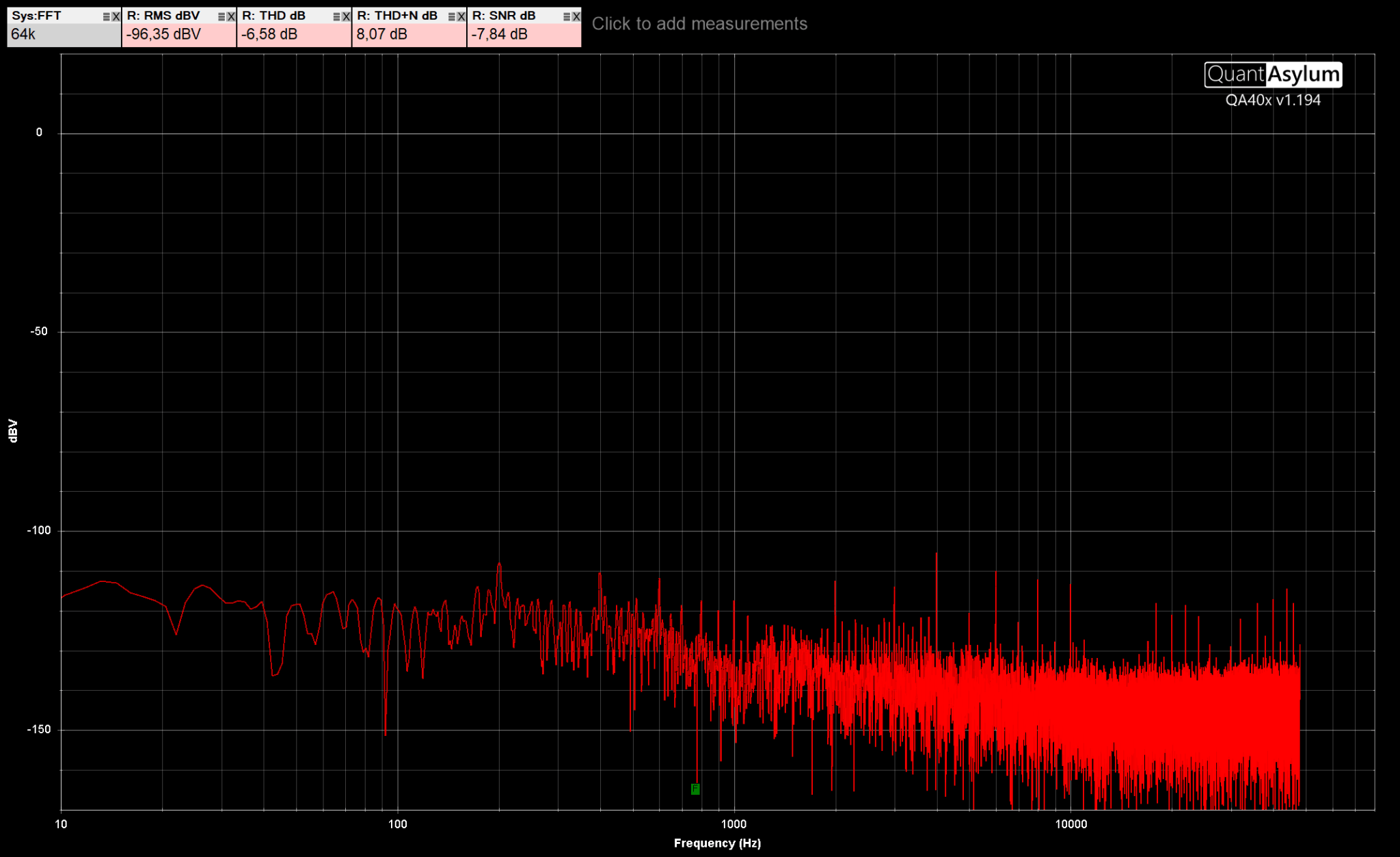

Hi again, I mad bad measure, noise floor is good. Anyway I spot a strange behavior relative to noise when es9038 play low frequency:
When playing above 2-3khz the dac performance looks good (measure took after my last se->diff opa1632 opa).
When frequency goes lower noise grow especially in the lower side of the spectrum:

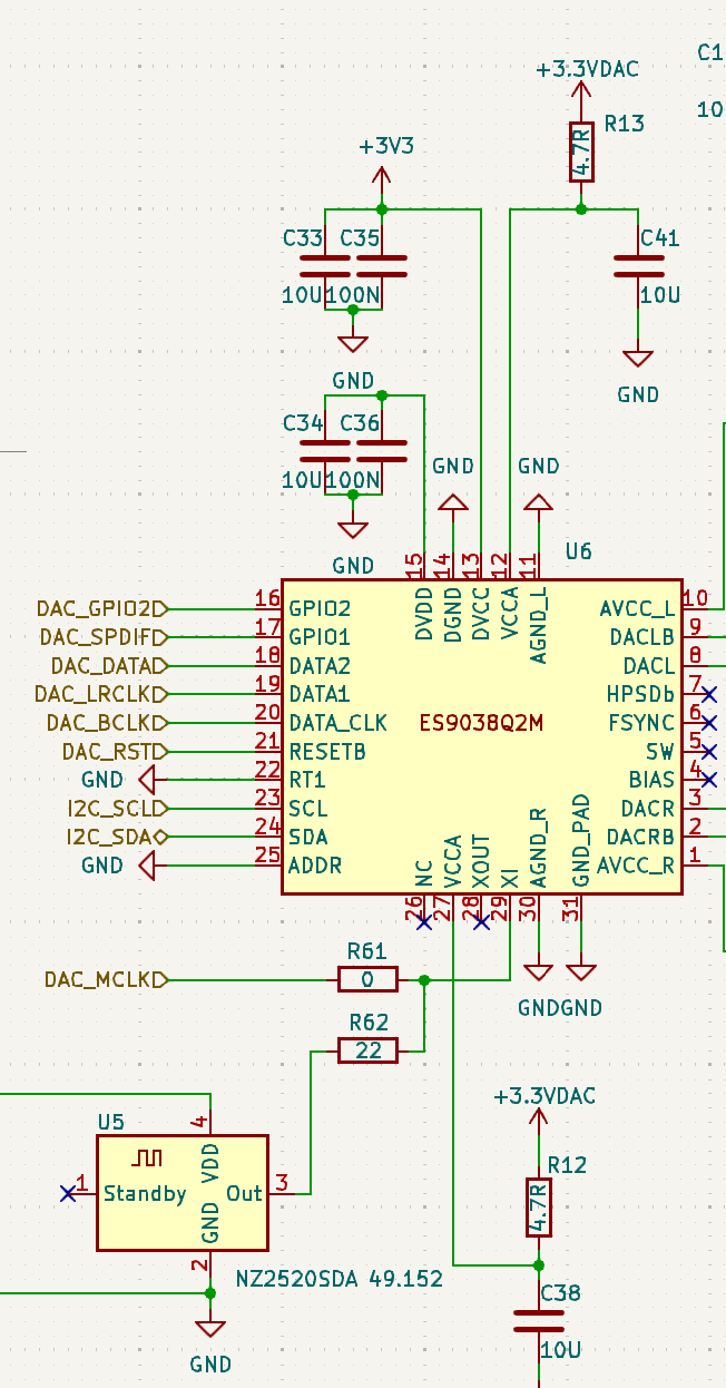

And the attached schematic. I majority use 4.7uF 0603 X7R 16V capacitors. I guess this 'low frequency noise floor grow' is no linked to capacitor value, maybe the famous master clock input jitter ? I use MCO output of an stm32 as master clock for dac. any suggestion ?
The noise floor in your lower frequency measurements does not look "real". It has probably something to do with your measurement setup. Your AVCC regulator (LP5907) has quite high 1/f noise (LF noise) but that would also show up in 10kHz measurement. MCK noise would likely show up in 10kHz measurement as well.
What is the FFT window you are using?
