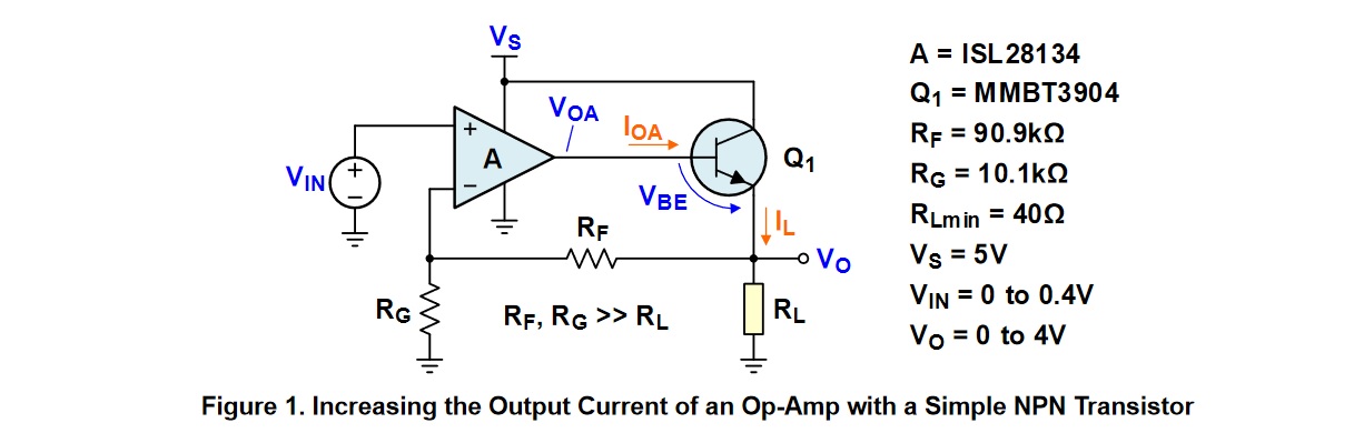

Hint: what you call "reference" for the op amp buffer needs to be, in fact, a very good low noise regulator, since whatever you are feeding in the op amp buffer (voltage variations due to "reference" element current and/or temperature, noise, etc...) will also come out of the op amp buffer. The only thing that the op amp may help with is the overall "load regulation" by potentially lowering the output impedance compared with the "reference". Which would be good, but only if it would be required; a competent engineer would attempt to figure this out, before designing in the op amp buffer. An incompetent engineer will say "an op amp buffer is good because it sounds better".
Otherwise, you will survive.
P.S. A whatever op amp (in inverting, non inverting, +1 buffer, -1 buffer, you name it, configuration ) input is not the power supply pin(s). Simple cause-effect relationship, by your logic any op amp gain stage is also a "voltage regulator".
Can't see how this differs from any other regulator. It's reference needs to be low noise, or IOW - any noise on the reference will make it through to the output. Take the LM317 for example - there it's even worse because the reference voltage is amplified by a certain factor and with it all the noise on it.
Try harder. You could extend an op amp output current, for example like in the attachment, static source/sink configurations (if that really matters, which is again not proven) are as trivial to design, with two transistors. This still won't make an op amp a "voltage regulator".
