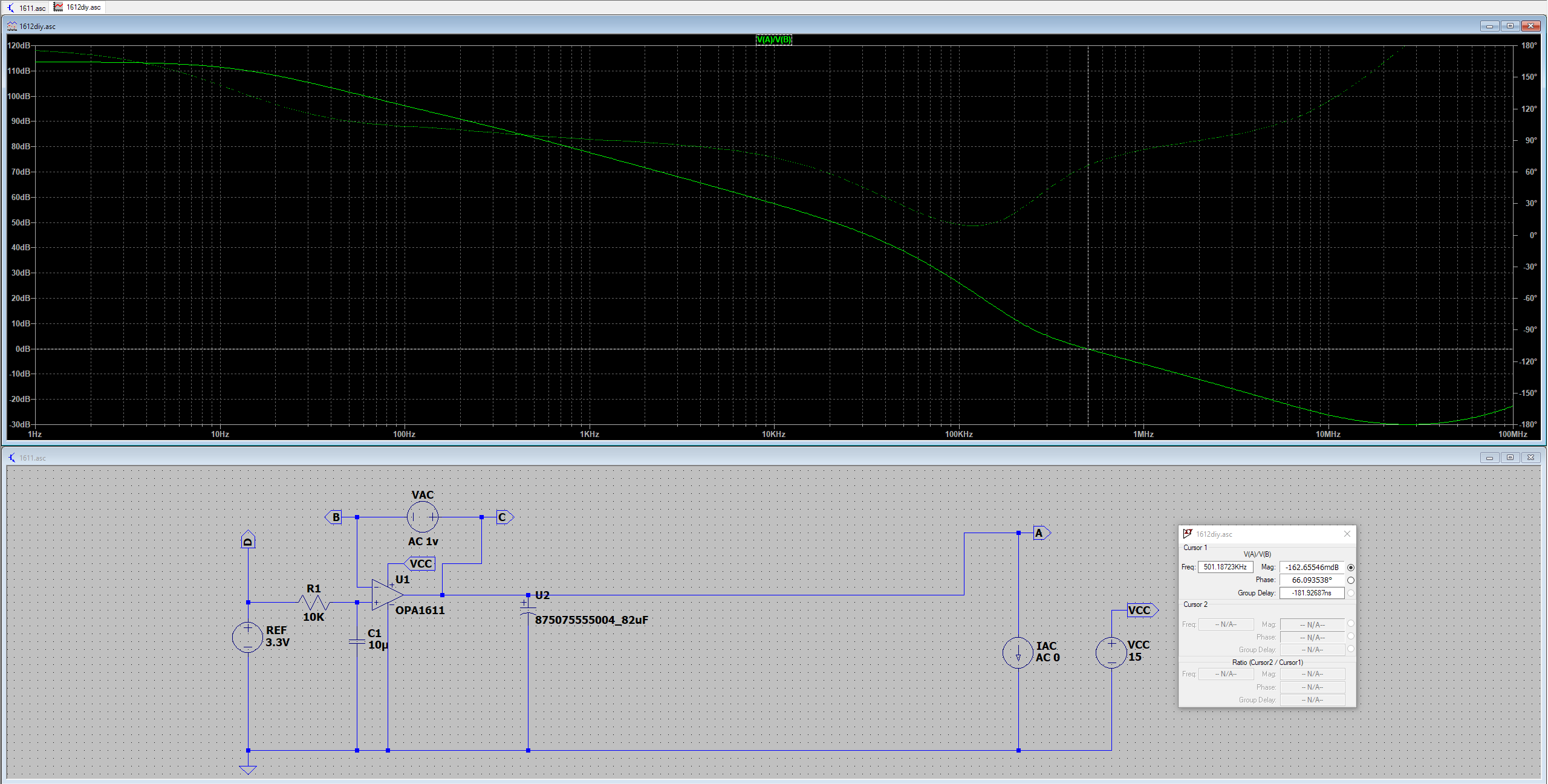

I read that, but I still don't know how an opamp with VEE connected to ground, VCC connected to well regulated +12V, configured in gain = +1 configuration, fed with well regulated and filtered +3.3V at the noninverting input is in principle different from any other voltage regulator.
It has a stable/low noise voltage reference, PSRR that matters is that on the VCC pin and output impedance is defined by it's open loop gain vs frequency.

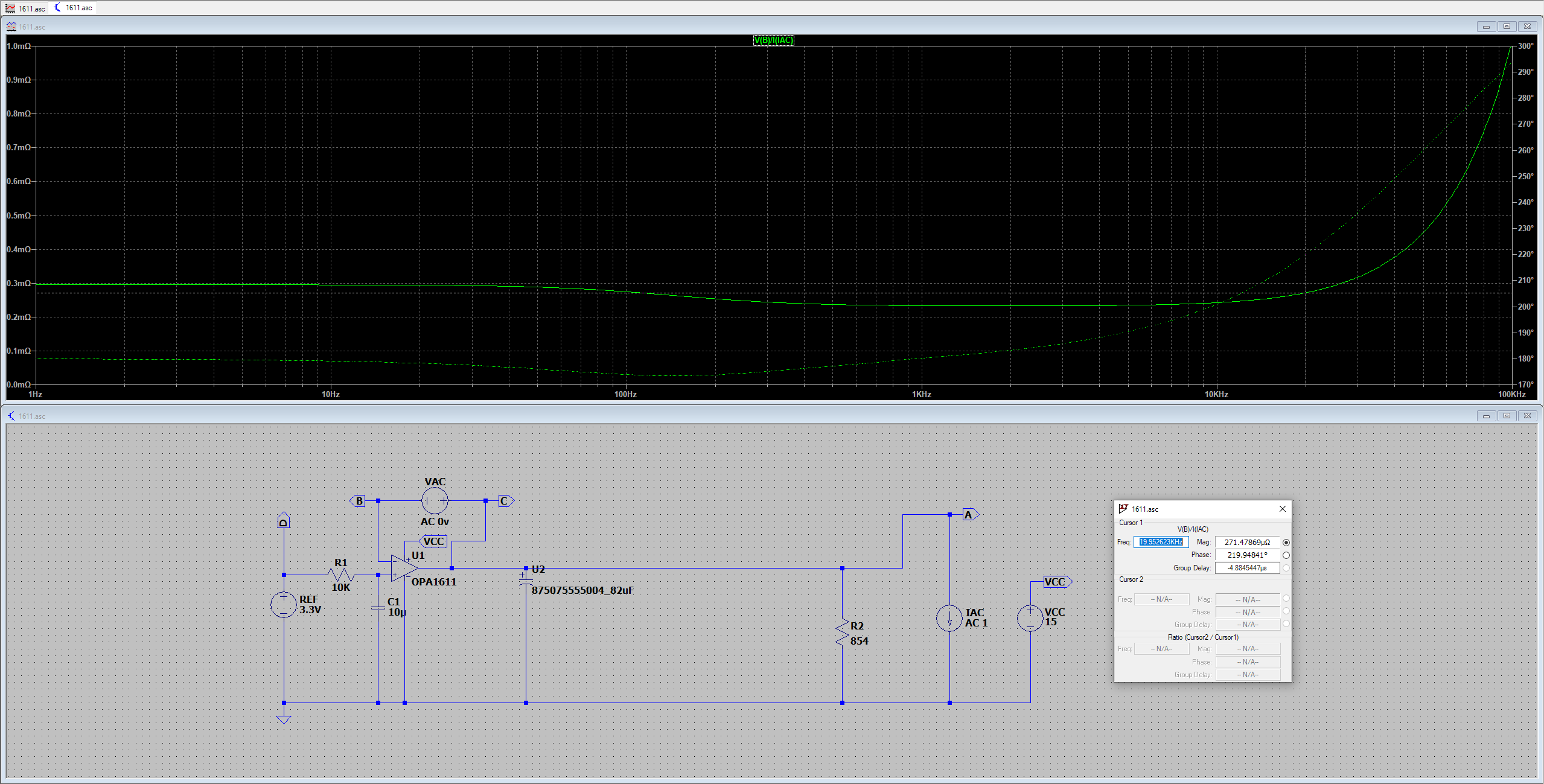

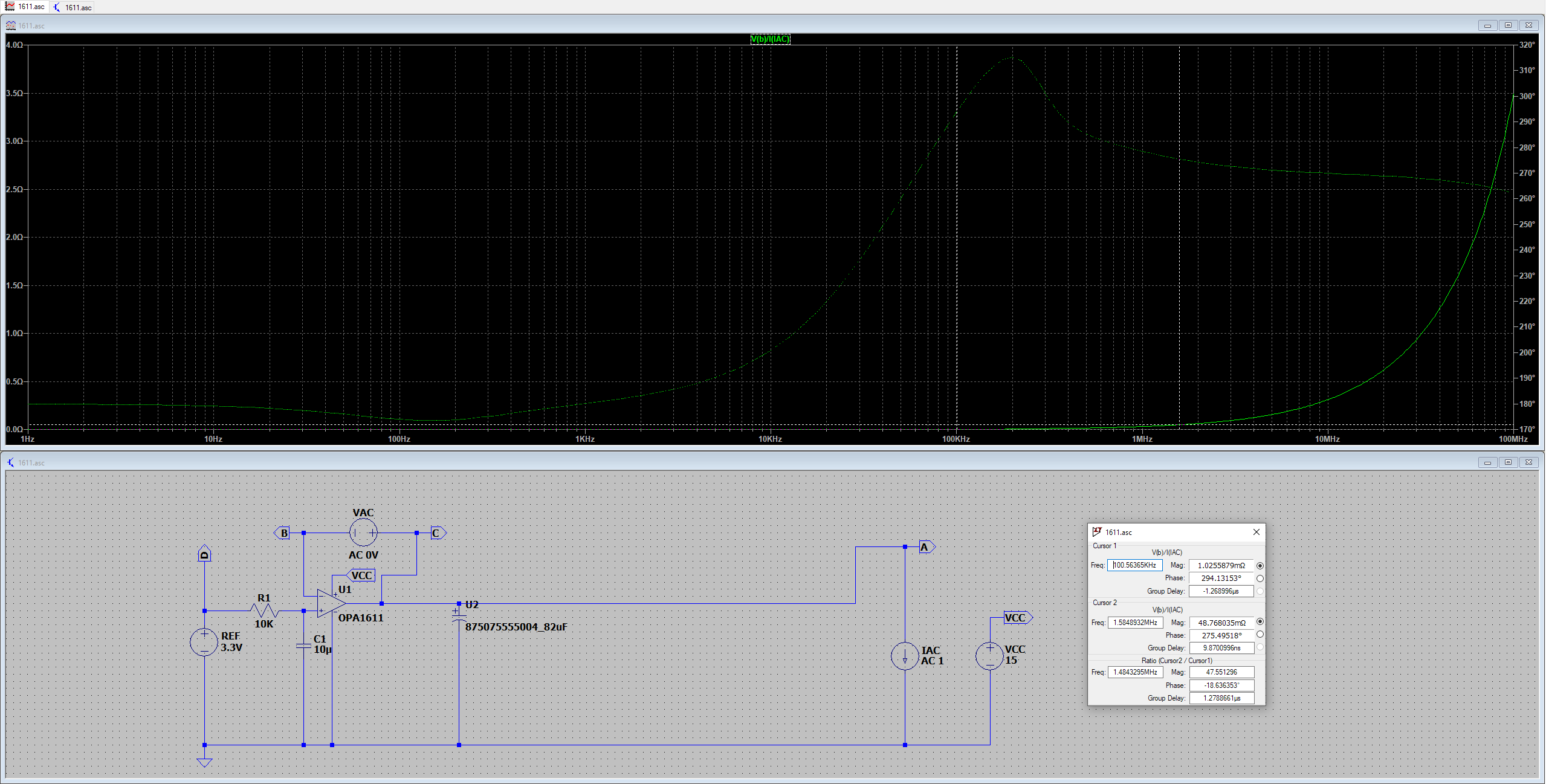

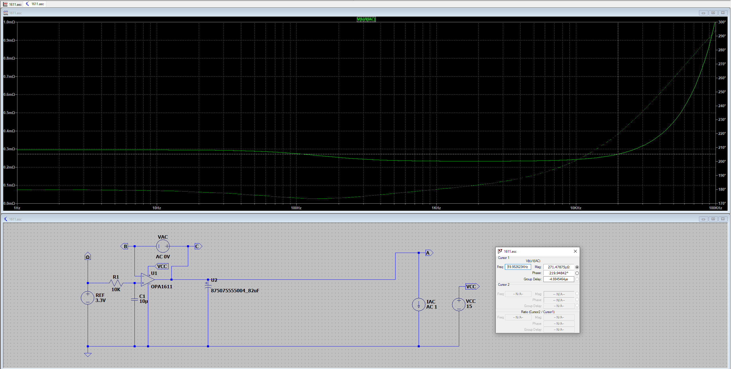

As promised here are the Zout and phase margin graphs from our simulations for the OPA1611 AVCC supply.
Is it possible to provide simulation * .asc
Thanks.
...here are the Zout and phase margin graphs from our simulations for the OPA1611 AVCC supply.
No resistor to represent the AVCC load presented by the dac chip?
Its small signal output impedance could be a little bit operating point dependent. Its that when trying to be accurate at or below -120dB levels, tiny things can matter. Don't know how good the opamp model is though. Maybe someone could hear smaller deviations than can be accurately modeled. At least, some professional audio designers I know don't model at all because they don't believe the models are accurate enough for what they are trying to do.

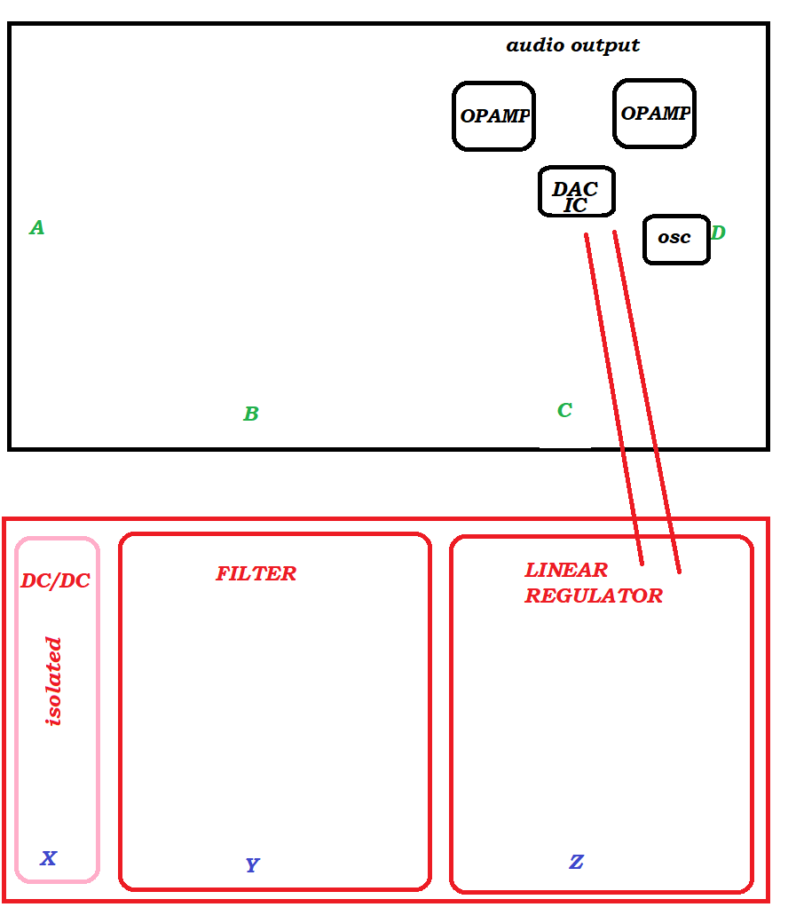

I have a question about return current. And proper ground to ground connection.
I have 2 seperate board. One is dedicated for dac. The other one is power supply.
DAC board have clean ground.
Power supply board has isolated dc/dc converter then filter section and finally linear regulator.
Which location (A,B,C,D TO X,Y,Z) or any other is best places for ground connection from power supply to dac board?

So, is the plan to run everything from one +5v rail? How will +3.3v be produced for devices that need it? What is the plan for cleaning up the switching noise from SMPS?

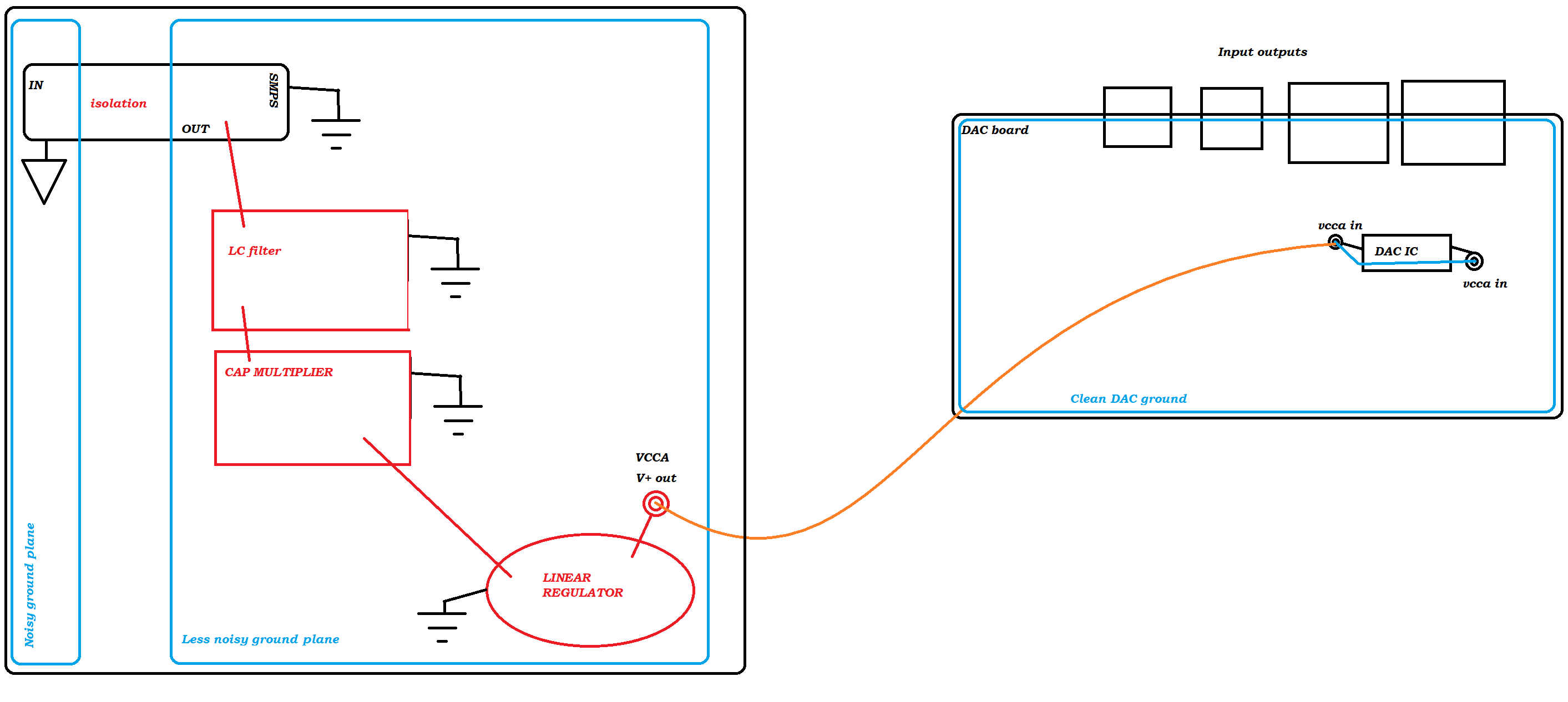

It would sure help to see a schematic, even a pencil sketch of one showing the overall power supply design. A dotted line or some connectors could be used to show which components are on the dac board, and which are on the power supply board.
My plan is to use two dc/dc converter one with 5v output one is ±15v output. To clean up noise, LC filter + cap multiplier right after isolation then use a linear regulator 3.3v and 12v output. Then i will connect each output to the DAC inputs with cables.
The dac pcb will have isolated I2C and I2S inputs. So dac pcb ground will be clean.
