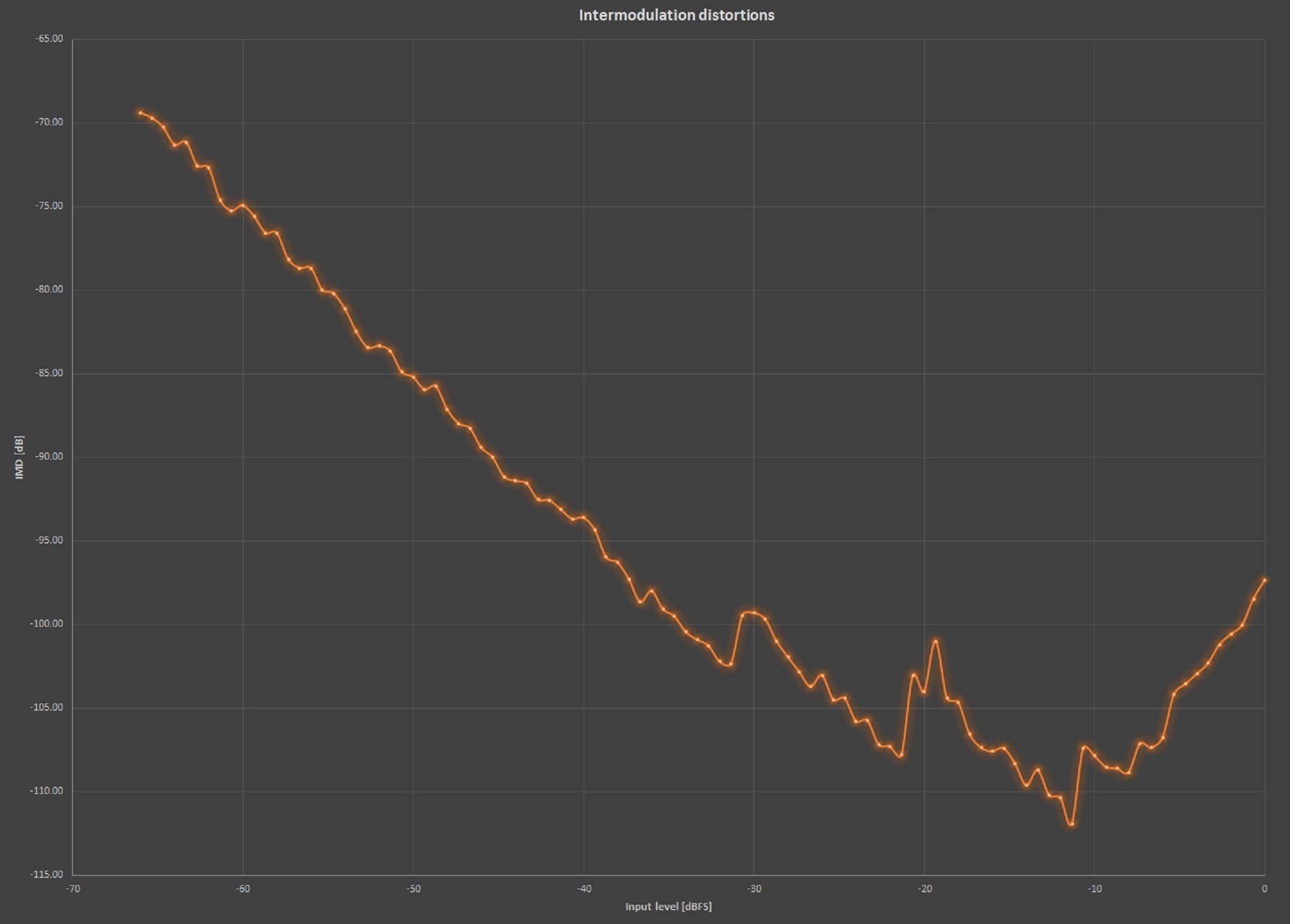

I'm attaching here, for the heck of it, the IMD measurement results for my dual ES9038PRO in Mono mode board, now with a composite op amp (OPA1612+BUF634A). Essentially, IMD is not measurable with my Rohde UPD (and I don't have an APx555). The UPD limit for IMD is some -112dB which is reached at -10dBFS, the jumps are when the instrument changes the scale. As long as the input is under -30dBFS, this board is significantly better than the Toppings D90SE. IMD (7KHz+60Hz) of -100dB is reached at -36dBFS, at the same input level the D90SE has only some -91dB! Using ADM7154 regulators and only X7R 0603 capacitors for decoupling (and lots of them), not a single film cap on the board. The only (poor) excuse for the D90SE is that it's not a dual mono, so the SNR is 3dB lower. You can peek at the new board in my thread https://www.diyaudio.com/forums/equ...trumentation-applications-74.html#post6714832.
One thing I have to admit, my board is a cost no barring implementation, the cost of the board in the photo was about $375 in parts only, while the whole Topping DAC sells for $900, so it would cost probably under half of that, to manufacture. But we are talking about performances here, not prices.

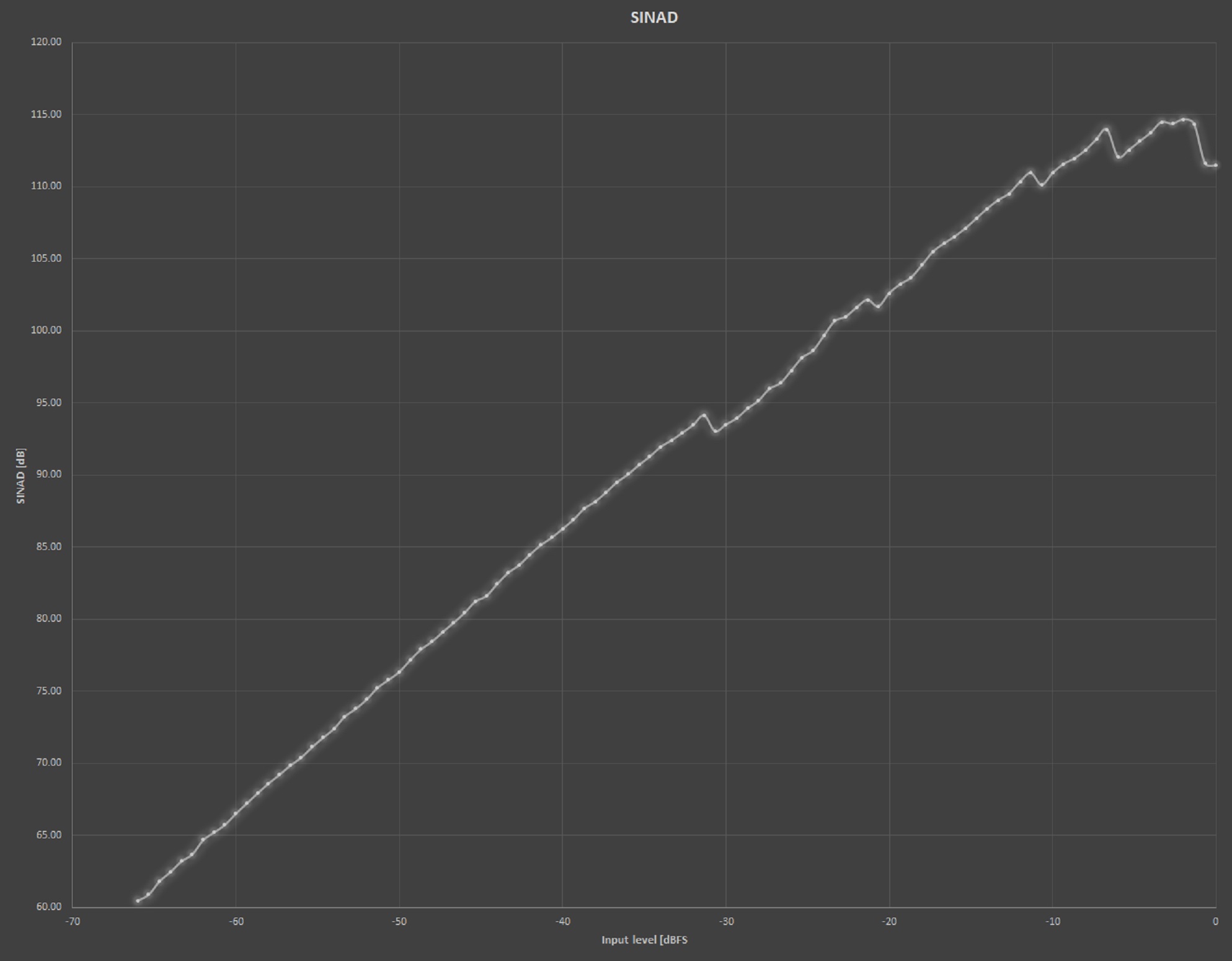

P.S. I include here also the SINAD measurement on my board, -115dB is the Rohde UPD SINAD limit, set by the analog analyzer noise. You could extrapolate the values before reaching the limit, it would be slightly north of 120dB, but only an APx555 could tell precisely (at it's own limit). Sorry, I don't have 30k for one, and not planning to take a second mortgage. The Rohde UPD is basically an AP SYS-2722 equivalent, so one generation in behind.
