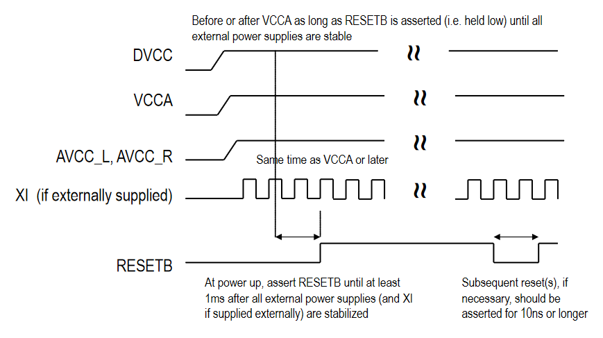

I would assume that I2S signals can be present right after DVCC is supplied. As I didn't try that myself (And cannot atm, I'm currently routing my DAC PCBs) that was a question for the more experienced ones - @Markw4 maybe?
Ah, I see you're talking about setup and hold times of data on the I2S DATA lines regarding the rising edge of MCLK... So @JPS64 was talking about a runt pulse from the MCLK when switching oscillators... Wouldn't it be good practice to hold the ESS in reset when switching MCLK to another oscillator?
I2S runt pulses could be produced by the the D-flip flop used for reclocking if its setup time spec is not met. Thought that is what @JPS64 was asking about?
Regarding startup sequencing of the dac, the data sheet page attached to #7425 would seems to me to apply in principle when switching clocks as far as asserting a reset. Don't know if it matters much in practice. Muting the analog audio outputs when there could be pops or other noises produced during dac mode changes might be a good idea.
