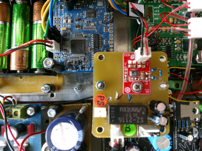

Herewith an update on the power supply of the familiar ES9038q2m board.
The various steps taken over time are:
- an active rectifier for both analog and digital power supplies. This required quite some capacitance – 20.000 uF per supply - to obtain a modest ripple.
- as a second stage some K-multipliers. Not much ripple left after this stage.
- for the analog supply the latest Denoiser with LM317/337 (see threads by Elvee and others)
- the regulators for the digital supplies are 3 x LT1963 (5V / 3.3V)
- the latest experiment is with a separate 3.3V supply for the clock. The standard clock draws a measured 6 mA. At first the idea was to use a low current TLV431 with a set of 4 x NiHM batteries of 1.300 mA/hr. However, the output voltage appeared not to be too stable when the batteries drained in capacity. So the solution for now is a LT3042 set to 3.3V, which draws 2mA by itself. As soon as the mains power is on, the power can be relay switched to regular power. Also, the power connection can be easily connected to the original board supply for the purpose of comparing. See the extra board connector on the picture.
Why this experiment: it takes quite some time for a clock to be audibly stable. At least a few hours, and it even may take a few days. One may leave the dac simply powered on endlessly, of course. But I like to be around when my diy builds are on power (also related to possible insurance risk, one may never know even with very careful building). Usually it takes some 15 to 30 minutes for warmup of the audio set; yes, except for the dac clock. Please no flames here, just my experience. Hence, the batteries. Up to now, the batteries last somewhat over four days. I am hesitant to use a large capacitance battery bank, as most have some sort of switching booster to meet the required voltage.
Any suggestion to reduce the current draw of the battery supply are welcome. For instance: how much voltage would a clock really need to ‘stay on temperature’ when the dac is idle?
Finally for now, is it worth the effort? I did take audition notes of all the various steps. For me, every step was an improvement. Actually, I should go back to the basic initial setting to verify the experience. But hey, the recent separate supply of the clock did so much for a tighter bass, a more natural decay in notes, better separation of instruments/voices, etc that something in me is procrastinating such a basic verification.

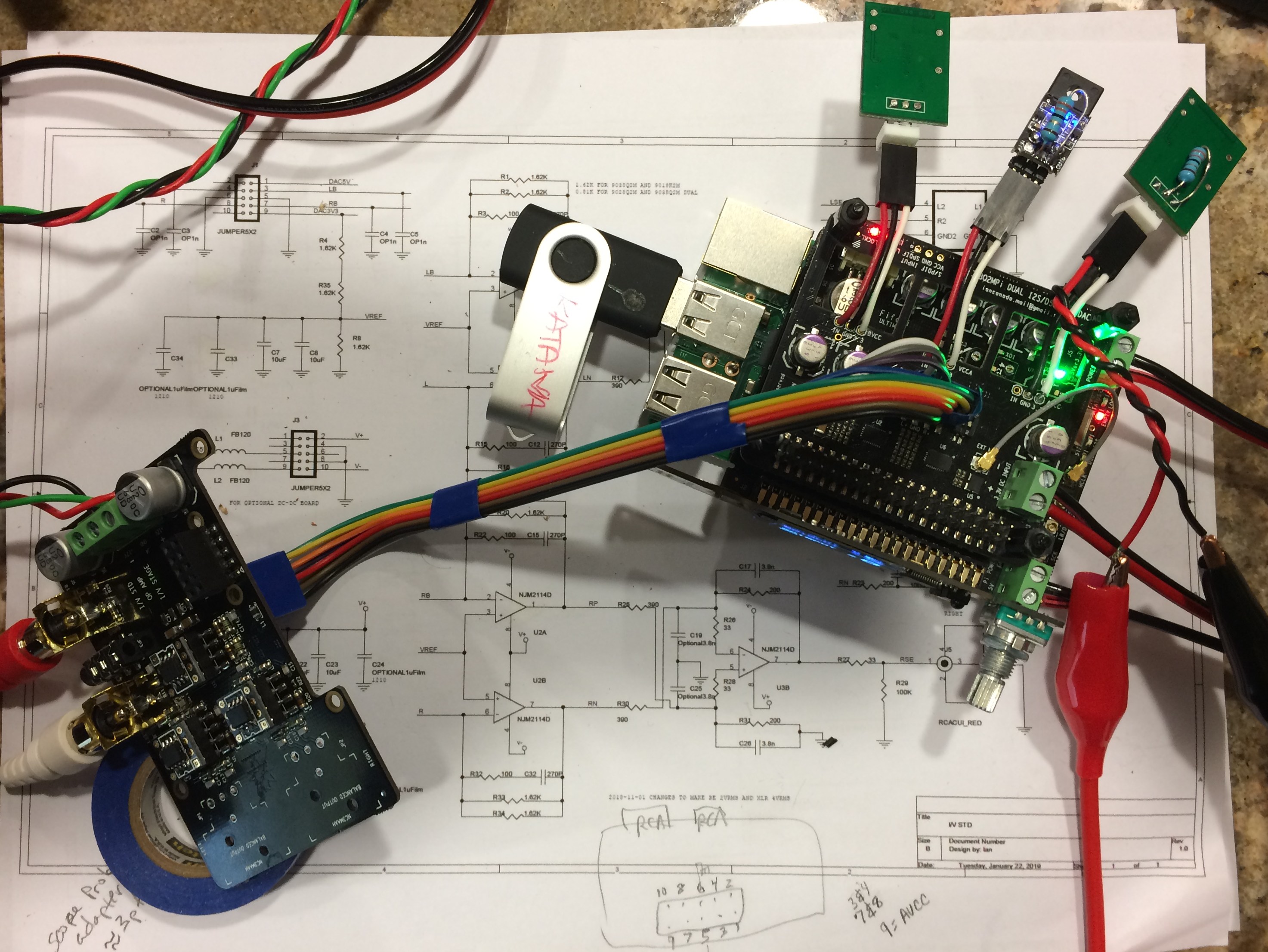

An update about how to connect a separate output stage as mentioned in post 6946 -6954. The post yielded as an insight of JensH that the four resistors of 6k2 on the dac board would not have to be unsoldered. With the advantage of being able to still listen to the standard rca-output.
As for the separate output stage the following options have passed in this thread:
a. the well described point-to-point output stage of Markw4, as summarize in post 2775, as tight connected to the dac board as possible:
https://www.diyaudio.com/forums/digital-line-level/314935-es9038q2m-board-278.html#post5555503
b. output stage with RPi form factor, a la IanCanada
DocumentDownload/RPiDacHAT/IVboards/IVSTD at master * iancanada/DocumentDownload * GitHub
c. output stage based on the schematic of MrSlim (post 3003), in the version of Green77, aka Daniel (post 5972)
ES9038Q2M Board
and my translated numbering of the bom in post 6946
https://www.diyaudio.com/forums/digital-line-level/314935-es9038q2m-board-695.html#post6517667
The two last versions of an output stage are relatively simple to be build.
For a start, I prepared option b. an output stage of Ian. This is the most simple one to connect right on top of the dac board. The output stage has its own divider for the AVCC, only 3.3V is required.
In first instance, the output stage was equipped with three oldish NEC4557c. The output was somewhat lower than standard, and with a noticeable audible distortion. Next up was a set of LM833 resp. a set of OPA2604. In the last two instances the output was only producing a very low volume, and was heavily distorted. All voltages very ok. Adding 4 x 1nF capacitor to ground on the four dac outputs as per schematic of Ian did not change the result. Also inserting a 4 x 780 ohm in series with the dac output wires did not make a change.
Question: what do I miss?
Not of fan of Ian's output stage design. For one thing both channels share the same AVCC reference since Ian's dac doesn't use separate L/R AVCC regulators. Also, I always found Ian's board to be somewhat distorted sounding. One problem is that its not on the dac board ground plane. I got the best sound out of it by driving it with Ian's dual mono dac board using a ribbon cable folded over in way that seemed to help filter out distortion from RF coming out of the dac analog outputs. I posted a pic of the folded and taped ribbon cable in one of Ian's thread in case anyone else wanted to try it. Attached below for reference.
The connection from the dac board to the output stage is about half the length compared to the photo in the previous post.
The serious distortion is really unbearable after already one minute, even with the 4557c's. So it is not just the output design. Strange that the other duals hardly produce any volume. I do have an add-on board with AD797 for to two separate AVCC's, and a subsequent 2 x 1.65V reference voltage.
Is it oscillation somehow? As a next step a scope may reveal what signal is produced.
Or should the 6k2 resistors be removed after all?
What can be a test to check what is going on? As in, for instance: can the output board be tested on its own? If so, what test signal can be fed to emulate the dac output?
If you are shorting AVCC regulator opamp outputs together that might cause some distortion. There is a schematic for Ian's output stage board you can use the check the wiring. I used OPA1612 for all the opamps, although the differential summing stage feedback resistors are pretty low value resistance. IIRC it was designed with OPA1622 in mind for that stage in order to directly drive headphones or something. However, OPA1622 was mounted on a dip-8 adapter which does not correctly ground one of its pins that is supposed to go to ground. IME not properly grounding that increases OPA1622 distortion. One thing to try might be using the differential outputs with some additional stages of passive filtering made with good film caps and metal film resistors. For each channel there would be one differential RC filter, and one RC filter to ground for each output signal. In other words, try what AKM did on AK4499 eval board for differential (XLR) output filtering. Its not a greatly effective filter, but it doesn't sound like too many opamps in a row either.
Another thing that might help would be powering the output stage opamps as I described in earlier posts using a R-core transformer with separate windings, etc. Also, it might help to bypass opamp power rails with film caps instead of X7R ceramics. One more thing that might help would be trying running the opamp rails at a lower voltage, say, maybe +-11v rather than at +-15v.

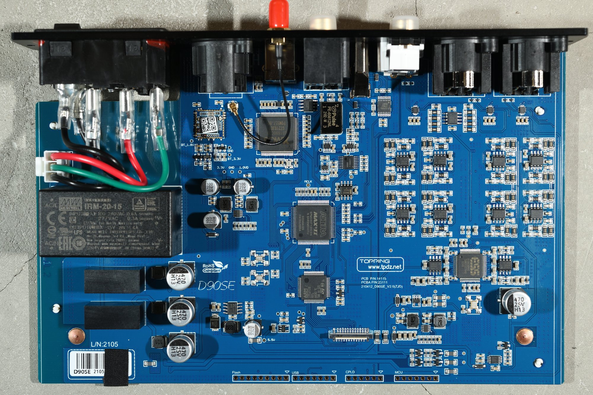

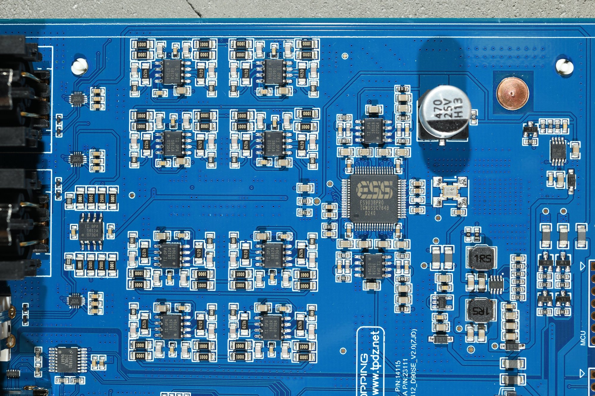

Hello folks;
Please see attached layout they achieve great results with smps.
They use TPS7A49 + OPA1612 OPAMP Buffer to power up vref_r and vref_l.
What is strange as far as i saw they use only positive power supply for the opamps.
what sorcery is this?
What i also noticed;
They use sctoty diode in every linear regulator input.
They power up audio clock seperate power source.
They use lots of ferrite beads especially in and out of regulators.
They did not use isolation ic for i2s and i2c only seperate ground planes.
What i do not understand;
The function of use lots of STO-23+ 10k resistors components.
What is 16 pin qfn ic just before for each outputs (3 pcs marking:3710 / 2007U)
Why they use resistor and capacitors in the feedback for vref buffer opamp
The output opamps will need +- power or else there would have to be DC blocking caps on the output. Other opamps that are never expected to need their outputs to go below ground could be powered from a single positive rail and ground, say, the AVCC buffer opamps. The AVCC opamps may include filtering on the signal to help reduce noise going to the dac chip. The tiny chips by the output connectors are for muting the outputs. Diodes at the inputs of voltage regulators could be for reverse voltage protection; depends how they are connected.
